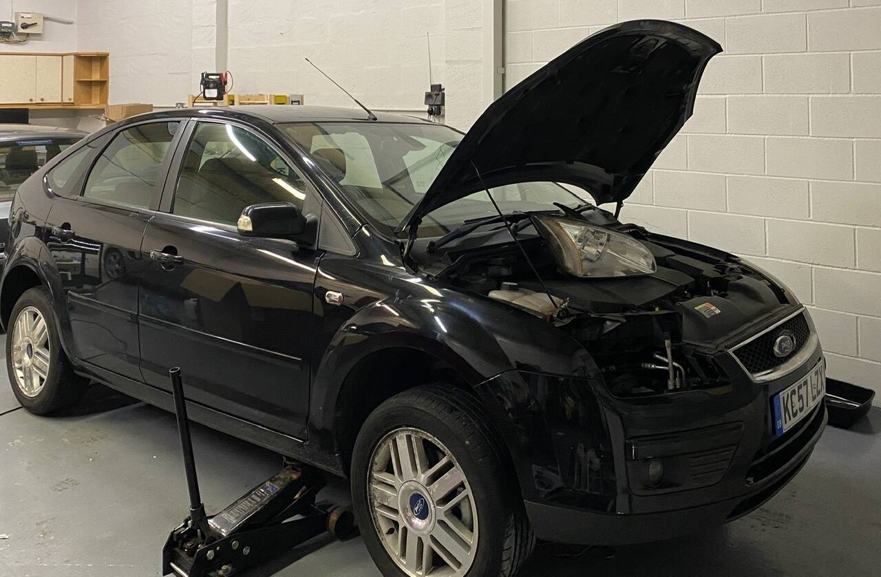

sierraman Posted January 7, 2020 Posted January 7, 2020 Re the wheel dragging, have you stripped down the brakes, might be sticking Clunk when taking off could also be the wishbone bushes.
Kiltox Posted January 7, 2020 Author Posted January 7, 2020 7 minutes ago, sierraman said: Re the wheel dragging, have you stripped down the brakes, might be sticking Clunk when taking off could also be the wishbone bushes. The wheel dragging is the description from the previous owner, I wouldn’t describe it like that, tbh. It rides as expected, doesn’t bash about over bumps etc - I would reckon the suspension is in decent shape (there’s a few recent bills, too)

Kiltox Posted January 7, 2020 Author Posted January 7, 2020 Hoping I have diagnosed the steering fault - need both a part and a Forscan compatible ELM327 to arrive so I can find out! RobT, The Moog, mrbenn and 3 others 6

sierraman Posted January 7, 2020 Posted January 7, 2020 Thought again on this (I know I’m tragic...) check the rear gearbox roll restrictor for a clunk. Usually you can ‘fill’ them out with PU sealant. Kiltox 1

Kiltox Posted January 8, 2020 Author Posted January 8, 2020 39 minutes ago, sierraman said: Try the diesel, I think the pumps the same. Plenty of used pumps about. Still don’t think it’s the pump, not yet anyway. Steering angle sensor is the main culprit but I need to run some more tests.
Kiltox Posted January 8, 2020 Author Posted January 8, 2020 1 minute ago, sierraman said: Have you got Forscan? Not yet. My Delphi DS150 can interrogate the steering system but not calibrate etc. Got an ELM327 coming today so I can have a go with Forscan. purplebargeken 1
sierraman Posted January 8, 2020 Posted January 8, 2020 Definitely, you can do a lot with that program.
Kiltox Posted January 8, 2020 Author Posted January 8, 2020 10 hours ago, sierraman said: Definitely, you can do a lot with that program. Will try it out tomorrow, see if it sheds more light on the state of the steering system than my Delphi did. Suspect it won’t but will hopefully be able to code / calibrate replacement parts as required
