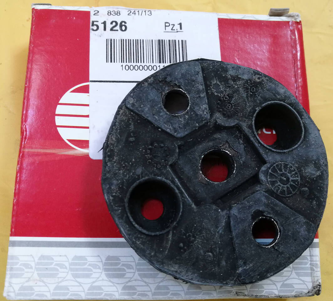

I believe my LNA needs a new coupling disc that I have bought, without bolts. What I did not realise is they were difficult to fit!
I’m afraid so, if the original is still in place. You will have a struggle, getting the old one out - easiest I found was to undo and remove pinch bolts at rack and column end. Key in to remove steering lock, lift column at steering wheel as high as it would go, prize out assembly. Then grind off the rivet heads and then drill though the centre of the rivet to remove it from the brackets. Assembly is reversal of removal as they say in Haynes manuals.
Also Chris, I would recommend purchasing one with the correct fixings, they aren’t expensive and the fixings are just the right size to allow re assembly.
This is the one I used ...

I have taken your advice and ordered a coupling complete with the correct length bolts.
This is what I had ready.
