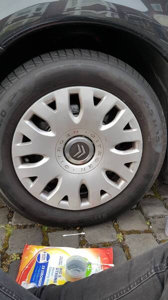

maxxo Posted September 7, 2020 Author Share Posted September 7, 2020 Went up to south shields today was good, until i paralell parked and misjudged it......... quite annoyed at myself so i used some random silver spray paint that's probably a million years old and a cotton wool bud to "fix it" came out alright i feel, certainly better than the scuff ended up touching up all 4 you can still see where it happened, but it should fade in alright privatewire, CGSB and Cavcraft 3 Link to comment Share on other sites More sharing options...

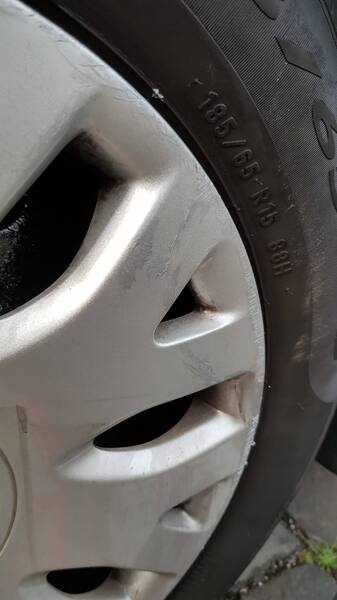

maxxo Posted September 7, 2020 Author Share Posted September 7, 2020 forgot this close up of the repair, not perfect as i say but beats having a huge scuff Cavcraft, privatewire, paulplom and 1 other 4 Link to comment Share on other sites More sharing options...

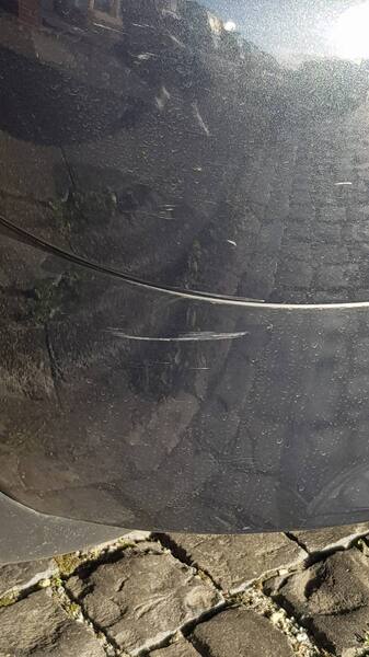

maxxo Posted September 9, 2020 Author Share Posted September 9, 2020 Nice to see i live on a street with honest people.............not I rubbed at it a bit and got it looking a bit better still extremely annoying though rainagain 1 Link to comment Share on other sites More sharing options...

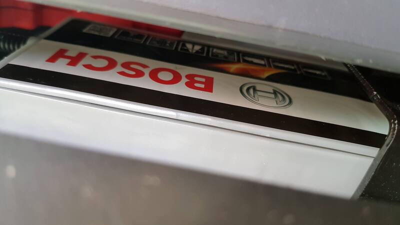

maxxo Posted September 15, 2020 Author Share Posted September 15, 2020 Been spending some pennies today this should be interesting to see how differently it starts once fitted with a nice new battery can have some fun with the old one Link to comment Share on other sites More sharing options...

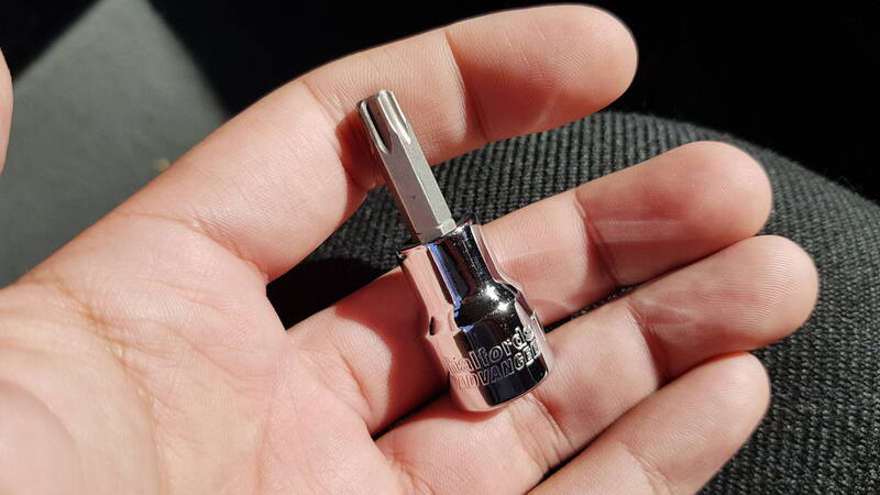

maxxo Posted September 17, 2020 Author Share Posted September 17, 2020 Did a bit of tinkering today well more like faffing around with the seat for 20 minutes Ah yes, time to access the battery......now on a normal car that doesn't think it's an egg it's in a sensible place, like in the boot or under the bonnet citroen though.......well they have to be different and for added barrels of laughs, this is a 2005, so it has the torx bolts holding it down which is fine until they've been accessed more than twice then they round off and make life a pain hmmmmm i was given this very cheap looking socket set, it did the job though and this piece is a total life saver, it really does make life a million times easy as the allen key like tool citroen give you is absolutely awful came with the car, i dread to think how much it cost from halfords once the bolts are all removed it's time to slide the seat all the way back, remove the head rest and tilt the backrest backwards then......tilt the entire seat forward exposing a 9 year old halfords battery which somehow isn't completely dead but i want to replace it before winter now it's time to close all the doors and set a stopwatch for 3 minutes to let everything shut down so it doesn't act french mind you this is a very french thing to have to do once the BSI clicks off, and i waited a bit longer just to be safe it's time to remove the terminals of course following all instructions i could find exactly to avoid issues I must admit, these terminals are absolutely excellent! makes it so much easier than unbolting the traditional style ones and messing about for ages of course, now it's time to remove the battery starting with the clamp surprisingly easy tbh, nothing broke and it came straight off without getting stuck on anything which is nice! however, removing the battery now that's a fucking pain being french the battery is almost the exact same size as the place it sits so that was some fun and games trying to get the damn thing out and the seat tilts forward just far enough to make getting the battery out that little bit more awkward still after a good few minutes of wrestling i managed to get the battery out which is nice then i was greeted with this mess nice to see an old pound coin too, just shows how long all that has been there for as i am a complete doofus and got distracted by a neighbour coming to talk to me (word of advice, if you see me working don't come and talk to me as i have no self control and will talk for hours instead of working) and i forgot to take photos of the install of the new battery it's pretty much the same as the removal process of course it's a complete pain to get the new battery in place, it would just not go in without tons of fiddling such as moving the leads and the vent tube while holding a heavy battery with one hand which is always good fun then waiting for a good while after connecting it before turning on the sidelights......which greeted me with a nice "thunk" then turning on the ignition, waiting 10 seconds then turning it off and removing the key then testing the remote locking before finally starting the engine and setting the clock and turning auto lock back on only pic i have of the new battery, it's a fair bit more powerful than the old one i'll get some better pics tomorrow of how snug the fit is, i need to make a quick repair to one of the seat bolts as it has somehow broken itself and won't screw down LightBulbFun, juular, CGSB and 3 others 6 Link to comment Share on other sites More sharing options...
maxxo Posted September 17, 2020 Author Share Posted September 17, 2020 I have absolutely no doubts this won't fix the cold starting fun i tend to have at least i'll have the power to do some mega cranking now that seat design is awful absolutely awful in every single way known to man i literally cannot express enough much i don't want to see those bastard bolts again but i will, as i have to fix one that has somehow broken itself lovely but in a way i love these 2000s PSA cars, i don't know what it is about them but they're absolutely lovely and well worth the effort Link to comment Share on other sites More sharing options...
