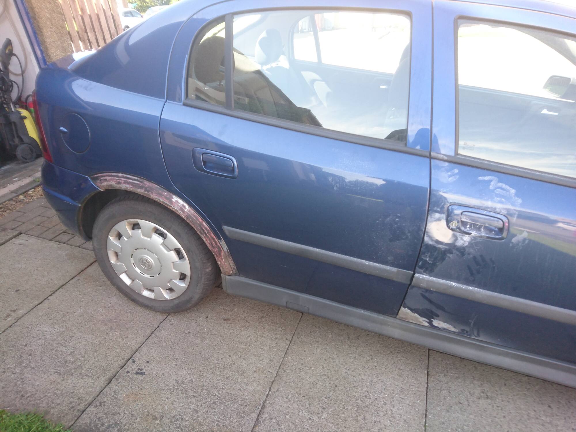

Then fill and sand that as well as sanding the rear arch and the big scab at the bottom of the drivers door.
The arch was welded last year for the MOT but hastily sprayed in black because that was all that was "in stock" at the time. Did the job at the time  but the rust was coming back through the cheap paint. Once sanded back the arch got a coat of filler to take care of a few pin holes then final sand and a bare minimum of masking off......

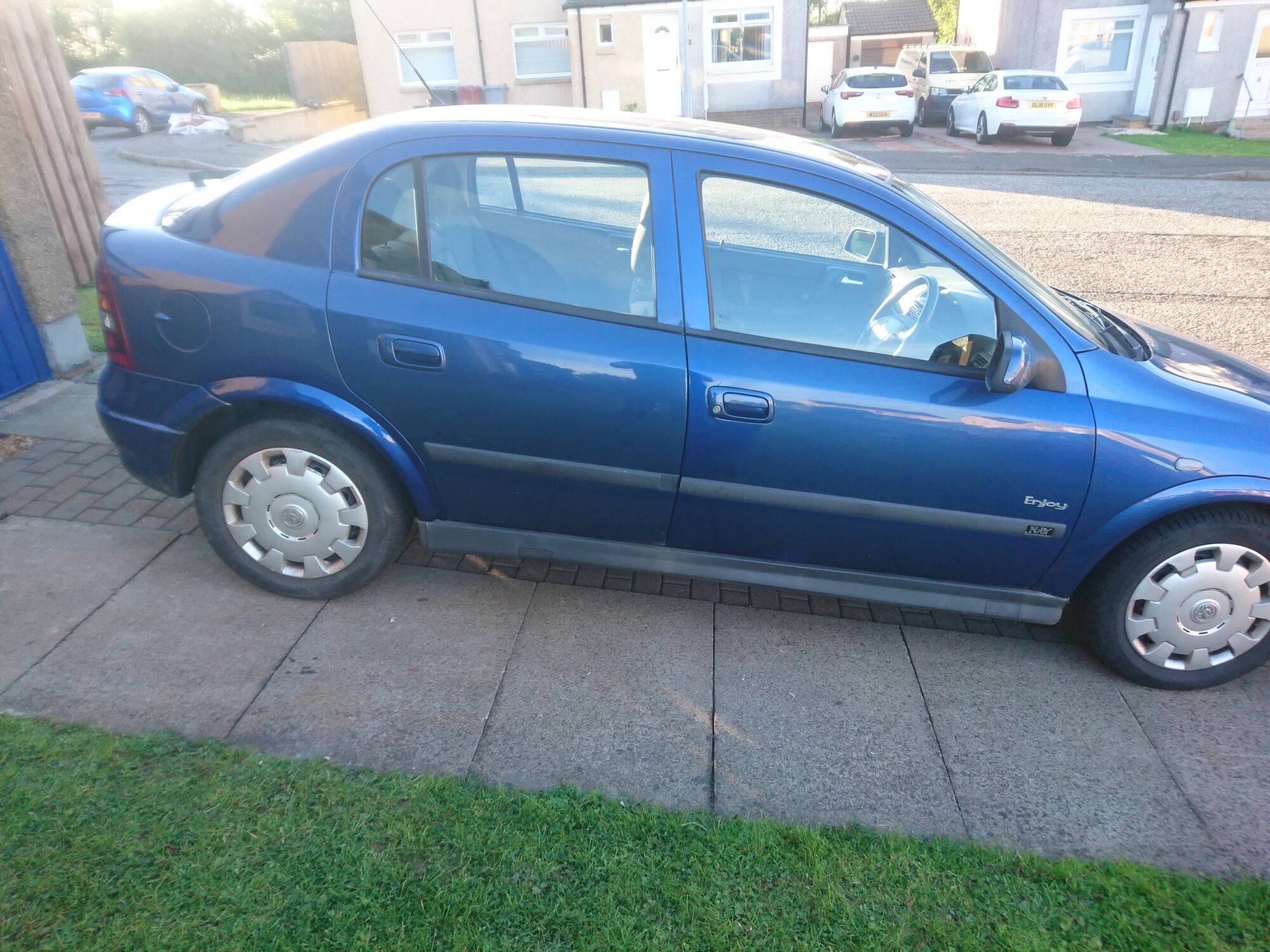

2xprimer, 2xpaint and 2xclear later and it's reasonably presentable.....
Just got the opposite side rear arch to do tomorrow and it'll be looking like new* again.

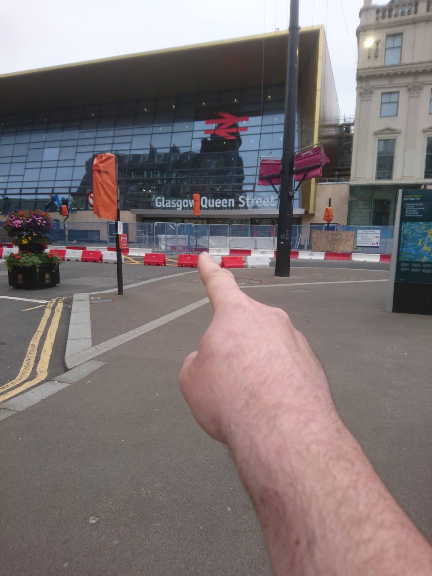

Another small clue for anyone with an indepth knowledge of the UK rail network.
Fans of The Young Ones can content themselves with shouting "TO THE STATION......" and playing some Motorhead......
