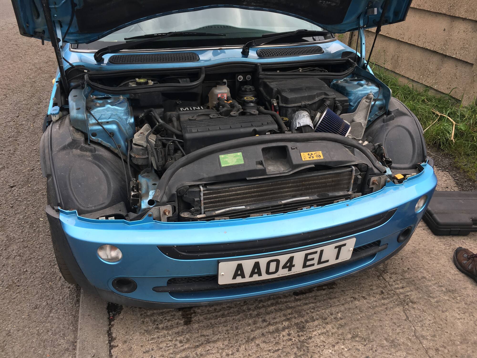

Hhmmm I think I’m going to struggle to test the water pump. I took this pic at upullit. You can see the bottom hose feeding the pump from the radiator  but not the top one that goes into the block  as it’s under the alternator. If you remove the alternator to see this pipe you then can’t  put the aux belt back on.
I can only think of removing the top hose feeding  the radiator once the thermostat has opened and check for flow that way???

at car now after three hour drive down. Filled up with water and ran engine, interior heater nice and warm so I think I can rule out the pump. The radiator is only getting at the corner near the top hose. If you open the bleed screw here water comes out but it doesn’t feel like the rest of the hose has water in it.

Ok guys changed stat, it’s a bit of ball ache to get at, hence why I changed it rather than first trying to run without one.
Straight away once it started to warm up the radiator got hot all the way across. Took it for a drive all good.
