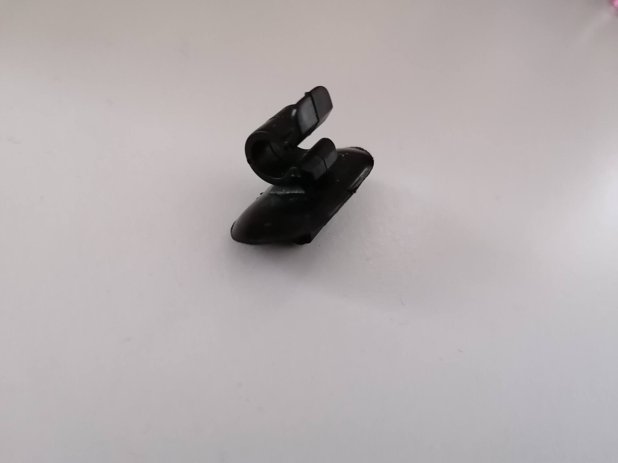

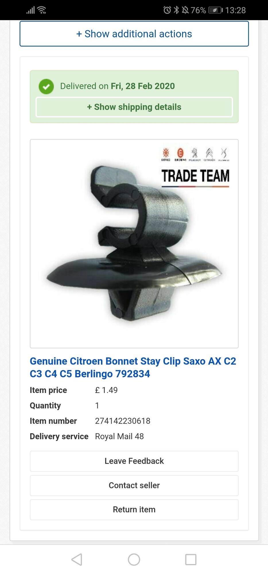

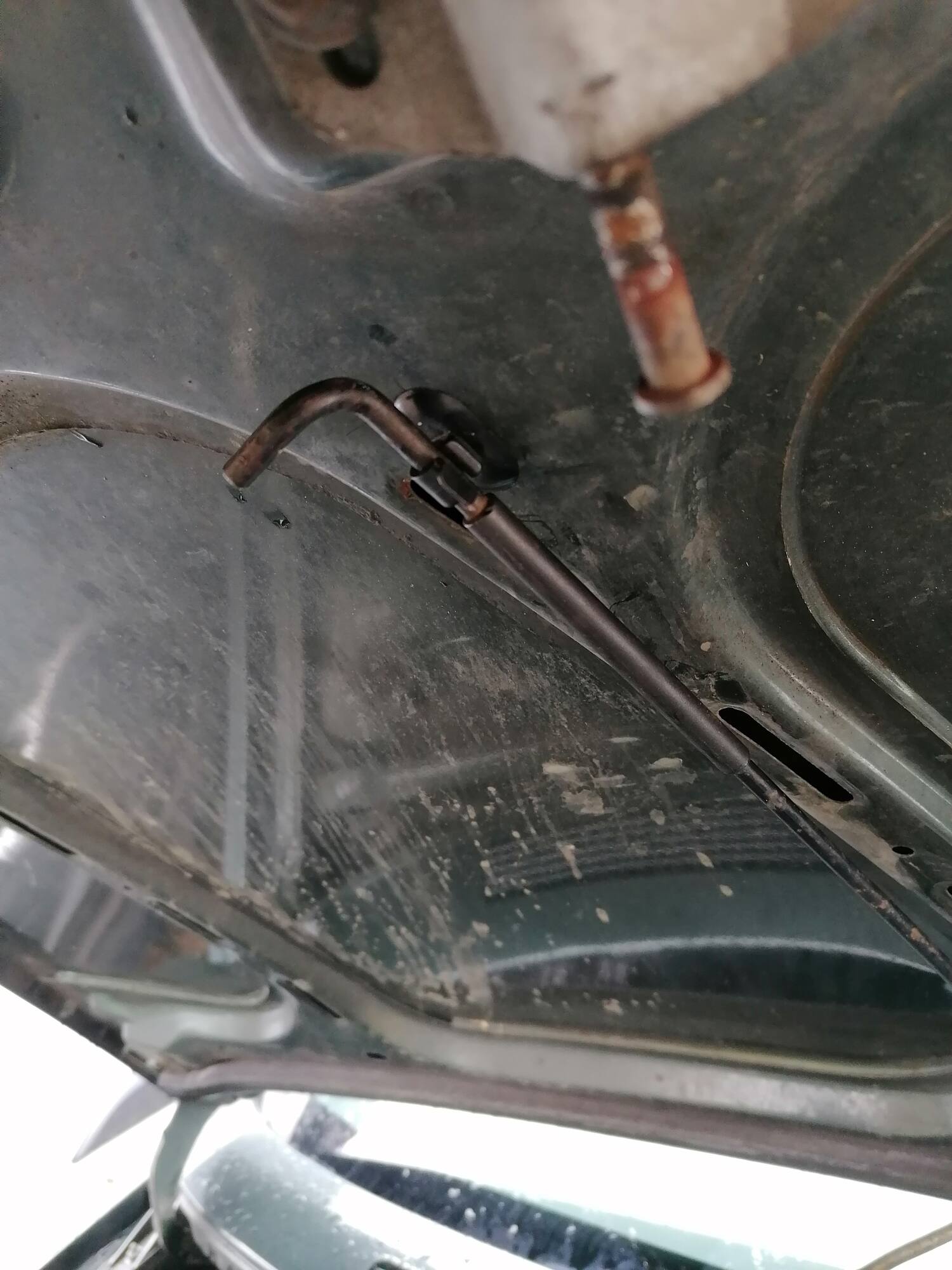

£1.49 later and the bonnet stay now has a new catch, the cable tie holding it up previously had long since given up the ghost.
Why did I put up with a cable tie to hold the bonnet stay for the sake of £1.49!

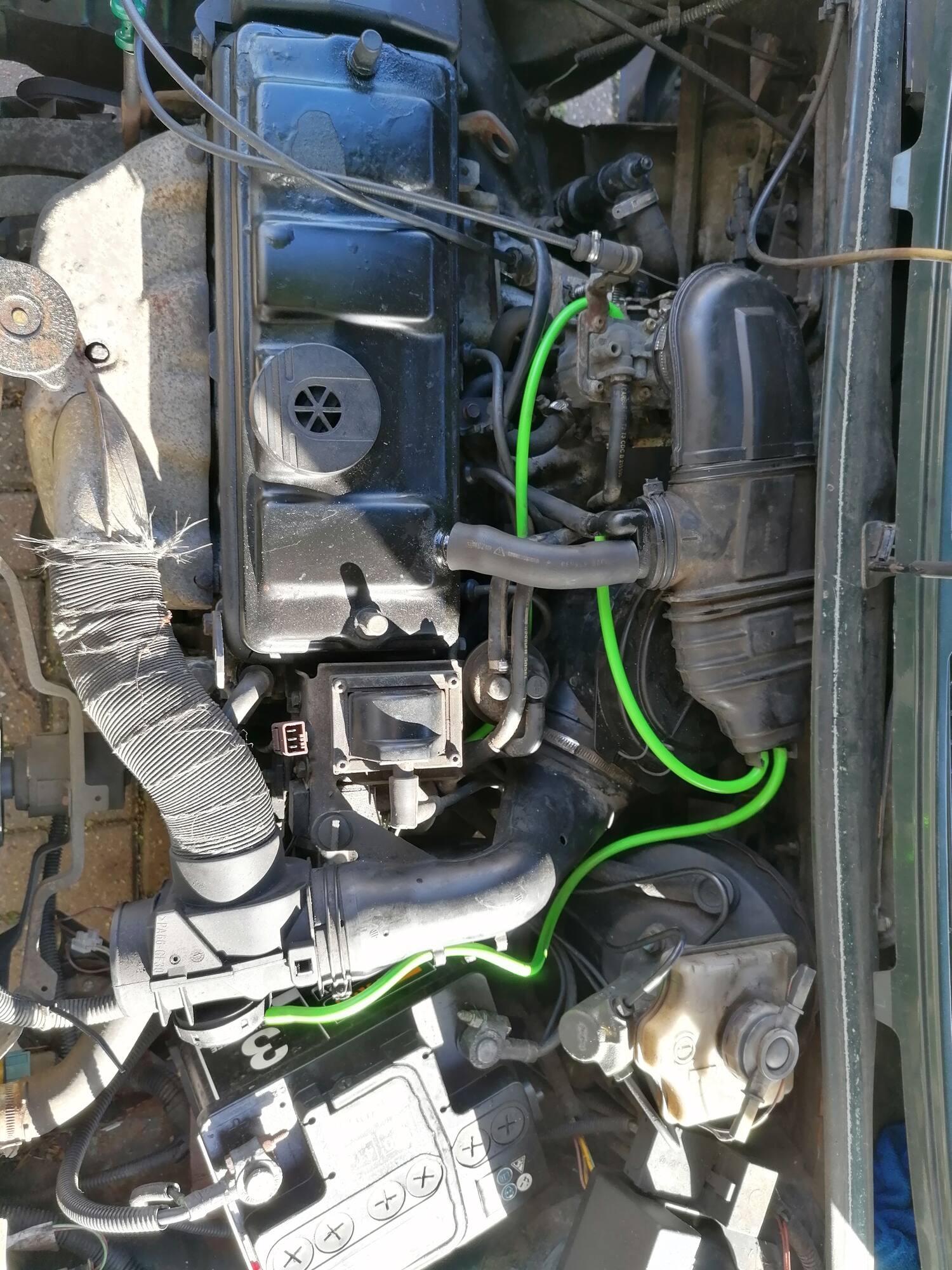

AX has started randomly cutting out at junctions, usually when warm and after having driven at speed.
It's been fuelling funny since I got it, hot starting is a pain. It always smells flooded when you come back to it after it has been sitting.
Any thoughts?
I sprayed around the carb with cleaner, but couldn't detect any air leaks.
I might replace all vacuum pipes just to be safe.
Any thoughts?

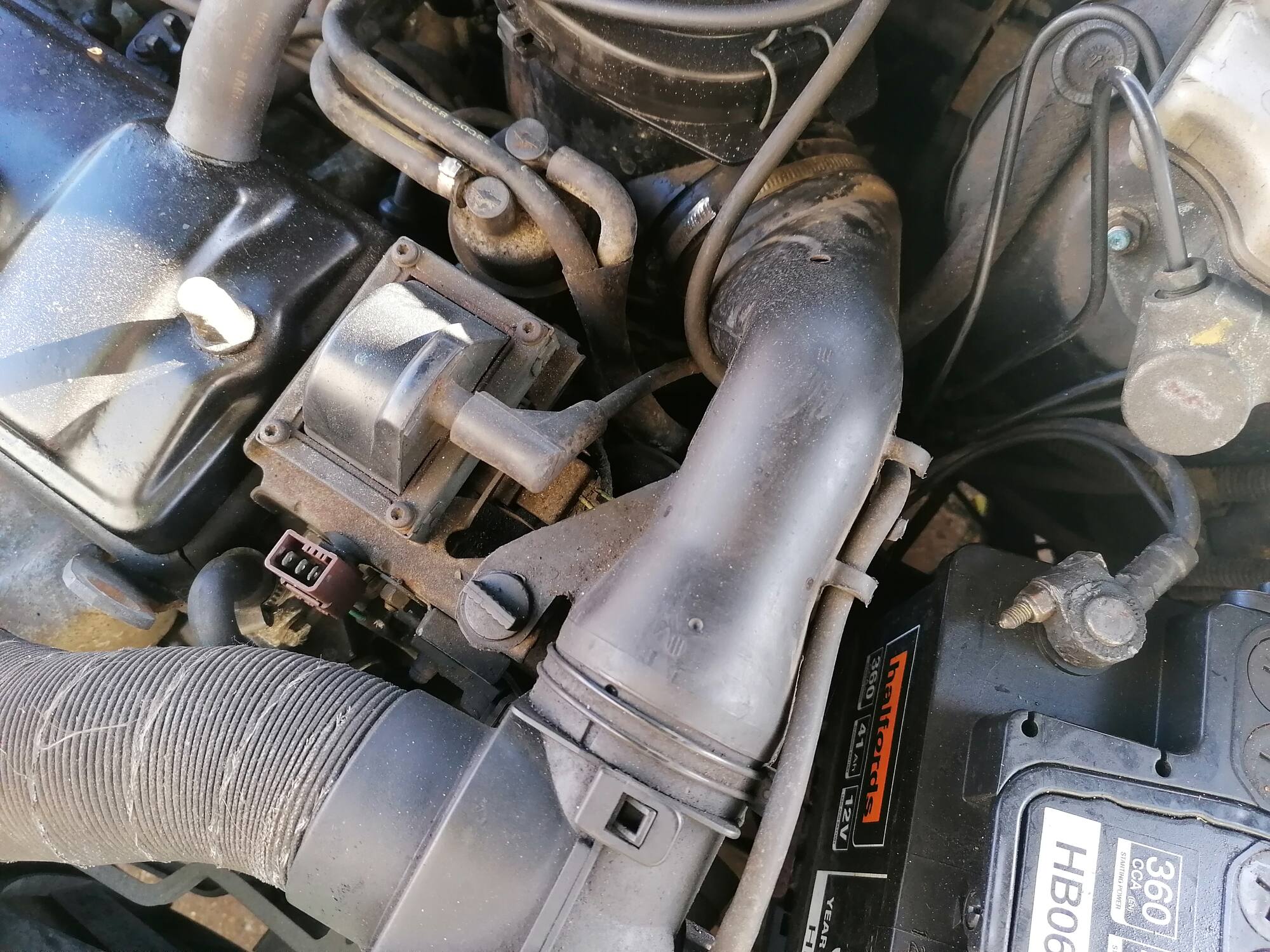

Does sound typical of ignition coil (I can’t remember if later TU have a coil & dizzy or distributorless ign) or high tension side of the ignition system starting to fail.
Could also be the fuel pump is overfuelling and flooding the carb.
Carb or fuel line has a leak which only manifests when hot.

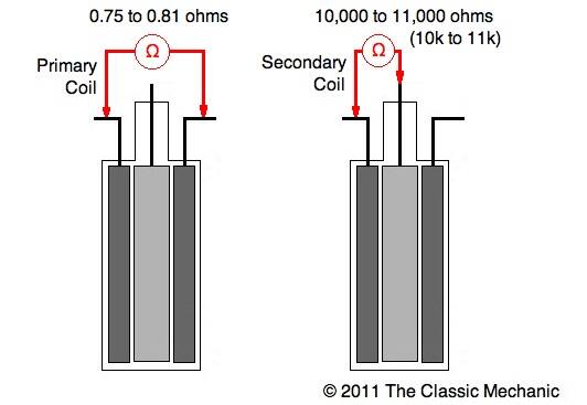

I’d bank on the coil myself. If you can check the LT & HT resistances.
Ball park for coil resistances, but check against an HBoL if you have one.

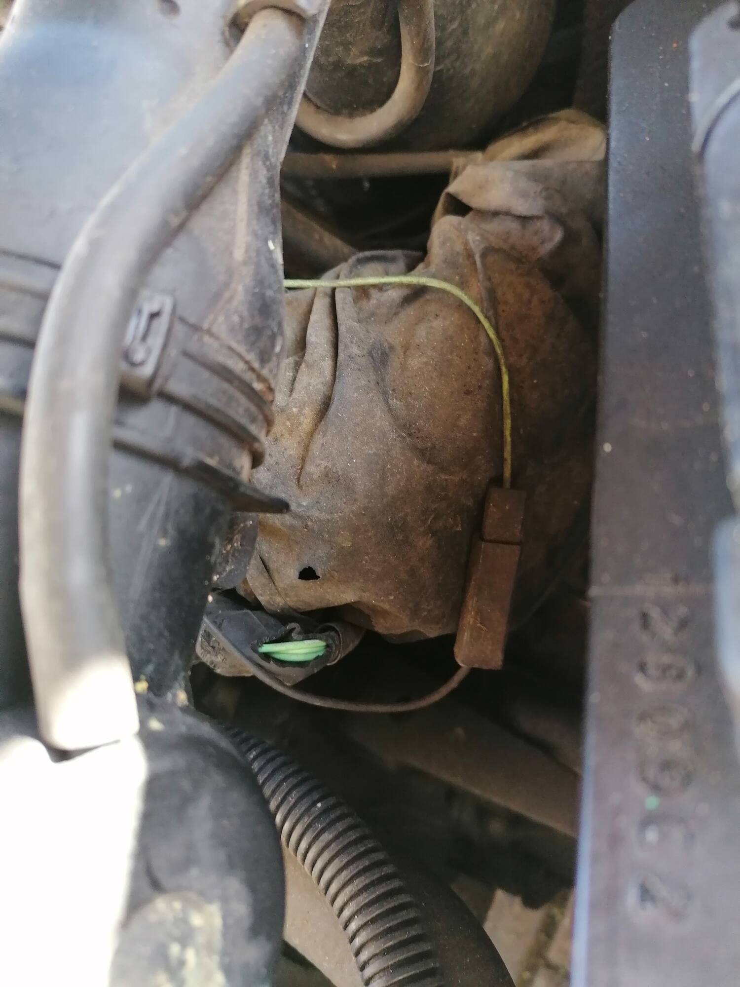

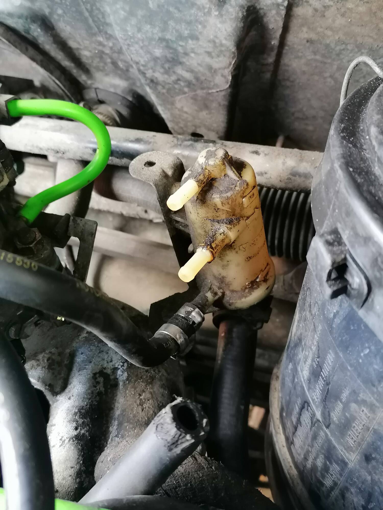

What is this part?
I'm presuming some sort of fuel reservoir, bypassing it makes car feel like it's running better, no hesitation or cutting out.
Maybe there's a blockage or something?
Will leave it off for a few miles and see if problem reoccurs.
Edit - Nope, red herring, see below...

Take the coil of and check the underside for damage. The one on my mk 3 Golf was exactly the same as that visually and gave the symptoms you describe, on closer inspection it was obviously knackered.

33 minutes ago, TheDoctor said:
What is this part?
It looks like a swirl pot or de-aerator kind of thing.
The randomness of the fault does lent itself to an electrical issue. I haven't changed the leads since I got the car, I might do them and the coil together.
Especially as two people have mentioned the coil now...
It took me a while to find it, it was worse in the wet obvs. The insulation had cracked on the underside.
I'm not saying it's definitely not fuel related, but when I was messing with older cars BITD, most 'fuelling' problems ended up being electrical!

I'm going to do the coil and HT leads first then decide what to do.
