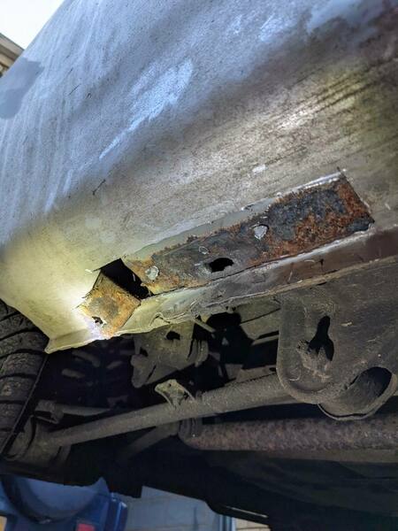

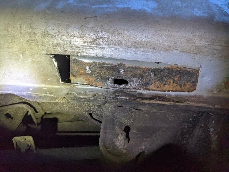

Right. Let's start getting this rust shituation sorted.
@The Moog's nuclear-grade ramps made short work of raising the car off the ground. The front end of the ramps are raised off the ground because of our drive is horribly uneaven.
I then gave the innocent looking patch a few passes with the angry wire wheel. I'm now confident the ripples in the pinch on the sills is rust jacking.
Chop chop
Scaley. I imagine this goes on for a bit further, but I've whacked the metal with a hammer and it doesn't dent or deform so I'm unsure if I should carry on cutting until I find the end of the rust or keep it where it is right now.
This is where I got to when the Sun went down. It's not too bad, all things considered. I haven't been able to open up any more holes, just knock off a ton of rust. What's happened here is exactly how the assembly line workers told me would happen, when I met them at FoTU. The outer panel is galvenised, and the majority of the metal I cut out was clean and still the original thickness. The reason for the rusting in the first place is because the sill brace bends down to pinch with the outer and inner sills. As it bends, the brace comes closer and closer to the outer sill and makes a super tiny gap between the two metal parts. This meant that they couldn't coat it correctly when the bodyshells were dipped. The way the brace is bent also creates a trough for water to pool up in which is especially a problem for Micras fitted with a sunroof. Because the sill cavity is open to the atmosphere through the drains, I have a feeling that condensation is what's caused the issue here.
You can see there is cavity wax of some sort... and cobwebs. The camera couldn't focus properly but the wax stops about 3' before the sill.
The plan of action tomorrow is to finish setting up the welder, put the car in the garage and patch the car up. Hopefully I can do it with two- one to fill where the brace has rusted through and then another over top of all that, once I've decided if I want to cut out more outer sill to chase down the rot. I'll the drill a hole through for a cavity wax wand, prime, stonechip, paint, cavity wax, bung and then slap some grease on because Y not.

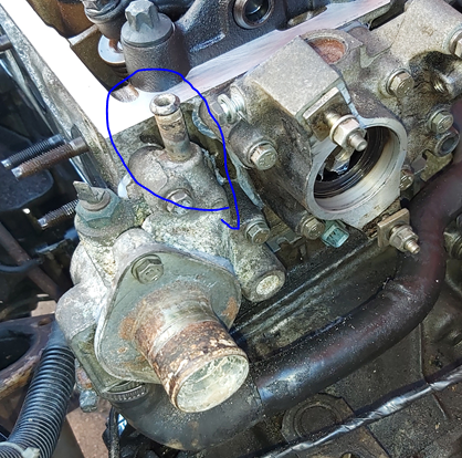

Anyway, the more pressing issue is the mystery slow and gradual coolant loss on the BX. At present, the low coolant warning comes on once every 2 months or so. The pressure tester showed nothing after 2 hours and the exhaust doesn't smell of coolant either. I'm hoping the oil loss issue has been fixed with replacing the distributor seal, but the real test will be after I service the engine.
When I bought the car, the rebuilt engine had ~50 miles on it. I've since put 6000 on it. I wonder if the head bolts perhaps need re-torquing. IIRC they're stretch bolts. I haven't done a leakdown test on each cylinder. The pressure tester was connected to the radiator fill point which is the expansion tank. The tank connects to the thermostat housing here:
From the looks of things, this connection is after the thermostat so it's only part of the coolant loop when the thermostat is open:
Would this mean it's a flawed test?
Other work I have done that involved tampering with the coolant circuit was replacing the intake manifold, which has a coolant passage in it which could also be leaking. With how the pressure tester was connected, I'm unsure whether this could have been picked up.
It could also be some form of HGF as these engines are known to do it.
Thoughts?

The bottom hose on the radiator goes back to the engine on most cars and does not have a thermostat to divert or stop the flow for a quicker warm up. So if the radiator was under pressure in the test I would assume the whole system is.

Ah, that's true. The next test I'll probably do is put a glove over the filler and see if it inflates any before the thermostat opens. I have a sneaking suspicion the head gasket may be failing already.
remember, most thermostats don't actually seal 100%, and as there is only one of them in the system, any pressure can always get back "the other way" round the system.  It matters not whether the thermostat is open or not, pressure in the system is pressure in the system.
Which is why, if the exhaust was passing into the coolant jacket, I'd expect to see the glove inflate with nasty gases pretty quickly after I start the engine.
I can't think of many places where coolant would escape, while meanwhile being invisible to a pressure tester.

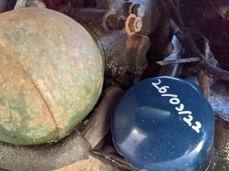

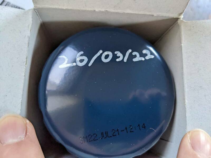

Anyway, the task today was to do an oil and filter change on the BX, which, all things considered, is frightfully easy. There's soooo much space in the engine bay making basic jobs like this honestly a joy to perform.
I firstly put the date on the filter, just so I know how long ago 6000 miles was
Then the actual oil change happened.
PXL_20220326_131525399_MP.thumb.jpg.79cd17212c2928dbaee169001982c443.jpgPXL_20220326_131823730.thumb.jpg.4b5942697f4d2c4d9bbdf73a91675f4a.jpg
As it turns out, I did this prematurely as I first serviced the car in July last year. It's no real biggie, though, as when I first serviced the car the oil in there was OLD and INCREDIBLY BLACK, so I was looking forward to when I could at least see some light through the oil instead of a bunch of carbon. I also added the oil change mileage to a label I first put on the dashboard, but it wouldn't adhere, so I put it on the part of doorcard that is only seen when the door's open. This'll hopefully ensure I next service the car at 6000 miles.

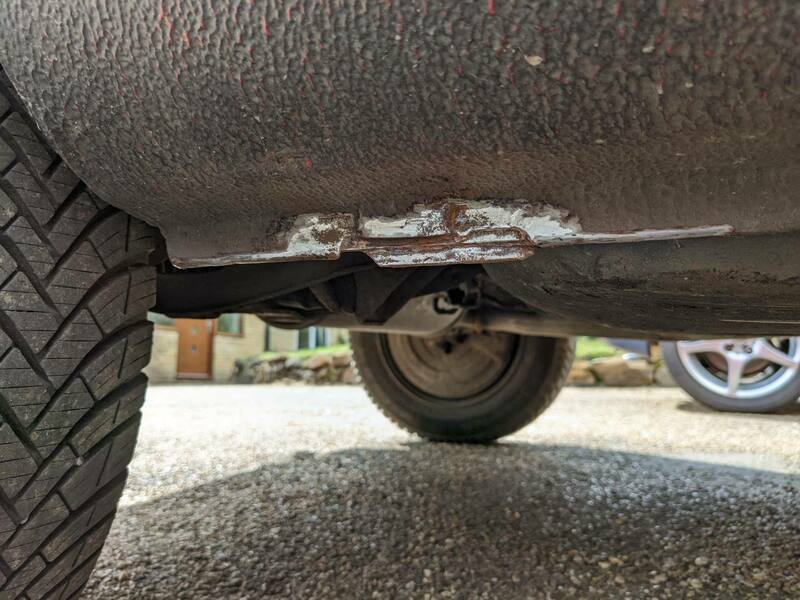

Stilt car
Rust
More rust
Thankfully nothing much worse than just surface stuff though. There's at least 3 layers of stonechip on the sills for some reason. It was so thick I didn't notice the drain hole that was there until I ground all the shite off. I then dug out a plug in the wheelarch that was made of seam sealer and then did this-

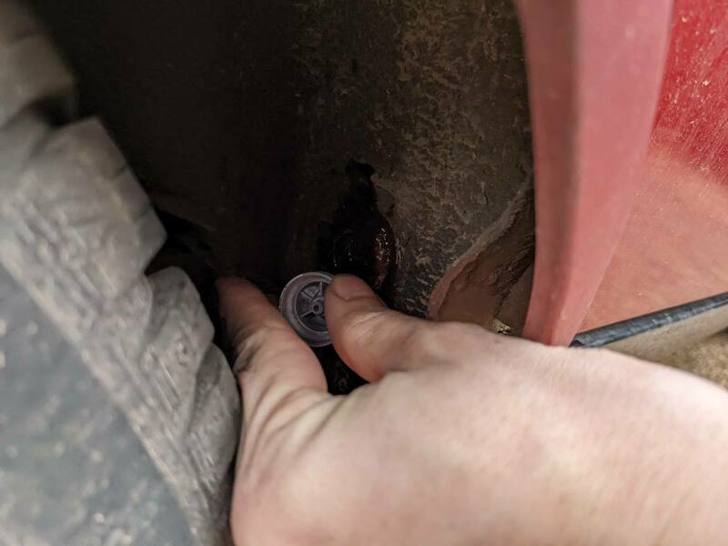

I managed to get cavity wax halfway down the car which was a nice bonus. I also managed to cavity wax the driveway and my rotary tool thing.
Rob at Chevronics said the sills also extend up into the rear of the cabin and there's a flap you can lift to shove a wand in. I moved the rear squab out of the way and got to work
This caused more wax to pour out of nowhere. Looking back, this is probaly why I've never been able to replicate the results- I'm just not thinning the stuff out enough. I was never able to get the stuff to creep as much as Bilt Hamber can.
Because I destroyed the old plug, I had to find something else. I did the right thing and shoved in a spray paint nozzle😁
PXL_20220327_144402466.thumb.jpg.af176d645cc504153b95099dbfbc8127.jpgPXL_20220327_144441011.thumb.jpg.a75148522ec1b7d765267f425afa5de4.jpg
Fits snug and like a glove lol.

I finished things up be giving the other areas a second coat of red oxide rust stopper stuff
Realistically what I need to do in future is take a wire wheel to both sills and take them back to good metal, as the stone chip stuff has cracked all along the sill's length and is is starting to peel away. This shitty black stuff that's currently on them is just scrubbing off with every wash.

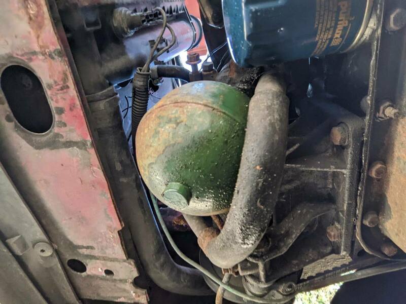

This also means the drip I've been seeing for ages on the reg sphere is LHM, so I proved it with the Tissue Test and, indeed, the tissue turned green. Oof. The source of the leak looks to be a simple one, however-
PXL_20220407_123739053.thumb.jpg.b60f364a0d7e48bdfdf1617b00023044.jpgPXL_20220407_123748884.thumb.jpg.1fbf72467751071e5af64bc2db63854a.jpg
It looks to me like the reg sphere's seal is blown or the return spigot has cracked. Though, if it was the spigot, I'd expect the majority of the oily mess to be on the pipe. The first picture seems to suggest it's leaking from the sphere seal and then down. I think some brake cleaner action is needed here.
