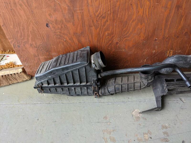

In the meantime, I have these BX parts that I'm selling:
PXL_20210403_150201199.thumb.jpg.72c430c96477ddf5af841223f2556439.jpgPXL_20210403_150206122.thumb.jpg.9ffffc717ff85da7a6eff38f58a76d8a.jpgPXL_20210403_150216456.thumb.jpg.4e9ddd06e34d45af0d864f9ddd4dd5e4.jpgPXL_20210403_150222359.thumb.jpg.672adfec9325ba6e1c1557946415df65.jpgPXL_20210403_150443281.thumb.jpg.57cce769504fe90bfda301f4cfad4aea.jpgPXL_20210403_150437126.thumb.jpg.929a995c576bd747657bf6734bbc4a3a.jpg
Starting from the top left:
  • Intake hose and airbox from a larger engine

At some point I shall make a for sale thread and give them a price. Truth be told, I don't know what these things should appropriately cost, but every penny will help make my wallet happier after ordering those tyres.
Edit: I am also looking for some parts, namely a wheel brace and spare wheel carrier. Hit me up if any of you happen to know where I should be looking to get them.
Wonder if that air box would fit into the space of the CX one?
It may but I'm unsure: from the basic drawings of the BX owner's manual, it looks like it fits the standard 1500-1900CC petrol engines.
I'm looking at plastic replacement candidates so I can sack off the corroded metal one
Looking at engine bay pictures, I'm wondering if it'd fit in the space the present air box does. It might do with some modification, however.

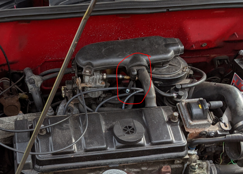

Ah yes, this is what I'll do first before fiddling with the fuel stuff. There is a stub of a line which is plugged right now- it faces the front of the car:-
The distributor is camshaft driven meaning it'll be under the coil... I see no hoses going in that general direction. Along with the engine rebuild, the engine electrics and vacuum system was reconditioned too, but it'll be good to check. There's always the possibility of a leak at the carburettor gasket so I'll test for that at the same time.

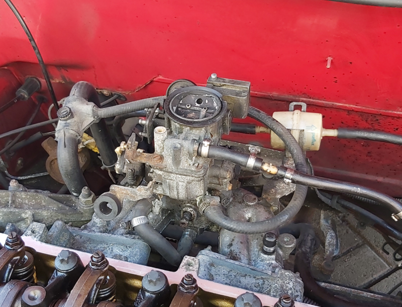

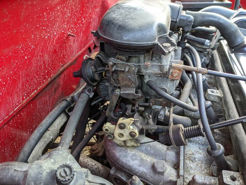

So far, the PO has sent me a sheet for a Weber carburettor, however the pictures I have and looking at the car shows that it's a Solex PBISA 17, with which there is barely any literature I can find.
What happens is that it's trying to idle but it bogs down and stalls. I have to engage the choke to keep it running. Here are some rebuild pictures to help with things:

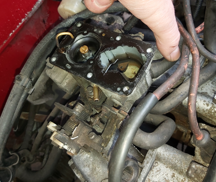

image.thumb.png.2d5865e1cb9233877c3f3b74e0bc1be0.pngimage.thumb.png.fccbd5c994acbb275d3de641df09152a.pngimage.thumb.png.86310541cd2abe80c8e28420912611cf.pngimage.thumb.png.4256c038b1b836b4a9b0e272243629ba.pngimage.thumb.png.08c50e90dc7031252b60cac3dfd46026.png
This indicates that it's been split in half and also separated from the intake manifold. Some tuning must have happened to get it at least running and MoT'd but I don't think any exact fine tuning has been performed. The carburettor, as it currently stands, has been degreased and cleaned. It looks a lot cleaner than in the pictures.
Very different carb to mine sadly so I can't make any direct comparisons sadly.
Can you bring the idle back to a sensible level by applying a tiny amount of throttle?  Or does it have to be via the choke?
I'd probably start by just trying the simple approach and trying to bring the idle speed up using the idle speed screw and seeing if that helps.  If I'm understanding what I'm looking at correctly, it's the screw with a spring under it just above 6 o'clock in the last photo.  All that does essentially is crack the throttle open very slightly.
If that works to a point but the idle is still very rough it will tend to indicate that the idle circuit is blocked and the engine is running purely on what dregs it can pull through from the main circuit.
It's one of those those things that's quite difficult to diagnose remotely, had hoped it would be a carb I know, sadly it's not!
Quite surprised to see it's only a single barrel carb though, my 14RE has a twin choke one, albeit with the earlier suitcase engine.

I have here some more pictures of the carburettor in situ-
Your assumption of the idle set screw is correct by the looks of things. @jamescarrutherswill be glad to know the vacuum advance is indeed plugged in and the blanked off pipe is something to do with the crankcase breather assembly.
Here's the amount of choke required to make it actually run-
And a video of the idle speed with the choke on, and slowly removing the choke until it tries to run and then stalls (engine was at temperature or thereabouts)-
