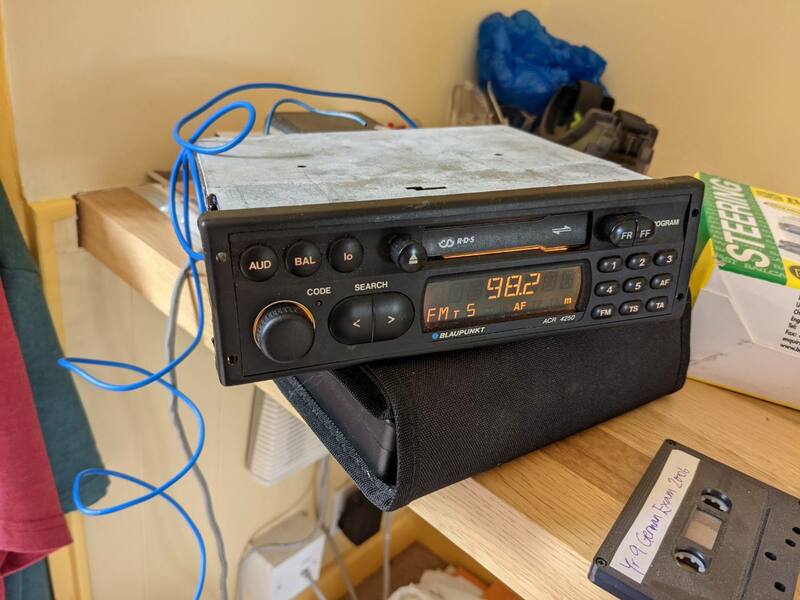

 Managed to get home a week early because someone on my floor caught covid and I've finished for the year. That was lucky.
I found a radio that would work exactly how I wanted. RDS and frequency autoscan so I wouldn't have to. It's another Blaupunkt and it's 9 years younger than the BX, but it looks the part and still has that lovely amber display. The seller was kind enough to package it really well and even include the release tines. I had to buy a £9.99 code for it, but that's a drop in the ocean. Here's a quick guide on replacing your radio in 6 easy* steps!
Step The First:
Buy code and bench test radio:
Radio and cassette works! Winning already.

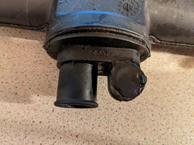

I also attempted to replace the starter motor, only to discover that the end piece on the new one doesn't fit at all, like, it's probably for the Suitcase engine instead. Weirdly enough, the core and brush holder is the same, so, when I do get a proper replacemrnt (Citroen C3), I'll smash the two together to hopefully make a Frankenstein's Monster Motor.
In the vid the starter did not sound as it it was lacking power or the bendix was sticking.

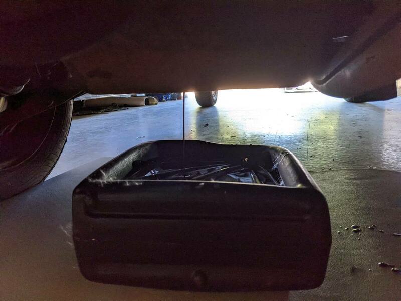

Oh look another oil change. Suspension set to high.
Then I worked really quickly because I didn't put any axle stands under it. DON'T FOLLOW MY EXAMPLE! I VERY BAD PERSON.
The oil was suspiciously black and the filter was definitely older than 6 month-old oil. I doubt any new oil was put in it after the sump was pulled and cleaned, as in, the old oil was drained and dumped straight back in when all was said and done. The (incredibly tight) filter was also much larger than what's supposed to be on there, alas I didn't take any pictures of it. The new one fitted much better.

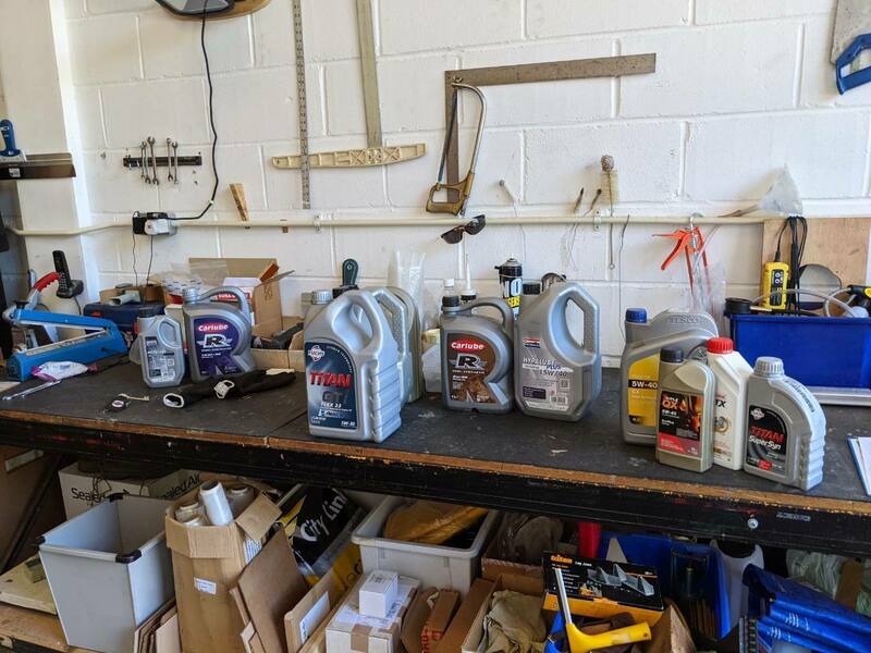

This is the new oil. Citroen recommends only two weights: 10W-40 or 15W-40 for all-year use, so I went with the latter. Bunged 3.2L in, let engine build pressure, drove it about, came back, topped up until full. Job jobbed. No suspicious leaks or anything left on the floor after the car was driven out. Excellent.
Now, what to do with all this oil?
We separated it into the different grades:
And then decanted the separate grades into the containers with the least oil in them. Through doing this I don't need to buy any extra oil for the Micra! Winning already. The only odd one out we had was this 5W-40 semi synth oil which we couldn't combine with anything, so instead I'll use it with the bar and chain oil I bought to undercoat the BX.
