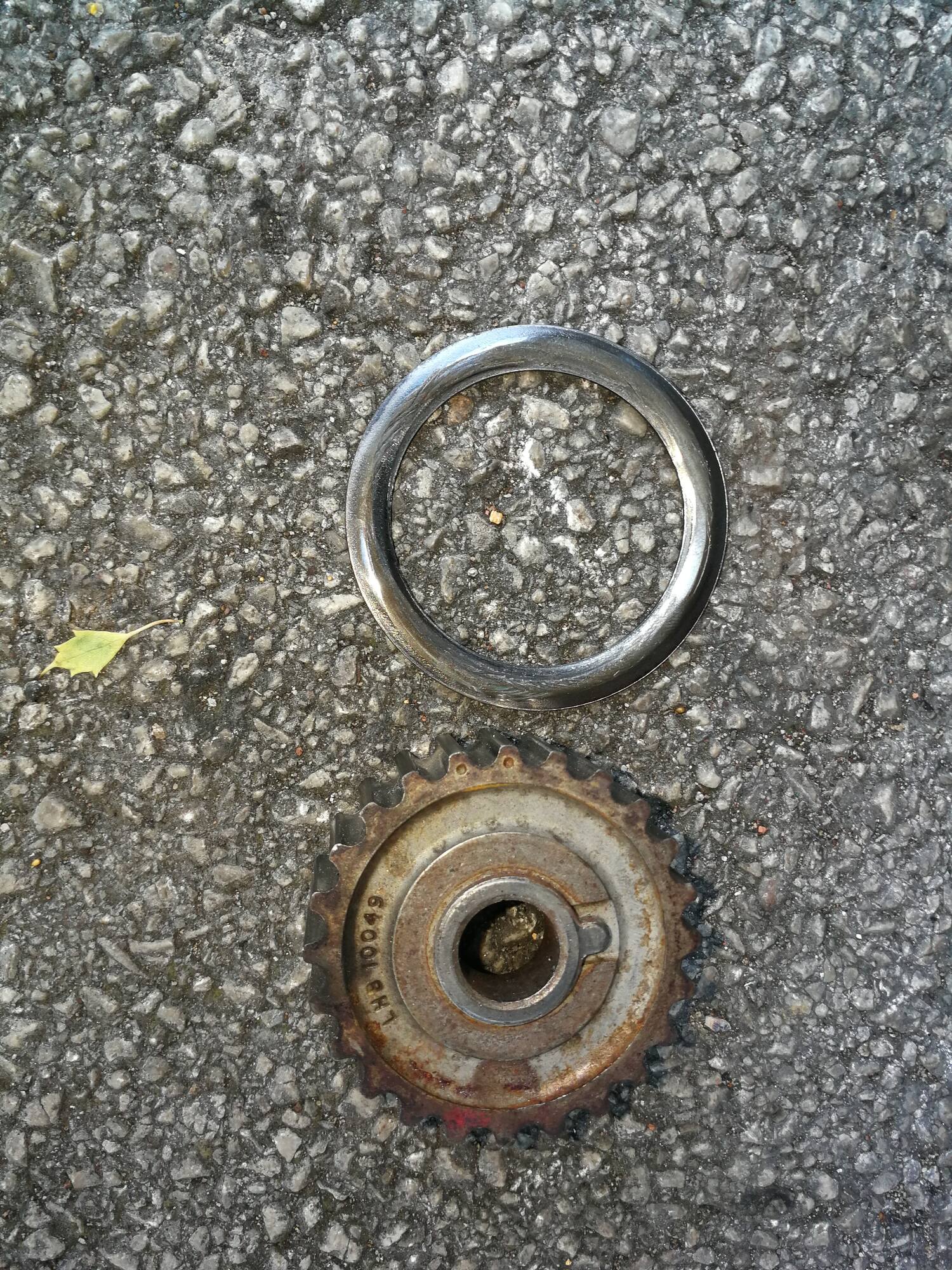

Upon removing the top cover I was presented with metal dust and rubber bits (obvious source of the issues then). It turns out that the deflection guide on the lower sprocket has come off and is rattling about like a mad thing. Also found at this point was excess slack in the front of the timing belt ?

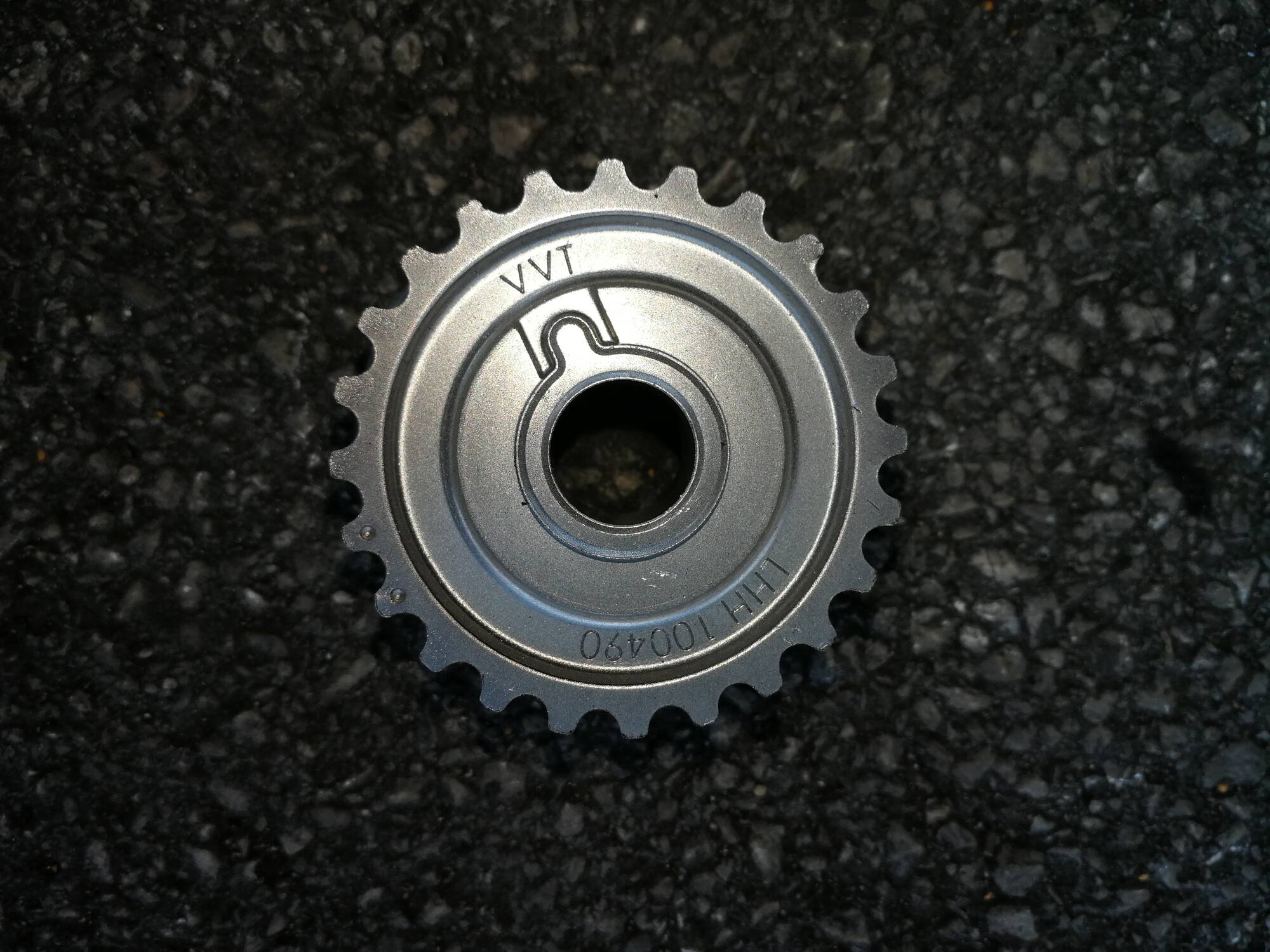

Inside was a genuine rover timing belt (23mm Gates powergrip), an INA tensioner (which is British with a British bearing fitted), camshaft locking tool and a genuine roewe crankshaft sprocket because rover and China! Note* even roewe/Mg/SAiC won't use Chinese bearings because they are that bad!

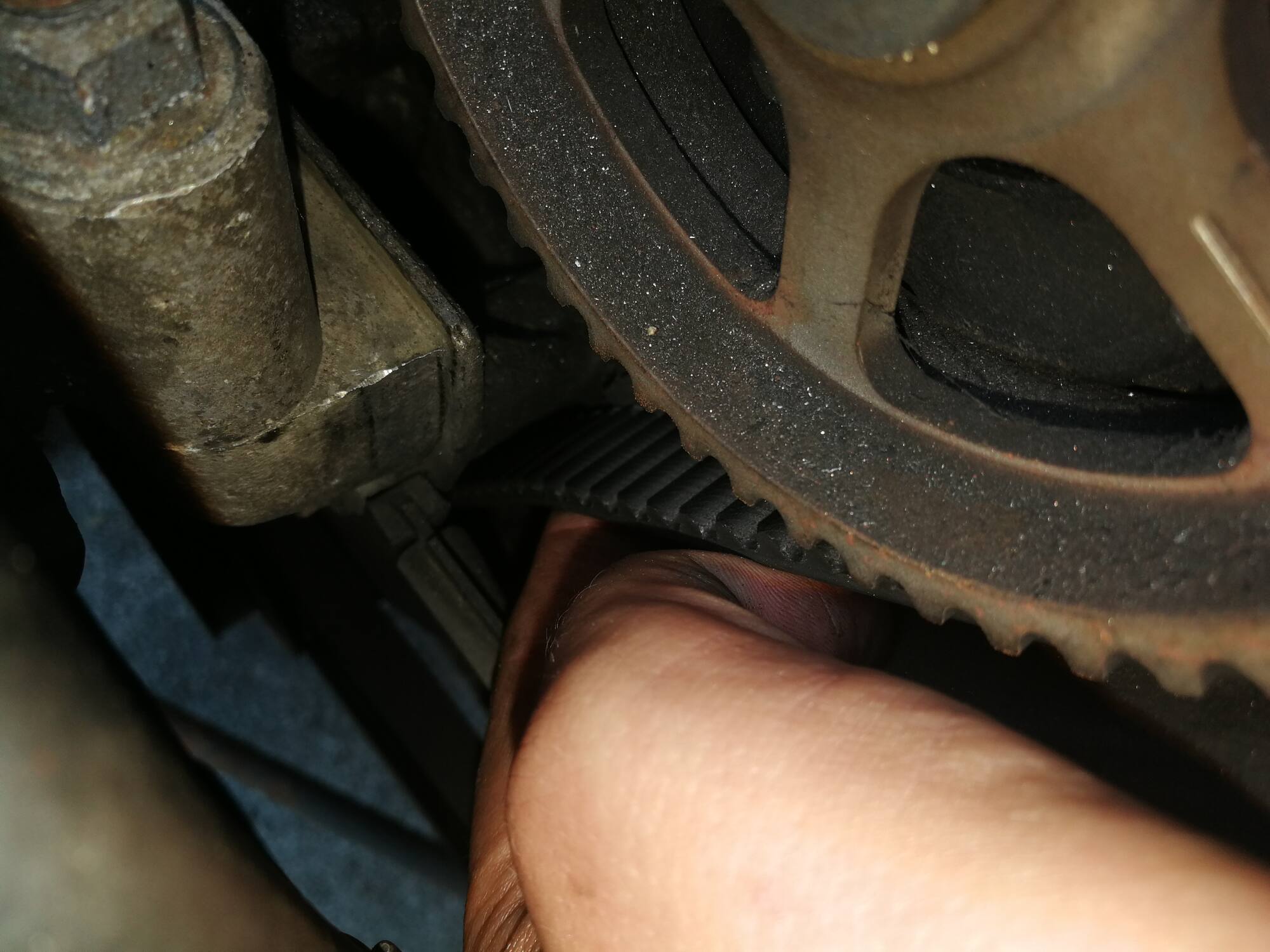

Soo ... Onto the issue at hand. Firstly a very irritating jingle and rattle combined and an engine that vibrated the car anywhere north of 2.5K rpm!IMG_20190722_125552.thumb.jpg.9aad02bac9cbfa4bbb7148478af3bb6e.jpglooks a bit iffy?IMG_20190722_125627.thumb.jpg.4130b23f5f6e0be2850a9d6afa36c28b.jpgThat should be way tighter than that, it was flapping about on the engine mount and timing cover.IMG_20190722_140230.thumb.jpg.35738d17cfdbea9ab2ca8694a098ad50.jpgFairly sure that should be in 1 piece not 2.IMG_20190722_162701.thumb.jpg.8f4cdfc2b15def8663e6fdfe31202b38.jpghmmm, Gates, supposedly British quality ...IMG_20190722_162732.thumb.jpg.d247296ba71aec79c877f50f15084c7c.jpgLIES.... I think not! This tensioner was fitted less than 6k ago and the bearing was as sloppy as the gusset of a lady of the night ?IMG_20190722_140310.thumb.jpg.be1128b80ed7b731d77d1baa61f3066a.jpgIMG_20190722_140318.thumb.jpg.e6f3b6e53c0f5319d149d23110cdb85b.jpgThis is the new crank sprocket (part number stamped on it too)IMG_20190722_125538.thumb.jpg.d2531e2982e2fb6fb115c2c6a81e5634.jpgWhat the top run on the belt looked like!IMG_20190722_154656.thumb.jpg.449f32d7d714589a355661650165b144.jpgAfter 4hours labour in the stupid 34 degree hot here this is how the belt now looks!

Slightly embarrassing that the jingle was that, especially since several people had looked at the things and couldn't find the issue, certainly the belt didn't look that slack last time it was checked.  More annoying still is that we went to a lot of trouble sourcing reputable parts from reliable suppliers so for them to fail so quickly is quite surprising.  I am glad you found the problem now and have managed to sort it out so quickly, here's hoping the new parts are somewhat better quality!
The lack of quality with parts is a gates issue.
They used to only supply top quality pulleys and tensioners with UK made bearings. A couple of years ago they shifted to the cheapest they could find and still label as UK made.
Luckily their belts are still pretty much top quality and I'm glad you fitted one
