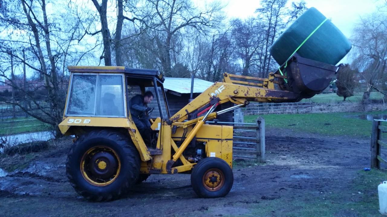

Our Fergie is a great little tractor but we bought it knowing the rear three point link didn't work, there's obviously a hydraulic issue somewhere but solving it means being without the tractor for a while, added to that there's a limit to how useful it would really be, Mrs Spart decided a big loader would be much more useful.
As you can see, compared to our little Fergie, it's huge. It's a Massey Ferguson 50b, from about 1974, it has provision for a backhoe butt I don't know if one has ever been fitted.
The loading gear works smoothly as it should and it's pretty easy to control, the only bugbear so far is the poor traction, I think due to the lack of weight at the back.
