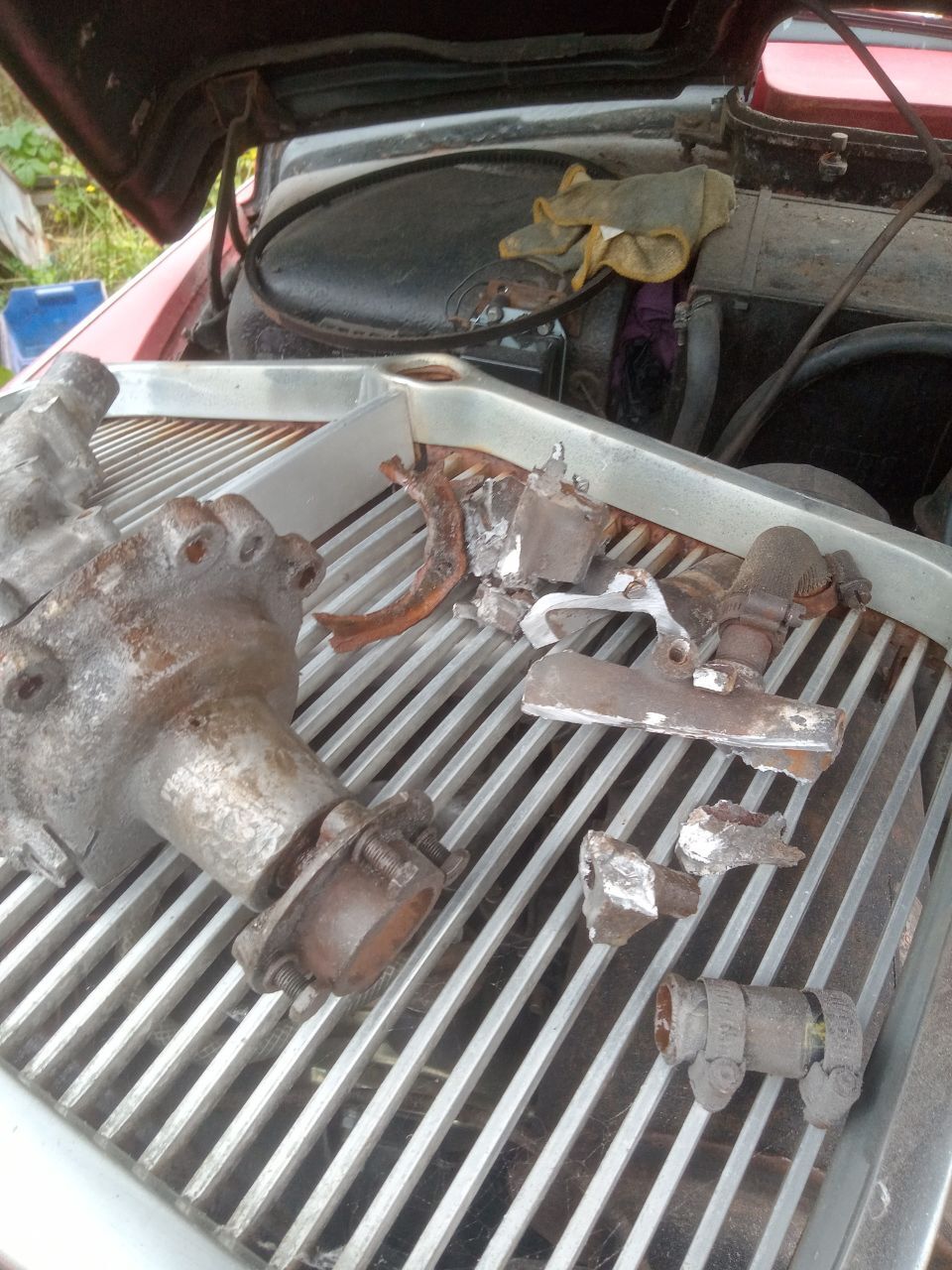

Well, well...
Today is the first day of a week-and-a-half off for me...  So I approached the Rover's water pump, battle ready.
I promise I have tried my hardest to get this thing off with conventional methods... to no avail.  Still, I felt like I was about to anger the mechanical gods, by committing the cardinal sin of cutting up a very rare part...
Anyway, fortune favours the brave they say, so the cutting commenced...
I know, brutal.
And finally...
Very stressful, but the pump is off and the block is undamaged.  I sort of cut around each bolt as much as possible, and then chiselled the weakened lump of ally casting away from them.  Eventually, I could see the pump starting to let go of the block, and off she came.
This revealed the cause of the noisy running, and the roughness I could feel when spinning the pump shaft by hand...
Yes, the impeller has sheared off the shaft basically, no pumping at all.  It's obviously been like this for some time too, the break edges are old-looking, and the wee waterway just above the pump (exiting the cylinder head!) was totally blocked with crud...
This did not seem to bother the old lady in the slightest, but I guess it would have done so eventually!
So yeah, a stressful removal procedure for us both, I'm sooooooo glad it's off...
It then started to rain, so all I've done since is flush the block and head out.  A LOT of rusty sludge has been ejected into the local water table, but all is clean and clear now.
I have the broken studs to tackle next, but my neighbour has kindly lent me what looks like an effective tool.  I will be going carefully, I'd like to avoid drilling and retapping the block if at all possible.
Then I can fit up the 'new' pump, all my new hoses and refill with the fancy Bluecol coolant, for many trouble-free years motoring!
Cheers all.
