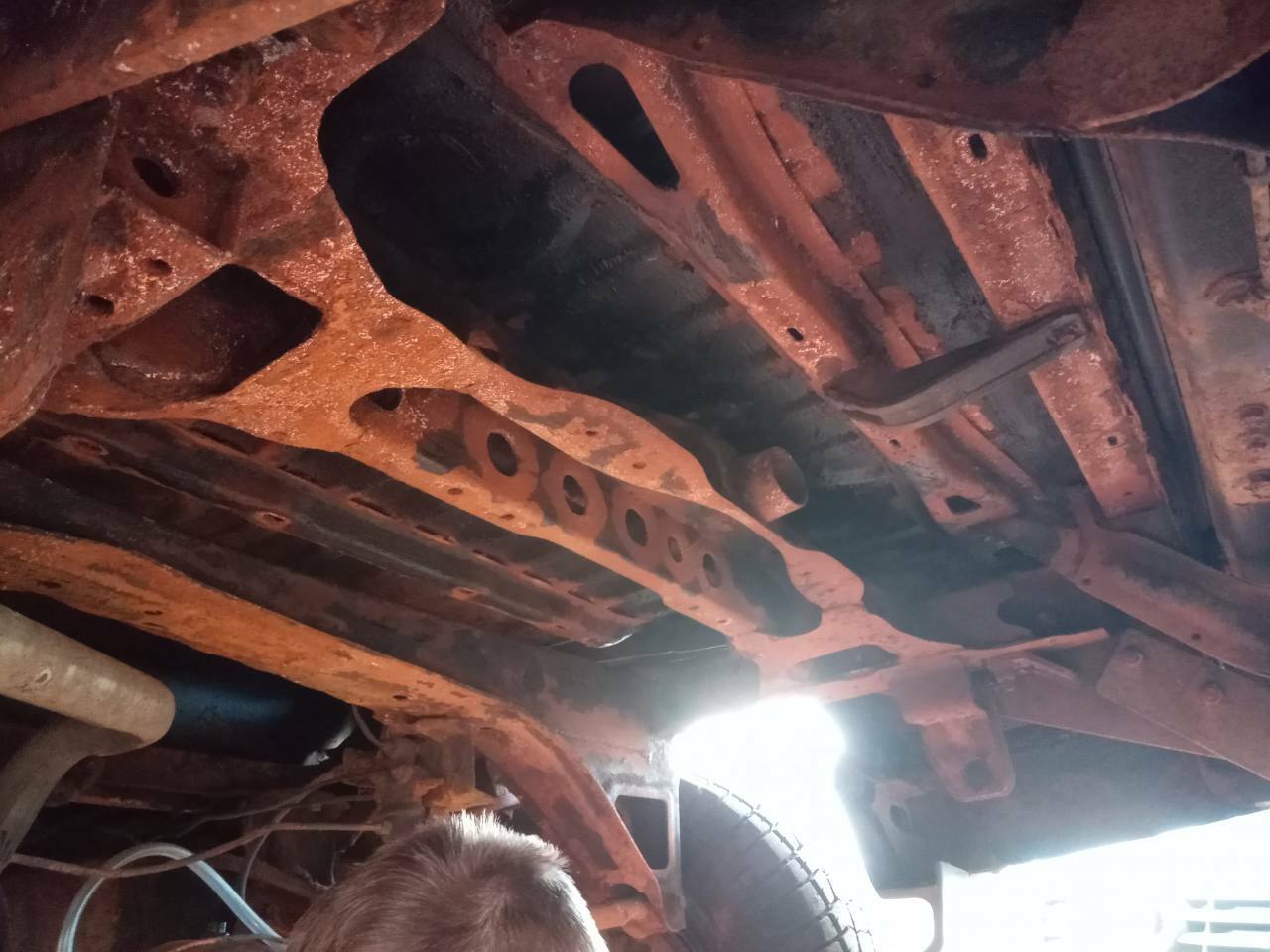

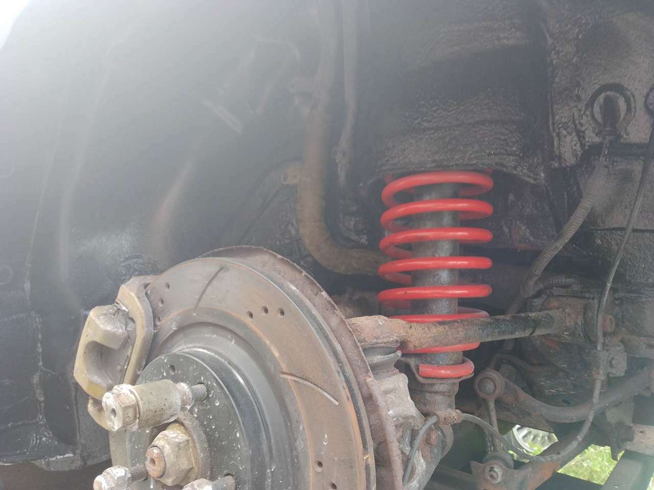

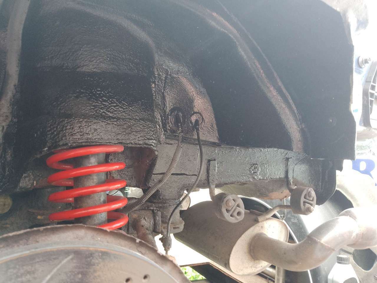

We then set to the re-oiling of the underside.  Not a nice job, but kind of vital in this neck of the woods.  My youngest and I spent the day blinking out/spitting out rust, but got the bottom wirebrushed nicely...
It was nowhere near as bad a job as the big de-rust a couple of years ago (documented on this very thread), but still took the two of us a good few hours.
Cooked up an oily brew this morning, and am just back in...
Much better.  It's a very oily mix this time, probably one litre of waxoyl to two of used engine and gearbox oil.  It stinks, but creeps well if applied hot, and never dries out.  I'll have to do it every summer from now on, not leave it too long.
Interior still looking good on its years too...
Just the sills/bumpers to paint up, then she can battle through another salty Moray winter.

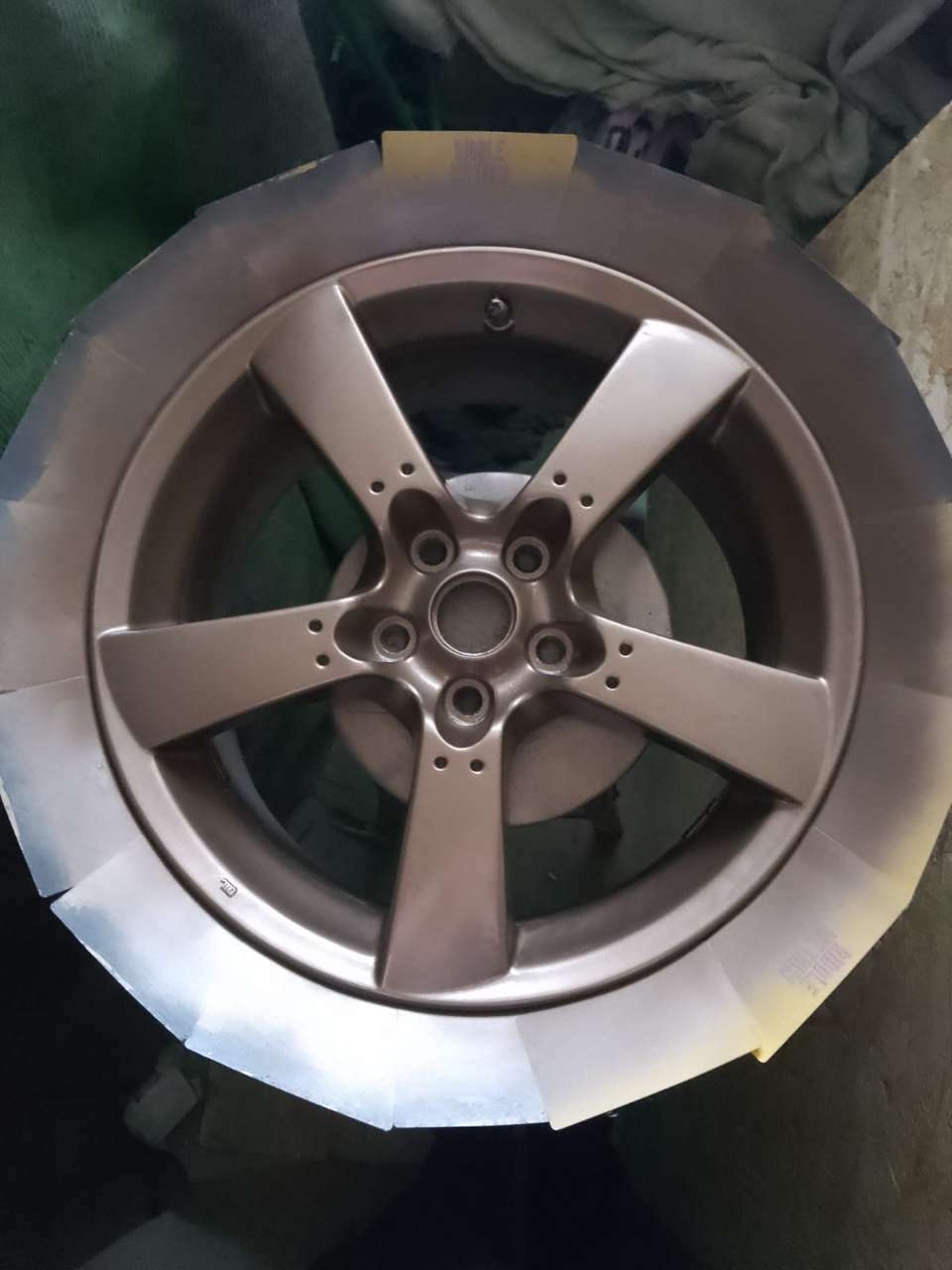

Junior is prepping the wheels for paint, going for gold again (I want to keep the gold stripe down the side too).  I'm in no rush with this one though, as long as I can hit the NC500 in it next summer I'll be happy!

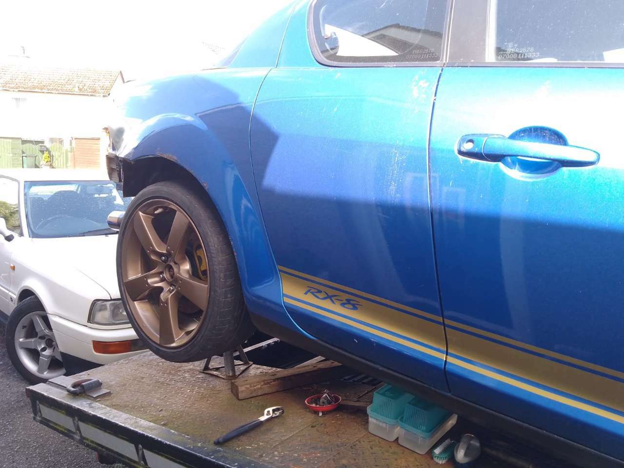

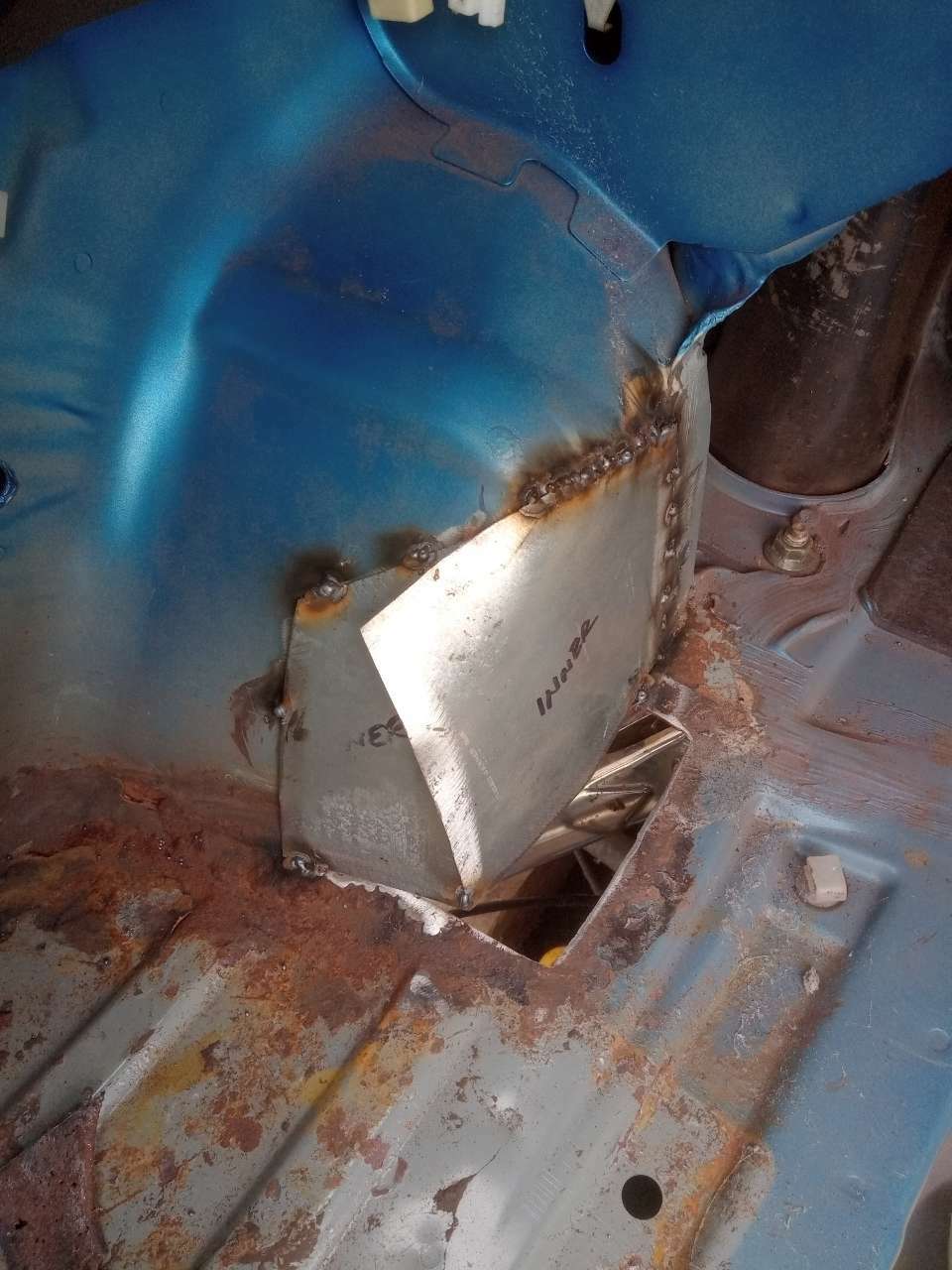

Actual progress on the RX8!

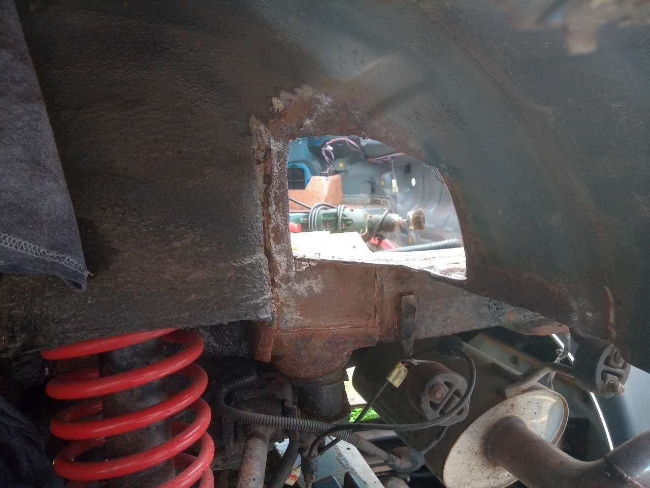

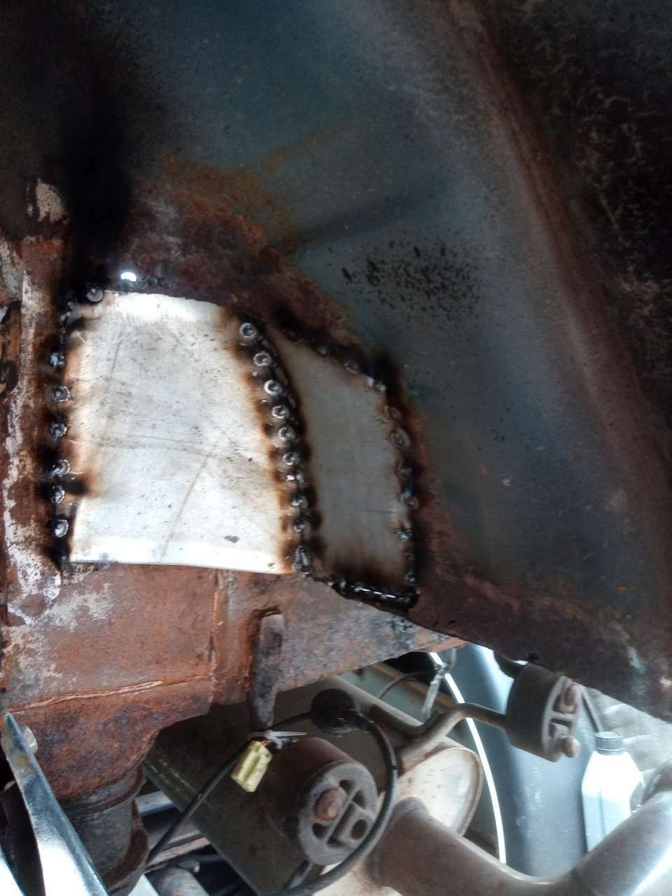

Hello all, blessed with wall to wall sunshine as we are this week, I decided to get welding today, and have completed one side of the boot floor/wheel arch repairs...
Not pretty, but by god it's thin stuff...  lowered my expectations a wee bit, as I just want the thing going now!
Vactan helps...

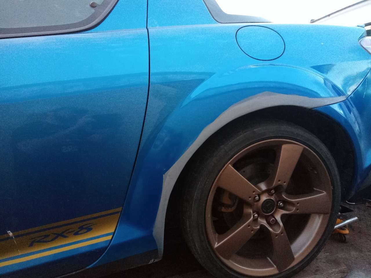

Even had a go at the wheel arch lip, so after I get it oiled up in the wheel well tomorrow that's a whole corner done at least...
Inching closer to terrorising the Highlands!
About your Trabbie exhaust - I don't know if it can be dismantled the same way, but the old CZ owner's manual used to describe taking the silencer apart, to (paraphrasing, cos I can't remember the exact words) take it out to the back yard, douse it in petrol and set light to it!
If I remember correctly, I have heard of this on old 2 stroke Saabs too?
I believe so, it would've been common practice probably in the past, given that the gunk in a stroker exhaust is half dried out oil. Burn it up, and it cracks off easily in chunks. Caustic soda dissolves it, so it can be scraped off, but either way works.
Come to think of it, oven cleaner out of a pound shop is probably cheaper than a half litre of petrol these days, so it might make economic sense!
T'other side...
Big 'oles in RX8's used to worry me, but no more!  The wet rag hanging to the side is my fire blanket, covering the fuel intake pipe.

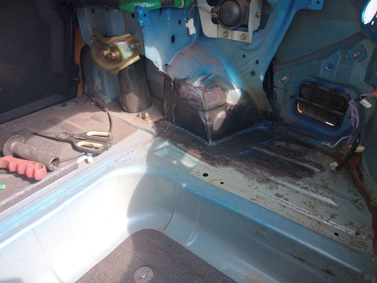

Decided on a different tack this time, after seeing how the card templates curved into shape...
Left one piece long on purpose, so I could get a nice join between the two bits...
Before tacking it on the outside and cutting off the excess in the boot...
A wee bit was then cut to replace a bit of floor.  Again, not pretty, but nice and solid.  I'm sure it'll look ok after a dressing with the flap wheel and some sort of paint covering.  The wooden blocks are used to deflect the grinder sparks, I'm paranoid about them setting light to the back seat foam.

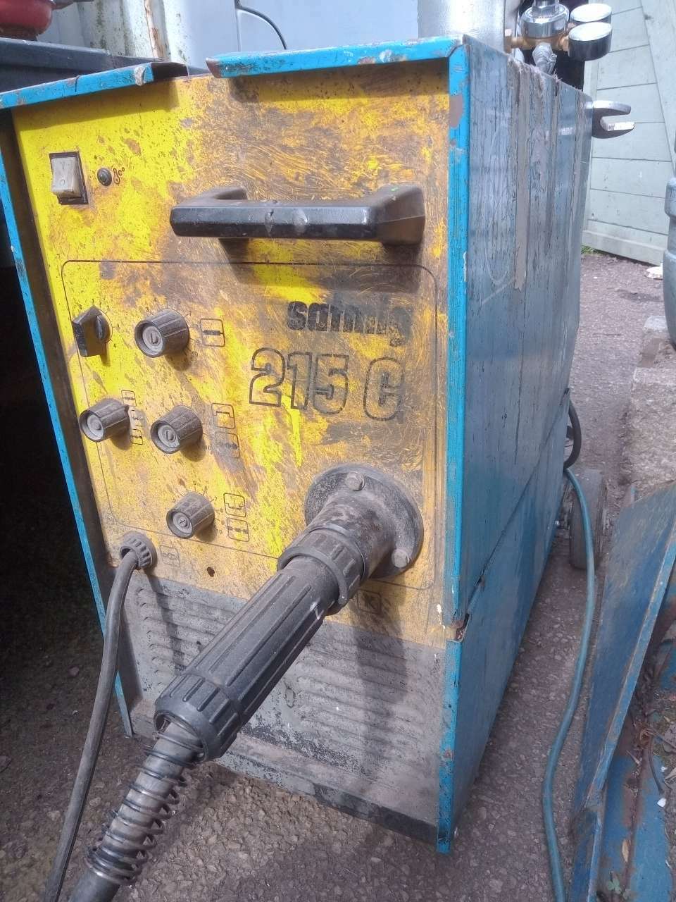

Here's a pic of the welder I bought a few years back.  I can't remember it's specs now, but I remember thinking it was the best power range and duty cycle I'd seen on 240v.
It's a SAF mig, French I think, and is operating on its lowest settings for both current and wire speed in order to not blow holes in the Maz (I still manage the odd one!).  I bought it from a chap who's son was selling up a failed garage business in Aberdeen, for £450.  Seemed expensive, but puts down beautiful smooth welds on thicker stuff, and to be fair, I'm the weakest link on this project I think!
Tomorrow then should see some vactan/waxoyl application, and maybe even the back end rebuilt.  I've cleaned up the crash bar and back bumper, it'll be good to see it look like a car again!

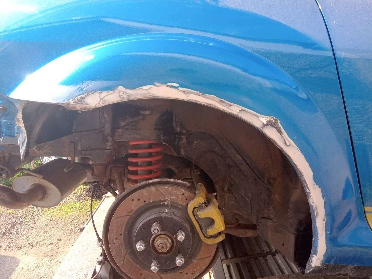

'Sorted' the wheel arch lip on this side too, they're pretty filler heavy tbh, and will need actually fixing one day!  The plan is to see how the car goes this summer, just enjoy it, and see if it warrants the full job after that.
After a lot of wire brushing/wheeling, vactanning and oiling, it's really good to see the rear reassembled.
