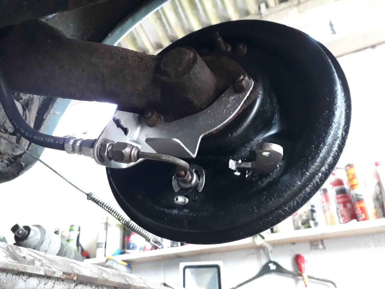

Sunday i finally decided to chuck the little blue nugget on the lift.  stripped the brakes down, painted the back plates and handbrake brackets.  Once dried fitted them back on and went to get the wheel cylinders fitted.  They looked like mini ones with the stupid e clip. However The roll pin was in a different place, that would be because they arent mini. The roll pins in a different location for larger bore cylinders it seems.  And the rears on this are the same as an MGB. Ordered in same day at work handily.
One cylinder was seized solid and the handbrake mech was stuck hard. Which would explain the handbrakes lack of hold.
I clamped the wheel cylinders with g clamps to get then bled up nicely prior to fitting the shoes.
This morning i also stripped and greased the adjuster. Freed up the handbrake mech, and stuck it back together.
New rear flexi lines, I reused some of the hardlines that looked okay. Ill make some new ones sometime but for now id rather just get the wee blue shite on the road as its been far too long.
Whatever this is, it also got the thick shultz scraped off it, wire wheeled and some silver splashed on..
Handbrake cable adjusters backed off, cable connected up then adjusted back up. A quick chooch of wax seal over it all for a bit of protection.
Tomorrow ill tweak all the wheel bearings back up and put new split pins in and i think we call that done for now. Just want to get some miles under its belt and tinker on something else..
Expand
Rear brake proportioning valve. Limits the amount of brake fluid going to the rear so under heavy braking you don't get the rears locking up before the front.

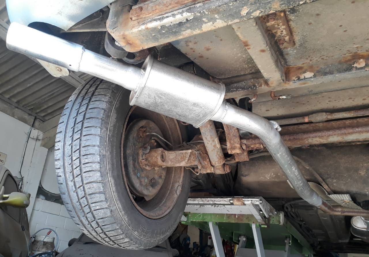

The red wagon of @Mrs6C went on the lift and recieved a full exhaust. While the box was out the way a lashing of underseal was splashed around the crusty bits.  I dont like this stuff but as said before, it has its place.
 exhausted.
