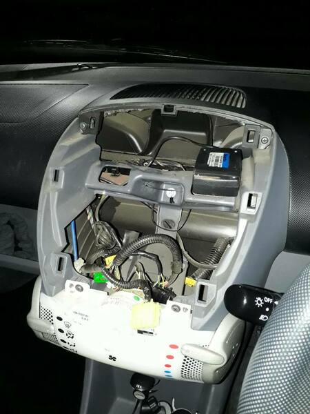

The pug has an aux input on the front of the headunit, handy as i hate listening to the radio, crappy as you have a jack lead dangling down infront of the heater controls etc etc.
1 screw behind the fan speed knob removed and then the panel pulls off. 7 clips and one screw in total, i wanted to put a hole into the panel and it was exactly where one of the clips was so that was removed. A wee hole and grommet then took its place and the cable feed through the hole the clip used to slot into. With the panel out i could drill a hole from above for the other end of the cable.
Found a tracker too! That was binned.
Back in
Other end comes out in the little cubby underneath out the way. Not dangling infront of the heater etc etc, its cheap and Works for me.

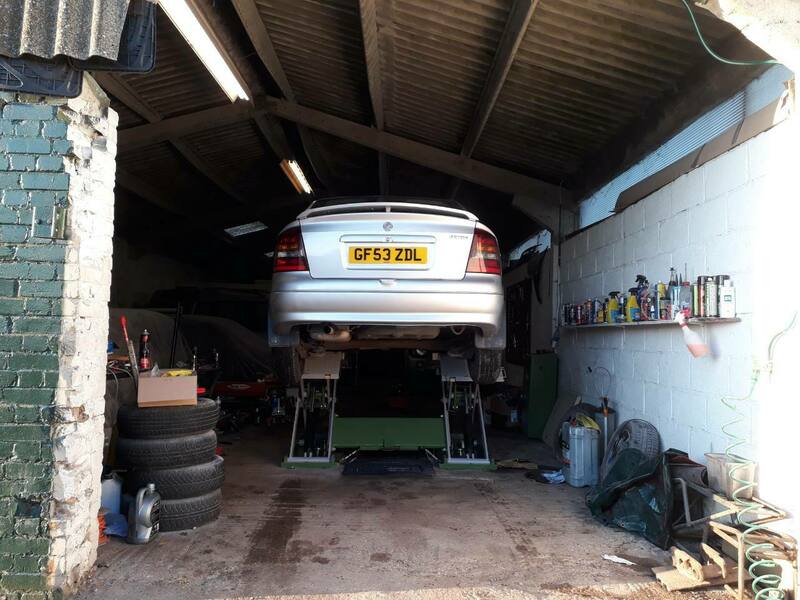

Right then, safrane and silver Astra,
Shuffle time
Jimny out filler dust covered safrane out followed by silver astra out, quick wash, safrane in , jimny back in Astra in and on the lift.
And back in.

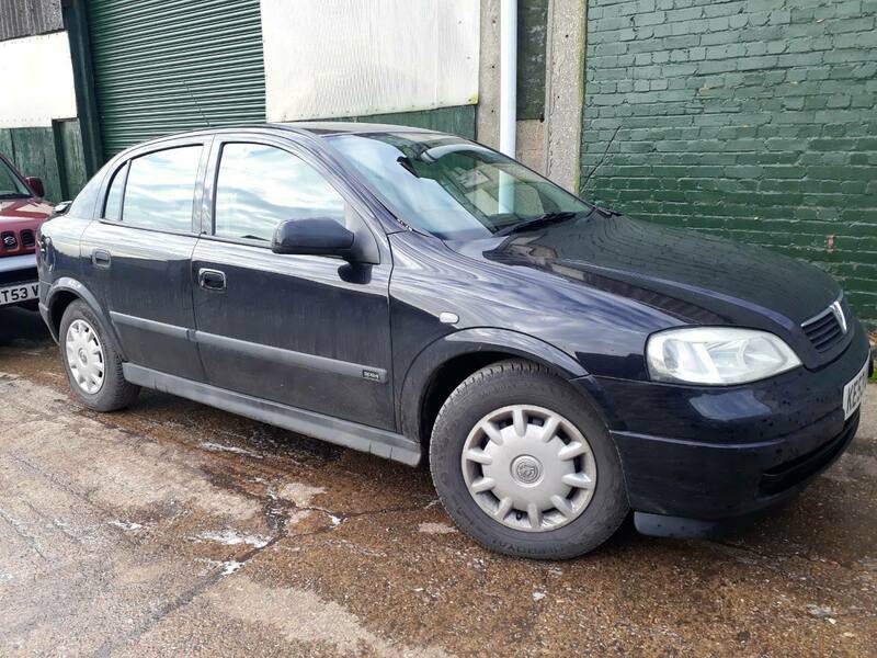

I was driving this untill the black Astra came up for sale and i swapped insurance to get that home and the idea was for my other half to try an Astra. This was an instant no go, to big and poor visability is seems.  So ive just been running the Black Astra around and its been cracking with around 6-7k since purchasing no issues, It is however a 130k mile car and the suspension is getting a bit loosey goosey.
Way back in this thread we can see id spent a good chuck of time and money on putting all new stuff on the silver car and to me it makes more sense to swapped back to that and park the black car up for future use.
While the silver car drives better, the engine pulls better and ive got more memories with it. It sadly has one big issue.

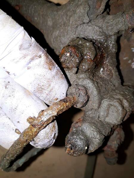

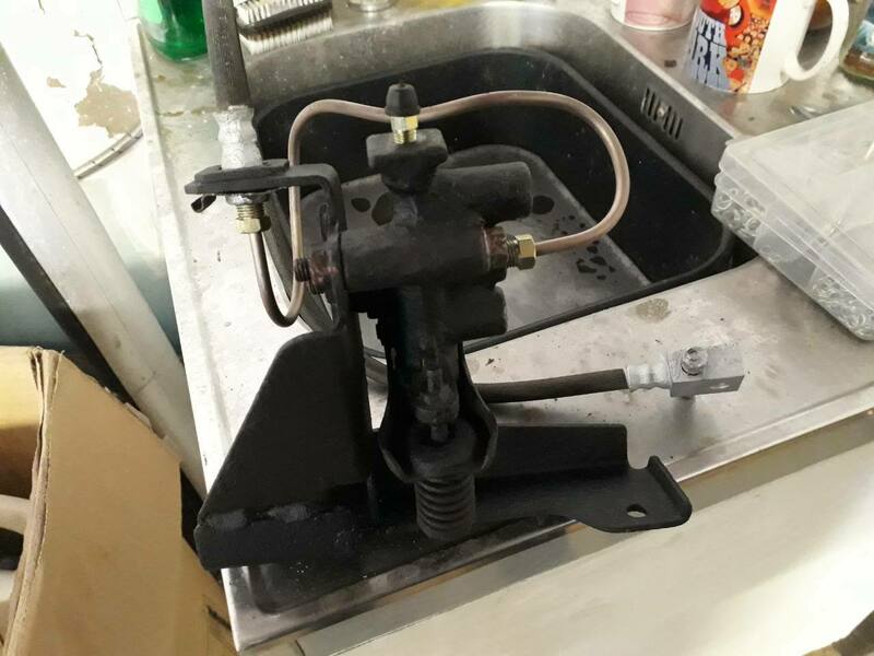

The brake line to the load valve at the rear has completely dissolved. Spraying downwards onto the drum backing plate and a bit of the axle tube.
Its the pipe that goes all the way to the front, and its been undersealed over in the past.
Ill change both pipes as im there and sure the other will be just as shagged.

The leak then, tucked up behind the spare wheel is the load valve and the pipe had rotted out near the union. Id contemplated purchasing another flare tool so i could just join the repair section to the 90% good line but the access was awkward and the biggest issue is that its been schutz'd in the past. I may have mentioned in the past but
I FUCKING HATE SCHUTZ!
It just drys out,  cracks and fucks everything. Horrible stuff. So i busted out the impact gun and removed the unit. Thankfully the bolts came out. I undone the flexi line to the axle from the axle end, and just cut the lines near the unions. With those cut and the unit down it revealed the little line was also fairly gone.
Crusty!

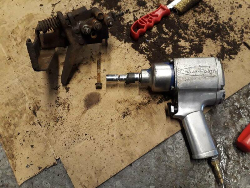

With the unions wire brushed and  each one given a few firm wacks i then tapped on a good six sided socket and just went straight for the impact gun which thankfully rattled the buggers out.
Given the load valves location it has a bleed nipple on it. I ponder for a moment , Do i risk it? Will the air just come out like id hope if i leave it?
Ah fuck it, ugger dugger time!
Stupid face pulled, but sucess!
I decided id get the valve off and give everything a clean up. Battery impact was a bit low so out came the big boy air gun, with the half inch impact socket being to thick walled to get on the bolt head i opted for a 1/2 to 3/8 step down with a 3/8 to 1/4 for the socket!
Many rattles and some forwards and backwards turns got the bolts out.
Needle scaled and wire brushed. Both bits recieved some black stonechip and left to dry on the proffesional paint drying rack.
While they dried That was it for the mazda today.

Load valve thingy put back together.
Fitted back on the truck, was seal sprayed on area before it was bolted up. Copperslip used on all bolts.
Front to rear lines all fitted up. Would have liked to make the lines neater but meh.

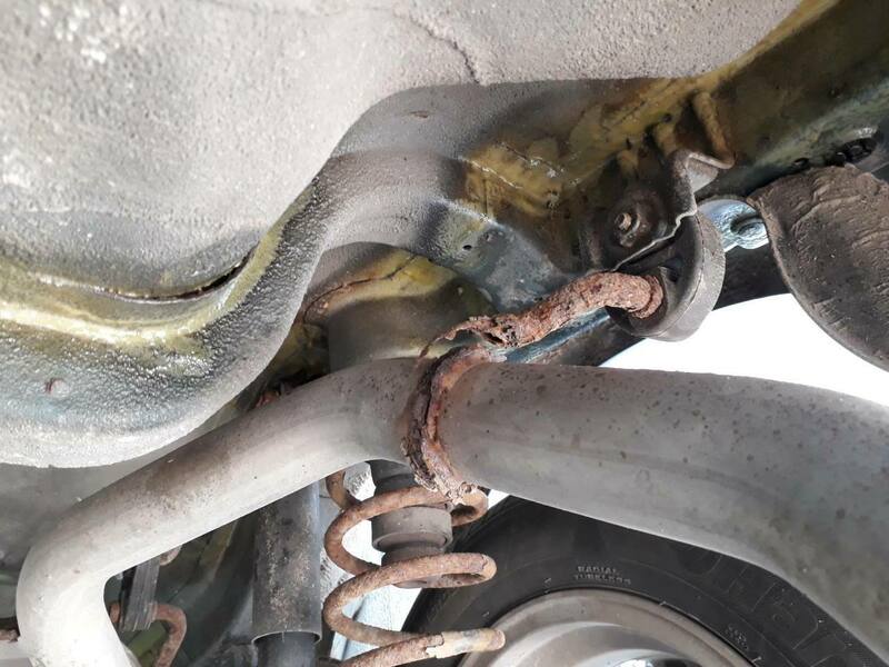

The main issue for today was to look at the exhaust hanger that had seen better days.
Im Not paying out for another exhaust just for this wee bracket. This meant im needed a new hanger.
Remember the damaged exhaust from one of the knackered corsas we replaced?  Choppy choppy!
Zappy zappy, grindy grindy.
Chucked back on. Sorted.
