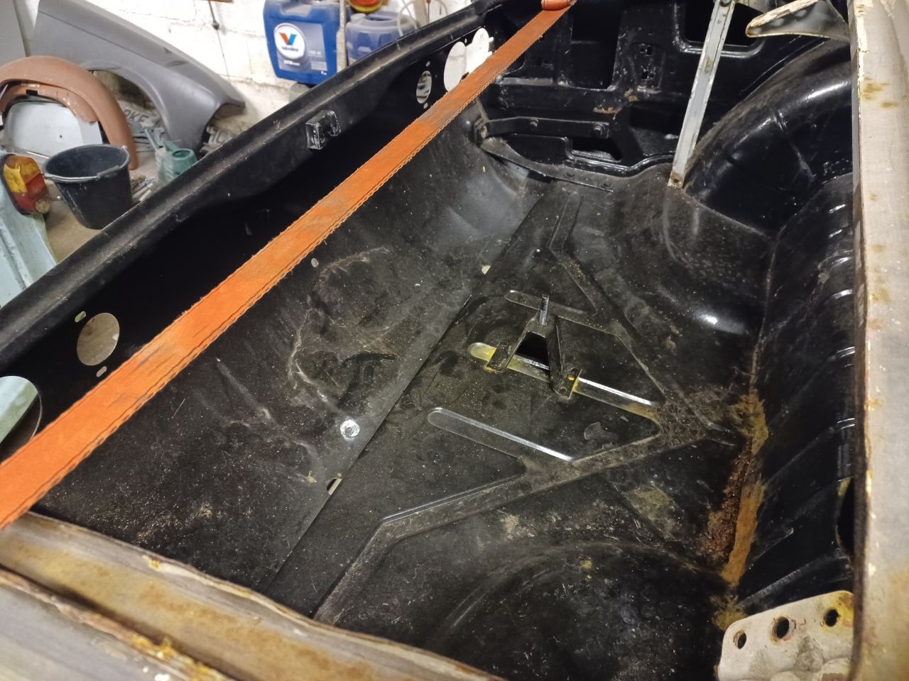

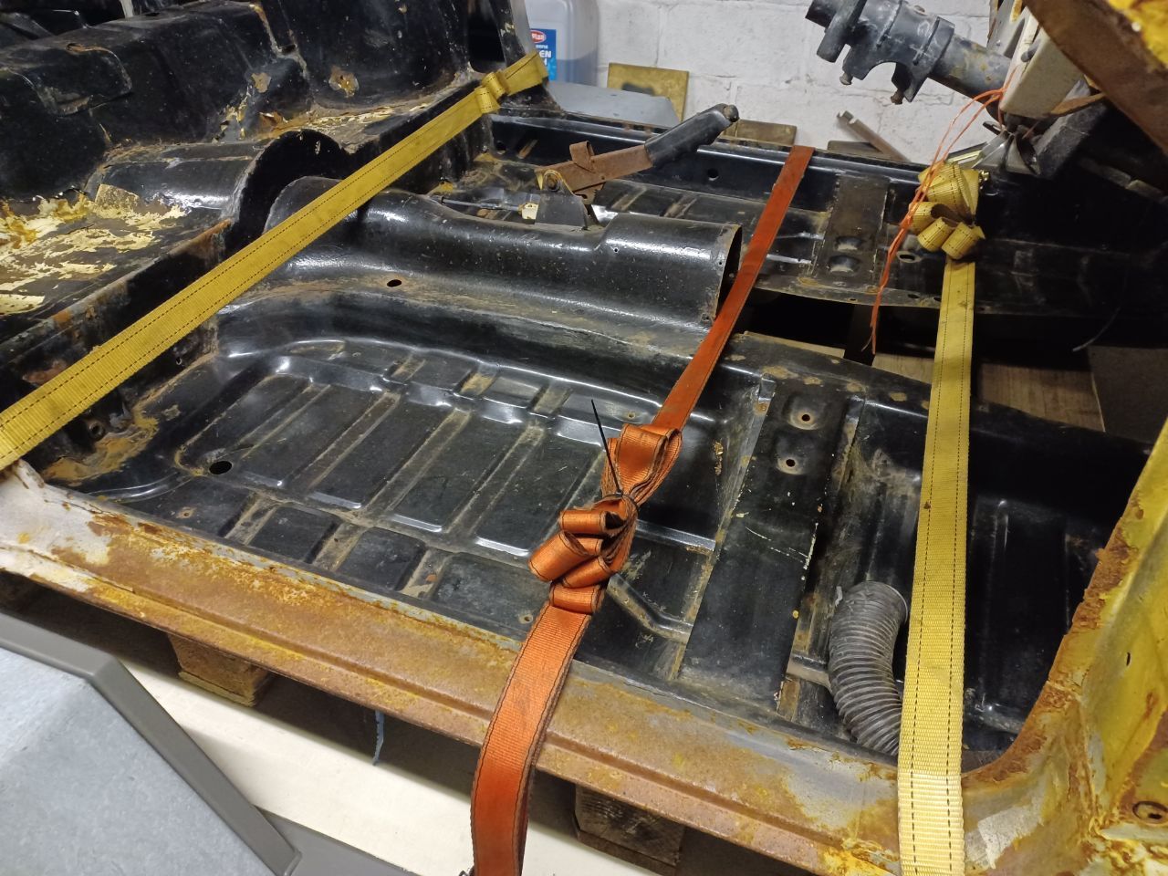

What did £525 and 380 miles get me then.
It's better than mine,  not as good as I'd hoped but a better starting point. I'm looking at it value as a job lot of panels rather that as a whole. As most of the panels fitted I needed to buy or repair on my tweaked shell.
It's had complete inner and outer sills x2 , floorpans x2 , seat box x2, boot floor, rear valance, and rear light panel, front side bulkhead panels.
To buy this lot now is roughly £1550, so while its got a few wanky repairs im happy its workable. I may chop the quarters off and get it blasted if the price is right.

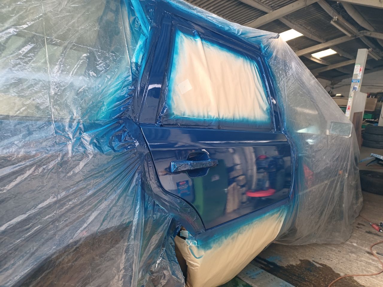

Rear door wet sanded, not perfect but it's a big improvement over what was there before.
Black sealant trick for the rear windows too as it's suspected they are letting water in
It used to leak via the antenna hole, I replaced the gasket (I may have replaced the whole thing but think that was a different car)...
Left out in rain confirms this wasn't the leak, looks like it may be the trim corner rather than the glass corner. More sealant at the ready. Now moved inside to dry.

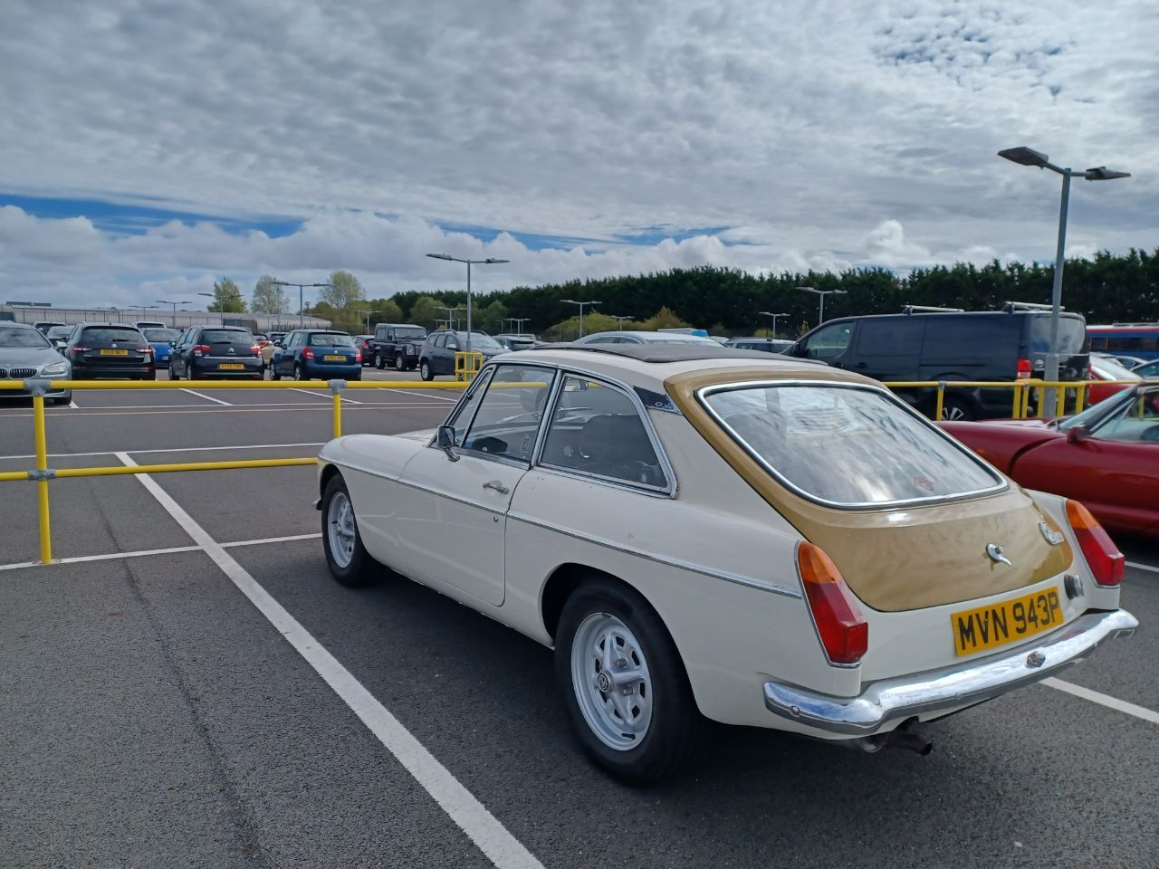

1000 mile review
This afternoon after un seizing the handbrake cable I took the B for a bit of a blast and we passed the thousand mile mark since returning to the road.
I like old tat and bringing old shite back around , but the main reason for buying the B was to see why these are so popular. So how have the miles been?
I get it now, the B is a really easy classic to have. Big parts availability both new and used, keeps up with modern traffic just fine. The gearbox has a nice shift to it and the brakes are pretty decent.
The engines a bit of a rattly old thing and the steering is quite heavy (not helped by the small steering wheel fitted in mine) but you get used to it.
Plus it looks good scruffy and dirty
I think its Time for an adventure little B
