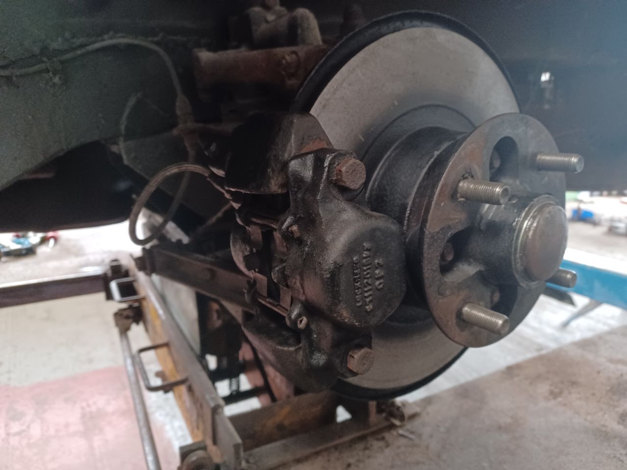

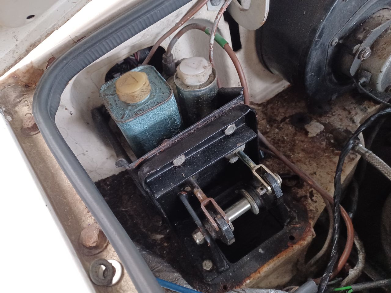

With the B seemingly running okay, after it was parked for the night I returned to find zero brakes. Now some may recall the master was stuck when I purchased the car, I managed to get brakes for test purposes by freeing things up with intention to replace at a later stage.
Then both wheel cylinders had let go also while parked a few weeks ago and have already been replaced with 2 new units and some uncontaminated but partially used shoes donated in a unneeded parts bundle a while  back by @SiC
The latest brake loss then, I assume was the seals in the master letting go, the bore wasn't very good inside and i knew it wanted work before hitting the road.  New master ordered and while we are here let's rebuild the Calipers with new pistons too. More decent used pads, and fitting kit from the SiC bundle went on too. I know second hand used brake parts, quality eh?
Discs also hit with the 80 grit on the sander.
Blue tin in the bin
Plastic fantastic!
Brake bleeding commenced and pedal seems good, will grab a second pair of feet to do another bleed just to be sure.

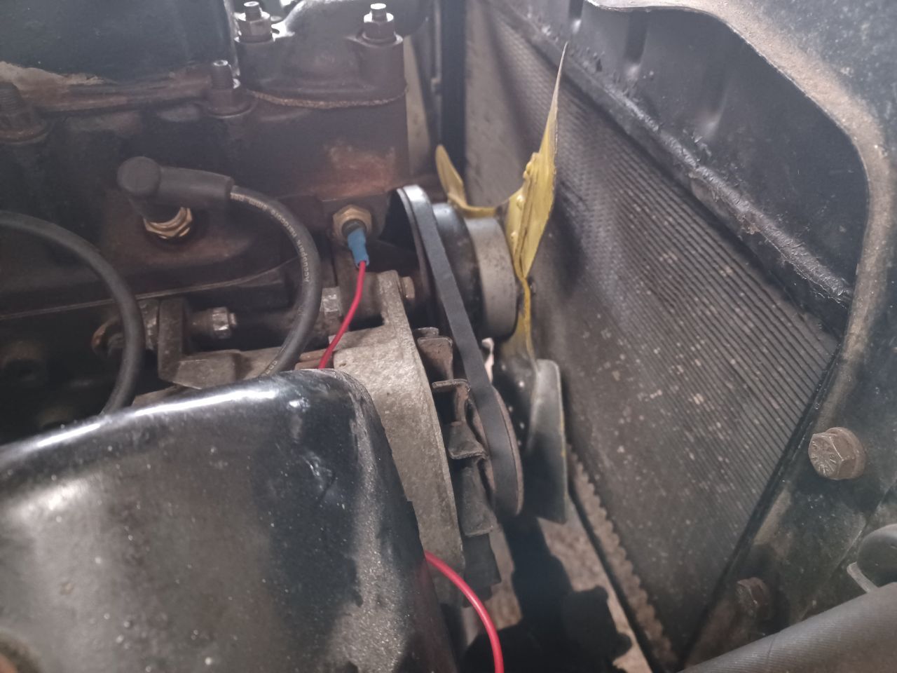

With the rad being replaced with a non sensor rad I wanted to opt back to a mechanical fan, but a new big plastic fan plus needing to get the spacer and bolts was going to set back about 70 quid,
Handily the supplier MGB hive that I've been getting my bits from (who have been great to deal with and very well priced) also sell used on ebay and had a fan  with spacer and bolts for 35 quid, Bargain.
Let's get it fitted up then
*lots of sharp things and swearing while peeking through a slot between the rad and support later*
narp don't fit. So it seems the water pump pulley PCD is different depending on year. Luckily the water pump on the car is drilled for both types. With the spacer and pulley centred on a suitable sized socket I redrilled the pulley and fitted everything up.
Finger fucker fan fitted

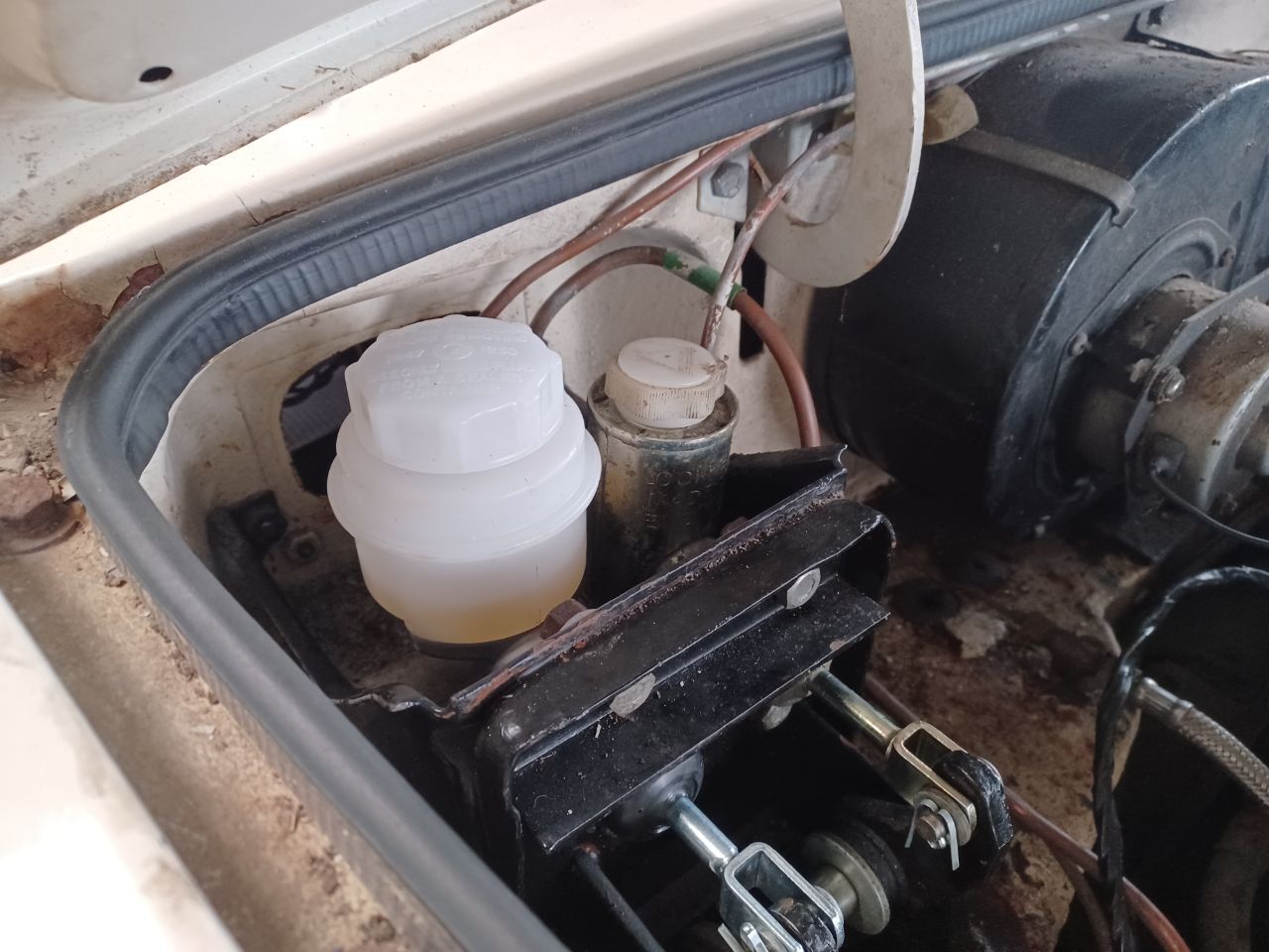

Well where did you go Mr brake fluid?
After a few days away at the 2cv racing, which ended with a wrecked car but most importantly an okay driver.
i returned to the workshop and first thing I checked was a pedal. It was doing things but sounded a bit odd. Checking the fluid reservoir revealed it was almost empty. I lift the car up and check the brakes to find the leak, none to be found, not even a weep which is a relief but also a concern.
This can only mean one thing, sure enough I pop the vacuum port off the servo and out pours all the fluid.
I'd suspected this servo previously when the bellows of smoke first occurred. But with it disconnected from the engine the symptom continued. I had popped the port out and looked at the hose and all had been dry previously.
I hop on ebay and chuck a bid on a cheap one ending soon and reasonably local, only after I bid do I notice the seller is away, tits.
Its an additional remote servo thats either after market or possibly factory fit. For now then we have gone back to no servo. I pinched a T piece off a suzuki and plumbed it in.

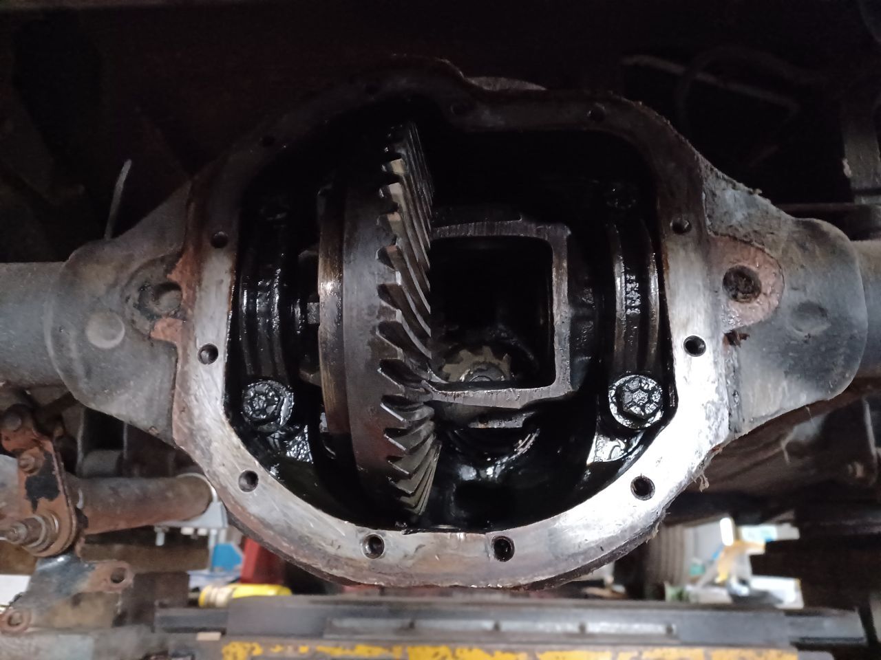

What  remained of the  Rear diff oil drained out too,  there's alot of slack in the diff which  appears to be a thing when the thrust washers are worn out.  This will be addressed soon but for now I've just replaced the oil and will get s repair kit on order.

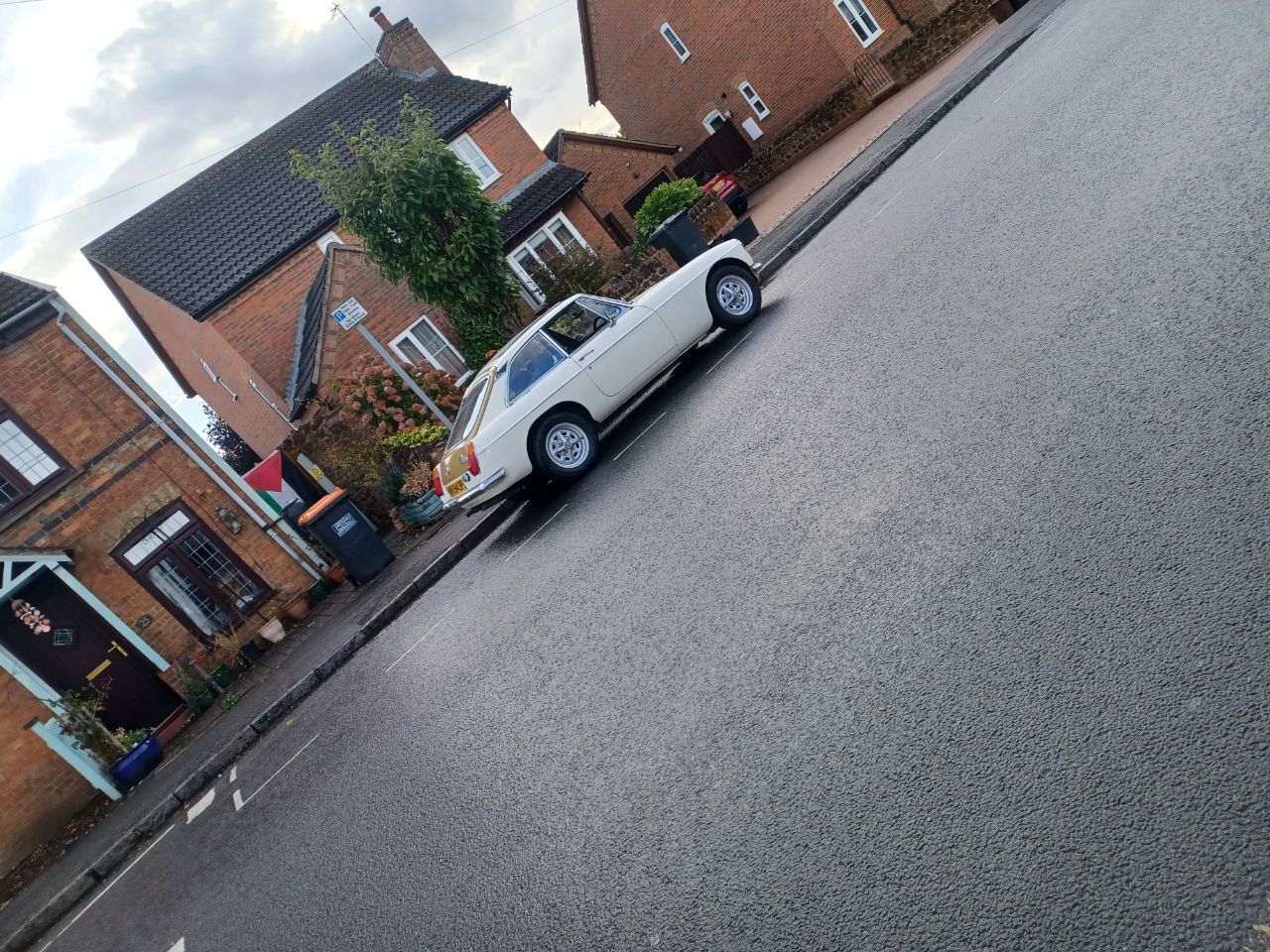

the cars now insured, can we make it to rustival?
  • Andyrew changed the title to Andy's awful autos: OMGB! RUSTIVAL DEADLINE
  • Andyrew changed the title to Andy's awful autos: OMGB! Hits the road!

On the road baby!
Seems ambitious 😀
