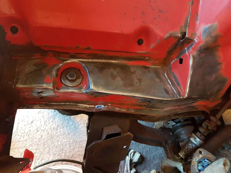

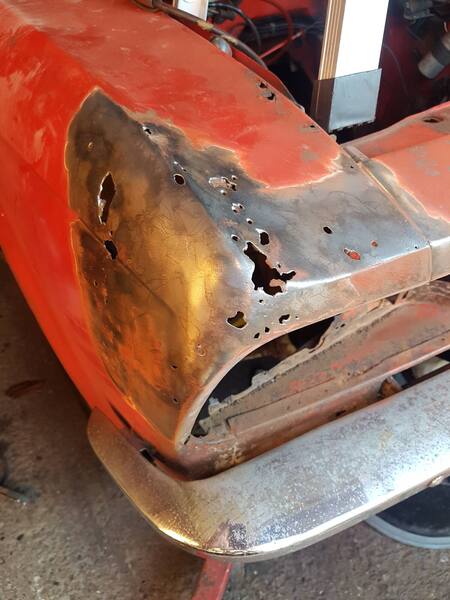

Started to take the paint and crud off the inner wing and top of the chassis rail. It's all looking rather solid so far. The front of the wing is holed in several places, nothing horrible though.
It's a start!!
If the underneath bit is as good I will be a very, very happy bunny.

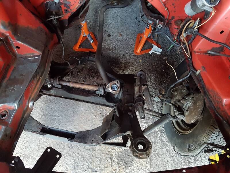

I summoned the electric file and wielded it against the Rusty Subframe Nut (as it was the only thing I could use to grind it down). 20 minutes and 3 power file belts later....... it's sorted.
I drifted it out and now all that is officially holding the subframe in place is the 3 other bolts (all loosened off) and the copper brake lines to each front brake.  I'll tackle those on Sunday.
I can then take all the usable bits off and scrap the original subframe. I can then crack on with cleaning up and painting the chassis rails.

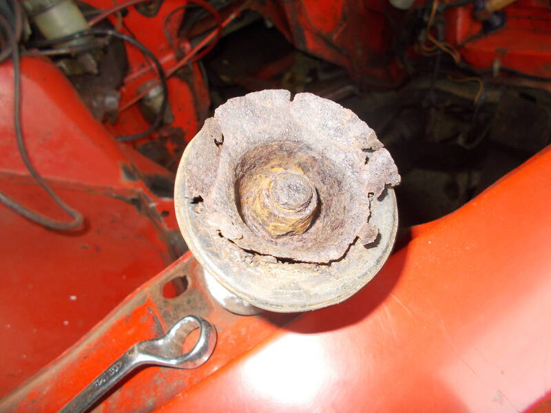

That wasn't going to undo in the normal way whatsoever.  Not much left of the cup washer at all.
Technical term: rusty as fuck.
Hopefully the other 3 bolts might be in better condition.

I scrubbed the areas around the 3 remaining subframe bolts so the socket has a better chance of gripping and secondly, I can see what I am doing a little easier.

Whilst I figure out how to get the subframe out safely I decided to undo some more things.
The brake pipe sadly snapped but it was also rusty as fuck and best replaced anyway.
The subframe is really, really, really rusty.
The drivers side wheel arch is covered in surface rust, there is one small patch required, the rest is pinhole stuff.
It's actually pretty bloody good in there and once the subframe is out access will be superb.

Plan: undo the steering knuckle, work out how to drop the subframe whilst still retaining a full set of limbs/fingers/flesh.
Oh, also retaining a full level of consciousness (although I find this attribute to be slightly over-rated anyway).
Wish me luck. WCPGW.

The subframe has now vacated the Toledo :)
Delayed due to a stubborn shock absorber lower nut and bolt being rusty.
Had a better look around the underneath bits, the N/S chassis leg will need a small repair but other than that, I'm pleased :)
Now to crack on removing the surface rust, rust killing and painting with POR15.
Body colour paint will then be applied.

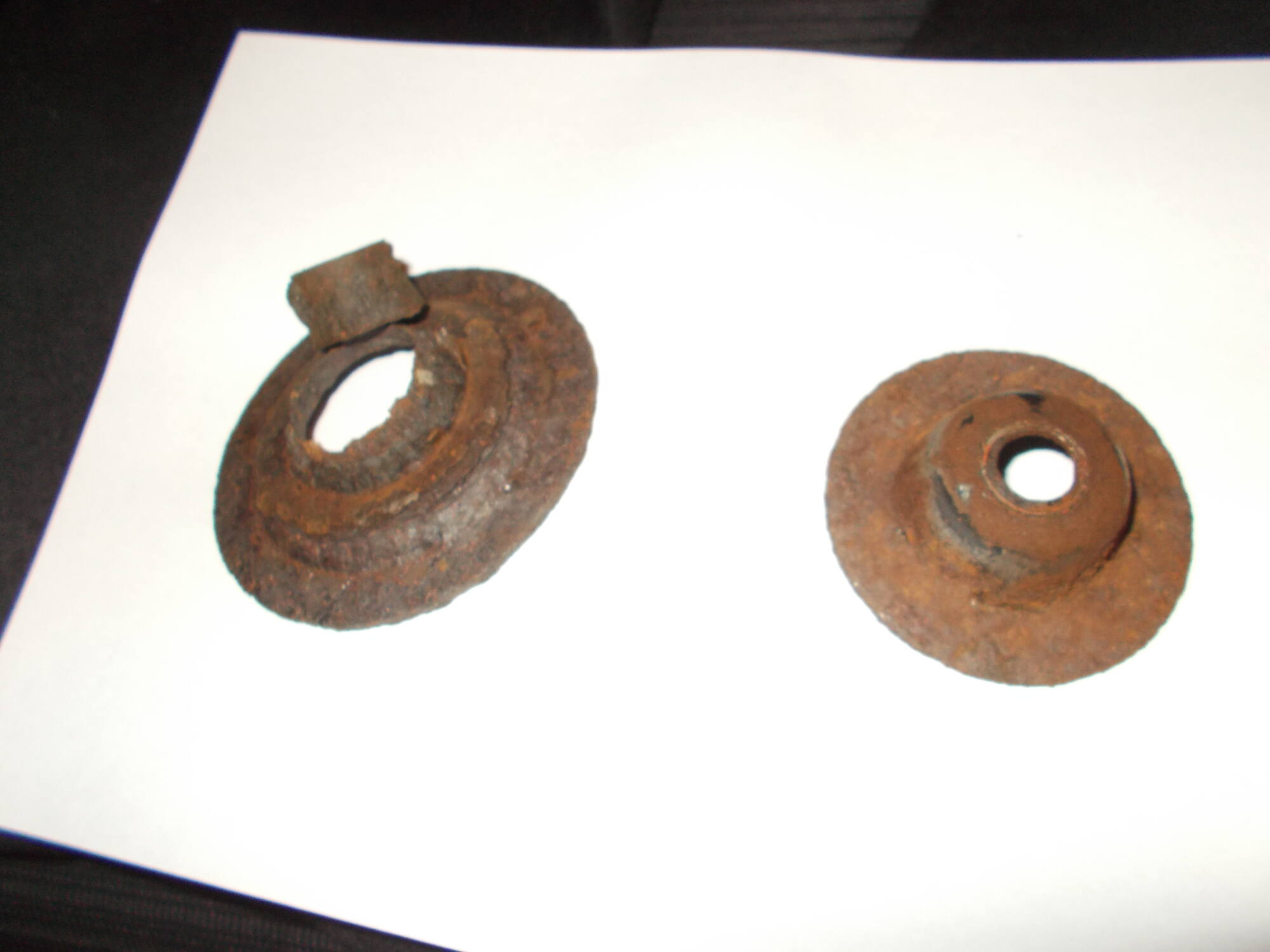

Forgot to add this.
The front bit of the subframe has a couple of cup washers to hold the bushes in place, blah, blah, blah.
These were rusty as fuck.
There were also two larger washers, also rusty as fuck. I am not familiar with them, just wondered if anyone has any further info?
The normal one is on the right.
I can find the smaller one without any issue but the larger one: 151632 (2 needed) is proving difficult.
The larger one is officially called a.....
Front Subframe Upper Retainer and is NLA on the R*mmer Bros website.
Mick Dolphin lists them so hopefully, otherwise fuck knows.
