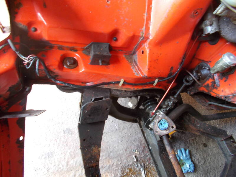

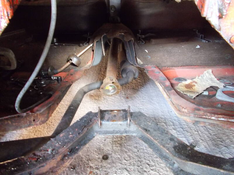

So, there it is. Engine is now out as is t he gearbox! Mate had a free day so he popped over to help (do most of it).
The subframe is still in as the OS front nut and bolt are seized, I will have to cut it out.
The subframe can then be removed. Just have to move a couple of pipes out of the way then I can strip down the chassis rails and tidy up the bits that would normally be difficult to access with everything in place.  I will then fit the new engine and subframe using poly bushes when  everything is cleaned and painted.
I can then fit the ancillaries after cleaning them up in the first instance.  New nuts and bolts will be used all round.
The engine mounts are in great shape and are original Metalastic ones, they will be cleaned up and re-used.
I need a new gearbox mount as the one on there looks like soggy chewed up licorice. Nasty.
