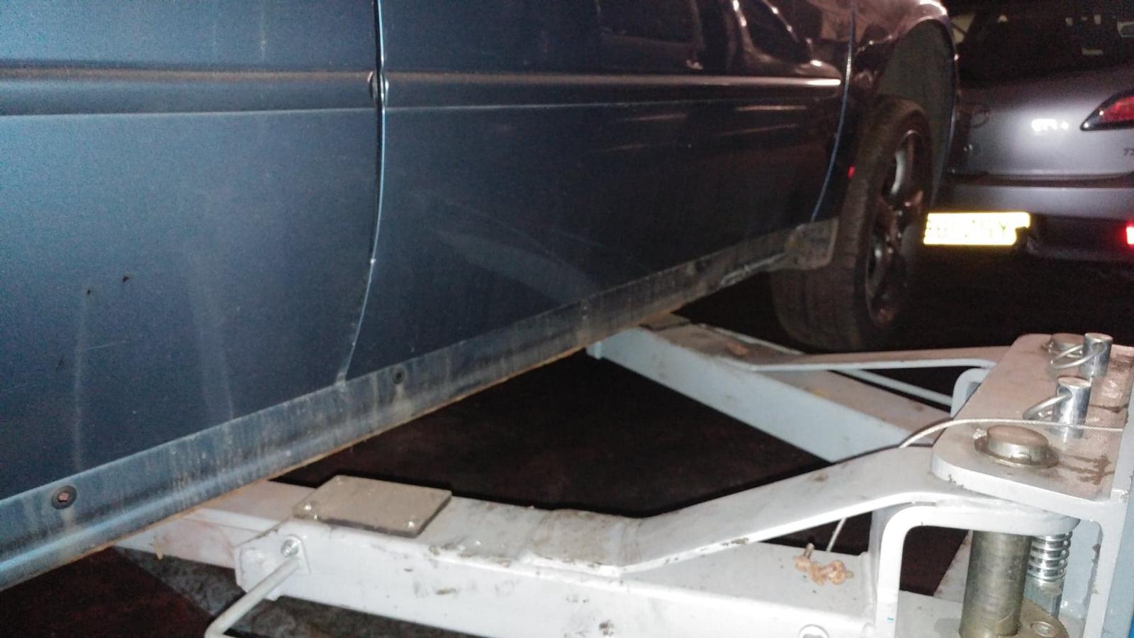

Welding was completed today - 3 big plates required because of the joins but when everything was chipped back to reveal the full extent of the problem, that 1 hole in the sill where the jack has gone through it really is all that was needed. Apparently the inner wings, the rest of the sill and the floor pan don't even have any surface rust so here's hoping that's the last time it needs to see a welder.
It's come in slightly under budget too - £160 :) Going to visit it tomorrow to take it presents - genuine Scooby dog guard procured last week and giant boot mat courtesy of loserone and gm :) Thank you gents!

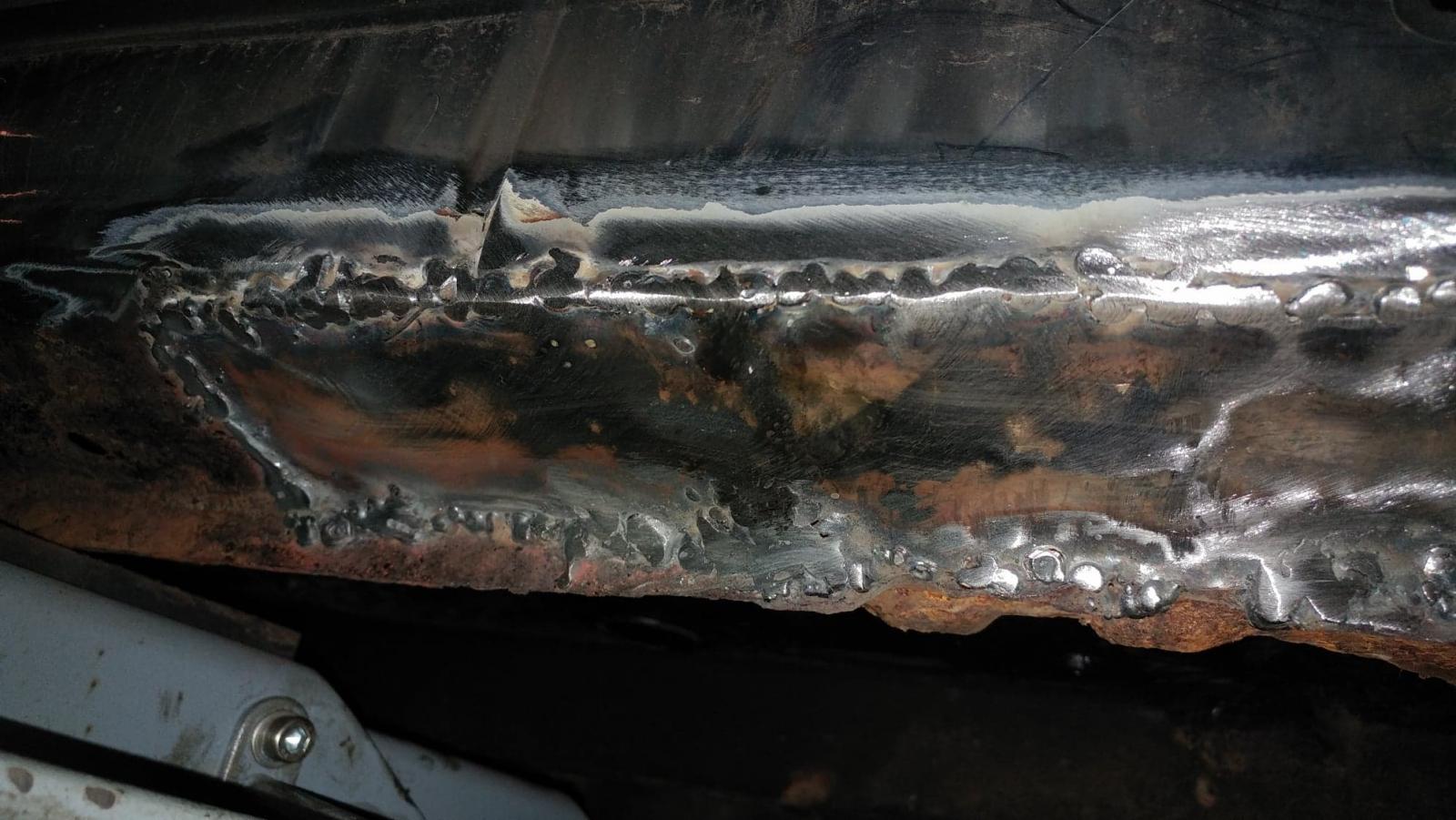

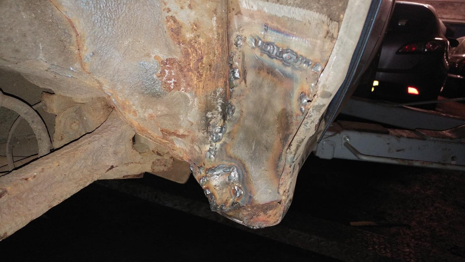

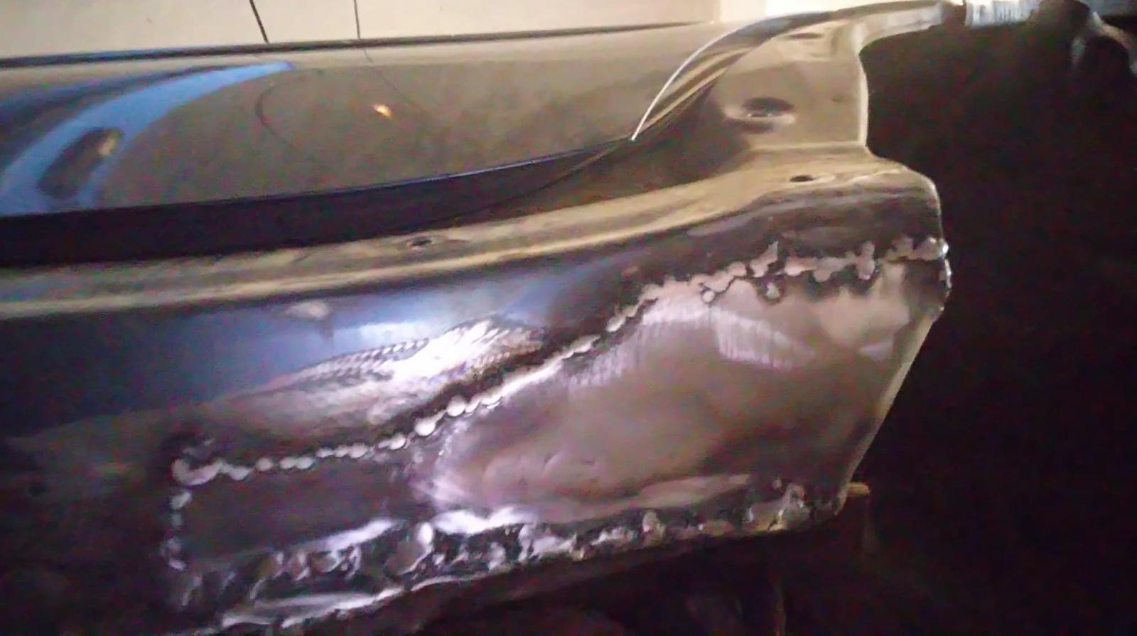

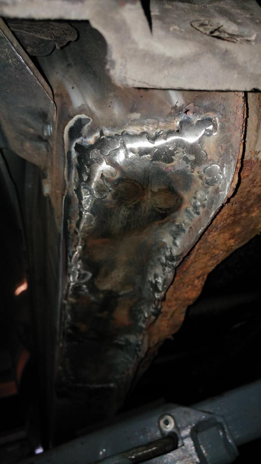

Pics as requested ;) I'm actually trying to work out how the hell it passed an MOT last year....
The above is the front of the sill underneath, the end nearest the engine.
This is underneath the sill at the back, which had been crushed by the jack.
Inner wing at the rear also required a plate. The lack of anti rust protection caused by the jack allowed everything to rot, and this didn't happen overnight....Still kicking myself I missed this tho!
Although to be fair, the rest of sill actually looks okay, and had sill covers on at the time I viewed it.

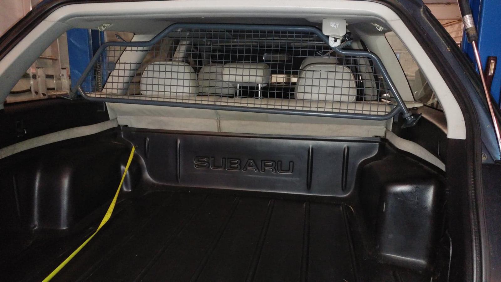

It is now also nearly dog-proofed thanks to loserone and gm Shitely-ing my heavy duty boot liner :D
Will fasten in the genuine Scooby dog guard once it's down off the ramp. It's a cracking dog-mobile as it has fittings which come down from the roof to secure it in place. Sure I read some where that 60-70% of Subaru drivers are also dog owners, so it's nice to see them catering to the market :)
