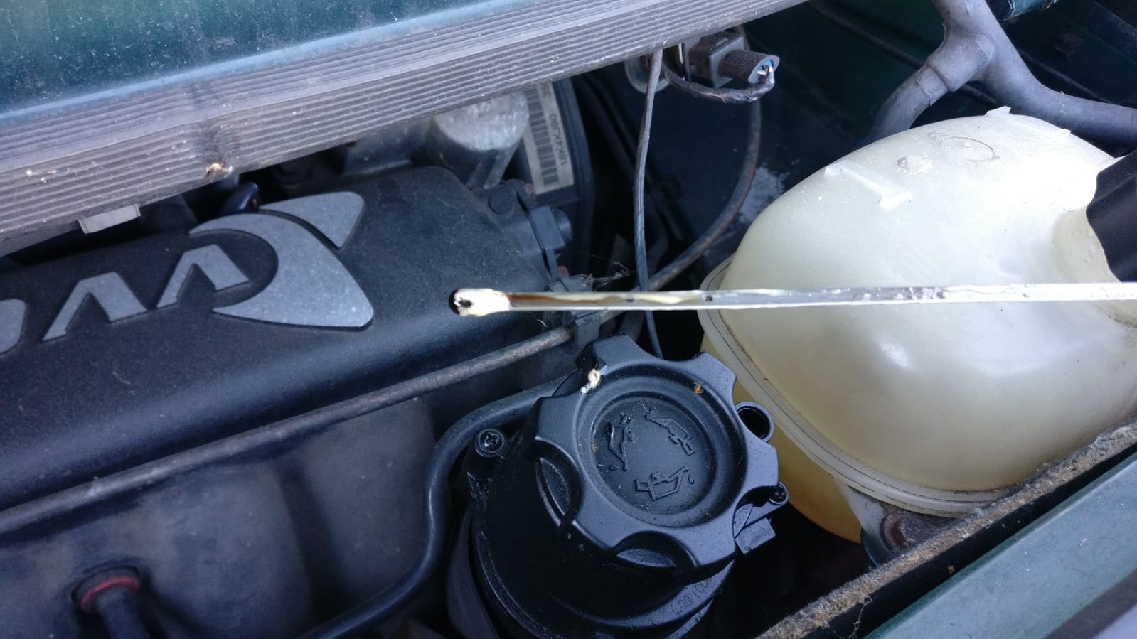

loserone Posted February 26, 2019 Author Posted February 26, 2019 See if you can guess what happened to this today.
loserone Posted February 26, 2019 Author Posted February 26, 2019 Is it warm in here?Dya want mayo with that? 320touring and Coprolalia 2
320touring Posted February 26, 2019 Posted February 26, 2019 Oh joy! Part of the joy of ownership eh:)
Schaefft Posted February 26, 2019 Posted February 26, 2019 Is this the reason I don't hear anything about the Mercedes? lol
loserone Posted February 26, 2019 Author Posted February 26, 2019 Er. Maybe. I think it's next on the list though, it's had to come back home for attention later
loserone Posted February 26, 2019 Author Posted February 26, 2019 Probably, and probably a cat, but probably not until a new head gasket. I've just been round the block in it though, doing an emergency frozen breast milk delivery, and it's fugging brilliant. So it's getting fixed. mrbenn, Tickman and purplebargeken 3

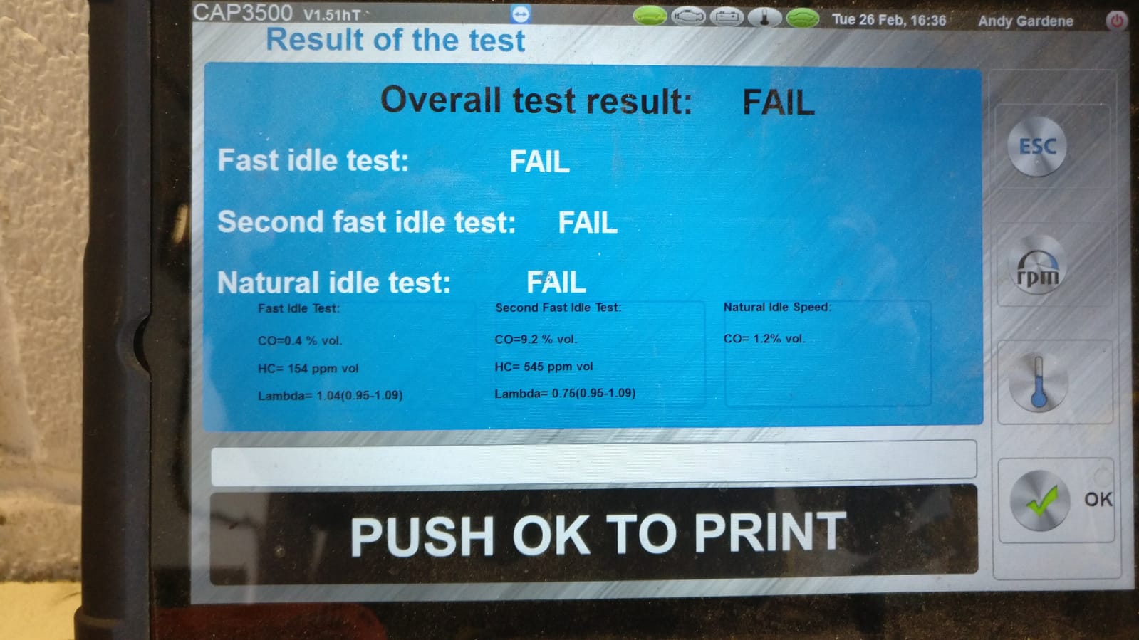

wuvvum Posted February 26, 2019 Posted February 26, 2019 Did it suddenly shit itself between the first and second fast idle tests?

scaryoldcortina Posted February 27, 2019 Posted February 27, 2019 Did it suddenly shit itself between the first and second fast idle tests?No, it wasn't going to pass (almost 10% CO when revved) and I didn't want to sit for too long with the revs up because of the possible HG situation so I let it idle through the first test and the preconditioning and only revved it for the second fast idle. PS, I'd already done everything possible to help it pass before hitting OK to test.
loserone Posted February 27, 2019 Author Posted February 27, 2019 Presumably at some point my Nissan LEAF offset becomes dangerous to the tester as well as the environment. 10% CO in a relatively enclosed environment such as a testing bay sounds like a recipe for disaster
