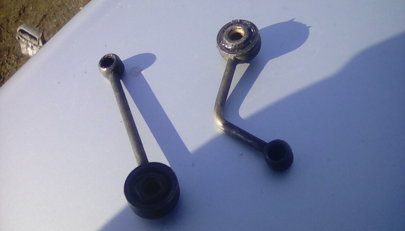

Had to modify the gearbox mount, that was easy enough. Also had to shorten this gear selector rod. Easier to just bend it for now thoughpost-19511-0-24257100-1551038434_thumb.jpg

When I started it the gears engaged nicely but no reverse gear. Bit odd but did 205s have reverse in a different place to 306 and ZXs? I should know that but can't remember!
Anyway that is irrelevant as the clutch pedal then felt odd and if you press it there is a stiff feeling and a horrible noise. I've done something wrong but what???
told you im not a natural spannerer...
205 reverse is below 5th position
Same as ZXs and Partners then. Very odd.

Early 205 diesels had the BE1 gearbox with reverse by first and lift up collar on gearlever.

Assuming it's the box on the right of the photo you've used, then that's a BE1 gearbox and will be lift-up reverse next to first.  Worth noting that the clutch release bearing is slightly different fitment to BE3 as well.
