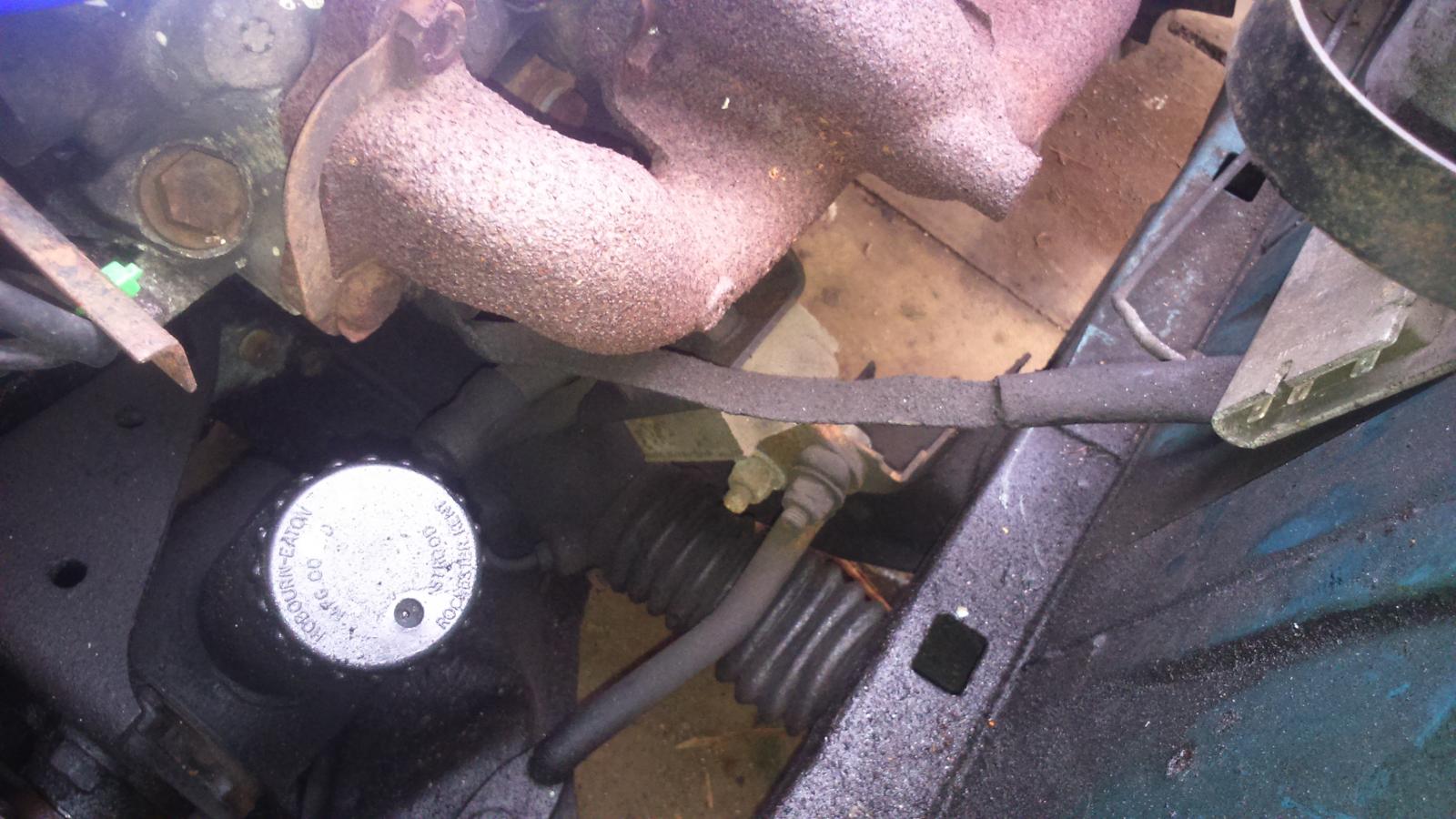

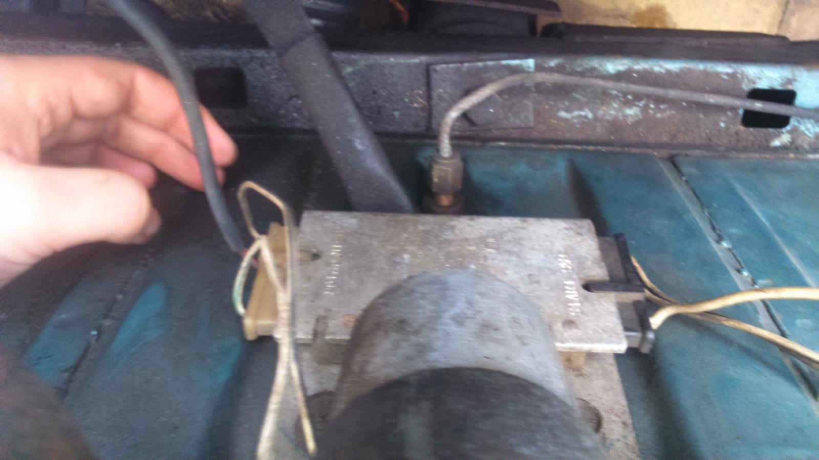

JuridicalGrunt Posted October 21, 2018 Posted October 21, 2018 bren is yours a v8 if so thier is another earth strap on the passanger bank of the engine it goes from the block to under the coil and ballast resistor here is a couple of pictures of it.

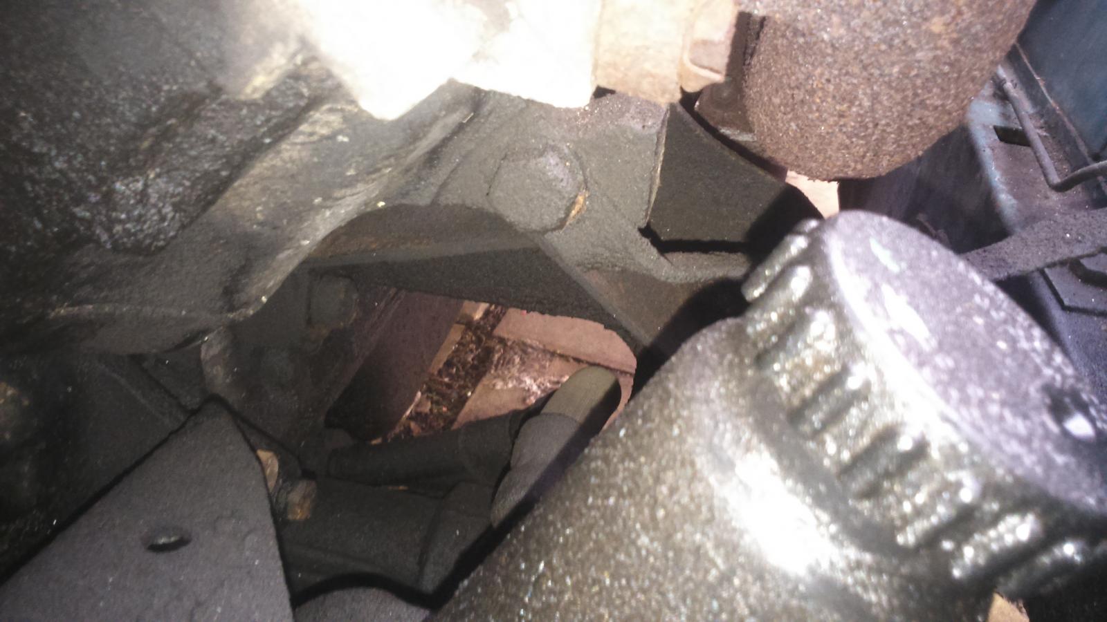

Bren Posted October 22, 2018 Author Posted October 22, 2018 Rear flexi has melted. It will be getting a rubber replacement.
