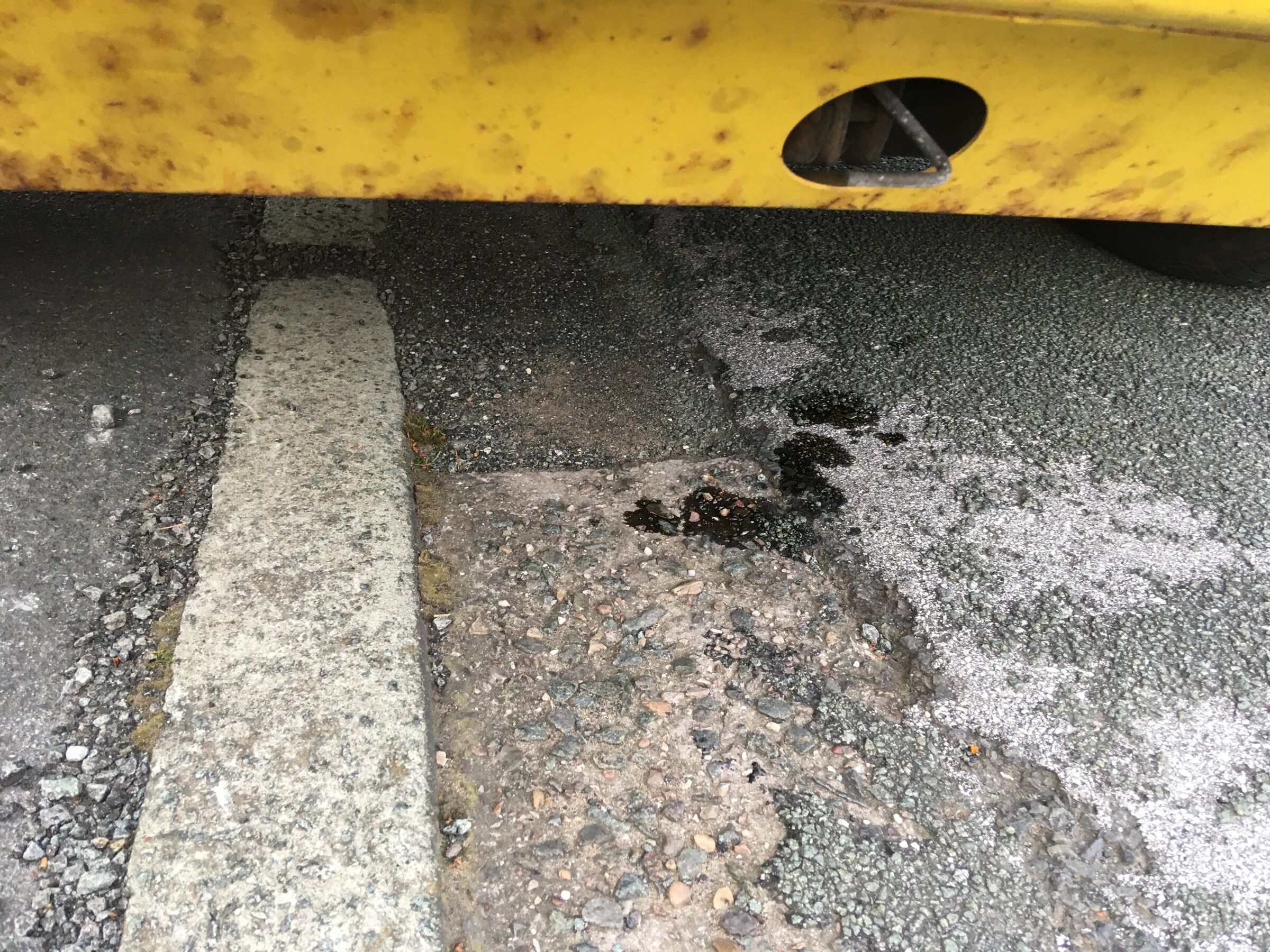

Only thing is this:
Its marking its territory, can’t be much as the oil level is fine, but there’s more drips there now than there was after a drive a couple of weeks ago...
Better have a poke about under there.
Lovely looking 2cv, the colours and bumpers suit it really well.
From my distant memory they leak oil from:
1. push rod tubes where they enter the block
2. Oil cooler seals where the inlet and outlet pipes enter the block behind the fan
3. Main engine casing. The case is split down the middle, so oil seems to weep very slowly through the joint. I guess these days an RTV sealant would be used but in my past it was Hylomar which did nothing!

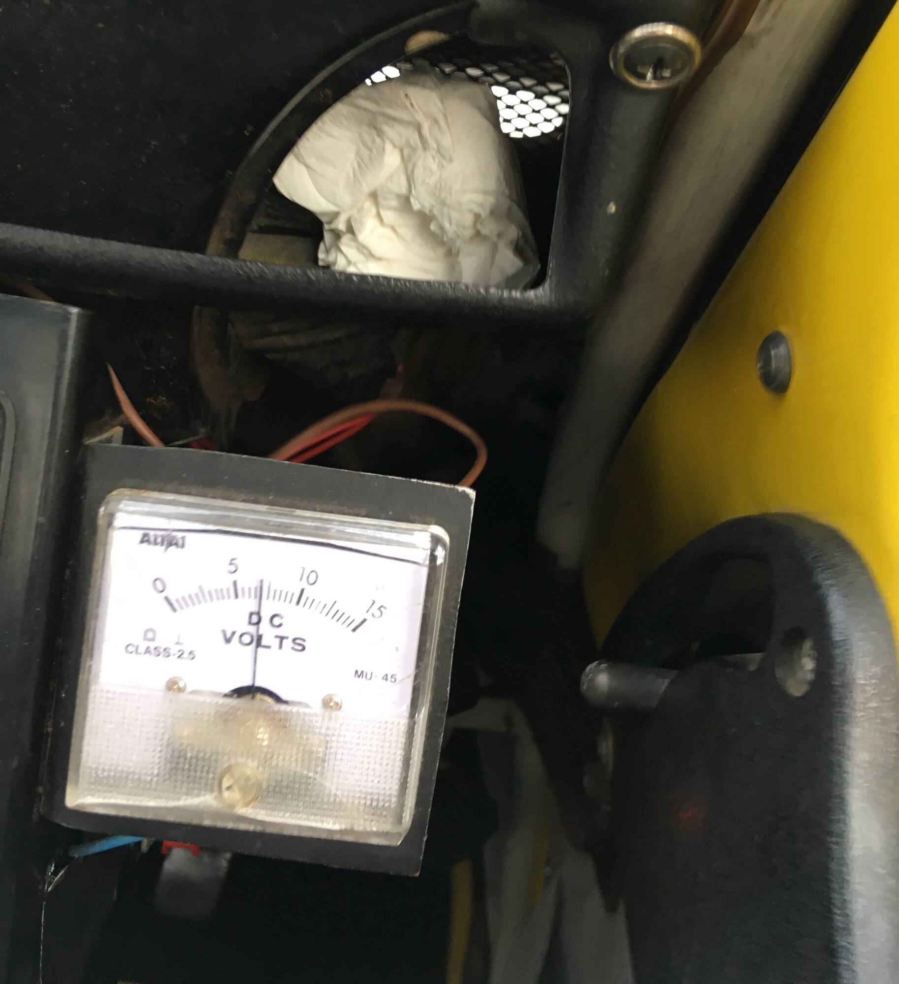

Fast forward a few days and we ambled our to Conwy for a day out and to visit the UKs smallest house. En route I noticed that our additional voltage meter was reading nothing, a quick check showed the fan was still spinning, so we carried on and got home fine.
The next day it resolutely sat here:
No amount of revs increased the voltage.

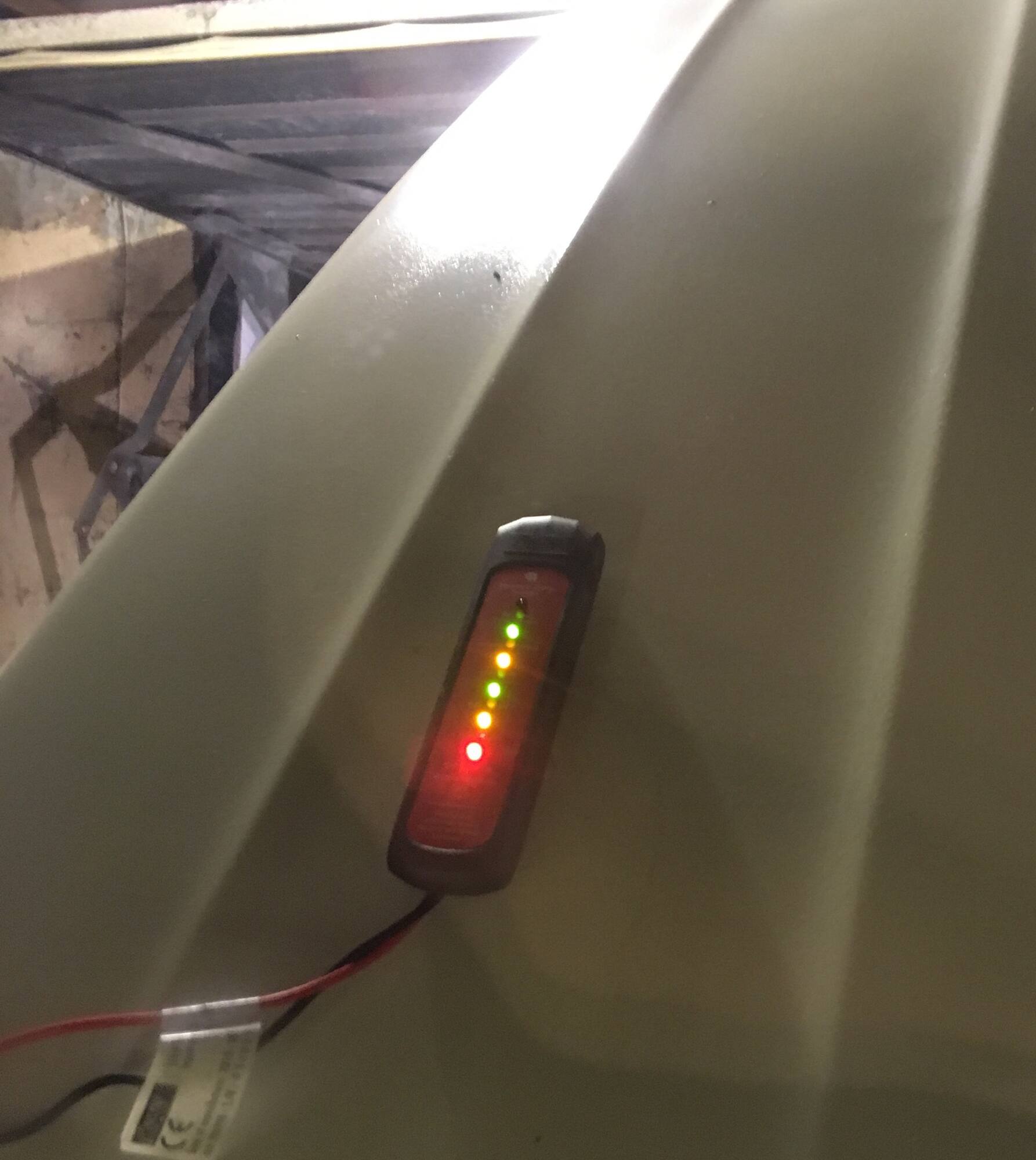

Its been s busy few weeks at Chez Brownnova and do today was the first chance I’ve had to have a proper look.
We still haven’t finished sorting the garage... the car is amongst the boxes. Thankfully I only need access The the front today!

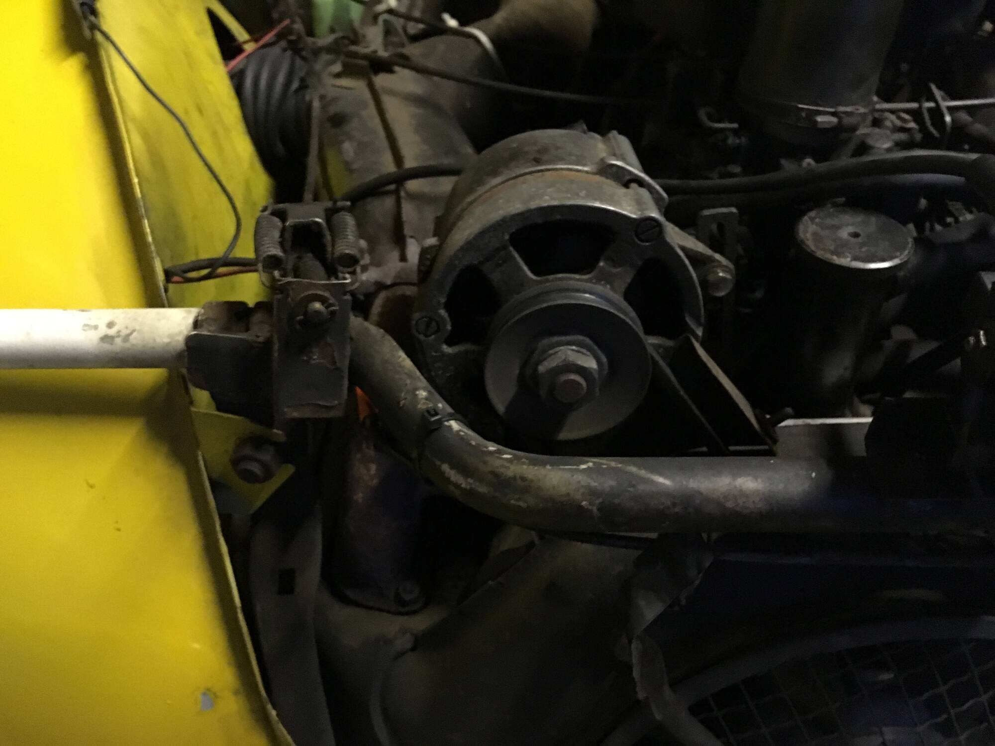

Off with the belt cover confirms my ‘loose fan belt’ hypothesis.
Fan belt adjustment is pretty straightforward on these so that good.
However.... the voltage meter reads exactly the same even with the belt tightened. Well at least it’s not wobbling around any more!
So best check the alternator using my Lidl alternator checker thingy. But of course house moved means I can’t bloody find it! Eventually at 10.30pm I find it in the spare wheel well of the Saab...
Mrs brownnova had made a crumble, I was tempted, but I had to check the alternator first...
It says to turn all the electrical items on (it suggests lights, radio heated screen air con) so I put the lights on...
Right we’re looking for the two lights above the three already lit to light up, if they do it’s charging well.
BINGO!!!
Hmm so that appears to mean it’s charging. I can only assume that the water has ingressed onto the voltage meter and made it read incorrectly. Unless some bright spark (see what i did there) has any other ideas.
It has highlighted that the fan belt has seen better days, so replacing that is now on the to do list. But not tonight!
Oh and the crumble was delicious ?
with the engine running poke the battery terminals with another voltmeter/multimeter?
IIRC if things are charging properly you should see 13.8-14.4V :)
Yes, I believe that is how the battery/alternator tester I have works by testing the appropriate voltage.
The battery condition has been fine and was showing fully charged despite many starts and restarts in the time the voltage meter has been reading low.
