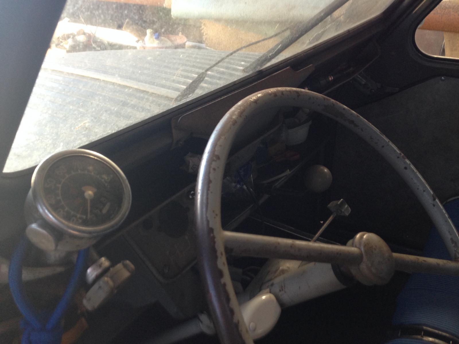

Hope you don't mind me hi-jacking your thread (let me know if you want this post removing) but I thought you might be interested in how the 2CV changed over the years. Whilst at my friends at the weekend I had a look at his latest addition, a 1959 model so took a few photos. I loved the speedo and the high comfort seats...

….a 1959 model so took a few photos. I loved the speedo and the high comfort seats...
The steering wheel looks worryingly solid enough to not come off second-best in an accident  :shock:
