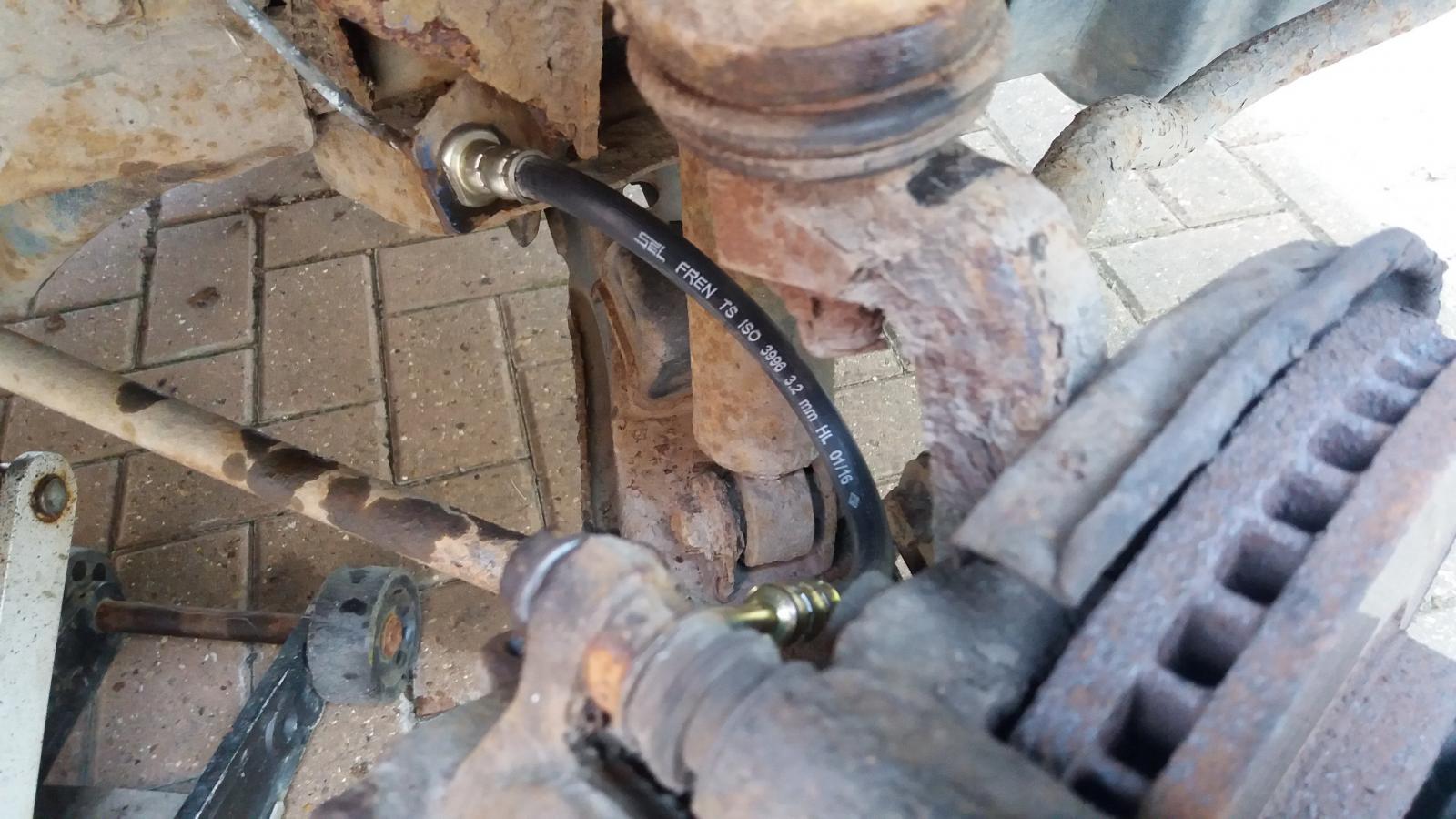

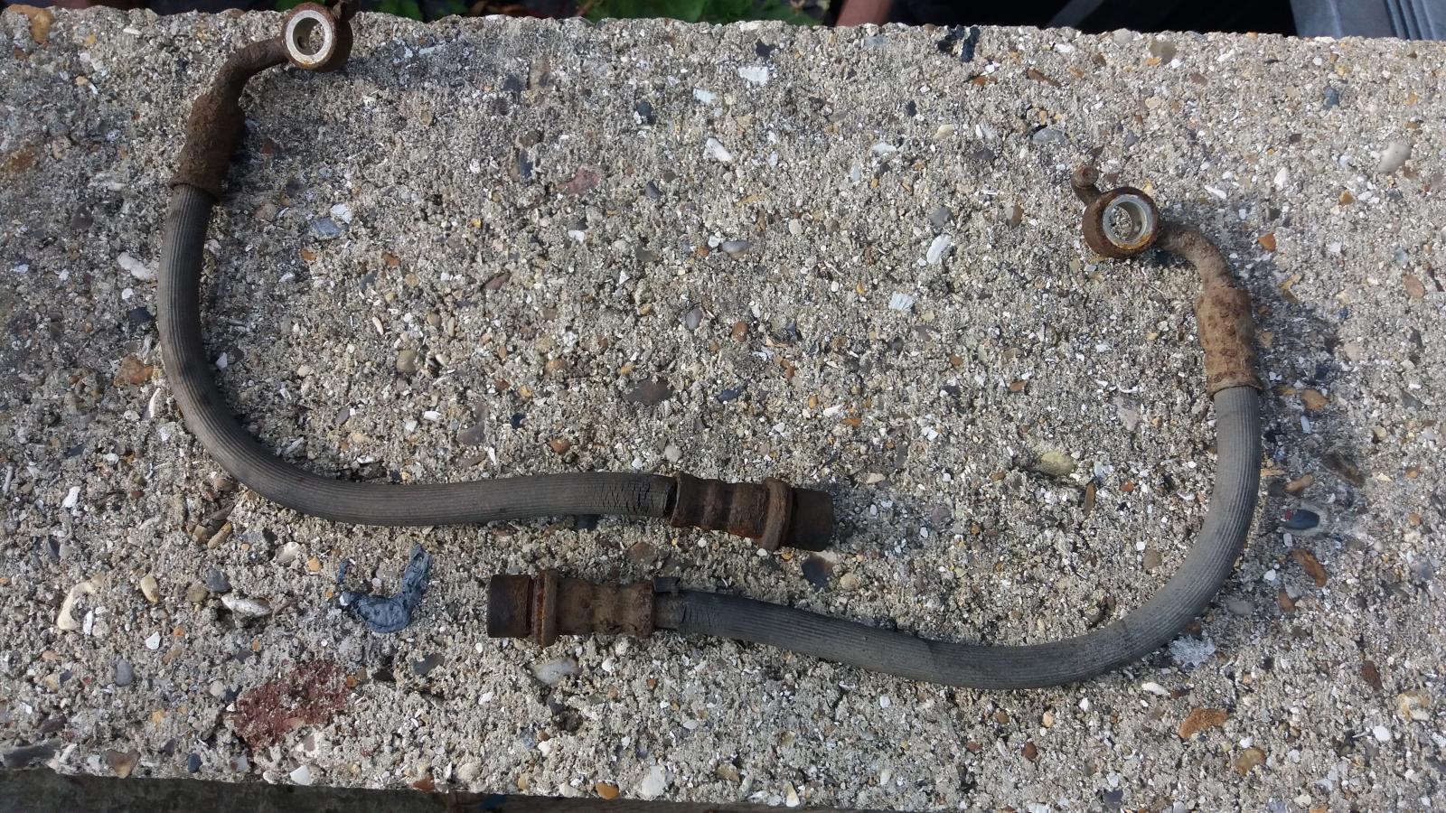

The sticky front brakes just needed a clean up and free up of the sliders but both front hoses were well past their best so got changed.
Then there was this horrible rear shock that was working fine and i was in two minds to make and weld a new dirt shroud to it but a new one was only £15.

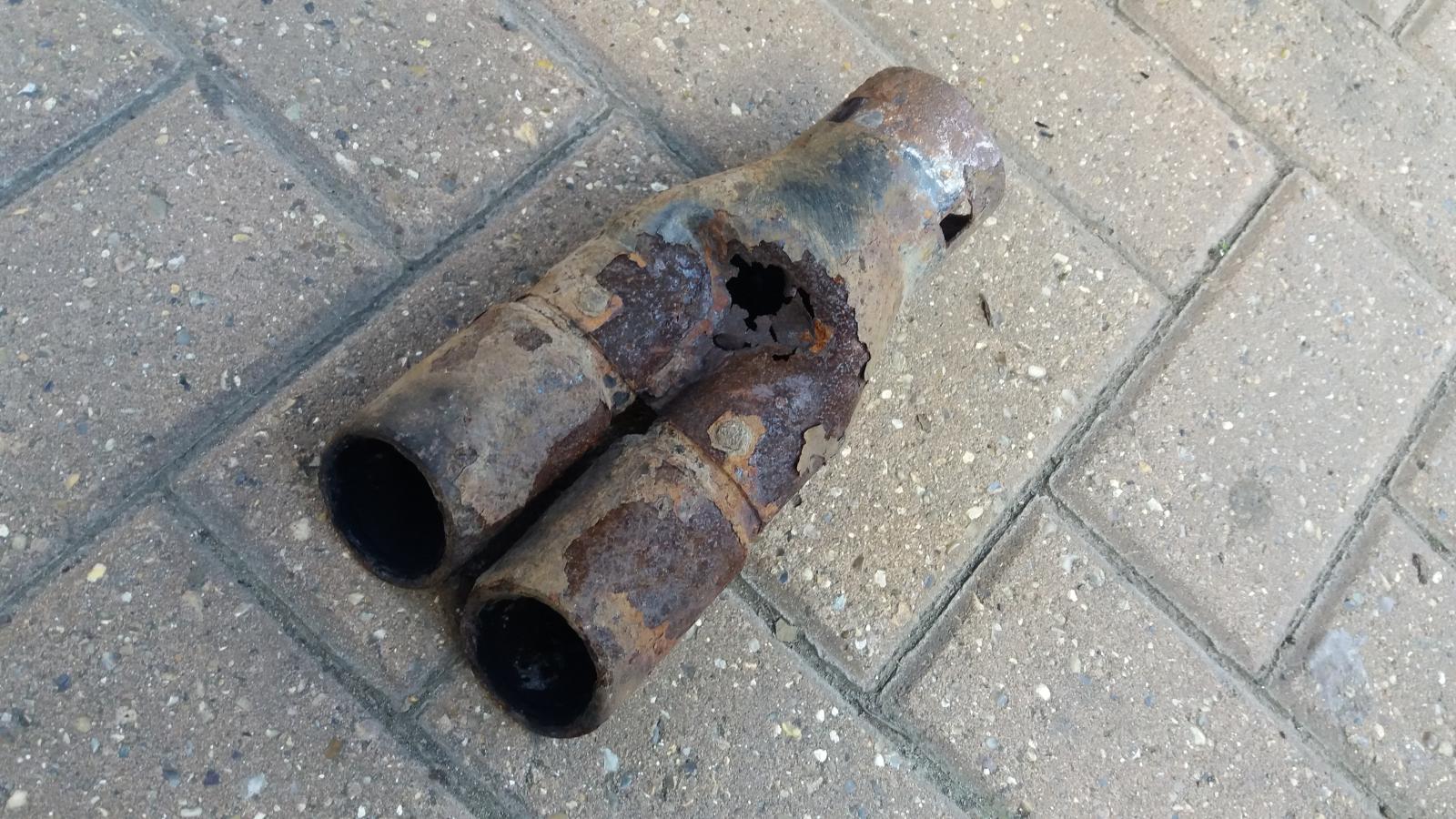

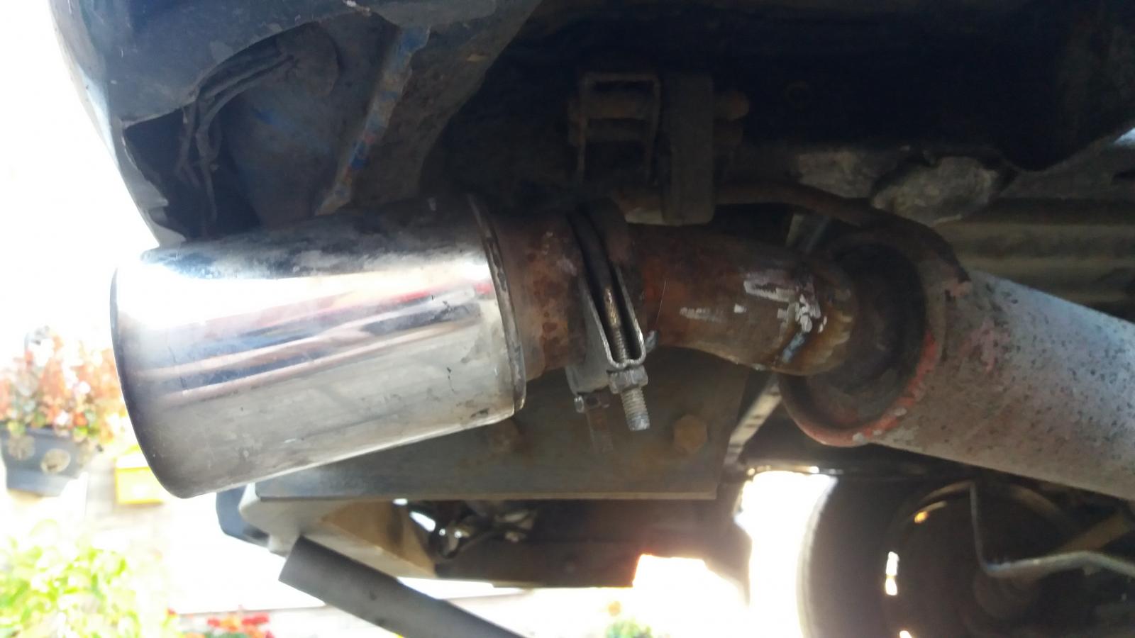

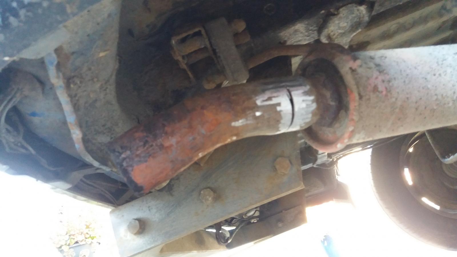

Then there was this loose / rotten tail pipe trim that i removed and then found the tail pipe was too short to exit fumes past the rear bumper.

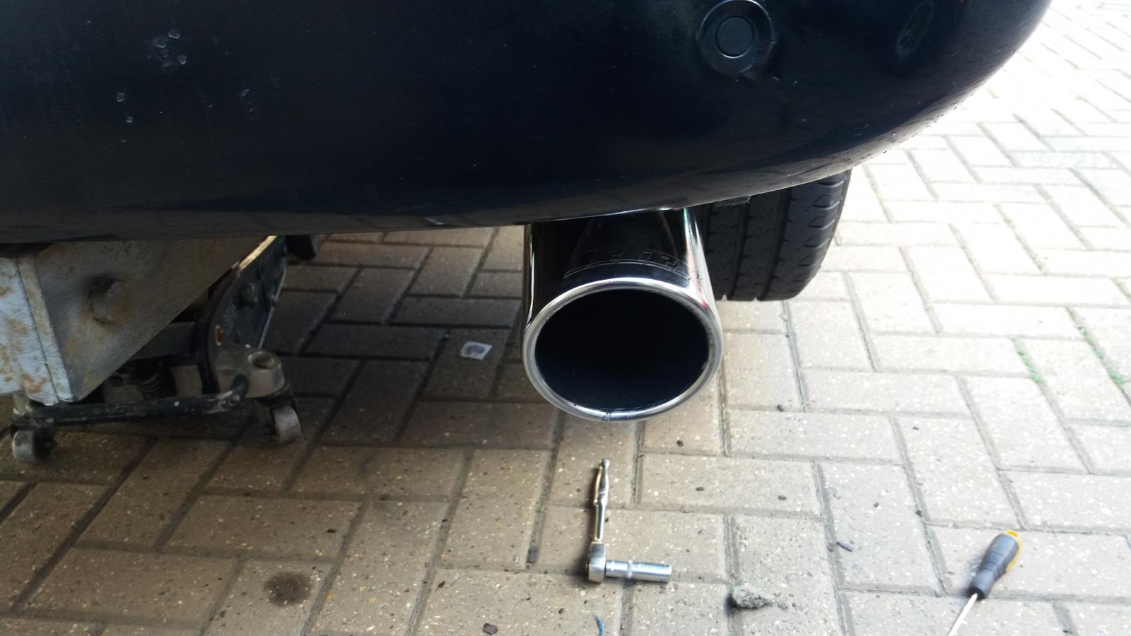

So i had a dig around the shed and went all ''Max Power'' and did this.
Cut out a slice from the tailpipe and bend it away from the bumper.
Then weld up the slice and fit this mother.
Surely this mod has got to be worth another 5 Bhp.

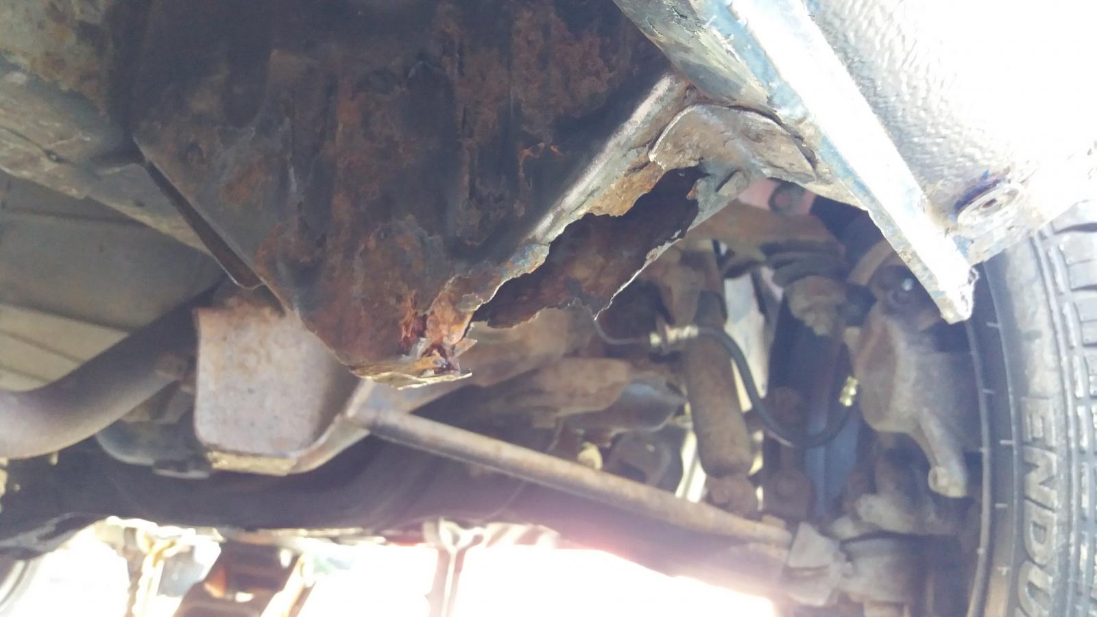

Oh and i found a bit of a hole under the o/s step.
I will poke at that tomorrow.

Right this holed outrigger type thing under the drivers side step is strange as the n/s one is perfect.
Shirley it's the nearside one that gets all the crap from the side of the road sprayed over it and should have checked out first ?
I trimmed it back to this then thought no lets really get back to sound metal and cut out much more.

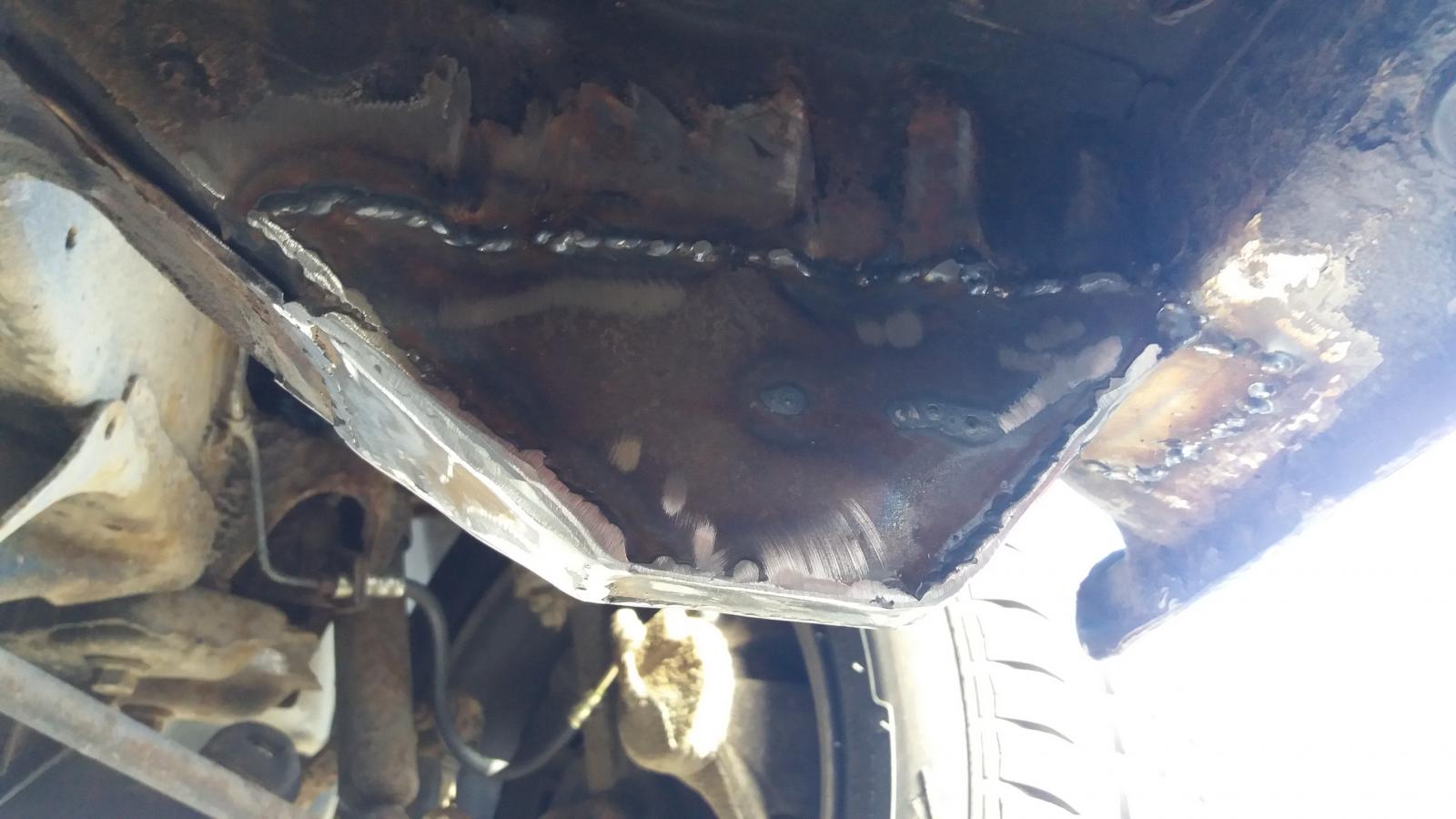

I had big ideas to make fancy templates of all the metal pieces required but in the end just winged it.
1.2mm zintec and the welder turned right up saw a lovely stronger than original repair.
A couple of coats of red primer followed by rattle can stone chip and it'll do for
me.
Bonus hot welding action shot !! (must finish off my sack barrow welding cart).

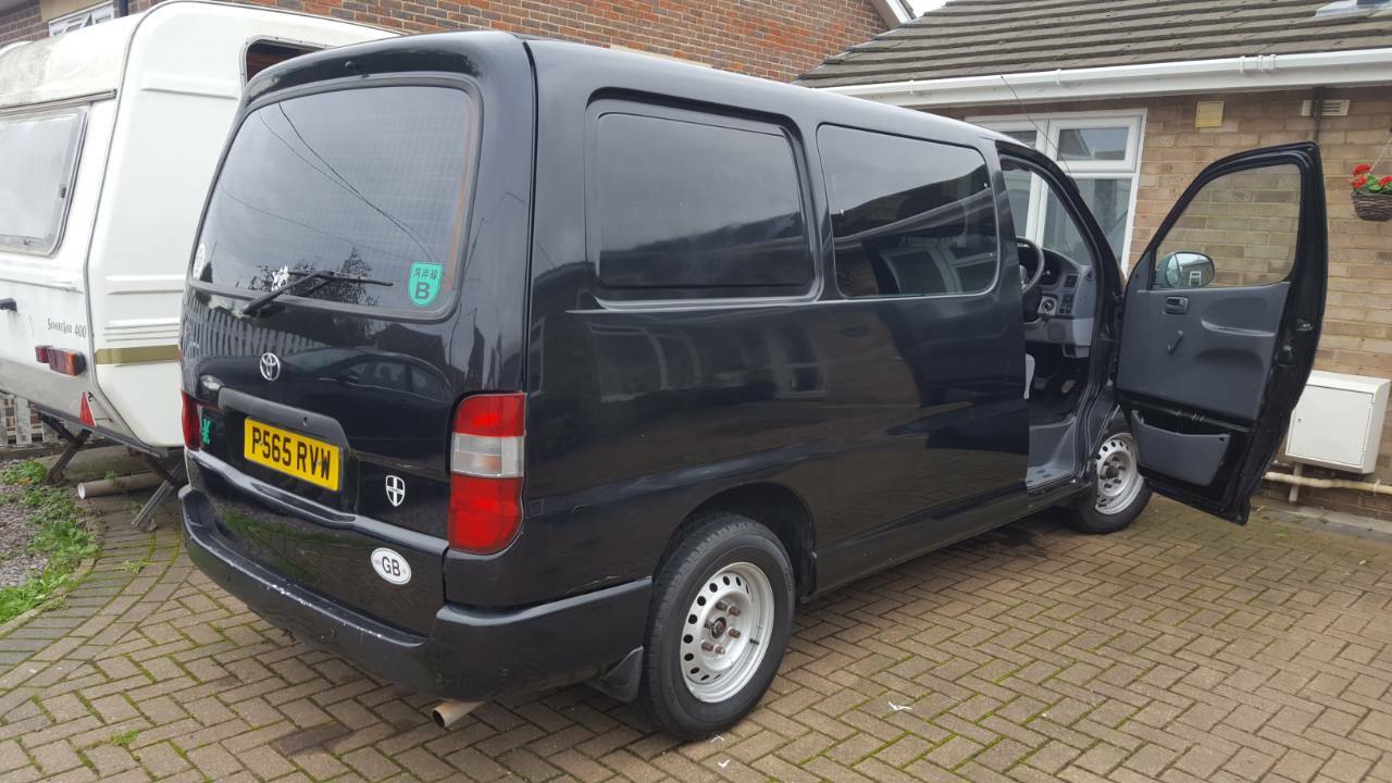

The paint on this is actually the same metallic black as my 08 Avensis but some one in the past has just used a gloss black rattle can to touch in around the edges of the windows and doors and it looks rank.
I am a fan of Farecla products and so set to trying to improve things with coarse G3 compound on the offending patches with only limited success so resorted to 1200 grit paper and soapy water to forcibly scrubb the gloss paint off of the surface of the clear coated met black under it.
It took forever but it did remove it but left the lacquer below it looking rather flat and scratched but i have a cheap Silverline rotary Polisher and with its help it was back to the G3 and then the more gentle G10 and it looks quite presentable now.
The n/s slide door and rear quarter are the only bits that are going to need painting so happy enough with that.

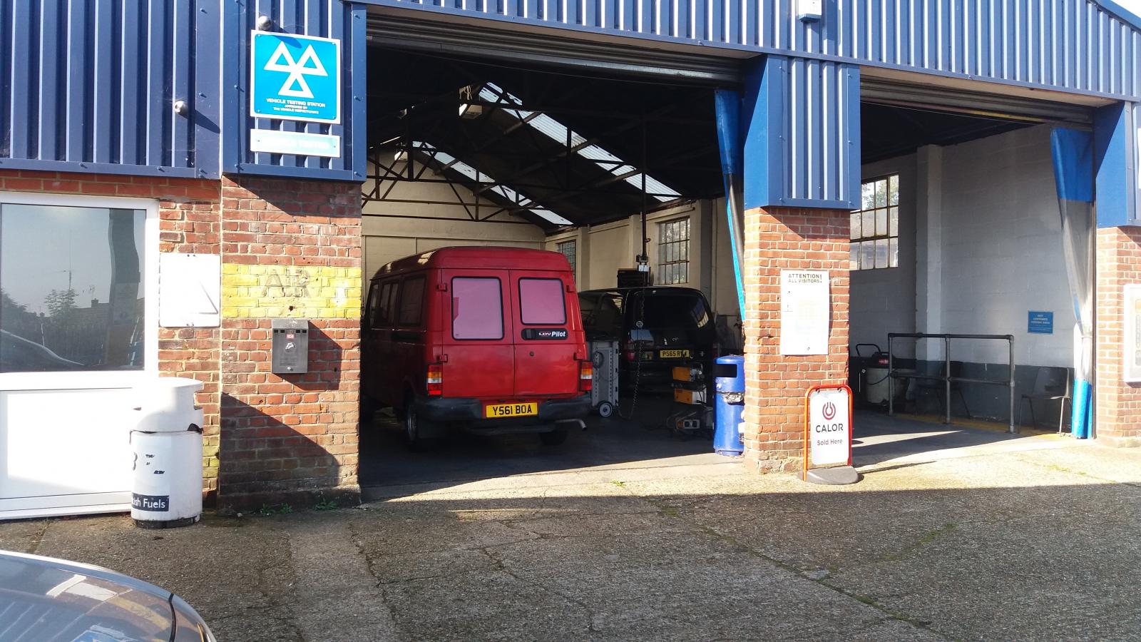

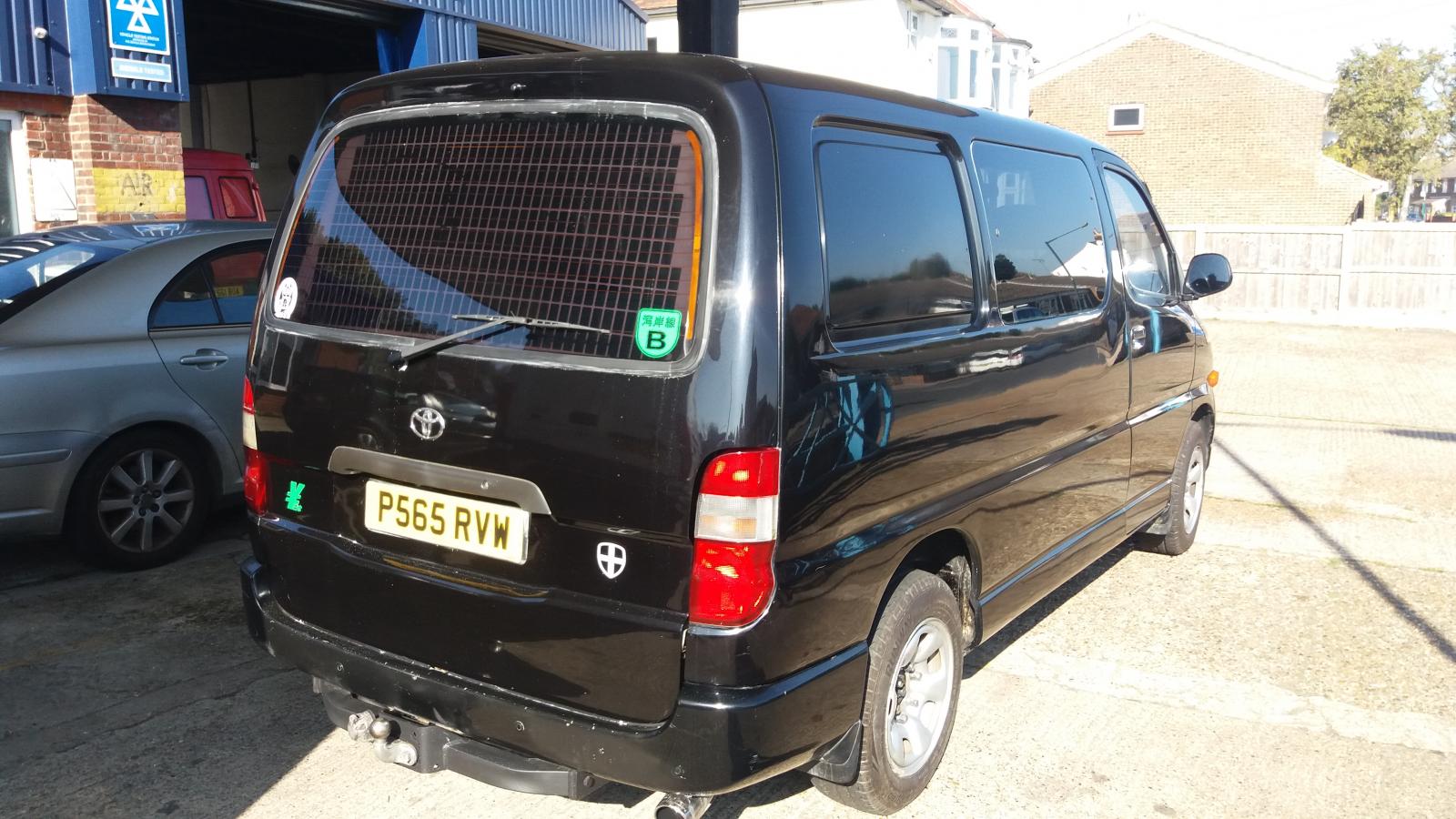

Mot day today,normally i use the garage i sold back in 2001 but they have had one tester quit and another one go into hospital so they couldn't accommodate me so i booked into another station that used to do my class 7 stuff back in the olden days.
This place just does mot's and absolutely no repairs and have a great reputation for honest fair tests.
While mine was in the brake rollers this giffer owned ldv joined the party.
The man from the ministry he say "yes"..
Using man maths the Hiace including the mot fee now owes me £837.

That's come up well with a polish. Do you think it might have been an undertaker's van originally, that's the only time I've seen black ones.
The story i got from the seller was the guy he bought it off always painted his vans black.

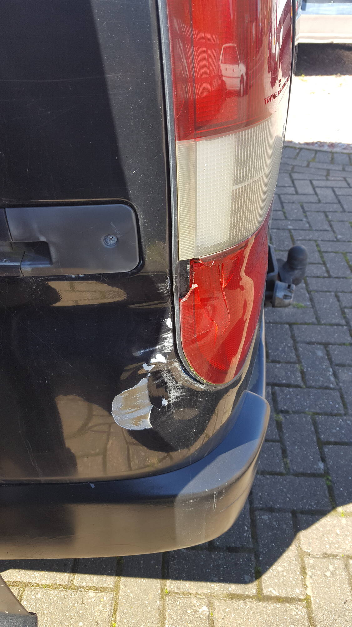

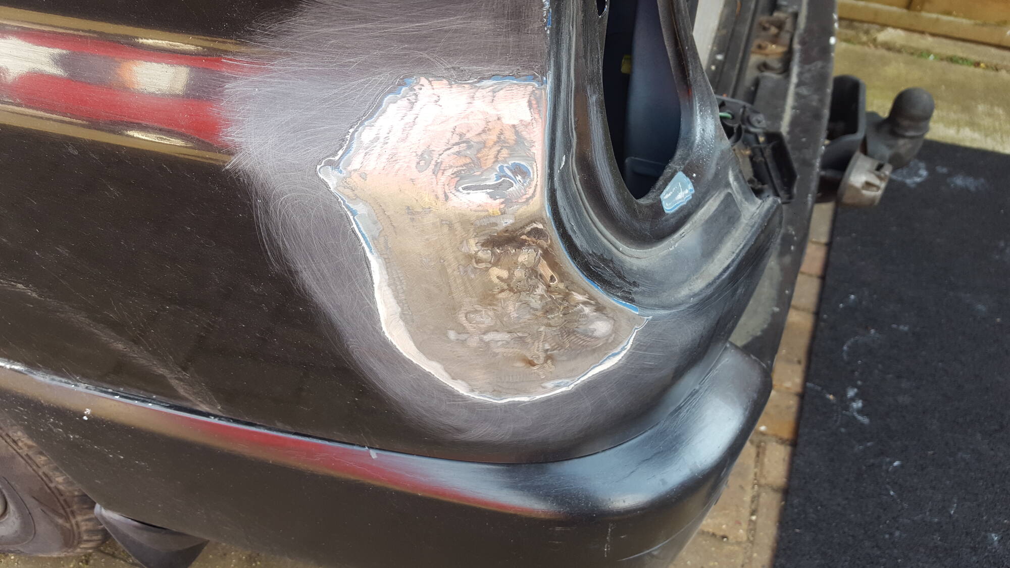

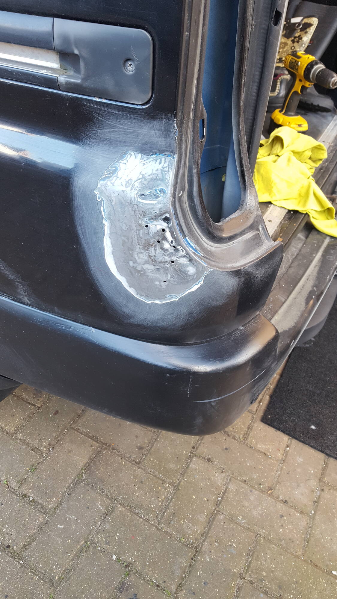

A while back Mrs Spud was doing a xmas fair with it and failed to spot a wooden post that dented the rear corner so today i decided i should have a go at improving it.
I thought if i took the rear lamp out i could get to the back of the damage and push the worst of it out but alas it's double skinned so instead i drilled a few holes and using a coarse threaded screw and mole grips managed to pull the panel mostly back into shape.
That'll do me Tommy.
Tomorrow i'll drag the Mig down from the shed and weld the holes up before skimming some P38 over it.

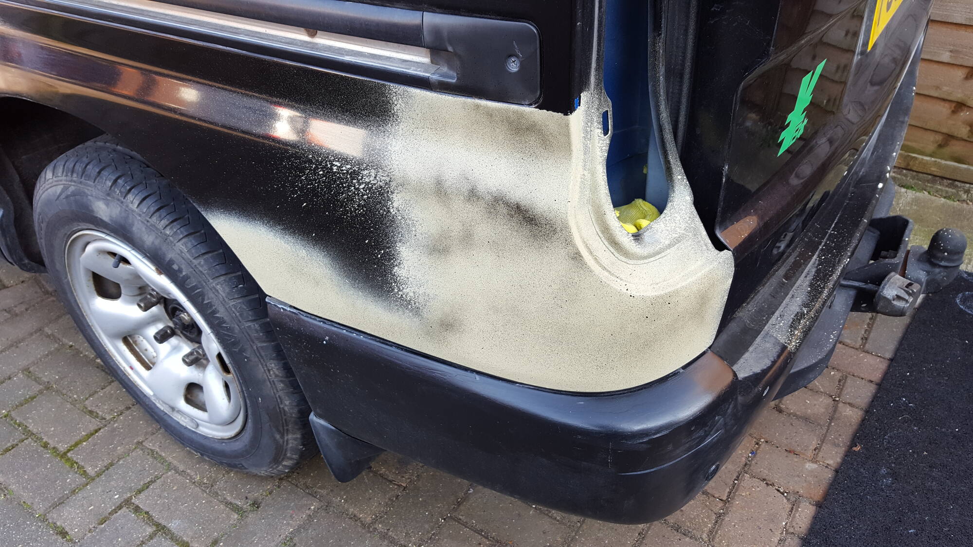

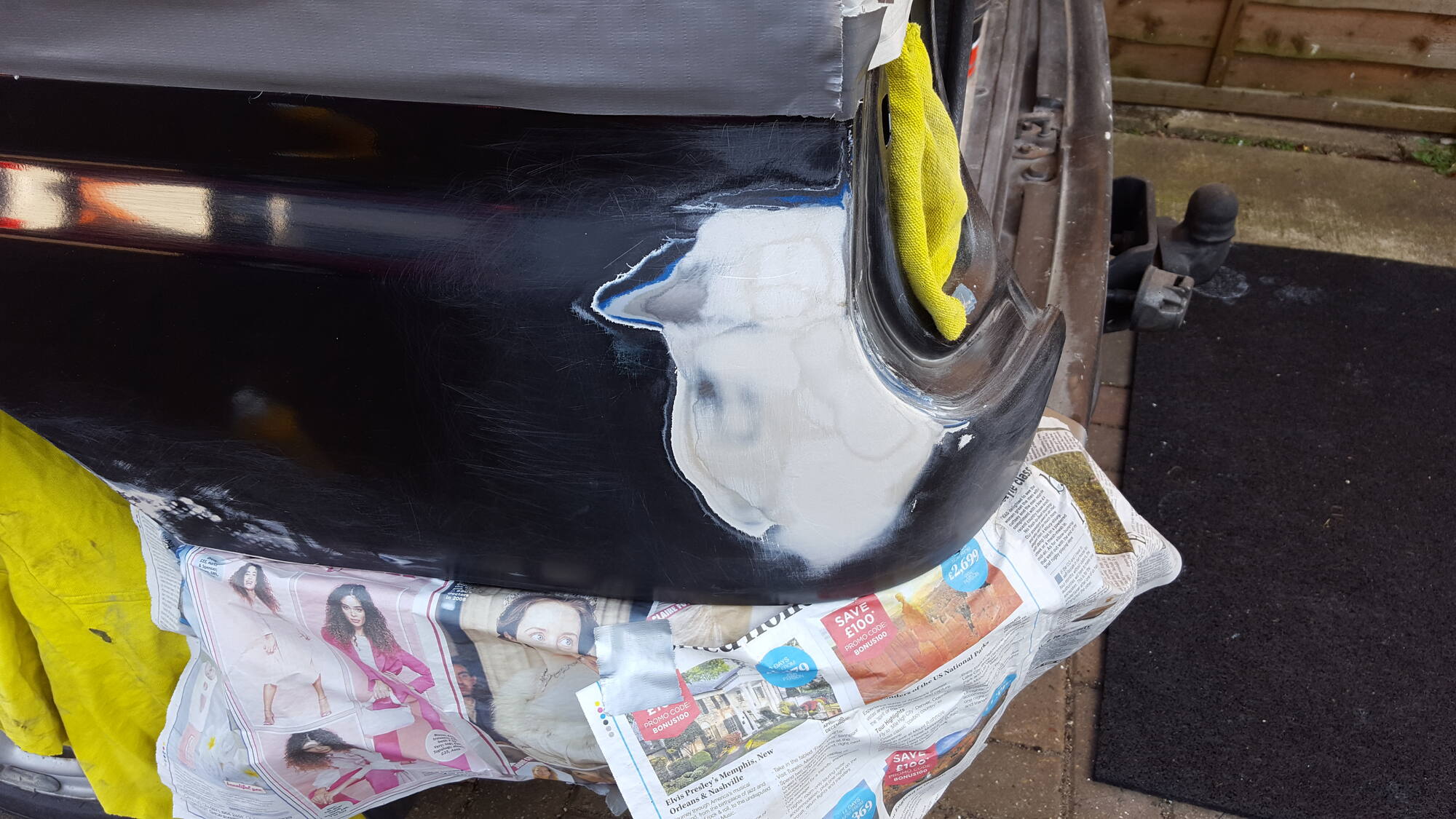

I need you to fix our Granvia! It has a fair few bumps and scrapes, including one very similar to that. Nice work!
Bing
Bang.
Bosh.
Both rear corners are already made of a thick skim of filler so a bit more won't hurt.
It has previously been painted the exact same mica black as my Avensis and Daihatsu and i have a can of that but for now i'll just do it in Poundland black.
Edit. My cheap ebay rear lamp turned up and fits ok too.

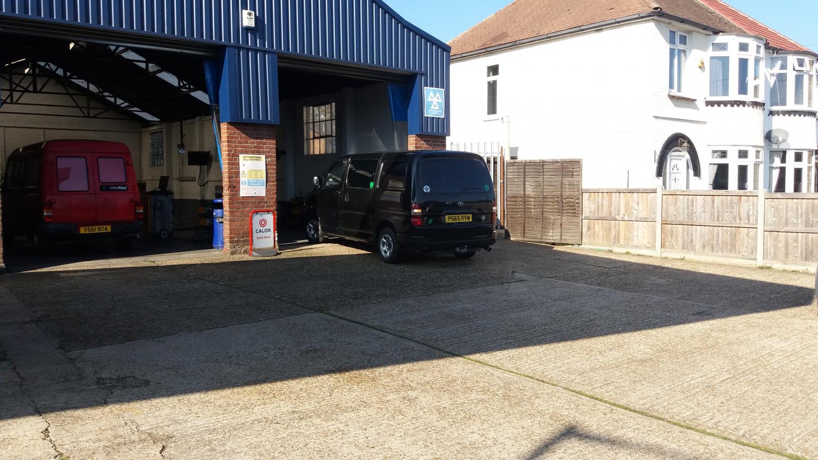

The vans mot expiry date has crept up on me and i haven't had a chance to give it a quick look over.
Its ony done 500 ish miles since the last test so this morning i quickly checked the lights,topped up the screen wash and removed the cob webs from the mirrors and chanced my luck at my local tester (Cooling Road Service Station) near Rochester.
Driving it always feels like it has a dragging brake as its only got about  80 bhp on a good day but today it felt even more leisurely than normal but at the mot centre i had a feel for a hot brake but all were fine.
Anyway 40 mins later the Hiace was backed out of the mot bay and parked up.

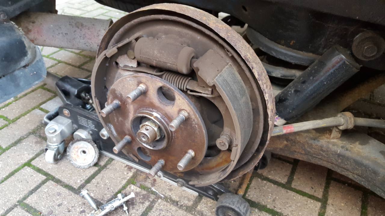

Well what can i say i feel so ashamed i have let the Toyota down and blotted my own copy book.

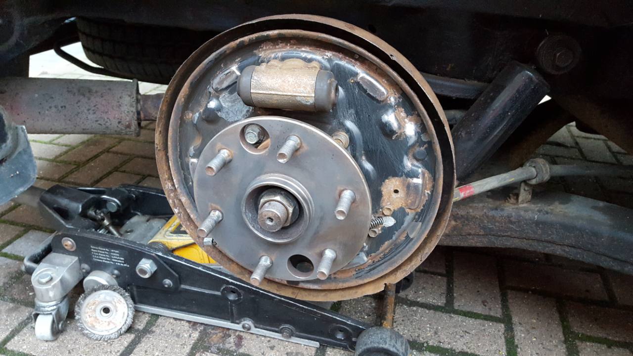

The brakes are certainly not sticking on in fact the exact opposite the drivers rear is doing absolutely nothing.
So that's what i am going to be doing later,to be fair i've never had the drums off it since i bought it.
I did try once but there is a big lip on them that was catching on the shoes so i gave it a miss and filed it as a job to do another day.
How hard can it be to remove a brake drum ?
Surely just a couple of well aimed clouts and it will pop off the hub flange (flange,love that word) but no it wasn't having it so i heated it up with a blow torch and tried again and nope not budging.
I then did a smal cut between the edge of the drum and the hub to try and relieve its stuckness and work some wd40 in there before trying again but still got nowhere.
There are two 8mm threaded holes on the drum but these didn't allow me to Press against the hub flange to force the drum off so thoughts turned to making a simple puller.
Trouble was effort no1 was too simple and the thin steel i used just bent out of shape so i had the hump now and crudely added extra strength to it by welding random bolts along its length,it looked crap and deserved to fail but i went again.
How grim is that.
The redneck stylee puller was refitted and straight away it  began to distort but...
It only bloody worked.
The reason i couldn't use the the threaded holes in the drum to push against the hub was because the last person (Spoon) to work on the brakes put the drum on where the two big holes on the flange are.
The annoying thing is i can't actually find anything much wrong with the brake the wheel cylinders pistons are free to move and everything looks ok.
Air in the system?  Mine had brake issues shortly before it turned out to have the structural integrity of damp cardboard, was either the master cylinder or some sort of brake bias valve playing up.  Glad to see this one continuing to live on, not too bad an MOT fail really!
So i have removed,cleaned,lubed (where required) and refitted the shoes and also gave the linings a bit of a scuffing up today.
The drums are in good order but had a small wear lip that i ground off allowing me to manually click up the brake adjusters while slipping the drums on and off each time.
Automatic adjusters never seem to work that great in my experience and once i had finished tweaking them up as far as i dare without making the brakes bind the pedal that was ok to start with was now very impressive.
The retest was squeezed in earlier and i was honest with the Tester guy and said that apart from lots of brake dust and slightly poor adjustment i hadn't found anything much wrong.
Into the rollers it went and this time the n/s brake pulled 285 and the dodgey o/s a now respectable 248 and they both increased/decreased evenly too.
So i don't know what was going on last time but happy dayz.
