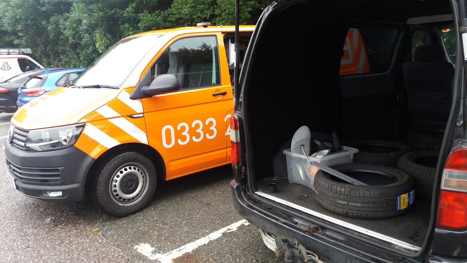

The RAC were called and a 45 min eta was given for a Patrol to attend so while we waited i started it up again only for the charging light to now go out and even the front brake had seemed to sort itself out.
I was in danger of making myself look a bit of a dick here but decided to wait for assistance rather than push on up the wet A30 and run out of electricity.
The nice Patrol checked the charge rate and it was a lowly 13.1v under load and there was only around 10 amps coming out of the alternator when measured with an Amp clamp.
Then the Alternator body got a bit hot and smelly along with the charge light showing again so the unit was goosed.
Rather than straight away offering to get it recovered home it was suggested that an Alternator could be sourced from ECP in Launceston and fitted in the carpark.

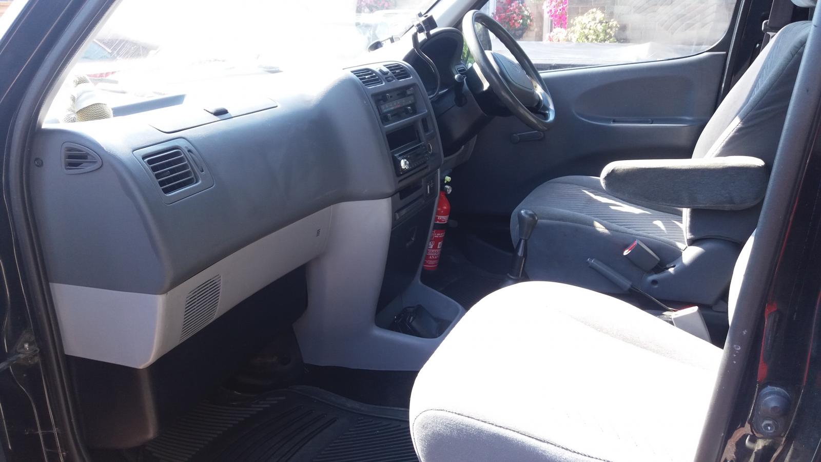

The previous owner broke up a Granvia so thats why it now has the Granvia dash and single seats along with the two side windows fitted.
I do like the early Hilux wheels too.

The van came with a set of new budget tyres laying loose in the back alas they were an inch too round for the van but they were the perfect size (205/55x16) for Focus,Mondeo,Astra's of a certain vintage so i popped them on the bay on a £80 buy it now listing and had them sold and collected the next day.
