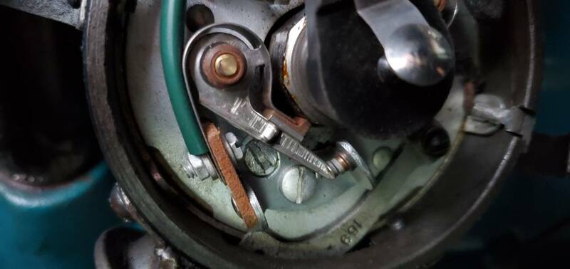

PhilA Posted January 17, 2021 Author Posted January 17, 2021 The car got a bit stuttery on the way home tonight so I decided to check the points. Trailing points had closed up sightly. Adjusted them out and also corrected a vacuum leak for the vacuum advance. Light throttle now feels a little smoother, slightly more effortless. I might back the ignition off a shade more to see how it behaves. Phil LightBulbFun and Skizzer 2

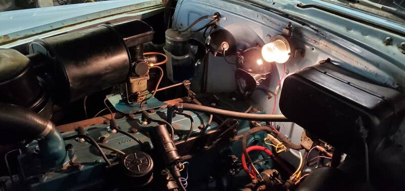

PhilA Posted January 23, 2021 Author Posted January 23, 2021 Today, I modified the alternator bracket to have a little forward-backward adjustment. Why? New fan belt, correct size. Grips properly, charges better. Something arrived in! A new thing to replace what was missing. Light! Lift the hood, it lights up. Happy with that, completes the engine bay. Phil puddlethumper, vulgalour, Skizzer and 15 others 18

hairnet Posted January 23, 2021 Posted January 23, 2021 6 minutes ago, PhilA said: Today, I modified the alternator bracket to have a little forward-backward adjustment. Why? New fan belt, correct size. Grips properly, charges better. Something arrived in! A new thing to replace what was missing. Light! Lift the hood, it lights up. Happy with that, completes the engine bay. Phil cool - is that a period correct one?
PhilA Posted January 23, 2021 Author Posted January 23, 2021 15 minutes ago, hairnet said: cool - is that a period correct one? It is the 1952 version- the 1951 one is just a bulb with a little metal hood. I picked this because it's nicely protected by the glass. Phil LightBulbFun 1

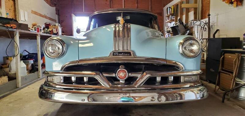

PhilA Posted January 24, 2021 Author Posted January 24, 2021 Went for a little drive today to get some photos. Most went on film (hope they come out) and I only got that one on my phone before the traffic got busy. It was way busier than it should've been for a Sunday. Phil puddlethumper, LightBulbFun, Dick Cheeseburger and 7 others 10

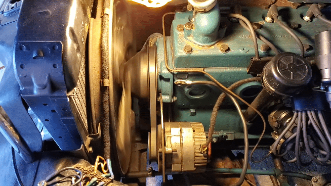

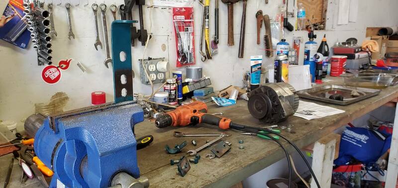

PhilA Posted January 29, 2021 Author Posted January 29, 2021 Redid the alternator alignment because the belt is noisy as hell after being parked up a couple days. Still noisy. Can't figure why. Went get milkshakes, brought the dog along for the ride. Phil GrumpiusMaximus, Tickman, spartacus and 10 others 13
somewhatfoolish Posted January 30, 2021 Posted January 30, 2021 Is it definitely the right belt? It seems quite deep in the pulley grooves, generally the outer face of v-belts I meet are nearly level with the outer diameter of the pulleys. A skinnier belt will work but won't be happy and obvs won't carry the same load as the correct item/will wear quicker.
PhilA Posted January 30, 2021 Author Posted January 30, 2021 10 hours ago, somewhatfoolish said: Is it definitely the right belt? It seems quite deep in the pulley grooves, generally the outer face of v-belts I meet are nearly level with the outer diameter of the pulleys. A skinnier belt will work but won't be happy and obvs won't carry the same load as the correct item/will wear quicker. Yeah, it had a 1/2" belt on before which was too thin by far, this is apparently the correct belt with, 5/8", same as tractors and stuff. somewhatfoolish 1
hairnet Posted January 30, 2021 Posted January 30, 2021 https://www.youtube.com/watch?v=3R2TtmqZKaw can you tow a caravan with that thing on the back :D PhilA 1
GeorgeB Posted January 30, 2021 Posted January 30, 2021 22 hours ago, PhilA said: Redid the alternator alignment because the belt is noisy as hell after being parked up a couple days. Still noisy. Can't figure why. Went get milkshakes, brought the dog along for the ride. Phil Alt looks too far forward and at a slight angle. Belt looks too narrow.
PhilA Posted January 30, 2021 Author Posted January 30, 2021 That's the width belt specced by GM from what I can tell. Alternator has pulled at a slight angle. I think I'm going to remake the bracket. GeorgeB and somewhatfoolish 2

PhilA Posted February 1, 2021 Author Posted February 1, 2021 Decided to pull the alternator bracket apart again this afternoon to adjust it up. That's about as good as it gets- it's actually an optical illusion the two pulleys look "off" in angle, they are straight; the alternator was actually too far back before by about 1/8". It still makes a racket. The belt is 19/32" wide, the correct width for the pulley. For some reason they had it sit deep. I'm going to get a belt that doesn't have the cooling grooves in- Gates do a kevlar mesh coated belt that's nice and quiet- I've got them on my lawn mower- it doesn't do a tight radius anywhere and has massive fan cooling anyway. Slightly more positive, I adjusted the hood stops so the grille lines up again, it was triggering my OCD before. Every photo of a Chieftain I see on the Internet has the grille/hood adjusted incorrectly! Phil mercedade, Dick Cheeseburger, somewhatfoolish and 3 others 6

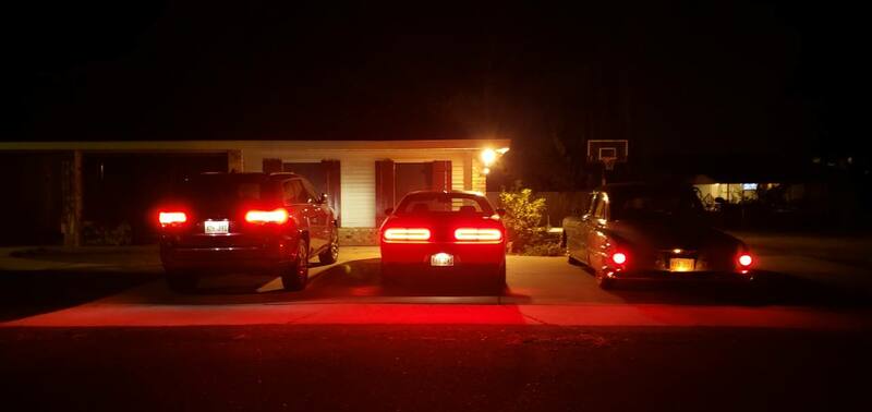

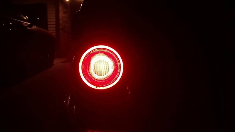

PhilA Posted February 4, 2021 Author Posted February 4, 2021 Bought some LED bulbs to brighten the rear lights up some. Camera hates the bright red but you can see the light it casts on the ground. Still not totally convinced, though. The bulbs are a little short for this and make the light as a halo on the lens. They are bright though. 2 moderns with lots of lights as comparison. Phil Tickman, puddlethumper and Saabnut 3

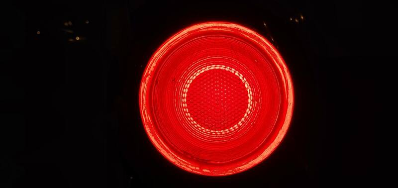

PhilA Posted February 4, 2021 Author Posted February 4, 2021 I thought about the lights a little bit and took one bulb out. There's a little lens in the top with 3 lights under it. This caused the bright slightly triangular blotch of light in the middle of the lamp by the retro-reflector. I scuffed the lens down a little to make the light a little more diffuse. Light distribution is greatly improved, satisfied with that result. Phil Saabnut, Rocket88, cort1977 and 11 others 14
cort1977 Posted February 4, 2021 Posted February 4, 2021 Very worthwhile that I think. People aren't used to the old style lights and just don't see them. (Of course they should, but they don't). PhilA 1
