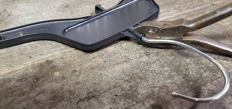

PhilA Posted September 2, 2020 Author Posted September 2, 2020 New wing mirrors. One item off the MoT list. Why? This one was not a pass. Phil ProgRocker, LightBulbFun, Dick Cheeseburger and 3 others 6

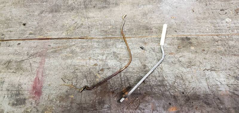

PhilA Posted September 3, 2020 Author Posted September 3, 2020 Tonight, coat hanger. Attacked with various tools. Left: previous owner's idea of a good lock pin Right: a better lock pin Slotted into place in the right hand door. I'm still trying to figure why both lock pins were missing in the first place... Phil paulplom, LightBulbFun and Tickman 3

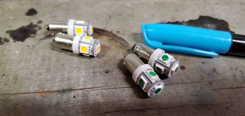

PhilA Posted September 8, 2020 Author Posted September 8, 2020 Couldn't do much tonight, shoulder's giving me grief again. I had an idea so I pulled the LED bulbs out of the box (I'd removed them because they were a strange hue and the dimmer circuit doesn't make them dim). They were attacked with a turquoise marker pen. Let's try one out... Yup. So now, modeled after the Chrysler Newport, we have the Pontiac Swansea dashboard (it was either that or Port Talbot) I'll get a better shot when it's properly dark. Phil juular, BlankFrank, mat_the_cat and 6 others 9
PhilA Posted September 9, 2020 Author Posted September 9, 2020 That'll work. Think it'll stay, at least for a while. Phil Snipes, Dan_ZTT, mat_the_cat and 12 others 15

Zelandeth Posted September 10, 2020 Posted September 10, 2020 That's actually quite like the dash lighting I've seen on a few cars of that era. Of course Chrysler then started playing around with electroluminescent lighting in the 60s for extra cool points...and probably a massive headache for owners! PhilA 1
PhilA Posted September 10, 2020 Author Posted September 10, 2020 The Chrysler system was fairly straightforward- the same kind of pseudo-AC as implemented by the radio's HT circuit, a metal rod or surface coated with EL paint, and a fine mesh wire over the surface or a tiny litz wire wrapped around the rod as the anode. That way they had glowing panels and needles that glowed of their own accord. Must've been like having some sort of space-age fantasy sitting in front of you at night. This merely adds the same EL color glow to the dash, but it's pretty effective, nonetheless. Phil LightBulbFun 1
