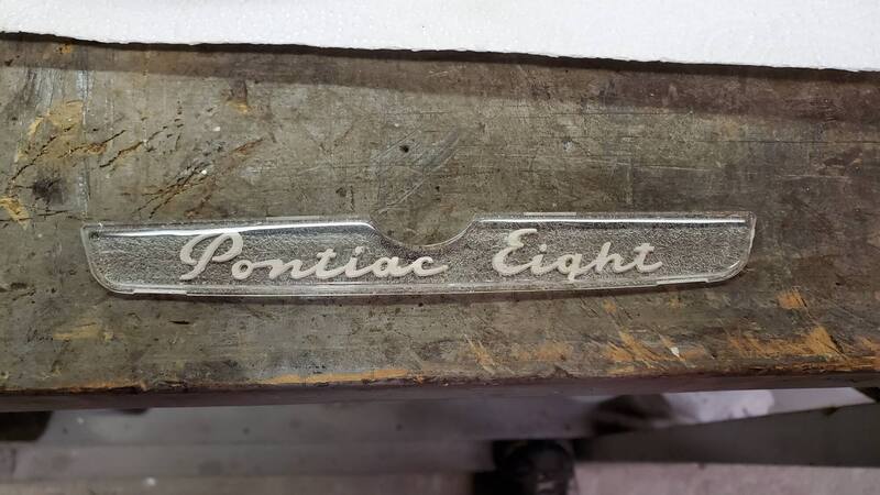

somewhatfoolish Posted July 20, 2019 Posted July 20, 2019 On 7/2/2019 at 2:43 AM, PhilA said: Cream paint on a piece of wire. Words done. With some pillarbox red. Cleaned up and assembled into the frame. And on the car. That makes me happier. It's not perfect but it's a lot better. Phil Were these ever illuminated like Wolseley grille badges, or was it just exuberant Virgil Exner 1950s 'Wooo! Plastic's neat! Plastic's the future' kind of thing?
PhilA Posted July 20, 2019 Author Posted July 20, 2019 Very much "look what we can do with poly methyl methacrylate!", a really nice way of getting the dash with 3D lettering that's a lot more accurate than glass and cheaper than etching. The whole car uses acrylic wherever possible- dash, the chief up front, tail lights. Only places not where I would expect it are the front turn signal lenses. Phil LightBulbFun 1

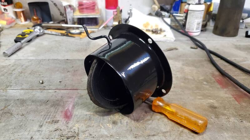

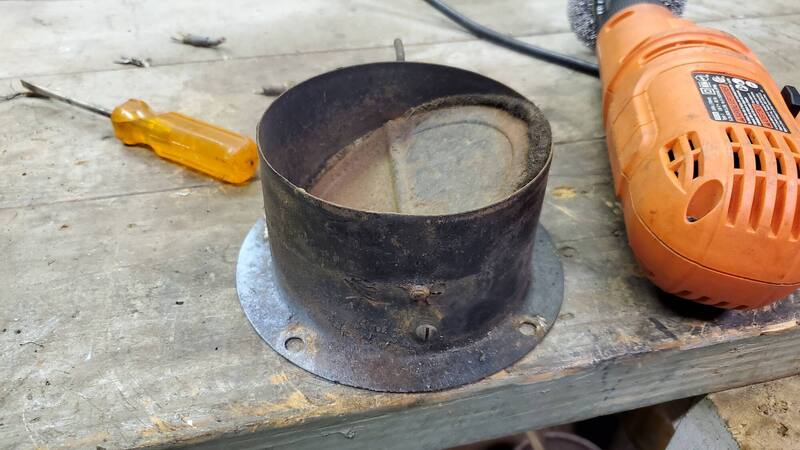

PhilA Posted July 21, 2019 Author Posted July 21, 2019 Put the hi/lo switch back and set all the carpet back down. Driver's side air vent. A bit rusty and funky. Less so now. Phil LightBulbFun, Twiggy, Skizzer and 1 other 4
