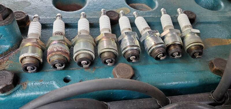

PhilA Posted April 3, 2021 Author Posted April 3, 2021 I pulled the plugs out to read them. All fairly even and not a bad color. Ran the compressions. 1- 115 2- 125 3- 105 4- 120 5- 125 6- 115 7- 125 8- 130 Those aren't bad actually. The pot I thought would be the worst (7) was actually amongst the best. 3 needs the tappets adjusting, it clicks. Overall not bad at all. Phil Fumbler, Tickman, CaptainBoom and 4 others 7

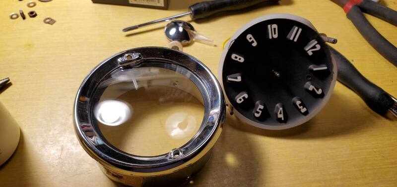

PhilA Posted April 7, 2021 Author Posted April 7, 2021 I received a big box of Pontiac goodies from a guy who's hotrodding a 1953 Chieftain, and had pulled a bunch of stuff out that he didn't need. One little gem was this: The factory "handbrake on" warning light. It was in a fairly sorry state so it got reassembled and cleaned. The rest of it was duly fitted, a suitable bulb procured. Nice. Ignition on, pull brake and that blinks at you as a reminder. In return I said I would repair the clock from his car. Cleaned the points and got it running. Cleaned the rest of it, took the nasty old paint off the hands and applied new. Looks pretty now, but needs a new gear for the fast/slow mechanism and the setting knob has been sheared off (no idea). Then, convert it to 12V with a bit of electronic wizardry and send it back home. Phil somewhatfoolish, cort1977, RayMK and 8 others 11
Asimo Posted April 7, 2021 Posted April 7, 2021 The clock numbers are a lovely font. Mr Livered and PhilA 2

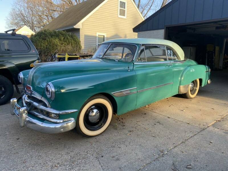

PhilA Posted April 8, 2021 Author Posted April 8, 2021 This is his car; most of the changes are underneath. Better brakes, more powerful engine, different gears etc. Phil eddyramrod, Dick Cheeseburger, mercedade and 1 other 4

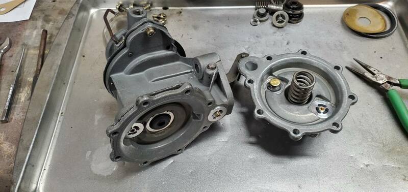

PhilA Posted April 8, 2021 Author Posted April 8, 2021 Fuel and vacuum pump rebuild kit just arrived in the mail. Phil LightBulbFun 1
hairnet Posted April 8, 2021 Posted April 8, 2021 I had shizz arrive in the mail also Thanks @PhilA PhilA 1
PhilA Posted April 8, 2021 Author Posted April 8, 2021 Lolfail Someone has rebuilt my pump with later parts. Replacement diaphragm in the mail. Phil
PhilA Posted April 10, 2021 Author Posted April 10, 2021 All clean, all new everything. Just waiting on the vacuum diaphragm to arrive. Phil somewhatfoolish and Saabnut 2

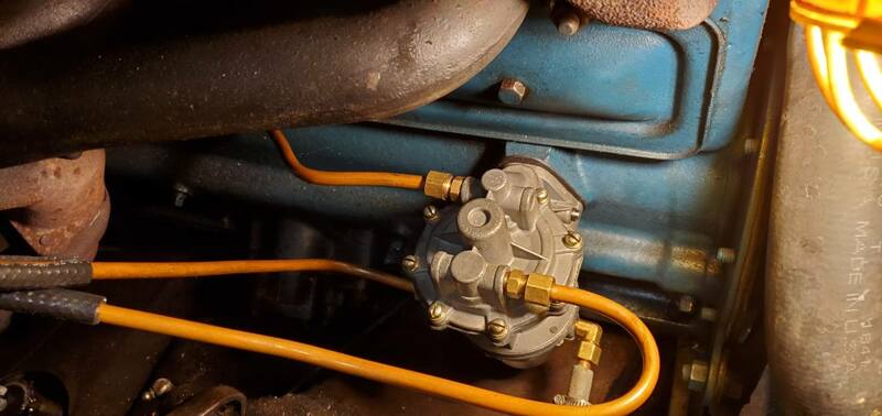

PhilA Posted April 12, 2021 Author Posted April 12, 2021 Reassembly, complete! It even works. RayMK, Tickman and Jenson Velcro 3
Zelandeth Posted April 12, 2021 Posted April 12, 2021 How the blazes do you get copper lines so neat? I'm downright embarrassed to show my efforts from routing new brake lines...
PhilA Posted April 12, 2021 Author Posted April 12, 2021 14 minutes ago, Zelandeth said: How the blazes do you get copper lines so neat? I'm downright embarrassed to show my efforts from routing new brake lines... I found lots of forms to bend them round. Paint cans etc; you have to do them little at a time and let the metal "do the work", else as you know, it just kinks.
