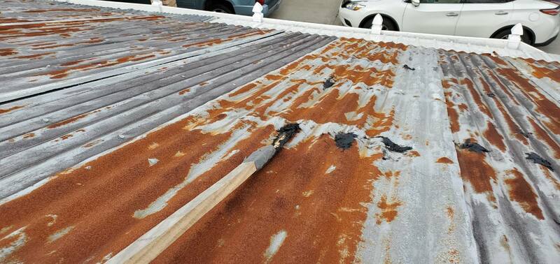

PhilA Posted March 24, 2021 Author Posted March 24, 2021 Patched up as many of the holes in the roof as I could see. Phil BlankFrank 1
PhilA Posted March 24, 2021 Author Posted March 24, 2021 It rained again. Wipers work Phil BlankFrank, Tickman, loserone and 4 others 7
GeorgeB Posted March 25, 2021 Posted March 25, 2021 20 hours ago, PhilA said: Patched up as many of the holes in the roof as I could see. Phil I thought you replaced that roof a few weeks ago?
PhilA Posted March 25, 2021 Author Posted March 25, 2021 9 minutes ago, GeorgeB said: I thought you replaced that roof a few weeks ago? The next level down I did, you can just about see the white over the edge of the roof there. Only replaced the parts that blew away and got totally mangled.
GeorgeB Posted March 25, 2021 Posted March 25, 2021 14 minutes ago, PhilA said: The next level down I did, you can just about see the white over the edge of the roof there. Only replaced the parts that blew away and got totally mangled. Ah, yes, I see now you point it out. Why do they build houses in a hurricane zone out of wood and tin?
PhilA Posted March 25, 2021 Author Posted March 25, 2021 5 minutes ago, GeorgeB said: Ah, yes, I see now you point it out. Why do they build houses in a hurricane zone out of wood and tin? Because brick is prohibitively expensive. Plus, a tornado will relocate a brick house as easily as a wooden one. Rab 1
GeorgeB Posted March 25, 2021 Posted March 25, 2021 18 minutes ago, PhilA said: Because brick is prohibitively expensive. Plus, a tornado will relocate a brick house as easily as a wooden one. Tornadoes may lift the roof off a brick house (if they are badly built) but they won't do much damage to the structure. Why are bricks expensive? There must be plenty of clay in the USA?
PhilA Posted March 25, 2021 Author Posted March 25, 2021 49 minutes ago, GeorgeB said: Tornadoes may lift the roof off a brick house (if they are badly built) but they won't do much damage to the structure. Why are bricks expensive? There must be plenty of clay in the USA? Down here, bricks are expensive. The price varies with his far you have to move them. I take it you've not seen a brick house demolished by as tornado before?
GeorgeB Posted March 25, 2021 Posted March 25, 2021 3 hours ago, PhilA said: I take it you've not seen a brick house demolished by as tornado before? No I haven't. Have you?
PhilA Posted March 26, 2021 Author Posted March 26, 2021 40 minutes ago, GeorgeB said: No I haven't. Have you? Yup. It's not the wind that does the damage. It's all the junk that it picks up and smashes into things that does. The roof was pulled off the house by the wind, then a tree that was uprooted on the next street smashed the front corner off the house and a good portion of the house then collapsed because it lost integrity. mercedade 1

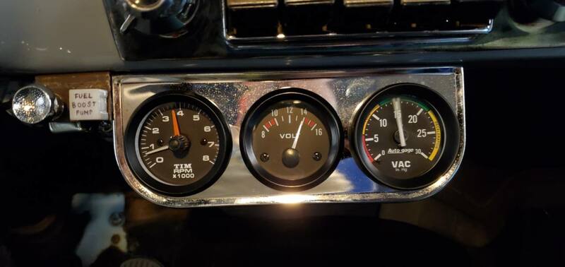

PhilA Posted March 30, 2021 Author Posted March 30, 2021 I fitted my new gauges. Handy things to know; the vacuum gauge has already proven useful because it was rhythmically bouncing at idle, telling me it's time to look at the valve clearances again. LightBulbFun 1
LightBulbFun Posted March 30, 2021 Posted March 30, 2021 7 hours ago, PhilA said: I fitted my new gauges. Handy things to know; the vacuum gauge has already proven useful because it was rhythmically bouncing at idle, telling me it's time to look at the valve clearances again. the tach is hilarious surely they make ones for diesels or something that only go up to 4K-5K so most of the gauge is not just sitting there twiddling its thumbs?
PhilA Posted March 30, 2021 Author Posted March 30, 2021 48 minutes ago, LightBulbFun said: the tach is hilarious surely they make ones for diesels or something that only go up to 4K-5K so most of the gauge is not just sitting there twiddling its thumbs? They do, but I had that one in stock already. It works well enough. LightBulbFun 1
Zelandeth Posted March 30, 2021 Posted March 30, 2021 5 hours ago, LightBulbFun said: the tach is hilarious surely they make ones for diesels or something that only go up to 4K-5K so most of the gauge is not just sitting there twiddling its thumbs? Volvo B10 one wouldn't be far off! PhilA and LightBulbFun 1 1
PhilA Posted March 30, 2021 Author Posted March 30, 2021 Quite a lot of older boats had a 3500-3700 RPM redline, so 0-4000 tachs are available. I just didn't want to pay for one. LightBulbFun 1
Zelandeth Posted March 30, 2021 Posted March 30, 2021 5 minutes ago, PhilA said: Quite a lot of older boats had a 3500-3700 RPM redline, so 0-4000 tachs are available. I just didn't want to pay for one. Having looked at quite a few listings for nautical kit when I was hunting for a cylinder head temperature gauge, I can understand that! LightBulbFun 1
LightBulbFun Posted March 30, 2021 Posted March 30, 2021 6 minutes ago, PhilA said: Quite a lot of older boats had a 3500-3700 RPM redline, so 0-4000 tachs are available. I just didn't want to pay for one. I wonder can you modify your existing one so at 4K it shows as 8K then you can just make a new backing for the dial to bring it back to 4K if that makes sense? (sort of like what you did to modify one for 2 Cylinder engines?)
PhilA Posted March 30, 2021 Author Posted March 30, 2021 6 minutes ago, LightBulbFun said: I wonder can you modify your existing one so at 4K it shows as 8K then you can just make a new backing for the dial to bring it back to 4K if that makes sense? (sort of like what you did to modify one for 2 Cylinder engines?) It's 4/6/8 switchable on the back, so setting it to 4 does that. Taking it apart necessitates un-peening the bezel, taking the needle off, making a new face, putting it all back together. That is a level of arse-ache I am unwilling to expend for a 2" tacho. LightBulbFun 1
