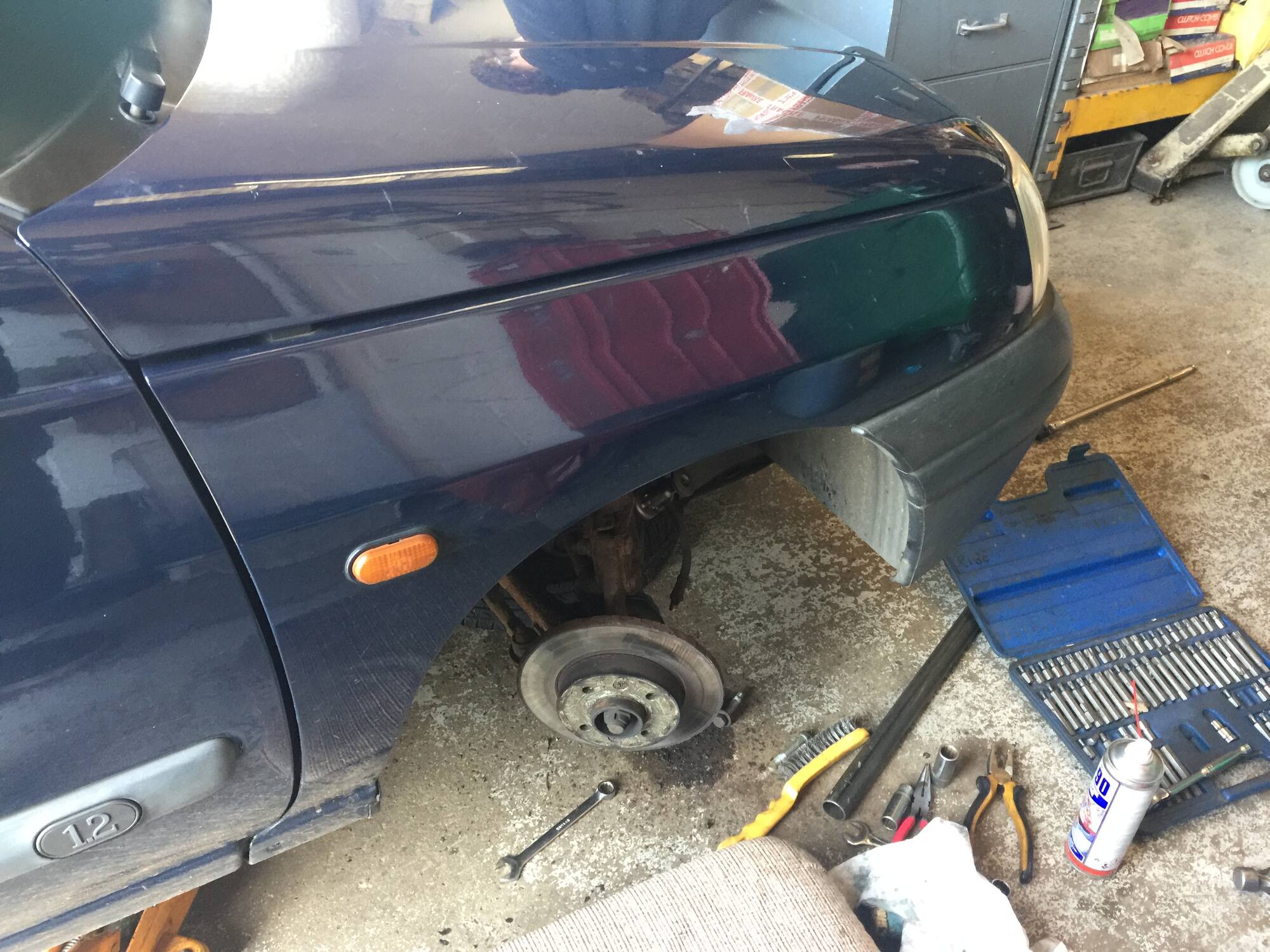

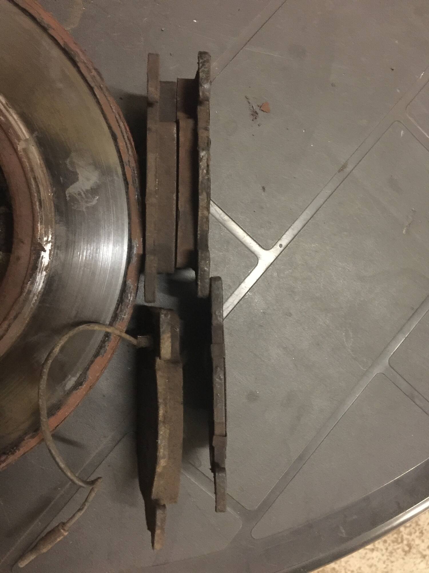

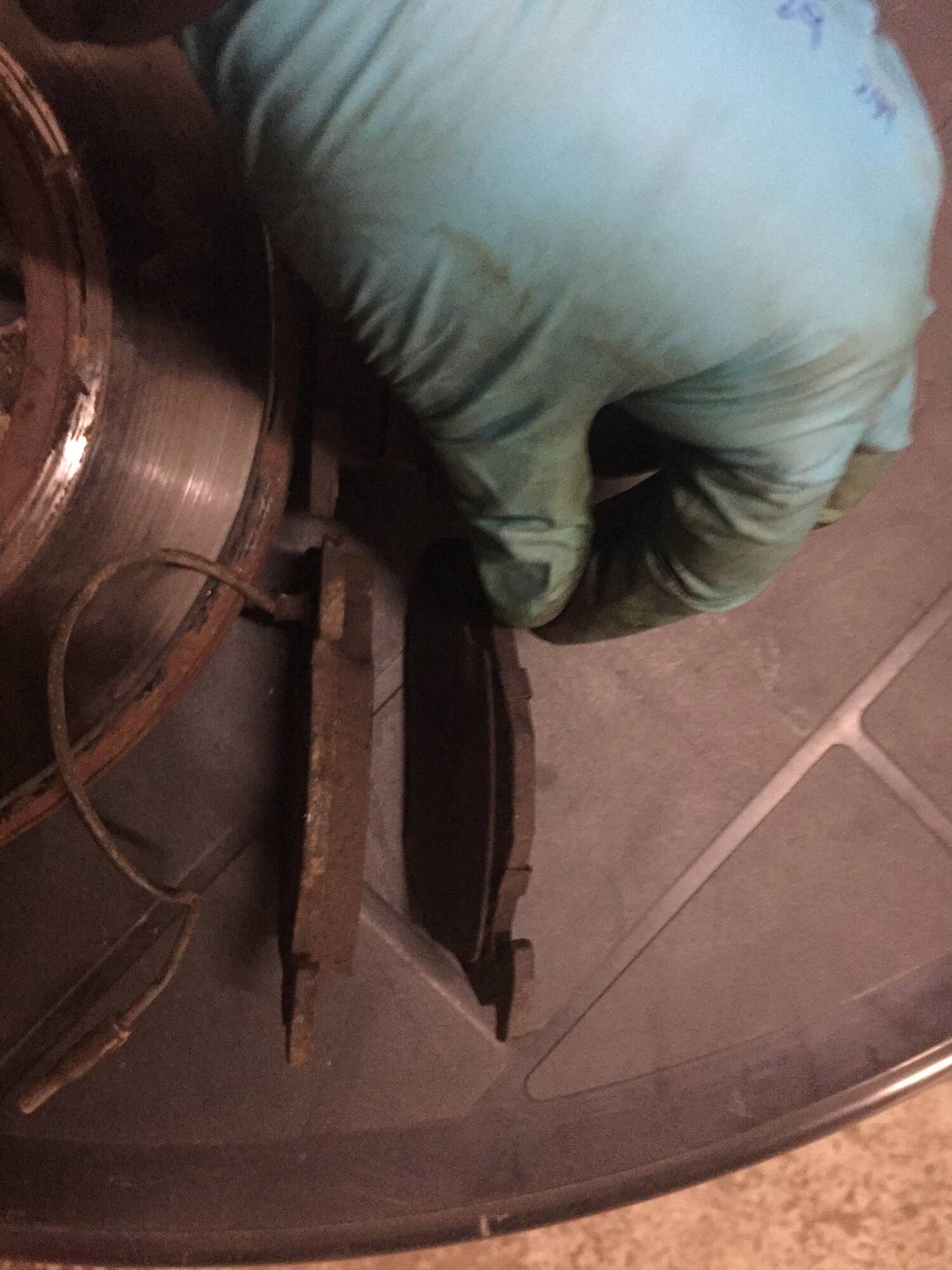

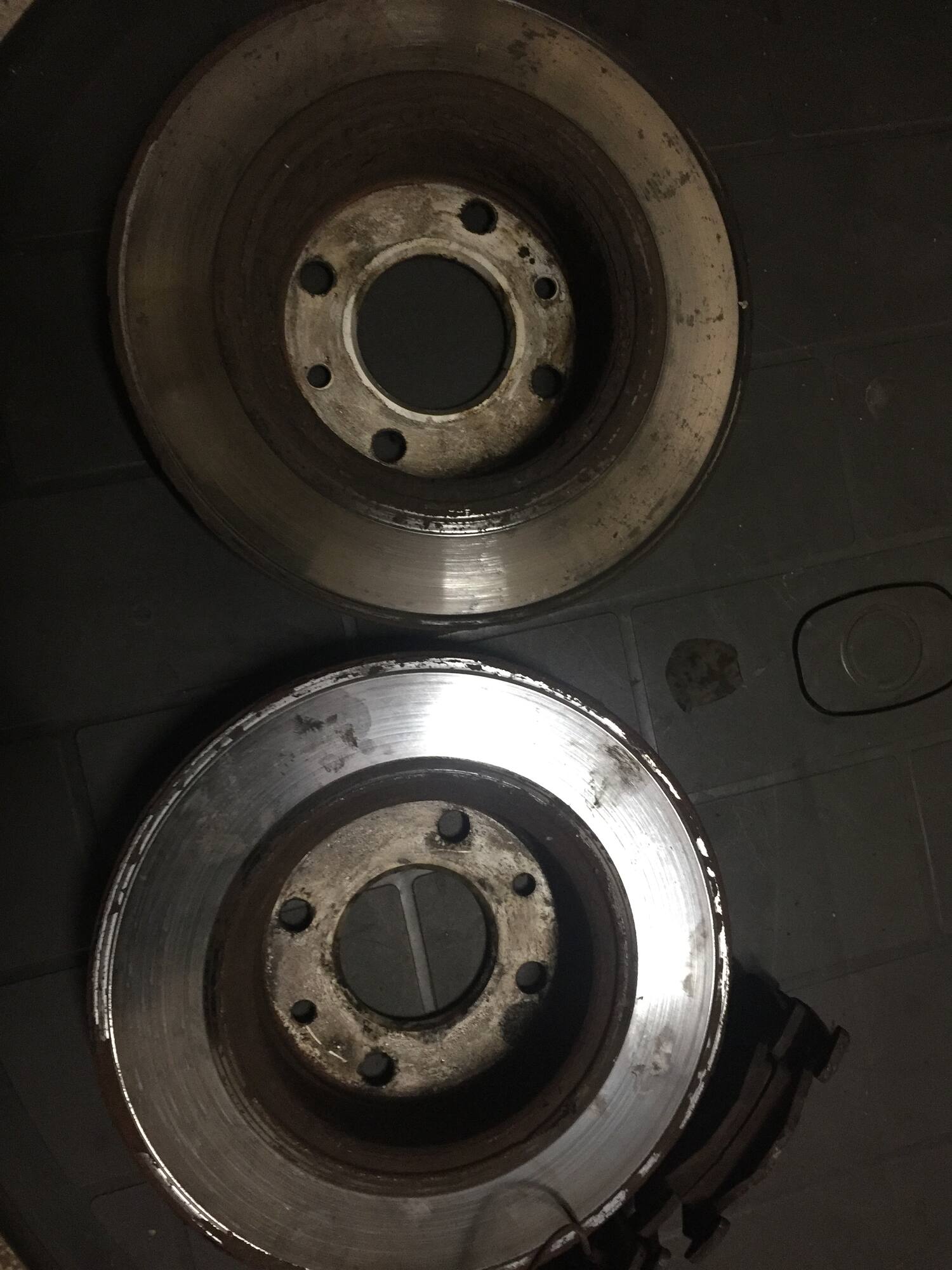

So, the drivers side caliper was sticking and one pad was worn right down. The discs were pretty worn too!
I removed the piston from the caliper and cleaned all the gunk off it before refitting with a new seal. Also stripped and greased the sliders. Had to do the same on the passenger side too as one slider was seized there as well! I managed to break the pad retaining plate with my ham-fistedness so blobbed some pigeons shit on to repair it.
The disc retaining screws didn’t want to know! I tried everything short of drilling them out (heat, intact driver, breaker bar) and nothing would shift them. This was compounded by them being a stupid torx head and our torx bit was twisting! I eventually went to the garage next to work and asked their advice. They lent me a very powerful Milwaukee cordless impact gun and a decent quality torx bit. That got them shifted!
Of course I forgot to take any pictures once it was all back together, but just imagine it with shiny new discs and pads.

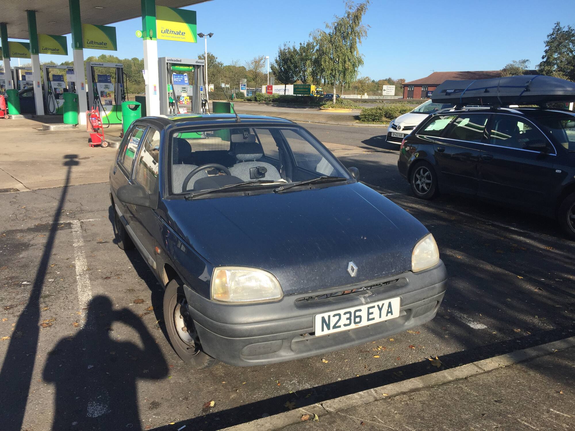

The petrol station shot was somewhere near Cambs on route to Sheffield. I met up with a mate in Sheffield while up there, he had a go in the Clio and liked it apart from the vague steering which he commented on! It is pretty bad by modern standards but I think I can change the drivers side tie rod rather than the whole rack.

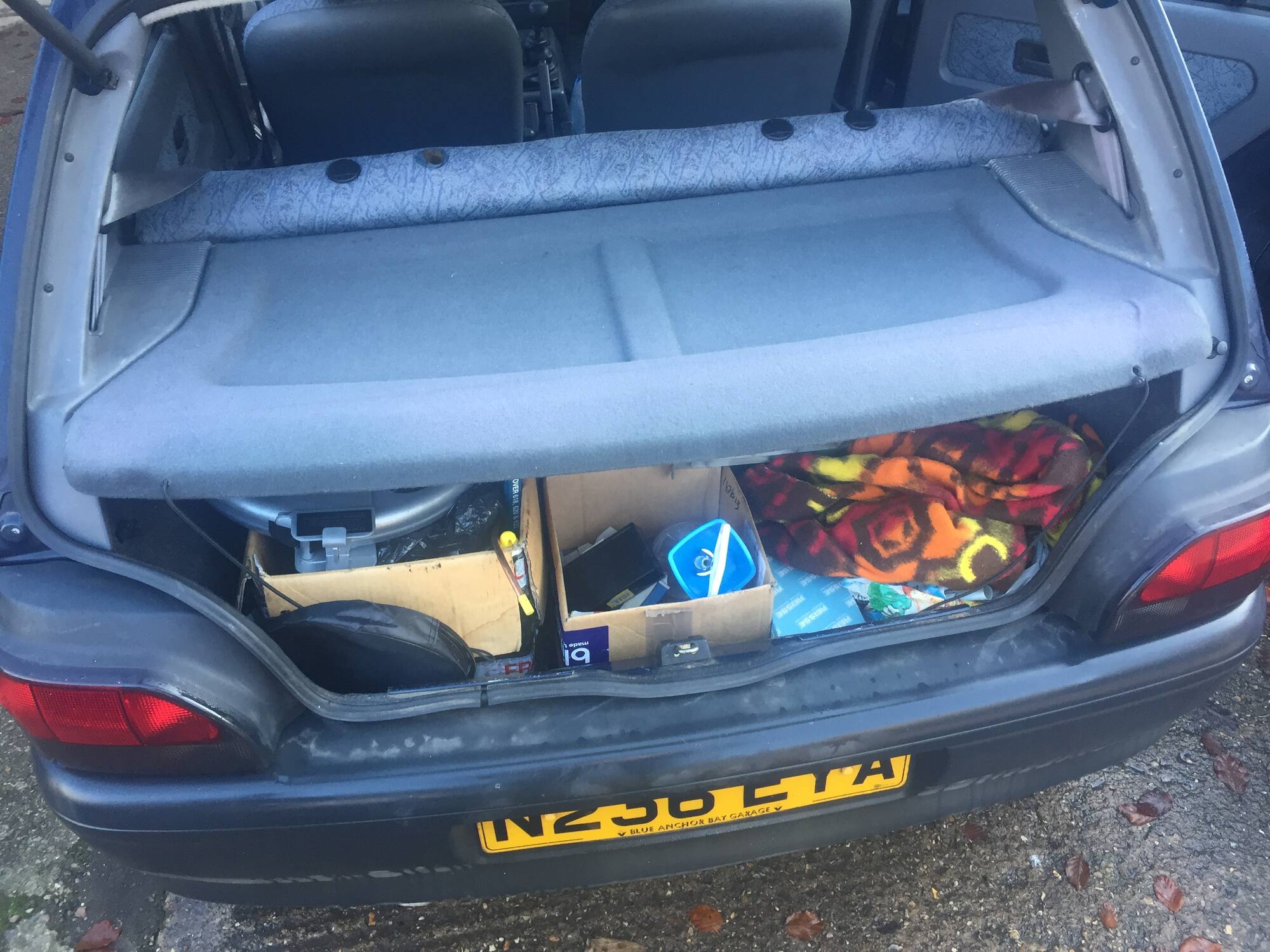

lastly, many thanks to the AS legend Rave who kindly donated Chloe a parcel shelf as the original had gone missing. It arrived safely and i fitted it yesterday (round at the garage). One of the plastic clips on the car is broken so I just wrapped the string around it for the moment!

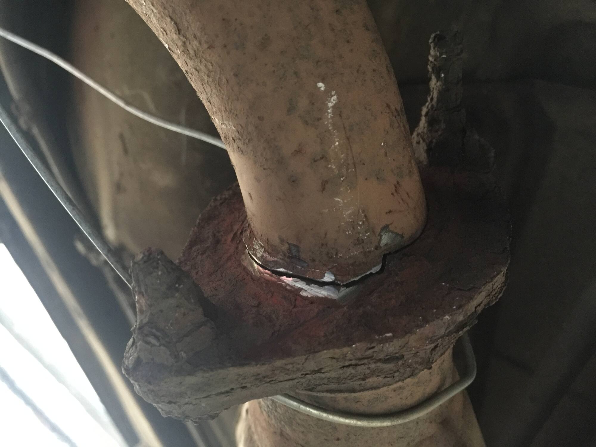

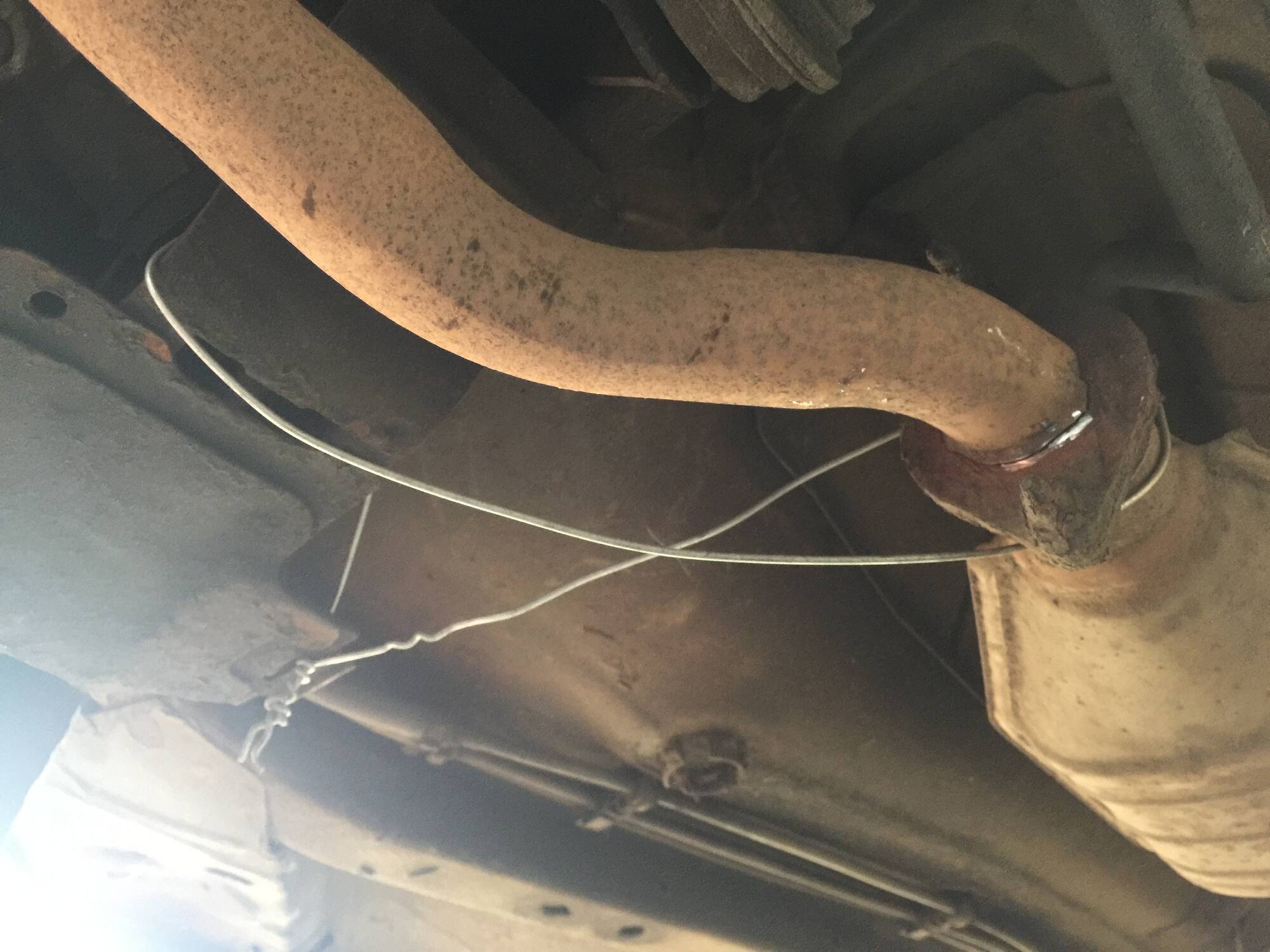

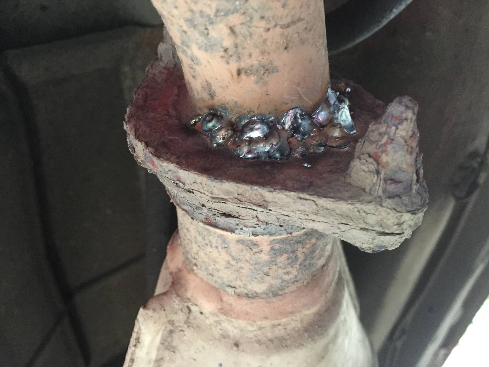

Other Clio bodgery/temporary repairs that have taken place recently include the front exhaust which decided to crack almost all the way through just in front of the cat. The Clio exhaust is a poor design with not much support and I was concerned about it falling off as it wasn’t far off doing so:
I found an old style coat hanger and untwisted it with a pair of pliers, and used it to attach the exhaust to the subframe, to prevent it falling off to get me to work for a week until I could repair it properly*
Then I halfarsedly cleaned it up and blobbed some pigeon shit onto it. A Mig welder has to be one of the most important tools in the shite car fixer’s/bodger’s arsenal.
All fixed!

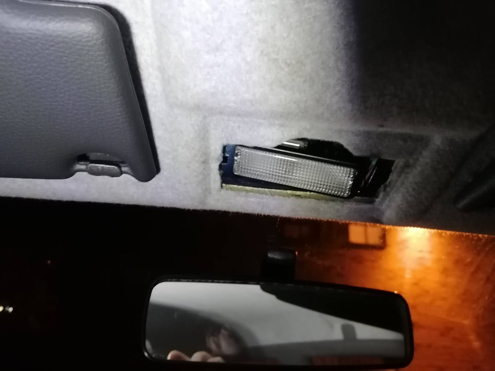

So far, apart from use it, I have thrown a temporary interior light in (from my AX), and sorted the history file into my sort of standard.

I'm amazed the AX had the same wiring plug for the interior light. Must have been the same supplier that supplied the lights to Renault and PSA.
