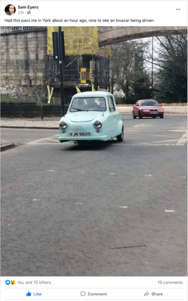

Eyersey1234 Posted March 7, 2021 Posted March 7, 2021 Was the one I papped yesterday a private one or a DHSS one when it was new?

Eyersey1234 Posted March 7, 2021 Posted March 7, 2021 3 hours ago, AdgeCutler said: Hello folks and thank you for allowing into the fold. Around 38 years ago or there abouts I found myself interested in Invacars, I used to see a type 70 down the road from my grandmothers house. Anyhow, about ten years ago I started to think I should try to track one down but to no avail, I did get sorely tempted by a mark 12 in Ireland about 18 months ago but that time around I came to my senses. I'm just coming to the end of a project and started to re-invigorate my search, this time using the interweb, not just word of mouth and have found myself here and also on FaceAches Microcar world. Yesterday I ended up collecting a Mk12 car that if I had any sense I would have walked away from. Basically I have a chassis plate, two seized engines and gearboxes, three damaged fibreglass panels, a small assortment of detritus and the rest can only be classed as patterns to work from. There are a few little things I'm a bit worried about but most is quite simple to replicate given time and hopefully advice from the likes of the members of such forums as this. As a first question if I may, does anybody know where I might start a search for wheels for this vehicle and if they were used on other applications? Welcome to the forum. LightBulbFun and AdgeCutler 2
LightBulbFun Posted March 7, 2021 Author Posted March 7, 2021 7 hours ago, Eyersey1234 said: Was the one I papped yesterday a private one or a DHSS one when it was new? twas a Ministry machine all Model 70's on the road as of time of writing are Ex Ministry machines (which is all the more amusing when someone says "I thought they where all destroyed or banned" and someone responds "Ministry ones where but a few where privately owned" like to say that the Model 70 they saw must be a private example!) very few Private Model 70's existed in the first place and as such very few survive today RRE20L, JNJ135L, NPN924P, and REV451R are the only private Model 70's I know to still survive (and RRE20L only survives by the skin of its fibreglass gel-coat) sadly none of those are on the road as of writing JNJ548N is also a private example, that may survive but its not one iv been able to verify, however it was last taxed in 2008 and had a keeper change in 2009 and shows no scrapped marker so I would like to think it survives somewhere as Id like to think by 2008-2009 they would have been becoming more notable, for example I know in 2008 the first Ministry Model 70 hit the road properly under its original registration etc without any ringing shenanigans (MHJ22P) but I dont know for sure if it survives, I sadly dont even have a picture of it, and the only picture I know exists of it is from the 1990s IIRC
LightBulbFun Posted March 7, 2021 Author Posted March 7, 2021 4 hours ago, AdgeCutler said: Hello folks and thank you for allowing into the fold. Around 38 years ago or there abouts I found myself interested in Invacars, I used to see a type 70 down the road from my grandmothers house. Anyhow, about ten years ago I started to think I should try to track one down but to no avail, I did get sorely tempted by a mark 12 in Ireland about 18 months ago but that time around I came to my senses. I'm just coming to the end of a project and started to re-invigorate my search, this time using the interweb, not just word of mouth and have found myself here and also on FaceAches Microcar world. Yesterday I ended up collecting a Mk12 car that if I had any sense I would have walked away from. Basically I have a chassis plate, two seized engines and gearboxes, three damaged fibreglass panels, a small assortment of detritus and the rest can only be classed as patterns to work from. There are a few little things I'm a bit worried about but most is quite simple to replicate given time and hopefully advice from the likes of the members of such forums as this. As a first question if I may, does anybody know where I might start a search for wheels for this vehicle and if they were used on other applications? Hello! welcome aboard nice to have another fellow Invacar owner on the forum do you mind if I ask where/who you got this Mk12 from? it sounds a lot like the one Big Al had for sale recently (which he has marked as sold) but it looked like it was in a bit better condition then you described, given he was showing a complete car! I do wonder what happened to that Invacar Mk12 ONO454D in NI, last I heard it was sold to some AC Racers to use as a pit lane car which is a little worrisome as I would hate to see it hacked about and modified as it was/hopefully still is one of the few Mk12's still in decent shape! likewise wonder what happened to that Invacar Mk12 that was for sale in South Africa of all places! anyways pondering of where various Mk12's have ended up aside the wheels your looking for are Dunlop LP 591 wheels I sadly do not know if these where used outside of the DHSS however in a pinch Mini Dunlop LP 1161 wheels should work as they have the same PCD and offset (you find them easier by omitting the LP and searching simply for Dunlop 1161 or by their British leyland part number 21A2744) although I have personally never seen a Mk12 fitted with a set of 10 inch wheels, I know the Model 70 of course transitioned from Dunlop LP 591 wheels to 1161 wheels, and I know at least one AC Acedes Mk14 or Mk14A that has been fitted with them as well so id like to think they would fit, but they are slightly wider (145R10 vs 125R12 or 5.20-10 vs 4.40-12 in old money) so keep that in mind and it is critical you specifically get 591 or 1161 wheels as if you get something with the wrong offset, your front wheel will suddenly be out of the centre line of the car and gawd knows what that would do to the handling LOL Mrs6C 1
Eyersey1234 Posted March 7, 2021 Posted March 7, 2021 2 hours ago, LightBulbFun said: twas a Ministry machine all Model 70's on the road as of time of writing are Ex Ministry machines (which is all the more amusing when someone says "I thought they where all destroyed or banned" and someone responds "Ministry ones where but a few where privately owned" like to say that the Model 70 they saw must be a private example!) very few Private Model 70's existed in the first place and as such very few survive today RRE20L, JNJ135L, NPN924P, and REV451R are the only private Model 70's I know to still survive (and RRE20L only survives by the skin of its fibreglass gel-coat) sadly none of those are on the road as of writing JNJ548N is also a private example, that may survive but its not one iv been able to verify, however it was last taxed in 2008 and had a keeper change in 2009 and shows no scrapped marker so I would like to think it survives somewhere as Id like to think by 2008-2009 they would have been becoming more notable, I know in 2008 the first Ministry Model 70 hit the road properly under its original registration without any ringing shenanigans for example (MHJ22P) but I dont know for sure if it survives, I sadly dont even have a picture of it, and the only picture I know exists of it is from the 1990s IIRC Funnily enough one of the comments on my Faceache page yesterday was I thought they were banned. Very satisfying to set the record straight. LightBulbFun 1
LightBulbFun Posted March 7, 2021 Author Posted March 7, 2021 4 minutes ago, Eyersey1234 said: Funnily enough one of the comments on my Faceache page yesterday was I thought they were banned. Very satisfying to set the record straight. indeed it is do you have a link to your facebook page/the post you made? I like to monitor the comments of Invacar related posts I find on social media etc (or is it a closed group etc?)
Eyersey1234 Posted March 7, 2021 Posted March 7, 2021 13 minutes ago, LightBulbFun said: indeed it is do you have a link to your facebook page/the post you made? I like to monitor the comments of Invacar related posts I find on social media etc (or is it a closed group etc?) No its not a closed group I'll see if I can post a link to it https://m.facebook.com/story.php?story_fbid=10208029877820042&id=1691670002 That should work
LightBulbFun Posted March 7, 2021 Author Posted March 7, 2021 6 minutes ago, Eyersey1234 said: No its not a closed group I'll see if I can post a link to it https://m.facebook.com/story.php?story_fbid=10208029877820042&id=1691670002 That should work Link is broken sadly, both in the orignial mobile from you sent it in and same for when I remove the "m." from the URL to switch it to the desktop site

Eyersey1234 Posted March 7, 2021 Posted March 7, 2021 Just now, LightBulbFun said: Link is broken sadly, both in the orignial mobile from you sent it in and also when I remove the "m." from the URL to switch it to the desktop sites Wonder if it's because my settings are set to friends, sorry didn't think of that before posting it LightBulbFun 1
Eyersey1234 Posted March 7, 2021 Posted March 7, 2021 3 minutes ago, LightBulbFun said: Link is broken sadly, both in the orignial mobile from you sent it in and also when I remove the "m." from the URL to switch it to the desktop sites I've changed the settings for that post, let's try again https://m.facebook.com/story.php?story_fbid=10208029877820042&id=1691670002
somewhatfoolish Posted March 7, 2021 Posted March 7, 2021 3 minutes ago, Eyersey1234 said: Let me know if that has worked or not please I can see it now. Eyersey1234 1
LightBulbFun Posted March 7, 2021 Author Posted March 7, 2021 13 minutes ago, Eyersey1234 said: Let me know if that has worked or not please Yerp works for me now Mrs6C and Eyersey1234 2
