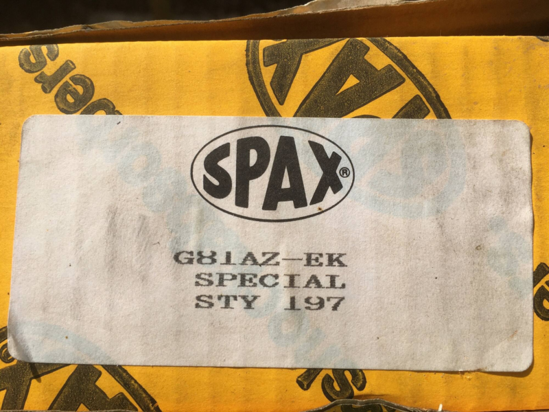

LightBulbFun Posted June 29, 2020 Author Posted June 29, 2020 On 6/14/2020 at 7:11 PM, LightBulbFun said: continuing the exciting/interesting Model 70 news, @st185cs shared with me just now this rather interesting letter he found with a NOS Front Coil-over he has in his personal spares stash its very interesting to me, because It answers a few questions I had in that my research showed me that, although most Model 70's today have Adjustable spax's fitted all round (including REV AFAIK!) that the Model 70 would have originally equipped with armstrong shocks all round, indicating the Spax's would have been a later in life fitment so I had wondered what exactly was the deal there, being adjustable, where they preset from the factory/DHSS Stores, or did the AR have to adjust them to spec before fitting them? It would be interesting to see the same letter for the rear spax shocks, but we have not come across one yet sadly the box for the coil-over as well as having the DHSS Store No on it STY197 has what looks to be the spax part number? on it I wonder if spax has any info on these Model 70 shocks still? it would also be interesting to hear if anyone familiar with Spax shocks has anything to say on it all continuing the shocks stuff @st185cs has just managed to unearth the same paperwork but for the rear shocks this time its interesting to see that the rears are set to 7 clicks clockwise compared to 5 clicks clockwise of the front shock obviously they are not the same type so its not going to be directly comparable but its still interesting to see and makes sense the rears would be firmer then the front as the rear is where most of the weight is I wonder @st185cs do you happen to have the box of one of the rear spax shocks may have come in? would be interesting to see what its Spax part number is (well at least I assume on the front shocks in my quoted post that "G81AZ-EK" is the spax PN for them, along with the STY number of course which I know is the DHSS Store No/PN for them) as a side note its interesting to note that STY228 is not actually listed in my Parts list but is listed in the index sheet at the end go figure! its also interesting to note that it has the same 5 Dec 1991 date as the letter for the rear shocks which further makes me think that is when Spax shocks where introduced, and helps gives me some rough idea of when REV (and other Model 70's) was last fettled because she is fitted with Spax shocks all round IIRC! Mrs6C 1
Mr Pastry Posted June 29, 2020 Posted June 29, 2020 10 minutes ago, LightBulbFun said: "G81AZ-EK" is the spax PN for them, That is the Spax number though the format has now changed somewhat. It is normally stamped on the unit, at the bottom near the adjuster, not always easy to read with the unit in place. Mrs6C and LightBulbFun 2

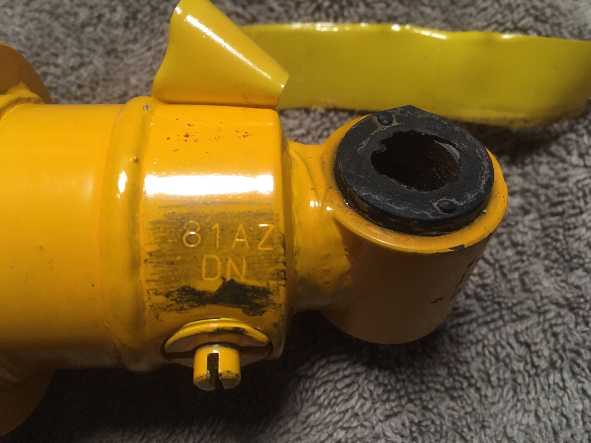

LightBulbFun Posted June 29, 2020 Author Posted June 29, 2020 4 minutes ago, Mr Pastry said: That is the Spax number though the format has now changed somewhat. It is normally stamped on the unit, at the bottom near the adjuster, not always easy to read with the unit in place. ah cool, good to know ill have to keep an eye out for it do you know if the PNs are decodable into anything or are they just randomly assigned digits/letters? as I type this up a picture of the box has arrived from @st185cs and its interesting to note how it is only 1 digit off from the front shock, so they are obviously part of the same series or created together or something such if that makes sense! (I do notice the EK is missing off the end of the part number rear shocks, I wonder if thats because the front is a shock+spring unit ie a complete coil-over unit, where as on the rear suspension the shocks and springs are separate parts so the rear shocks would just be rear shocks no springs) Mrs6C 1
LightBulbFun Posted June 29, 2020 Author Posted June 29, 2020 like clockwork! from @st185cs (wonder what the DN means? also interesting to see what the adjuster actually looks like! or at least I assume thats the adjuster!) Mrs6C 1
Mr Pastry Posted June 29, 2020 Posted June 29, 2020 That is the adjuster. The numbers can be decoded up to a point, but I'm not too familiar with that early format. The G means gas filled which most are. I don't know the suffix letters. a different system is now used but as you guessed they do indicate things like whether it has a spring seat. I don't think I have the catalogue now unfortunately. IIRC the number was frequently 1 digit apart for front and rear on the same vehicle but it wasn't entirely logical. There was almost no interchangeability between vehicles (at least officially) they all had dedicated part numbers. There was and presumably still is a standard range of competition car dampers in a range of sizes, which would be the place to start for equivalents. Not cheap tho. somewhatfoolish, LightBulbFun and Mrs6C 3

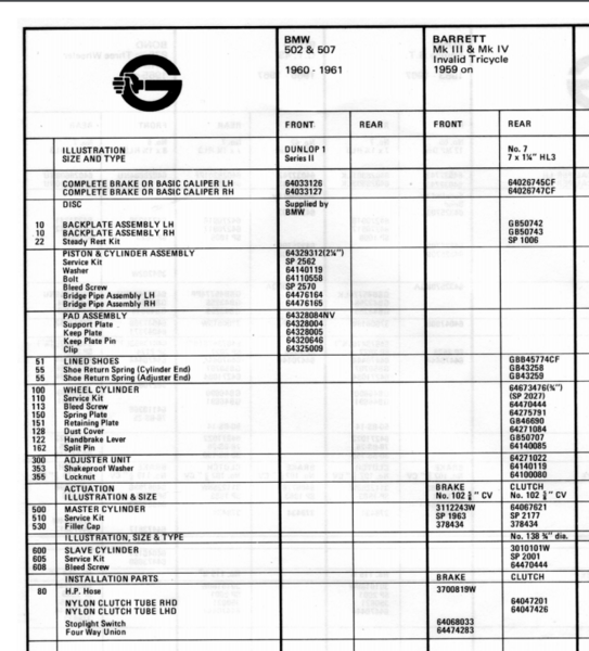

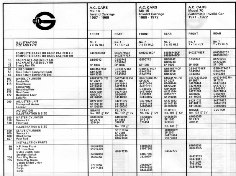

Mr Pastry Posted June 30, 2020 Posted June 30, 2020 49 minutes ago, LightBulbFun said: so that solves the brake shoes issue at least Herald/Spitfire rears, also Marina and some Escorts. LightBulbFun and egg 2
LightBulbFun Posted June 30, 2020 Author Posted June 30, 2020 13 minutes ago, Mr Pastry said: Herald/Spitfire rears, also Marina and some Escorts. ah cool thats good to know! I was wondering what they where shared with I did google GBB45774CF but only came across a couple scant mentions of spitfire's im guessing they may be listed under different part numbers these days? (especially as I imagine manufacturers other then girling probably made/make compatible shoes etc and others may be listed under say Triumphs own PN system etc!) I did google Spitfire rear brake shoes and they seem to match and are look to be relatively plentiful so thats good!
Mr Pastry Posted June 30, 2020 Posted June 30, 2020 14 minutes ago, LightBulbFun said: im guessing they may be listed under different part numbers these days? I think you'll find that classic parts suppliers like Moss and Rimmers use a mixture, but mostly the car manufacturer's numbers. IMO a decent parts list with sources and equivalents is about the most useful thing you can do if you want to keep the cars running. LightBulbFun and bobdisk 2
bobdisk Posted June 30, 2020 Posted June 30, 2020 Page 22 has Tippen "Invalid Carriage" info. https://irp-cdn.multiscreensite.com/94895fc8/files/uploaded/GIRLING VEHICLE APPLICATIONS. RENAULT. RILEY. SAAB%2C STANDARD. SUNBEAM%2C TVR%2C TRIUMPH%2C TURNER%2C 1960-1980.pdf There must be another PDF that covers between E and R, but I cant find it as yet. LightBulbFun 1
LightBulbFun Posted June 30, 2020 Author Posted June 30, 2020 2 hours ago, Mr Pastry said: I think you'll find that classic parts suppliers like Moss and Rimmers use a mixture, but mostly the car manufacturer's numbers. IMO a decent parts list with sources and equivalents is about the most useful thing you can do if you want to keep the cars running. yeah thats exactly what id like to do for as many parts as possible, sadly although the Model 70 is the literal definition of a parts bin car, it seems like the parts that are in the most demand are the few that are unique like exhausts fuel tanks and body work 41 minutes ago, bobdisk said: Page 22 has Tippen "Invalid Carriage" info. https://irp-cdn.multiscreensite.com/94895fc8/files/uploaded/GIRLING VEHICLE APPLICATIONS. RENAULT. RILEY. SAAB%2C STANDARD. SUNBEAM%2C TVR%2C TRIUMPH%2C TURNER%2C 1960-1980.pdf There must be another PDF that covers between E and R, but I cant find it as yet. Oh very cool find! I did go looking for the sheets that may contain Invacar but yeah couldn't find anything, but I dont think I ever thought to go look for Tippen, but did make me wonder what other IC's are listed and how obscure it would go, and at least Barret is listed as well 1959 and onwards would imply Barret Midget given even barret is listed Invacar (and the others like Stanley/harper as well) must surely be listed somewhere! I wonder if the Invacar section has the Model 70 listed there as well or not
LightBulbFun Posted June 30, 2020 Author Posted June 30, 2020 ah here we go did some quick googling and found it, looks familiar I think I may have actually come across it before! https://www.northwestautomotivehydraulics.co.uk/contact https://irp-cdn.multiscreensite.com/94895fc8/files/uploaded/VEHICLE APPLICATIONS GINETTA. GORDON. HILLMAN. HOLDEN. HUMBER. ISO. JAGUAR. JENSEN. LAGONDA. LAMBORGHINI. LANCIA%2C LOTUS. 1960-1980.pdf

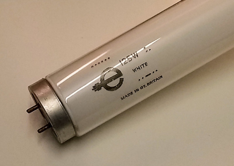

LightBulbFun Posted June 30, 2020 Author Posted June 30, 2020 a little bit off topic but I had been wondering why the girling logo looked so awfully familiar to me finally hit me why! its very similar to the logo of the "electra" brand the electricity board used back in the day as seen on this tube here (sadly not mine!) Mrs6C 1
High Jetter Posted June 30, 2020 Posted June 30, 2020 It wouldn't take much to turn it into the London 'tube' logo either LightBulbFun 1
greengartside Posted July 1, 2020 Posted July 1, 2020 That’s the logo that Eastern Electricity used to use back in the 80’s! LightBulbFun 1

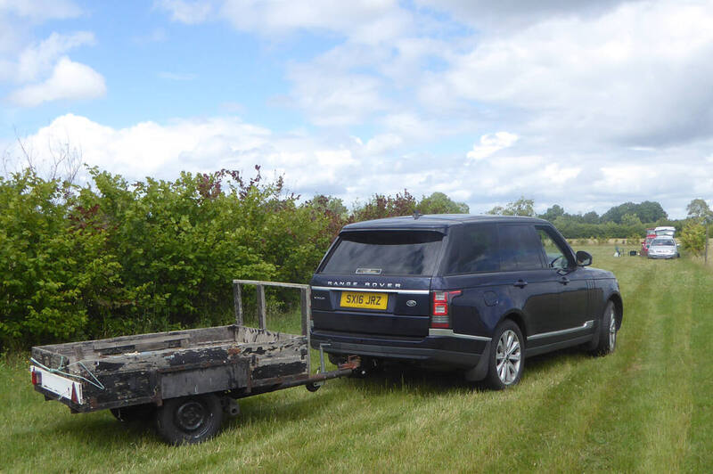

Six-cylinder Posted July 1, 2020 Posted July 1, 2020 Last Sunday the Invacar trailer went for a ride to a new parking spot. LightBulbFun, egg and keef 2 1
LightBulbFun Posted July 1, 2020 Author Posted July 1, 2020 Just now, Six-cylinder said: Last Sunday the Invacar trailer went for a ride to a new parking spot. Oh cool it actually trailers! see actual usefulness* im not* completely off my rocker! BlankFrank 1
Six-cylinder Posted July 1, 2020 Posted July 1, 2020 27 minutes ago, LightBulbFun said: Oh cool it actually trailers! see actual usefulness* im not* completely off my rocker! Not sure about "useful", it was in the way and had to be shifted! egg and LightBulbFun 1 1
LightBulbFun Posted July 1, 2020 Author Posted July 1, 2020 5 minutes ago, Six-cylinder said: Not sure about "useful", it was in the way and had to be shifted! one of the lights was robbed off the trailer board to help* diagnose the CX was it not? besides not long to the FoD open week, so not long until its gaffer taped to the rear of a moped (or the JingLing!) and filled with various members of @catsinthewelder's family Autoshite chariot racing maybe? LOL
