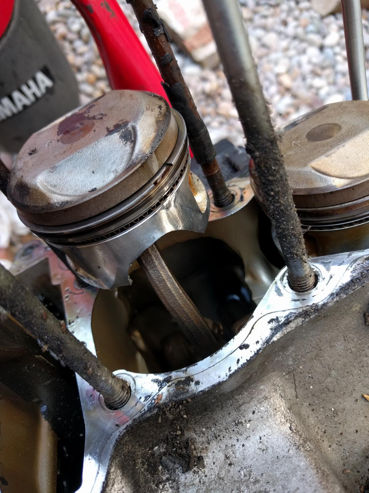

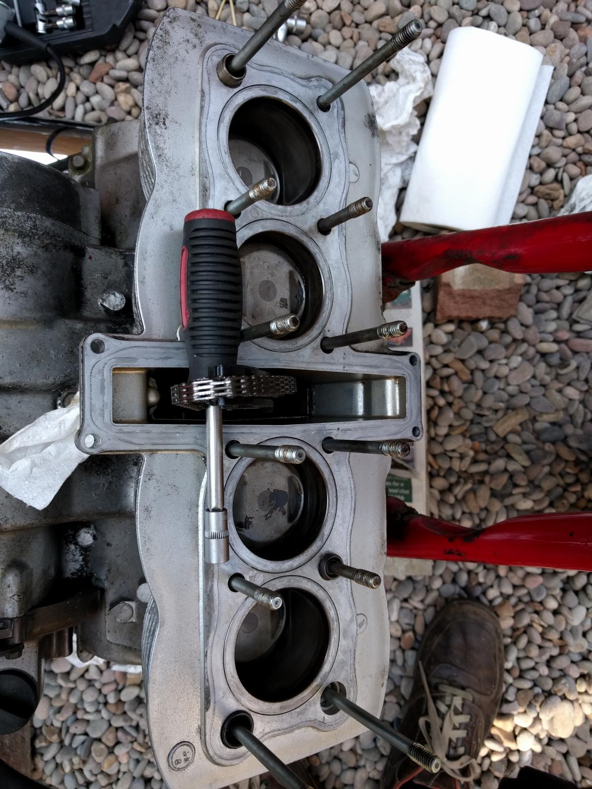

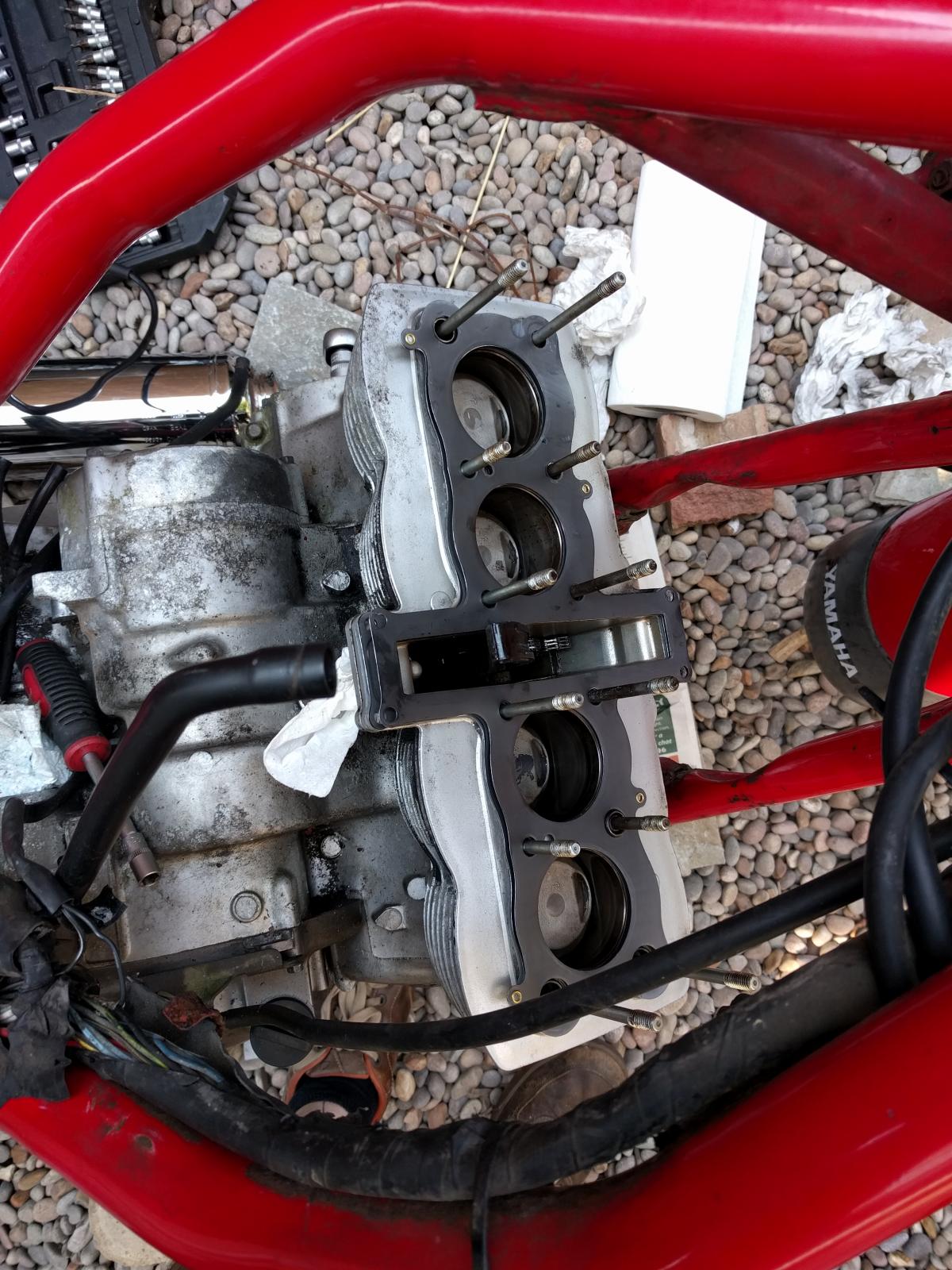

tobyd Posted July 7, 2018 Author Posted July 7, 2018 Raft of bits arrived over the week so got cracking. New head gasket, a carb that is mostly ok just needed a light clean and some new screws (and 4 rebuild kits but we'll see about that closer to the time), sump and clutch cover gaskets, valve seals, fuel hose and vac line and new plugs. cleaned up carb Lapped in the valves and cleaned and reassembled the head, new stem seals. cleaned up the piston crowns a bit and removed a little of the crust on the edges of the cylinders but not that much. new gasket (this is backwards though...) popped head back on whilst disassembling I think I dropped a washer down the tensioner hole so thought i'd fish it out of the sump. took forever to knock the sump free. ah shit... Shrapnel. but from what? looks a bit thick to be piston skirt and what else did it take with it before it came to rest? I've not tightened the head down yet so contemplating pulling the barrel to see if anythings come adrift from a piston. 75p stainless steel cleaner from wilko bought the exhaust up pretty nicely in unrelated and uninteresting other news.

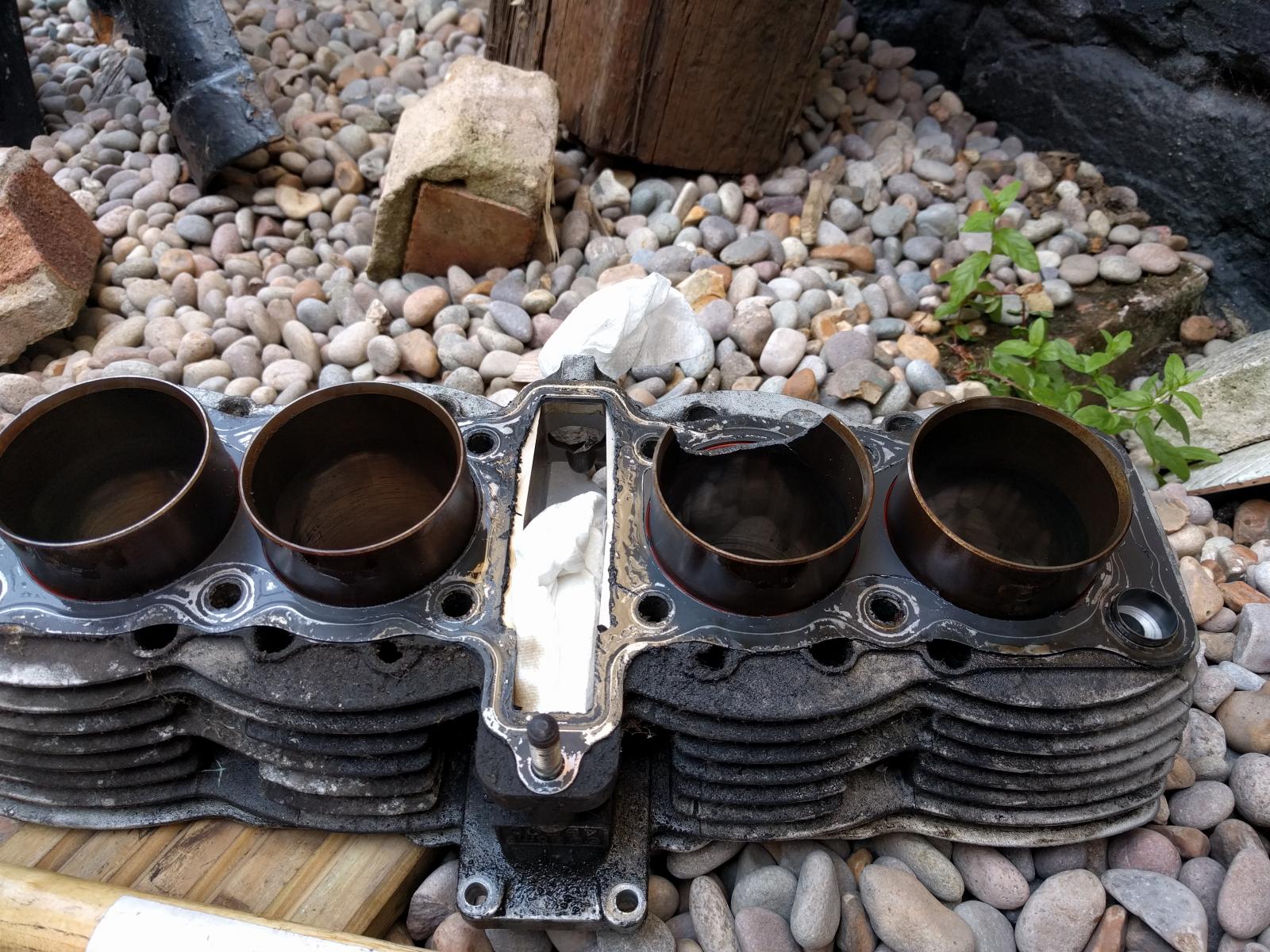

tobyd Posted July 7, 2018 Author Posted July 7, 2018 There isn't a lot of scoring or broken in the rest of the cylinder so i'm not entirely sure whats caused it to go wonky. There is some broken superfluous engine casing above the front sprocket that makes me think a chain snapped at some point. maybe something to do with that although i'd have though the clutch would take the brunt of that. Last rites for this engine anyway, I bet the crank absolutely loved bending that con rod. Still, If i can get hold of the other one for cheap I can have two broken ones and won't that be a better place to be in? hairymel 1
vaughant Posted July 7, 2018 Posted July 7, 2018 Gutted, had that feeling with my Zafira, convinced myself it was a cool pack but turned out to be a melted piston crown but because the rings were still ok it didn't smoke much but little to no compression. New engine job but since then, it's been an amazing car. Taught me how important a compression tester is for testing anything causing silly faults.
Stanky Posted July 7, 2018 Posted July 7, 2018 Bit of JB weld, stick the bits back together, it'll be fine? Sort of? EDIT - or take #3 piston out for better* economy?
Tamworthbay Posted July 7, 2018 Posted July 7, 2018 Bit of JB weld, stick the bits back together, it'll be fine? Sort of? EDIT - or take #3 piston out for better* economy?You could leave out the con rods for cylinder 2 and 3 and wedge the pistons near the top of the bores, or leave out the followers so the valves don’t open on those cylinders. I can’t see any reason why it wouldn’t run but it would be so shit it would be funny. tobyd, Kringle and Stanky 3

DodgeRover Posted July 8, 2018 Posted July 8, 2018 It's had water in while parked up and bent a rod when trying to start. yellowperil 1
yellowperil Posted July 8, 2018 Posted July 8, 2018 It's had water in while parked up and bent a rod when trying to start.Or maybe fuel from a leaky or not turned off fuel tap.
