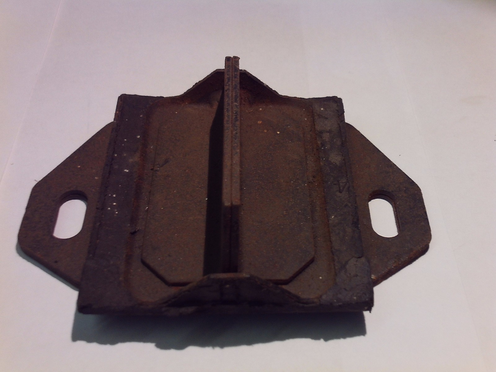

SiC Posted July 17, 2018 Author Posted July 17, 2018 Managed to get a smallish job done tonight. Drained the brake fluid out of the two reservoirs and removed the clutch master, slave and pipework. I used my Gunson easybleed between the master and offside tyre to provide some pressure to force fluid out of the system. Next I removed the pedal box. Apart from wanting to clean this up, it gives much better access to the footwell that needs welding without the pedals being in the way. Brake master I'll remove another day as I'll jack it up so I can remove the bleed nipple on a caliper to drain as much fluid out as possible. Looking at the crusty nipples, I think this may require trying several until I find one that doesn't snap off! I was trying to figure out what metal is left on the subframe mount plate in the drivers footwell. Obviously had some welding here before. Is the thick plate above the rubber part of the subframe mount that is on the subframe side or bodyside? To me that looks like the body side. But I can't figure what the rubber bush in the middle is supposed to be doing. purplebargeken and vulgalour 2
sharley17194 Posted July 18, 2018 Posted July 18, 2018 The rubber bit is the subframe mount, the panel is double thickness and should have a strengthening panel welded on the outside. Its fairly easy to recreate with flat steel. SiC 1

vulgalour Posted July 18, 2018 Posted July 18, 2018 I was trying to figure out that mount there too. I assumed that the floor/heelboard had rotted away so what was being seen inside the car was the back of the mount, much like the other subframe mounts on this side of the car. Your pictures show it much clearer, wish I'd taken the pedal box out when I was looking now, it gives a much better view and access to see what's going on there.
SiC Posted July 18, 2018 Author Posted July 18, 2018 I still haven't quite figured it out. Don't know if I want to remove those bolts until everything is a bit more rigid on the floor and ready to weld that bit.
vulgalour Posted July 18, 2018 Posted July 18, 2018 While the floor isn't in, access for chopping out and putting fresh metal in is going to be easier since you'll have more room to swing a power tool. You can put the repair in without removing the subframe and that should keep enough strength in everything I'd've thought. Even if you just tack/ugly weld the repair in it will be strong enough to hold it together and drop the subframe to do a neater job once you've sort of sketch-welded it all into one piece. purplebargeken 1

Geep Posted July 18, 2018 Posted July 18, 2018 AUSTIN MORRIS 11/1300 FRONT SUBFRAME MOUNTS N.O.S You are looking at a full set of New Old Stock Front Subframe Mounts that fit all 1100/1300 ADO16 Cars https://www.worthpoint.com/worthopedia/austin-morris-11-1300-front-subframe-168459622 Picture is a bit small but may help identify what it looks like? There is also this: AUSTIN MORRIS 1100 1300 1963-1974 NEW FRONT SUBFRAME MOUNTING (RJ034) https://www.ebay.co.uk/itm/AUSTIN-MORRIS-1100-1300-1963-1974-NEW-FRONT-SUBFRAME-MOUNTING-RJ034/223059859788?_trkparms=aid%3D222007%26algo%3DSIM.MBE%26ao%3D2%26asc%3D49129%26meid%3D88ad818a7cfd4b6c82d5619f77ae2f56%26pid%3D100005%26rk%3D4%26rkt%3D4%26sd%3D281678187499%26itm%3D223059859788&_trksid=p2047675.c100005.m1851 Another here AUSTIN MORRIS 1100 1300 1963-1974 NEW FRONT SUBFRAME MOUNTING (RJ034) https://www.ebay.co.uk/itm/AUSTIN-MORRIS-1100-1300-1963-1974-NEW-FRONT-SUBFRAME-MOUNTING-RJ034/272919388587?_trkparms=aid%3D222007%26algo%3DSIM.MBE%26ao%3D2%26asc%3D49129%26meid%3D3cef291dc8814dea94773ade4b069982%26pid%3D100005%26rk%3D1%26rkt%3D5%26sd%3D223059859788%26itm%3D272919388587&_trksid=p2047675.c100005.m1851 I would say you can remove that mount to attend to the floor then reattach to get the position of the holes. The subframe is held by other mounts so won't move with taking off one mount. The frame itself acts as a sort of jig for positioning. Not sure about any reinforcing on floor but it won't be very thick if there is any. Check other side once you have mount off to see if there's any obvious double skinned panel behind mount. SiC 1
SiC Posted July 18, 2018 Author Posted July 18, 2018 Yeah I was looking through eBay trying to figure out what the mount itself looked liked. It almost looks like the mount is bolted to nothing! The other side has been welded before and of course no guarantee its the correct design now.
