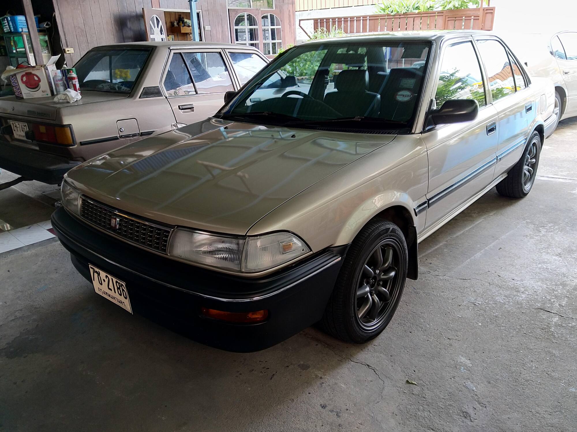

In 2 week I will have own this car for exactly one year, during which I put some 9,000km on it.
Removed the rear lip thingy for proper giffer spec looks. Also treated to a clean and wax. The car starts to have real issue with clear coat breaking down except in the area in which it's repainted. Can't do anything unless I disassembled and repaint the whole thing. Not really necessary unless I'm going for 100% factory fresh restoration, it still looks great in picture which we all know is the most important thing. ?
I had to replace the radiator cap as the old one was leaking, OMG such huge issue. Also have to add some oil because I hit 8,000rpm too often.
Apart from that this thread lacks content because the car works so well.
Might be doing alignment and a service soon before I have to move to the countryside for 2 months (work, early June til August). I'll definitely be having shite adventures because the countryside is where all the old shite ended up. ? Will deffo be bringing the car with me though as I don't want it to lay dormant.
