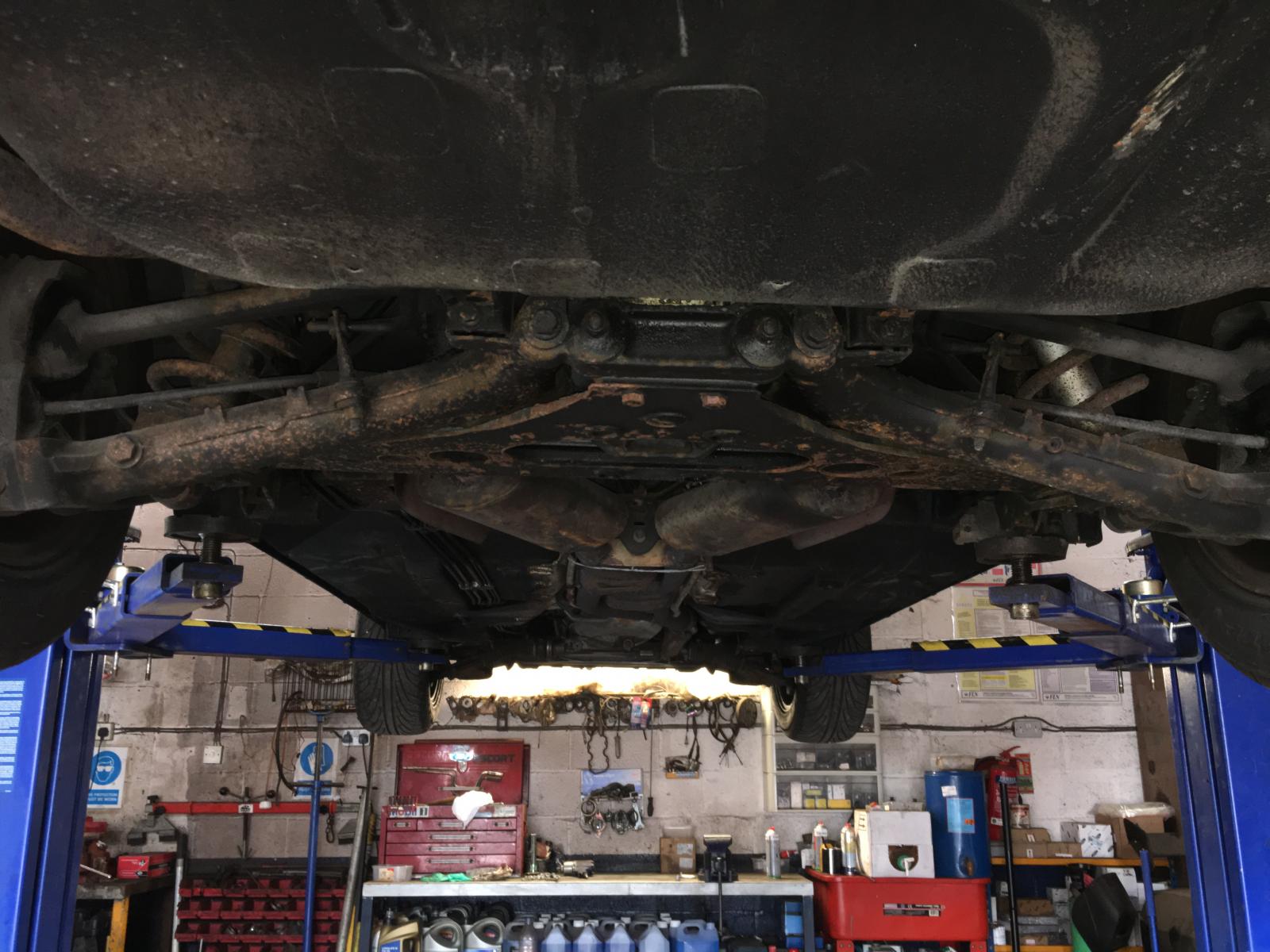

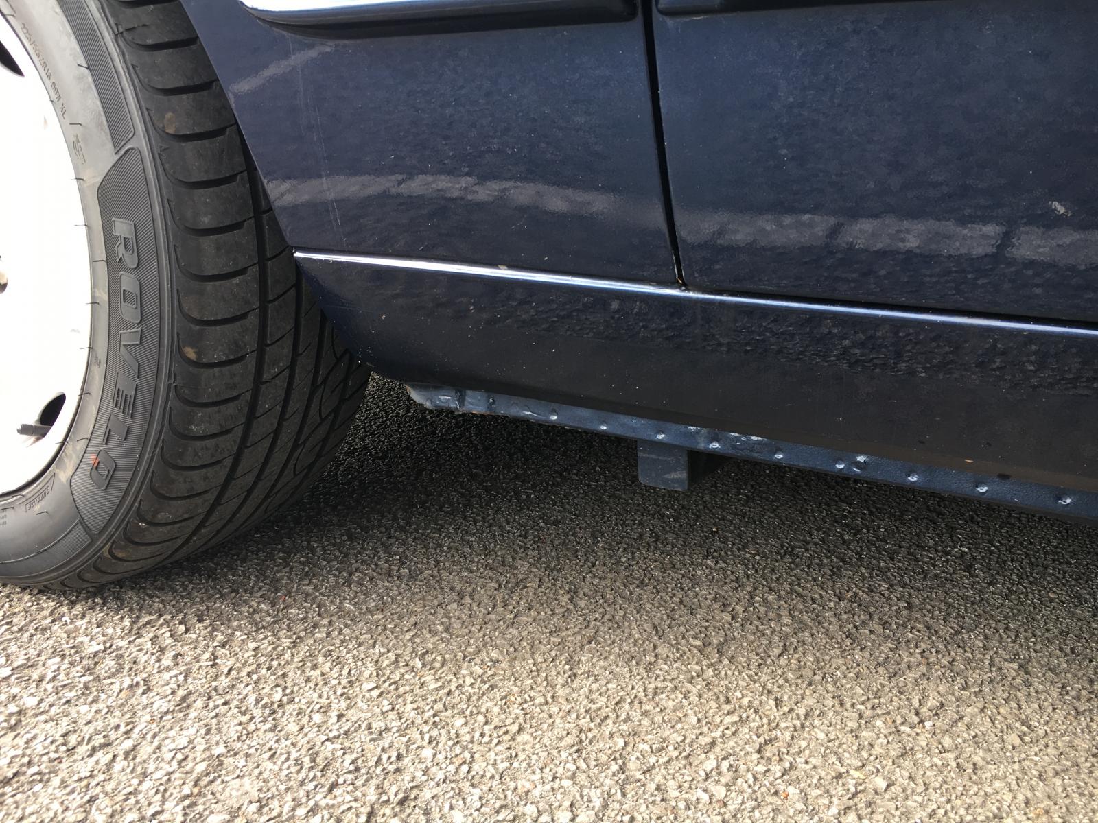

Broadsword Posted August 3, 2018 Author Posted August 3, 2018 Small updates. I got the remote locking working just about, which was very pleasing. The flipper is on its last legs but I just managed to get the contacts in good enough shape for it to keep working. While I was at it I disconnected the alarm siren. The noise of the chirps this thing makes is really rather annoying after a while. Disconnecting the multi plug to the siren is the easy way out. You will find the alarm siren next to the windscreen washer fluid reservoir, very easy to get at. I finally got the car on a ramp to have a really good poke around underneath. The mechanic was quite impressed. Overall it's very clean and solid. A few things of note are: *Some play in front wheel bearings.*Offside front brake flexi hose is a bit tired.*Nearside front brake caliper and flexi hose are new.*Front shock absorbers look new.*Minor oil leak from engine (best to leave it).*Small oil leak from diff seal.*We tied back the ABS sensor wires to stop them flapping around in the breeze.*Inner front wing corners repaired to a poor standard. Solid, but need monitoring.*Surface rust on lower inner edge of offside sill. Wire brush and treat.*Offside rear jacking point twisted but solid. We still lifted the car on it without problem. It's an oldish car so overall things are really good I would dare say. I forgot to pay attention to the gearbox mount. I can't get a good view from my rubbish photos so I can't see the rubber bush. Other news is a slight and annoying misfire detectable at tickover. The answer will no doubt be LUCAS. I've cleaned the intake bellows, TPS and front of the throttle body. That did nothing. I'll do the fuel filter next as it looks old and I have a new one. I also have the correct spark plugs which I might try before resorting to coil packs and fuel pressure regulator. Isaac Hunt, djimbob, Split_Pin and 1 other 4

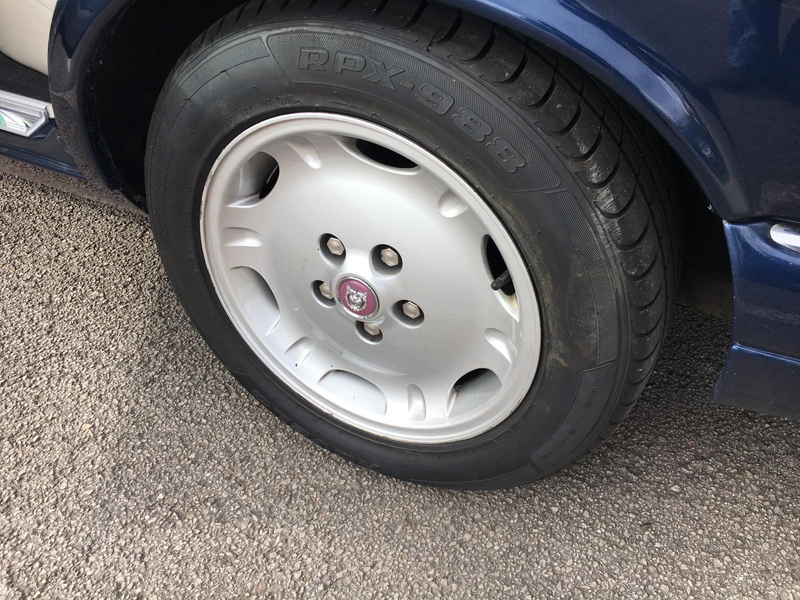

Broadsword Posted August 31, 2018 Author Posted August 31, 2018 The tread blocks were starting to peel away from one of the front tyres (Nankang) so it was time to buy a full new set of tyres. I needed a deal so spent about two days looking around. The final result was a set of Rovellos fully fitted and balanced for £185. The new set has made the car far nicer to drive. The old front tyres was Nankangs and dry rotting. The rears were Triangles (still can't get over that ridiculous name). I thought the rear tyres were poor and noted they were from 2011. When the guy at National Tyres had them off they were actually really good looking. Loads of tread and not cracking up at all. I threw them in the boot for an emergency. Isaac Hunt 1

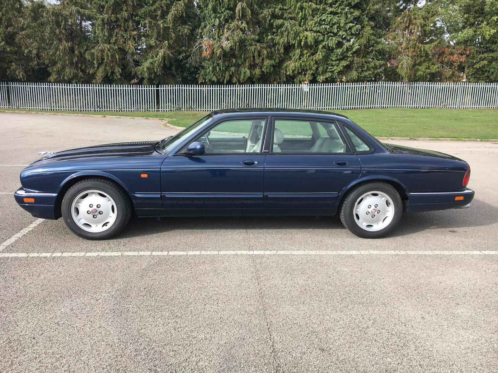

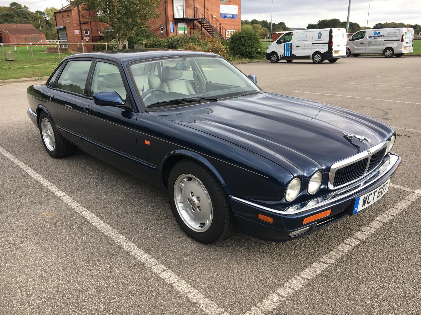

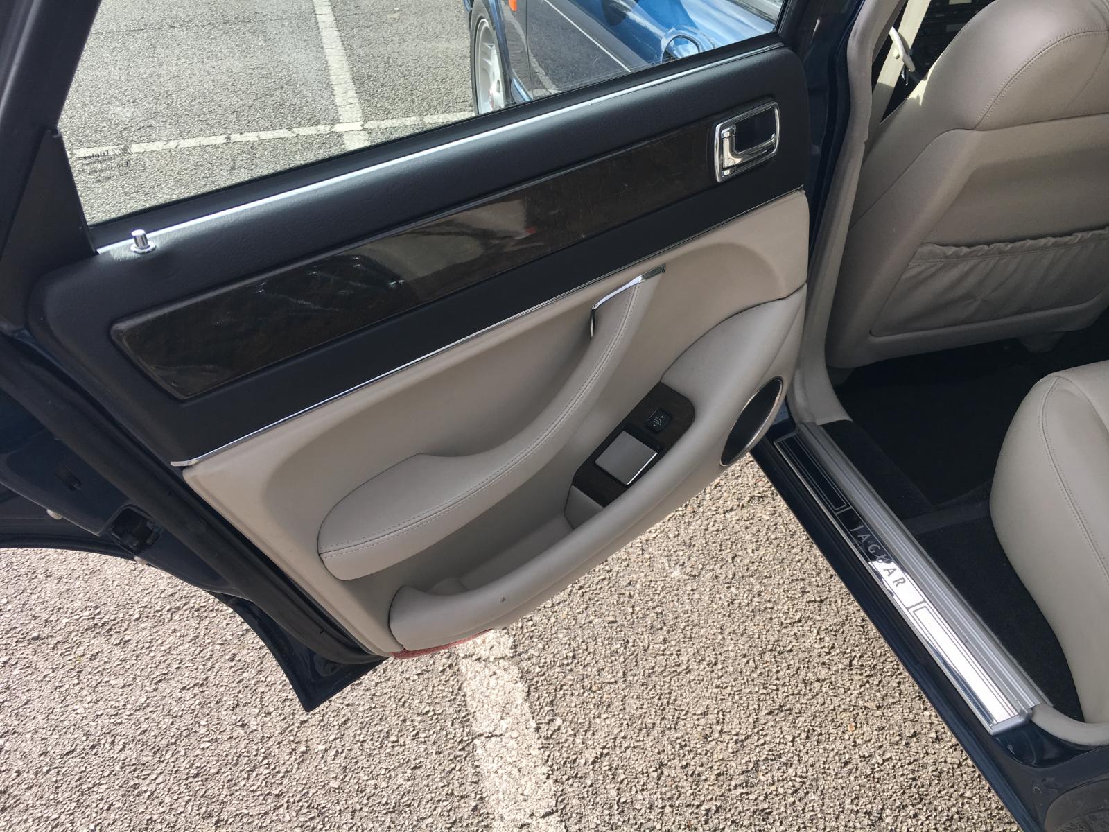

Broadsword Posted October 8, 2018 Author Posted October 8, 2018 Better photos: HillmanImp, tonedepear, oldcars and 8 others 11

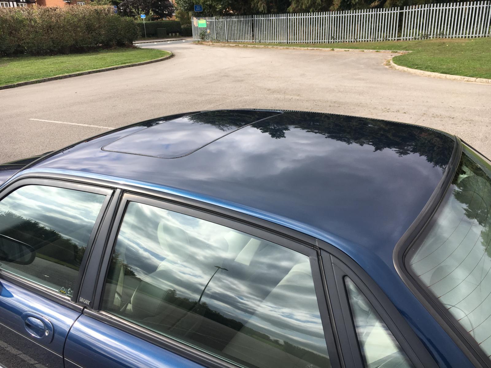

Broadsword Posted October 8, 2018 Author Posted October 8, 2018 I promise it doesn't leak! How bad was your experience with a sunroof in the past?
