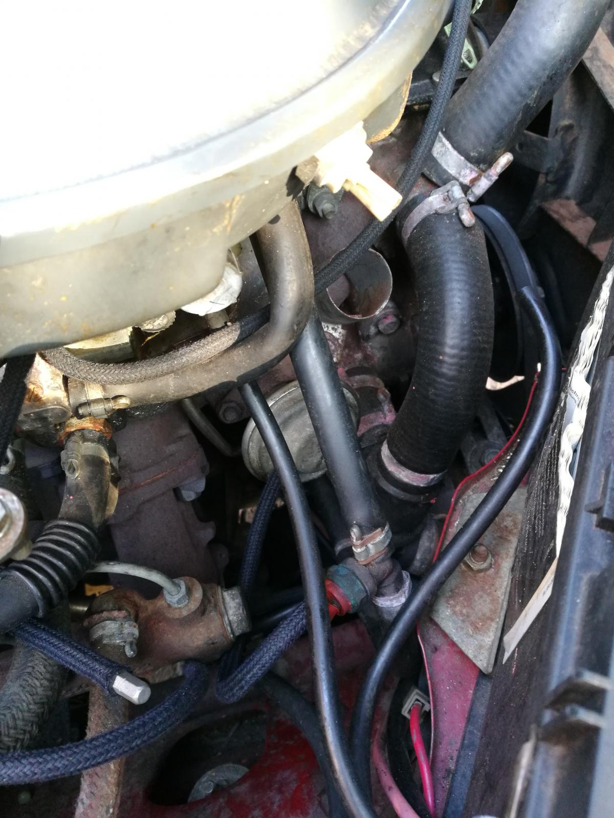

Now, my Lada originally had a vacuum actuated EGR valve.  I'm pretty certain that this hasn't worked since the mid 1990s for a start.  Fine...just replace the valve surely...this is where it gets more complicated.
This car has however been modified, and now runs the single point injection system from another model (which is was never supplied with in the UK for some reason best known to the manufacturer).  This results in vastly better emissions figures than the original system was capable of.
None of the injection cars ever used EGR as far as I'm aware as it simply wasn't necessary due to the better fuelling control.  As such there's nowhere on the inlet manifold for it to attach to.
Now, my EGR valve is still there as I didn't want to faff about blanking off the hole it would have left on the exhaust manifold, but obviously isn't attached to anything else now.
I realise that by the letter of the regs that this is now a "major" fail as the EGR valve has been for all intents and purposes "modified."
...however in the spirit of the rules it surely shouldn't be a problem as the car has been fitted with a far more advanced emission control system than when it left the factory, rather than this being done to mask a fault or to improve performance at the expense of pollutant levels.
This has been a pretty expensive project (reckon it's probably cost me £750 or so all in), but has resulted in a car that drives massively better than when it left the factory and produces far, far lower emissions (it's literally scraped through every emissions test since its first MOT, whereas when I last had it checked it came out at a very comfortable pass - CO: 0.001%, HC: 3ppm Lambda: 1.008).

Strictly speaking, your vastly improved emissions are all about hydrocarbons and carbon monoxide, not about the NOX that the EGR valve targets.
I've never seen a vacuum operated EGR valve.  Can't you stick a pipe on it and put the end, er, somewhere inconspicuous?

Here's a vacuum operated one...Buried roughly centre frame.
True enough the NOx issue I guess...Though if they'd been that worried about it they would have carried over some form of EGR to the injected models I have to assume.

Not all cars have EGR valves, even after most did.  My wife's 2005 Zafira doesn't have one where my '96 Astra does.  Guess some engines needed them and some didn't for reasons I don't understand, though I'd be interested to know more.
If you don’t point it out to them, they’ll never notice imo.
They’ll have no idea about what should, and would be on a 25 year old lada and it will pass emissions so he won’t be looking too hard.
This 100% - does anybody actually expect it to have an EML light either? Put a pipe to nowhere on it.
