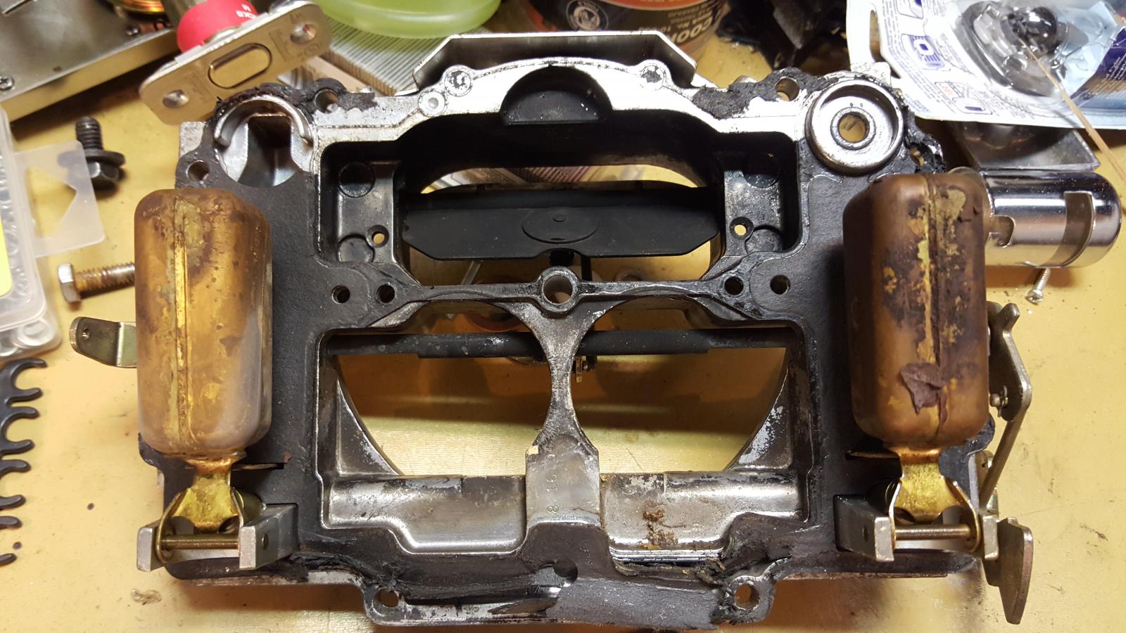

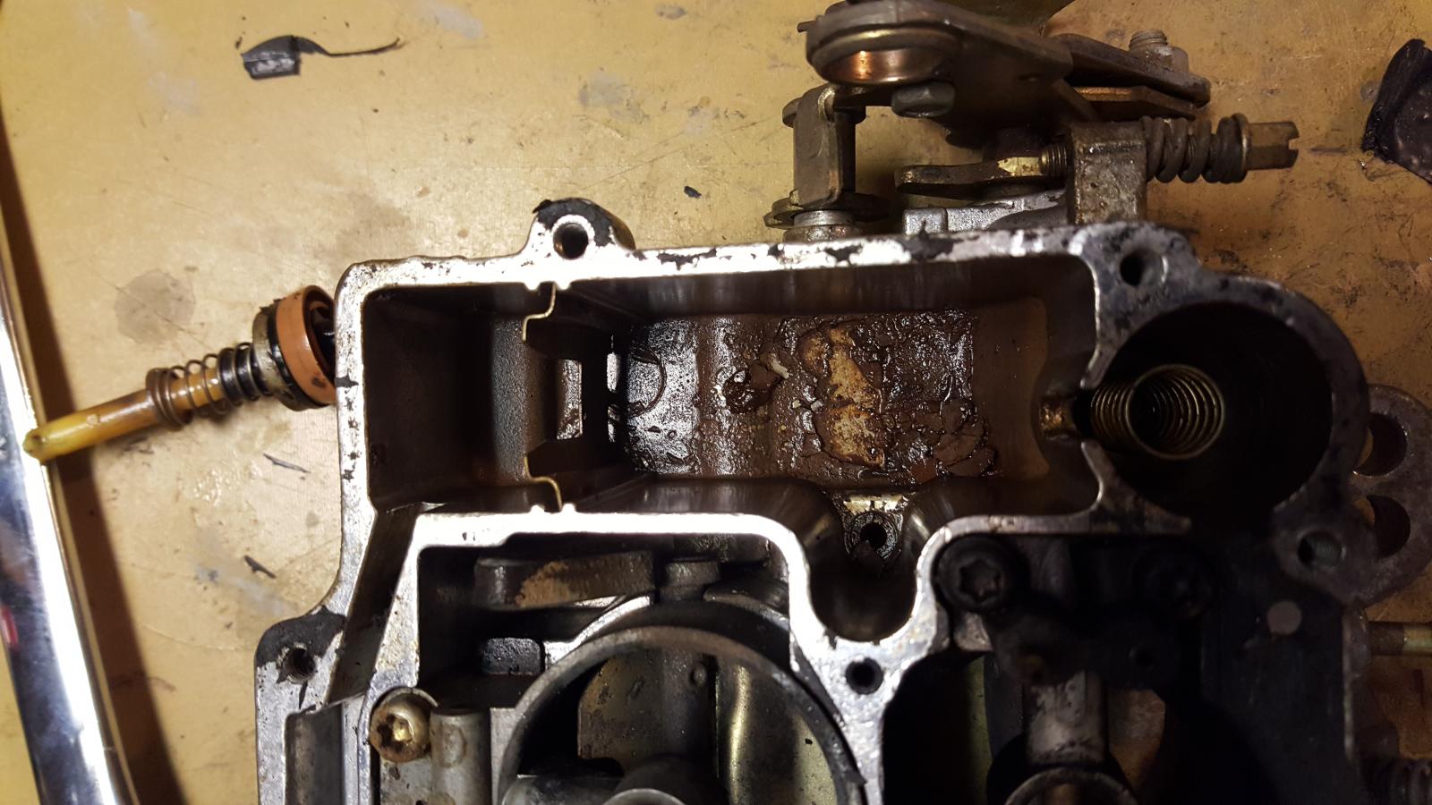

darkfour Posted April 21, 2018 Posted April 21, 2018 I've got an edelbrock 1406 on my 440. When I opened it up to rebuild it, it was full of brown goo. Cleaned up a treat and now runs like a top. danthecapriman, eddyramrod and Christine 3
