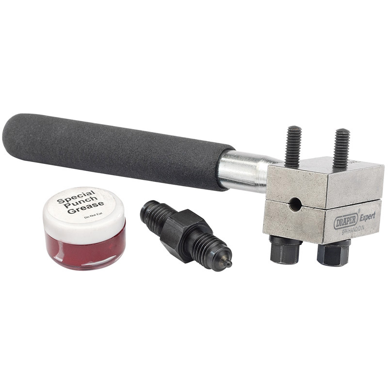

Here's my nomination to get stuff started; a Draper hand held brake pipe flaring tool. I had to replace a front pip;e on an E36 recently. It starts at the flexy hose under the front arch, behind the arch liner, through the inner wing and across the bulkhead behind the engine to the ABS block on the other side. Trouble is, it's hidden behind the engine - so you have no idea which pipe on the other side of the engine it is.
So I bought one of these from Amazon (because no local shops like Machine Fart stock them, just some hopeless looking Laser crap) and by fuck it's good. So I went back to unrusty pipe, cut it with the pipe cutter, slid a new union on, bolted the flaring tool on (two 10mm), wound the flaring bolt in to the stop - job done. A bit of copper pipe, ends flared again with this tool and the whole thing was done in half an hour. This thing weighs next to nothing and it got into a very inaccessible place.
Just a great bit of kit. Recommended.
I have one just like that but badged as Quinton Hazel
