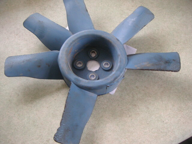

Two minutes later hes there with a piece of fan blade in his hand. "Have we got a spare fan?" Yes in the van.
How did you find the broken blade?
Stuck through the bonnet when I checked the water"
Ah! that accounts for the vibration then, now't wrong with my diff.
The eagle eyed among you will notice that the top hole is elongated. The reason for this is the expert* conversion from 3 holes in a Zetec water pump to 4 holes in a pinto fan.
A longer bolt is fitted to the elongation, which passes through an expensive adaptor pulley and secures the whole assembly to the water pump.
When I elongated the hole in the new fan, the metal bush fell out. But not to worry!
Have to take the rad out to fit the new fan. Fan on, rad in, water in, fire it up. Engine goes, fan stays still!
Took a while to realise that the bolt through the elongated hole, with no bush had compressed the plastic enough to touch the water pump body and prevent it turning, must have been a fraction clear previously.
Rad out again, shorten bolt, rad in water in.

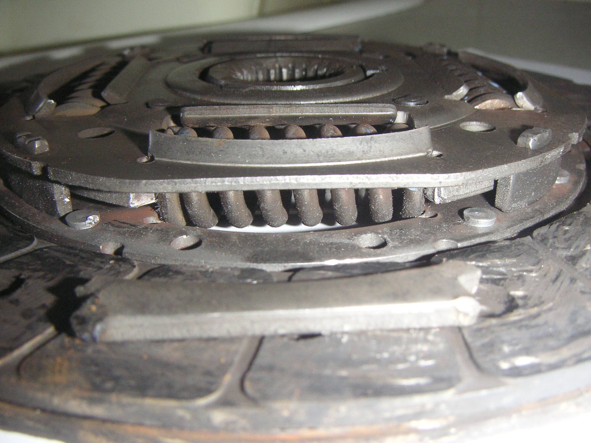

Removed clutch, something fell on the floor, small piece of drive plate, about 50mm long x 3mm square ish.
You could see where it had broken near the spring.
This piece attached itself through the pressure plate, through the driven plate and into the flywheel recess where the bolts are.
It somehow jammed the whole thing up, it's that small you would expect it to shear,

Clutch plate damage. Am assuming this broke when we hit the fence,
Spring compressed and shattered the plate. It may be difficult to see on the photos.
This bit is as it should be.
