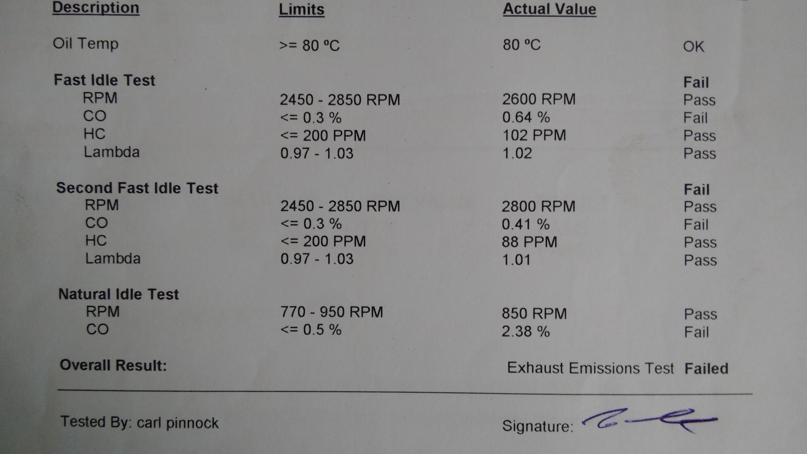

You might get away with a thorough warming through - the second fast idle test wasn't too far above the limit.  My C4 blew a 0.45 and the tester reckoned an Italian tune-up to get the cat up to full efficiency before taking it in for the retest should do it.  Your natural idle figure looks rather high though.

Yup, a good Italian tune up. Make sure the engine really is up to temperature too. Our Nippa struggled a couple of years ago, because the coolant sender was slightly duff, so it was over-richening the mixture slightly - just enough to cause a high reading.
A just fail like that is either a knackered cat or cat not up to temp . As suggested above - take it back when stinking hot for a try if not it’s cat time .
Don’t get a euroflo one - they don’t even pass an mot when new
To make a proper assessment you’d need to see the oxygen and carbon dioxide values on a four gas analyser. Also crankcase breather issues can cause issues with emissions testing, as said above try the Italian tune-up first.

Looking at those figures, it's overfuelling at idle, which has contaminated the cat. Lambda is OK on fast idle so it's clearing itself on throttle. Is the thermostat OK? Does the car get up to 80 odd degrees, and if so I'd be looking at the coolant temp sensor. Get it on a diagnostic and make sure the ECU is seeing the temp is correct and not just taking a flatline reading. IIRC the gauge has a different sensor on these. Get that sorted then give it a good hard run to try and clear the Cat, hopefully it can burn off.

The idle limit for the spi Mini was 0.75% CO. Some testers may not check this..
It didn't work :( . Got down to 0.38 but wouldnae go any lower. So near yet so far.
