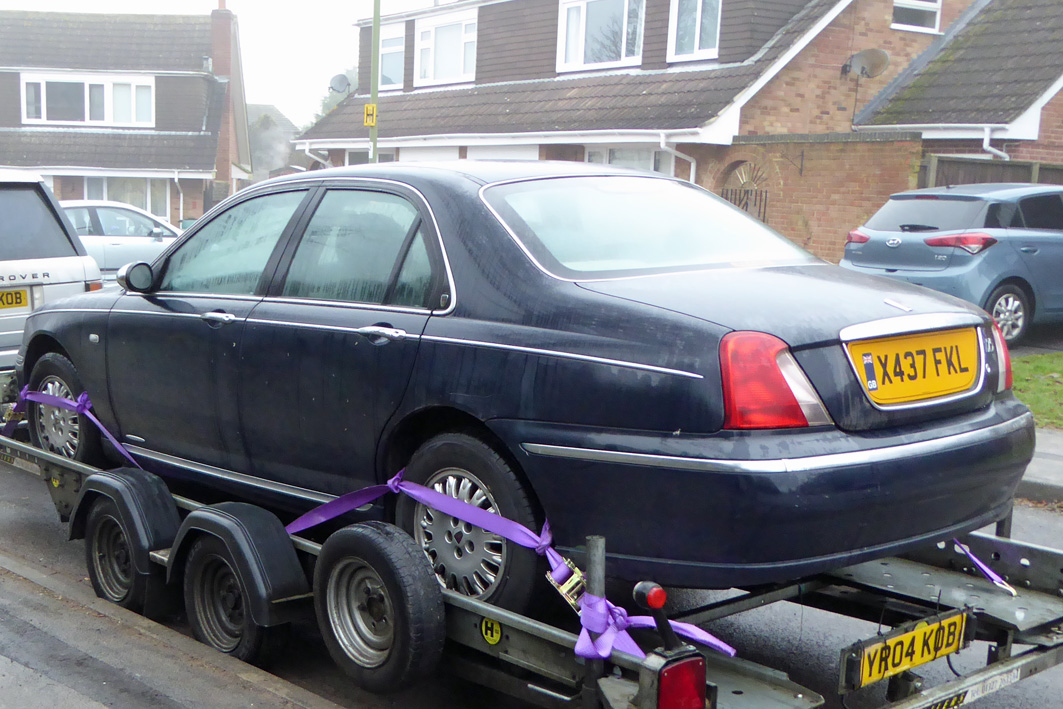

Six-cylinder Posted February 15, 2018 Posted February 15, 2018 I have a 75 which you are welcome to take a door off. oldcars, SiC, Skizzer and 6 others 9

Six-cylinder Posted February 16, 2018 Posted February 16, 2018 Price up getting that door from Six Cylinder and go from there. Sneeze on a Raver 75 and it's a write off. I was thinking £8 for the door. As some of you may remember I was given the car by a member of this parish following it's engine locking up by swallowing water. All I had to pay for was trailer rental and fuel for my Range Rover so a million pounds is all it owes me! A local friend has taken the interior and I have not managed to salvage much for myself so just a few pounds towards my recover costs would be helpful if anybody needs anything from it. Price wise I am easy so just tell me what I am getting and I am sure we will not fall out. I plan to send it on its way in a few weeks time so anybody should say now if you want something off it. oldcars, Skizzer, DeeJay and 3 others 6
