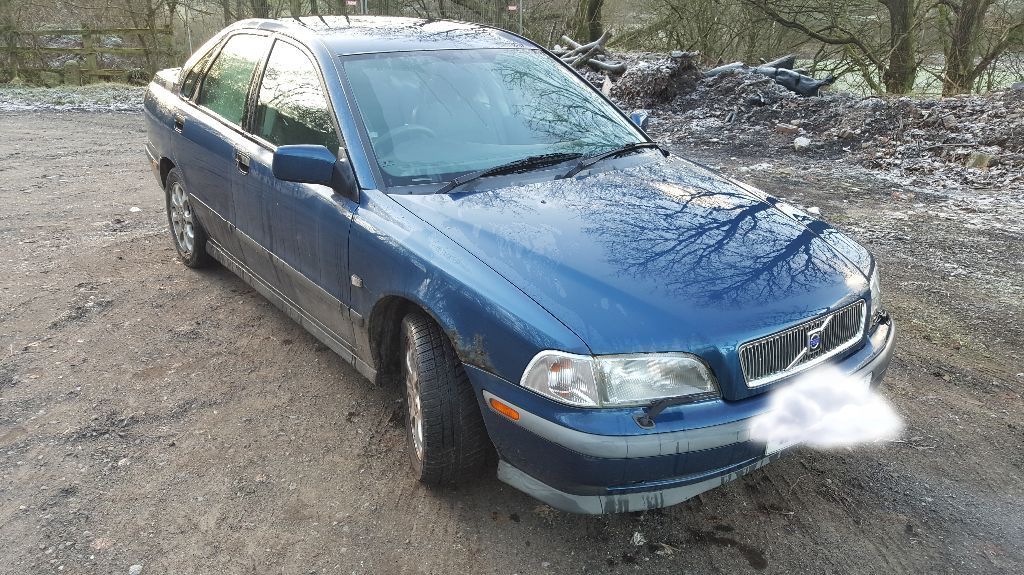

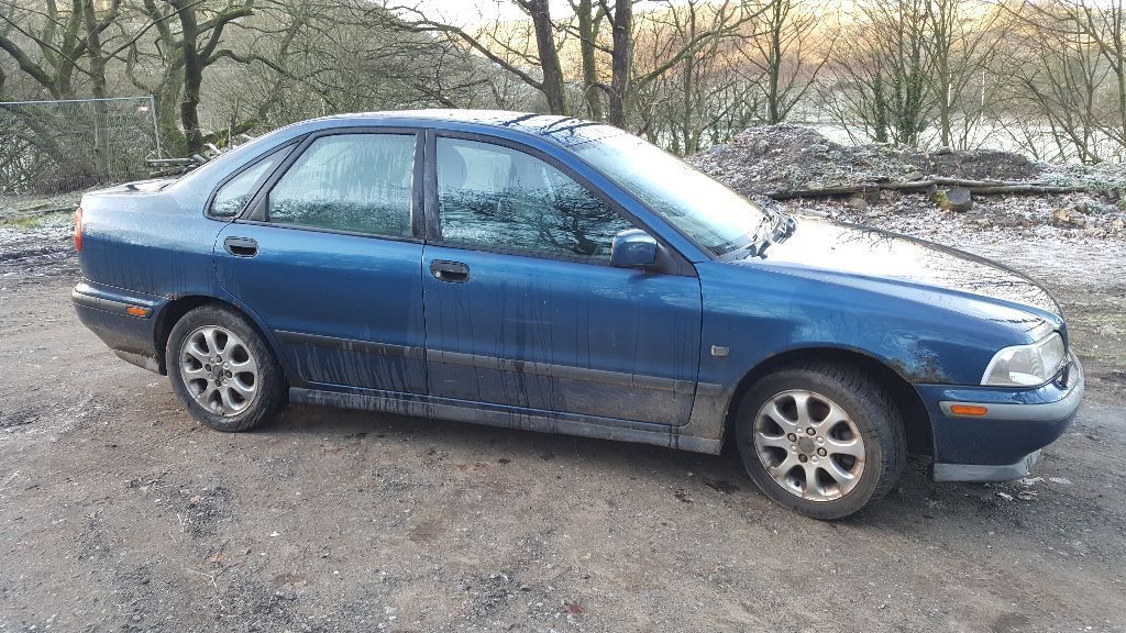

new pickup tonight,yes they do rust,but for £25

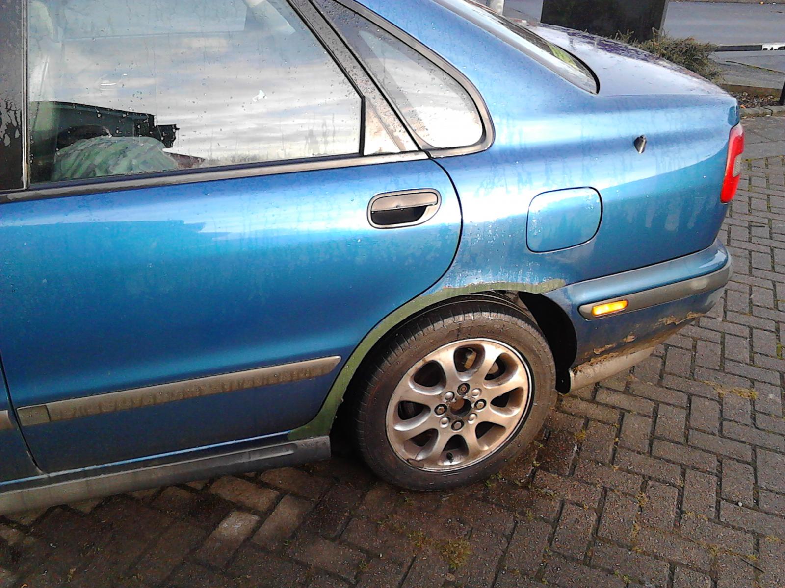

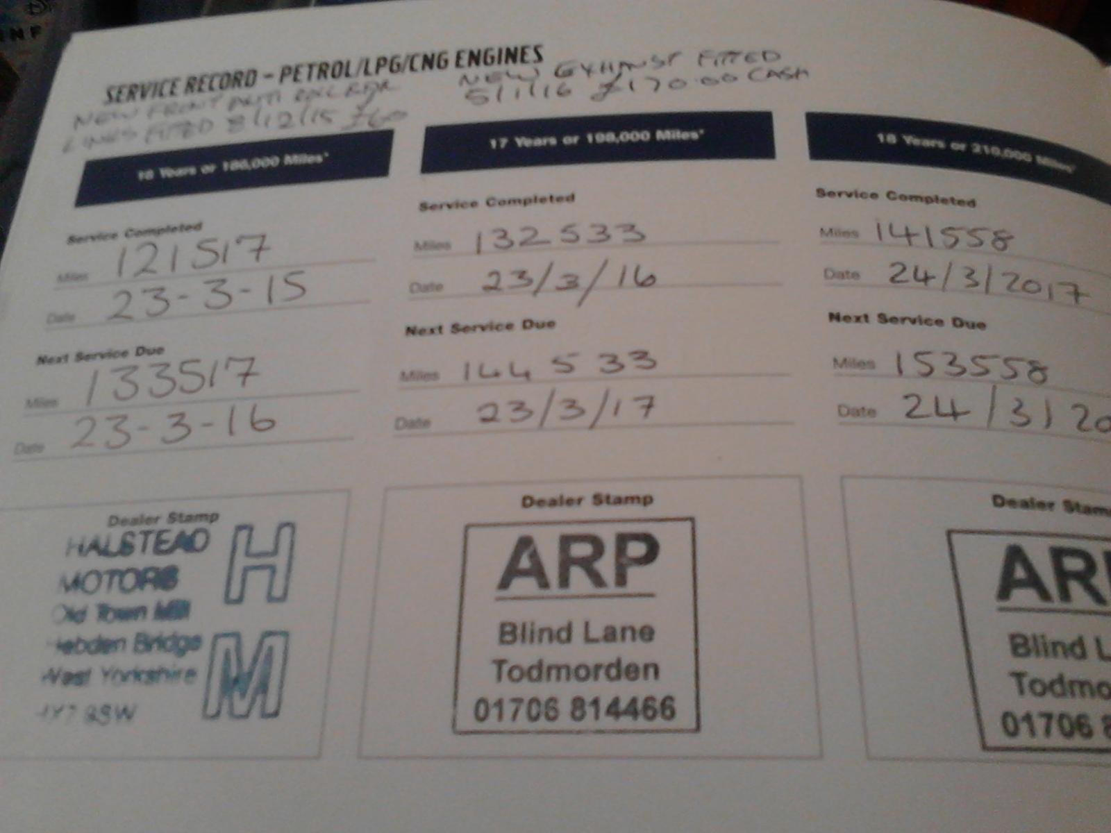

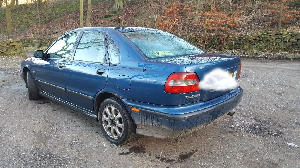

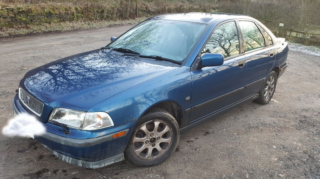

here in all it glory,... still windy out,so other than pictures nowt done,found two locking wheelnut key in boot,found service book,been reg serviced every year,new full exhaust 2016,has had three cambelt changes,one at volvo...last at 2014 not needed for good while yet,and starter motor,last service 24/3/17post-19591-0-59827500-1514971919_thumb.jpgpost-19591-0-52297400-1514971931_thumb.jpgpost-19591-0-10048900-1514971942_thumb.jpgpost-19591-0-57122900-1514971957_thumb.jpgpost-19591-0-71838900-1514971972_thumb.jpgpost-19591-0-24592300-1514971985_thumb.jpgpost-19591-0-17436700-1514972014_thumb.jpgpost-19591-0-66132200-1514972025_thumb.jpgpost-19591-0-43651300-1514972037_thumb.jpgkey fob taped up ordered on of fleabay 99p..will check on front wheelbearing noise!!!!

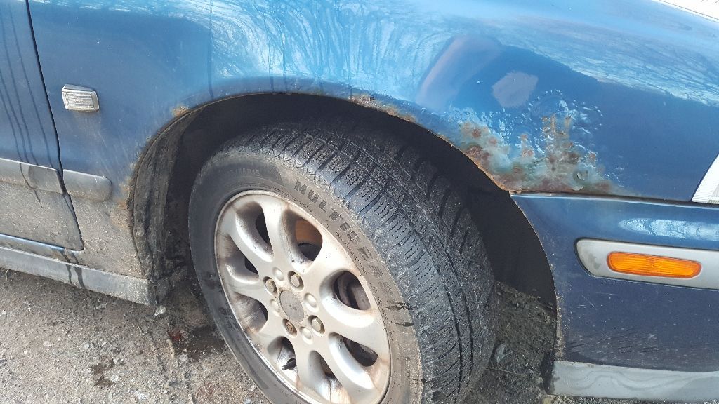

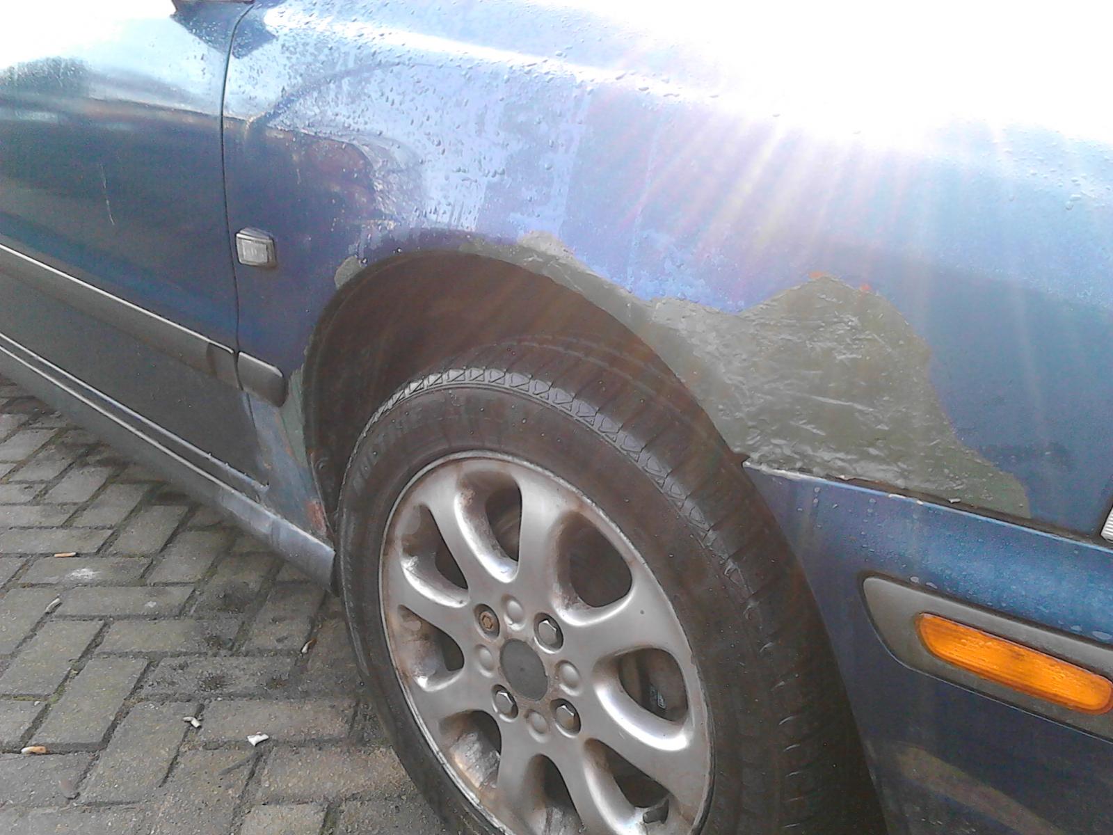

I know they're a Carisma or something underneath but that's a lot of rot for a later 90s Volvo.

You appear to have got some clouds stuck on the front and back of your new motah.
Did you have to recover it from a canal?  I don't think I've ever seen that much grot on an ovloV of that age before.  Or one so cheap....

That might be a replacement pattern part front wing, as others have said that's a surprising amount of grot for one of those. Considering a return trip to London on public transport cost me about the same and now I have nothing to show for it, I would declare this as outstanding value

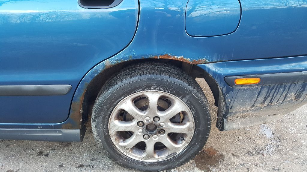

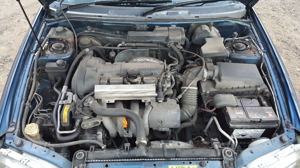

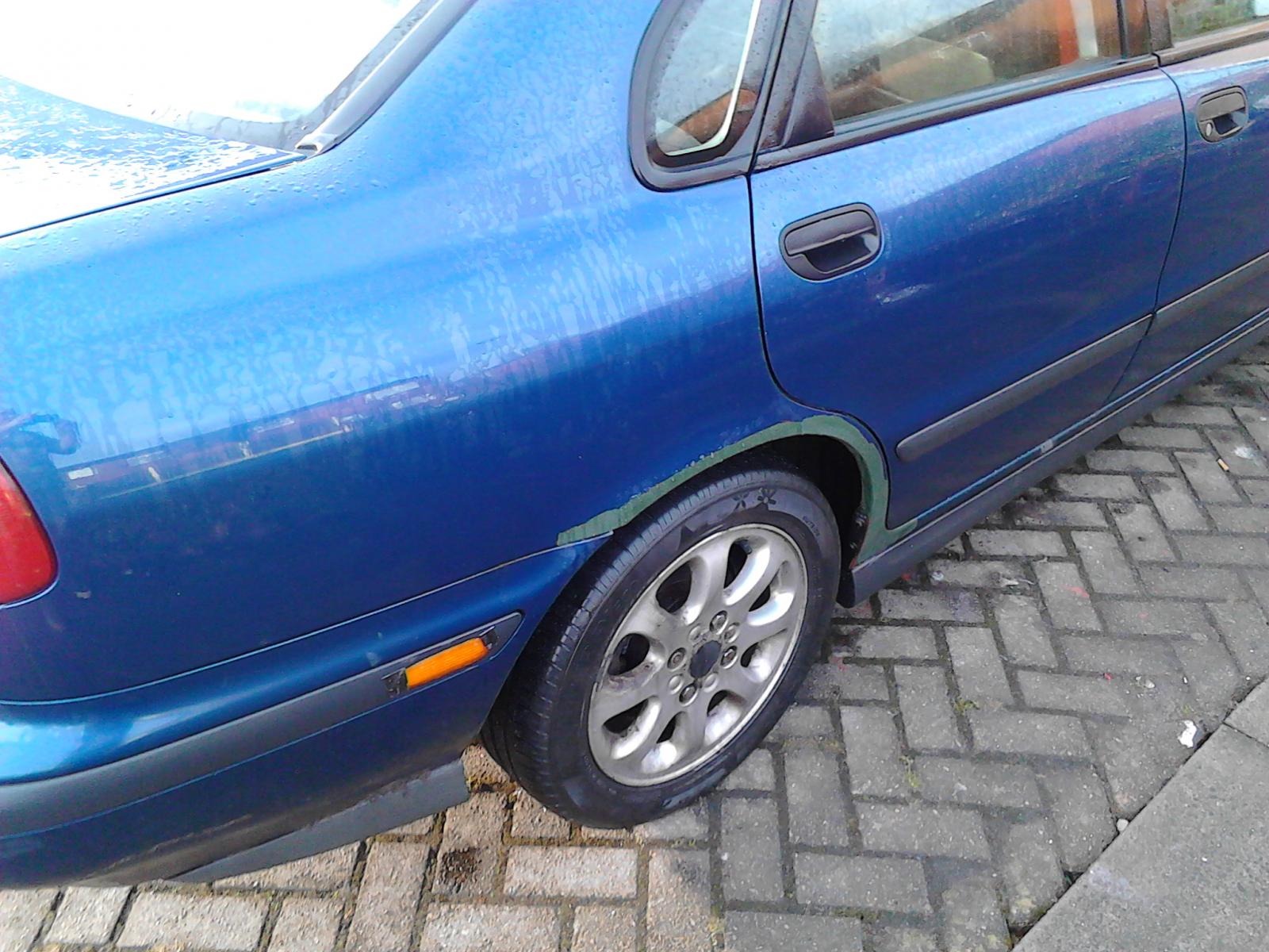

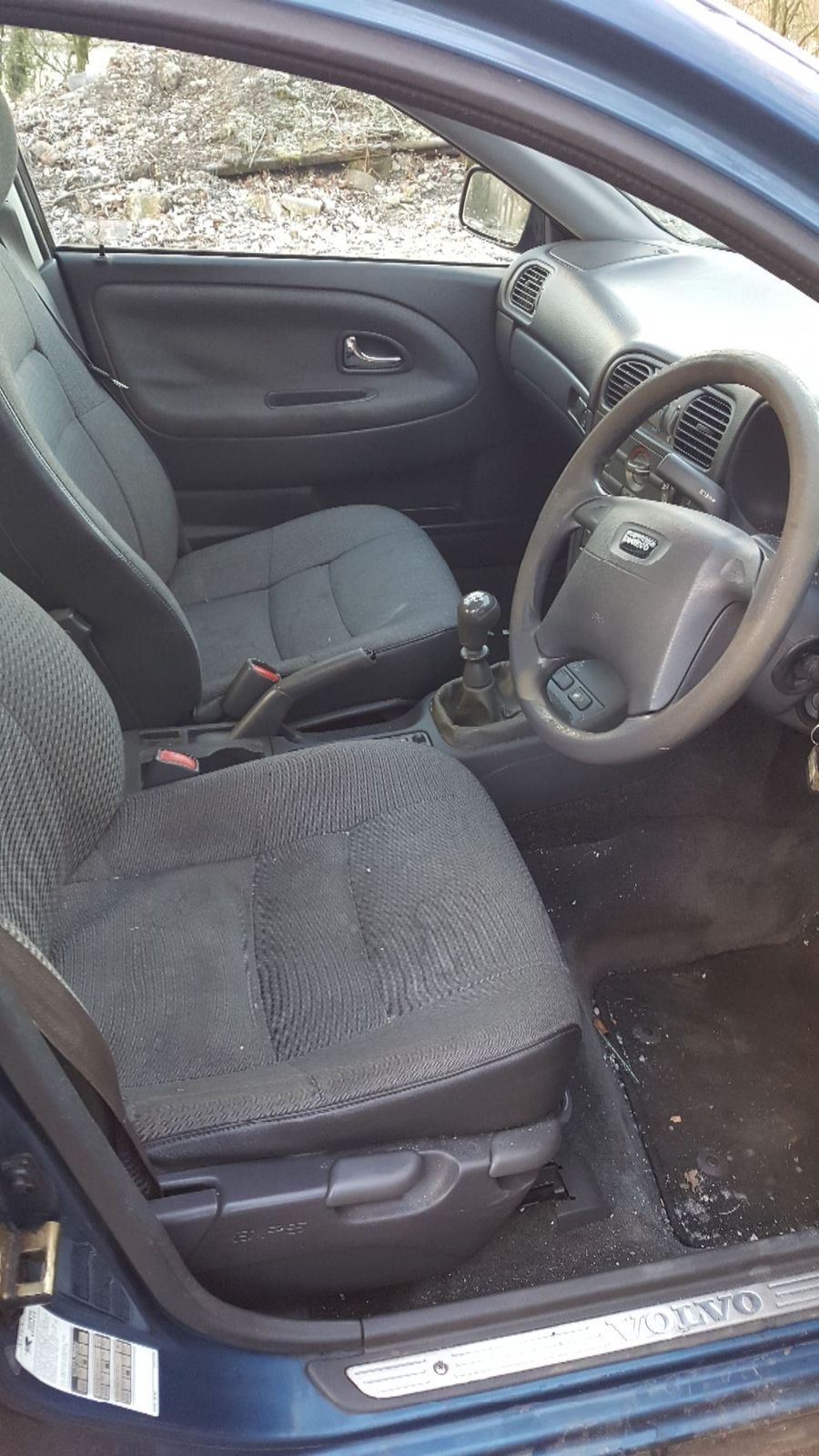

got the grinder out,sanded down,than slapped on some rustins antirust,will paint on more rustins red paint tomorrow,if dry,slight fray on seatbelt,gorrila tape sorted that, funny stains on rear seats,pictures tomorrow,

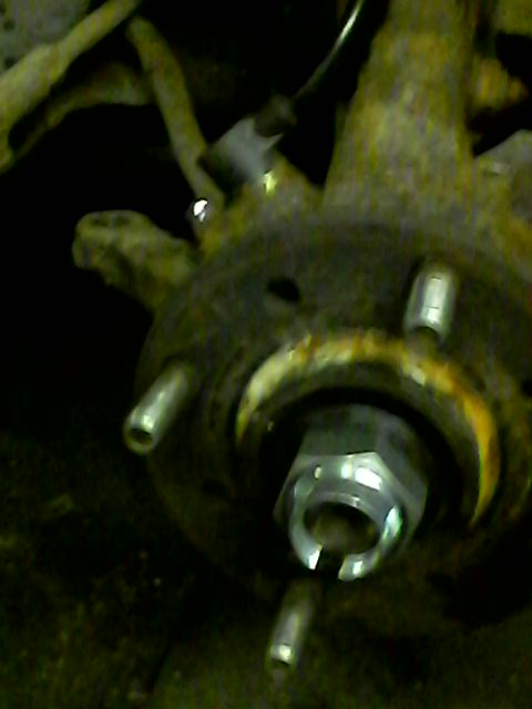

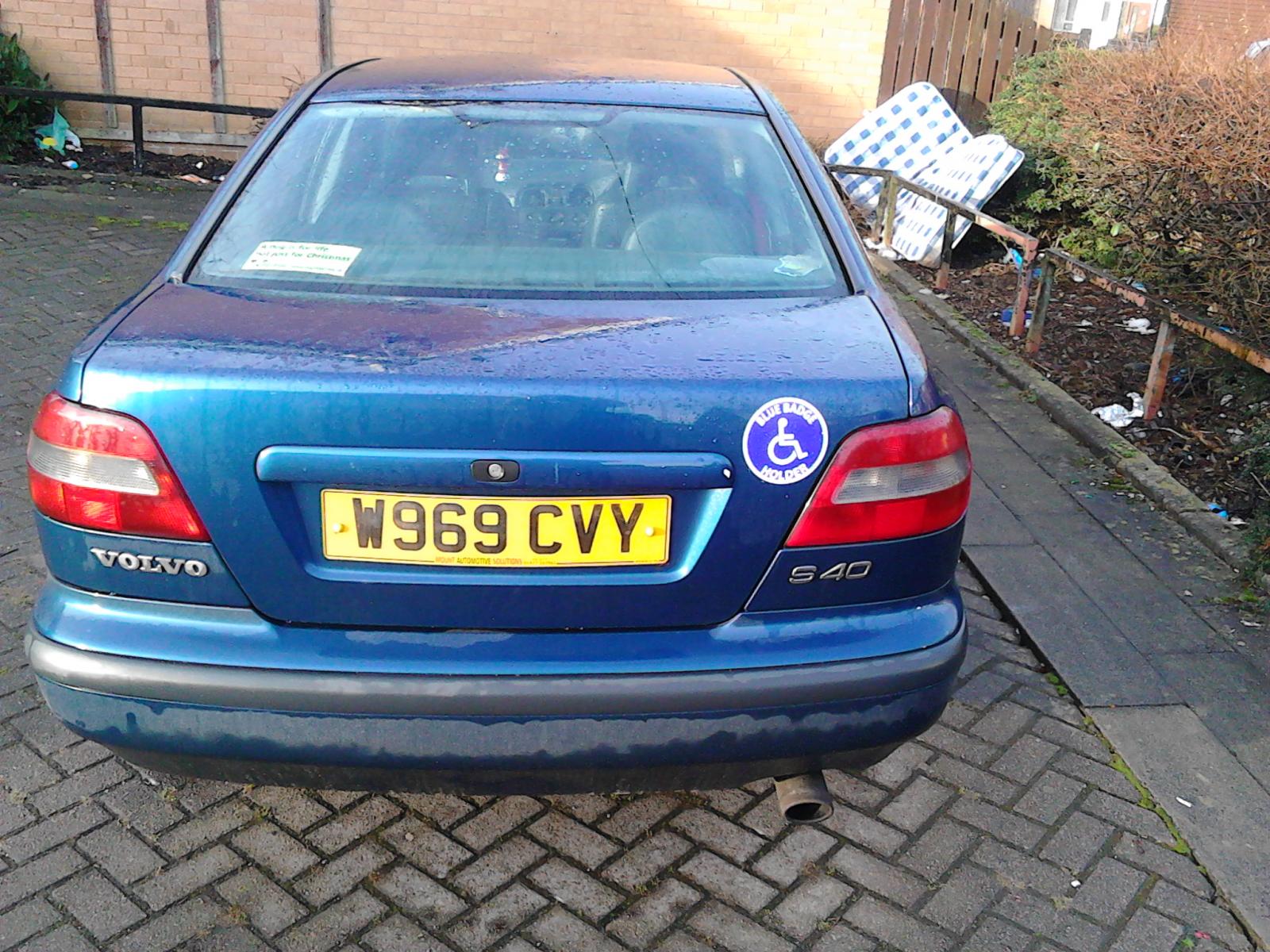

wheel arches sorted ish,ground of loose rust,slapped on some rustins anti-rust red paint,than had some darkgreen metal paint,drivers front wing got holed with grinder,mixed up p40 that took care of the wing,checked the wing,its a genuine volvo one,stripped of all road wheels,got some cheap pads allround,some of the sliders were seized,copaslip now fine now,bigger job,front wheelbearing was droning badly,got a premier wheelbearing for 25.00,stripped down the hub,went to have bearing pressed out,than new one in,circlip was well seized,that was chisel out,than noticed the lower balljoint was fooked,luckily the carspares had a lower arm, last one in stock,35.00,made by moog,so should last fine,have checked mot has one till end of march,heated seats work fine,electric ariel fine,volvo fitted radio,cassette,cd player,2 locking wheelnut keys,aircon,still needs good clean,but i did empty the ashtray....new pictures in morning,without the clouds,..sill has a rattle now on passenger droplink maybe,seems good on fuel for such heavy car,better than yaris verso....

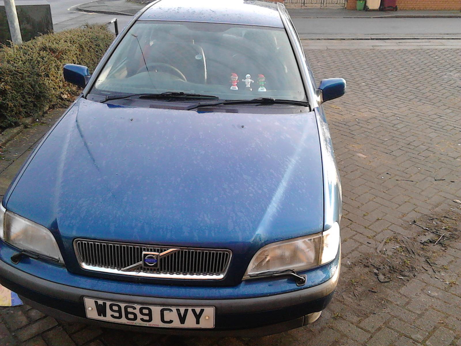

new pictures,last pictures not so good cheapie camera phone,will bed the pads in,brake fliuld seems very dirty,black,may need flush through....changed air filter,mahle jobbie,
