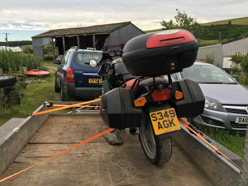

Today, despite having an ankle that refuses to work (no idea how that has happened, blaming it on age) I had to move the BMW 1100RT out of the shed and onto a trailer, as tomorrow I have to deliver it to a shop in Aberdeen for new tyres, a full service and an MOT. Providing all goes well, it will return here next week before being collected by its new owner next, who has not seen it yet! Once collected, his first ride will be around Europe and back to Stavanger!
I am glad it is going, I had to get a friend to help me load it onto the trailer as it is that big and heavy.
  • Saabnut changed the title to How much shite is too much shite? Another New Arrival
Well the bike was dropped off in Aberdeen Saturday morning ready for work to commence tomorrow (they are closed Monday). Decided I had too much to do to attend Glamis and with the heat forecast - a good decision in retrospect. Talking to people who went they said it was so busy it was difficult to get around the site!

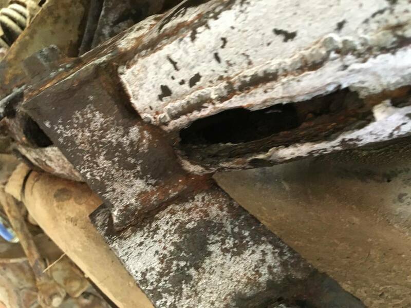

The weather turned out nice but decided to put it to use* and get on with the Disco. A thorough inspection showed a total of 5 patches required, 4 on the chassis nearside rear and one on the sill closing panel in the same area, but nothing major. Sitting for the last two and a half years also meant there was a lot of flaking surface rust. Out with the grinder with a knot wire wheel and the rear section soon looked better which was more than could be said of me or the shed floor
I treated the brushed steel with Jenolite and went for a brew while it did it stuff. These are the areas of added lightness
I fabricated the first patch and had literally just got the first couple of tacks on when my friend arrived to fit the new starter motor and ignition switch. The reason it was laid up, apart from it had been driving me mad with unreliability, was the starter had remained engaged with the engine running which had fried the starter. My thinking was it was likely to be the starter failing in the engaged mode or the ignition switch failing, so to make sure I bought a new starter and a replacement switch.

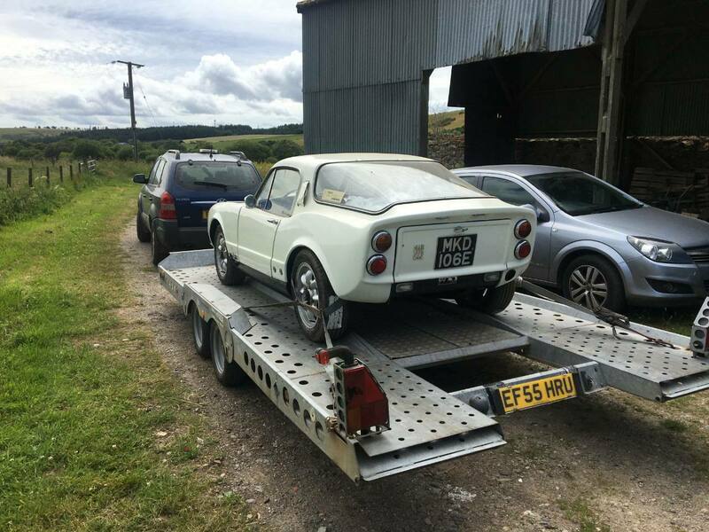

Here it is awaiting collection

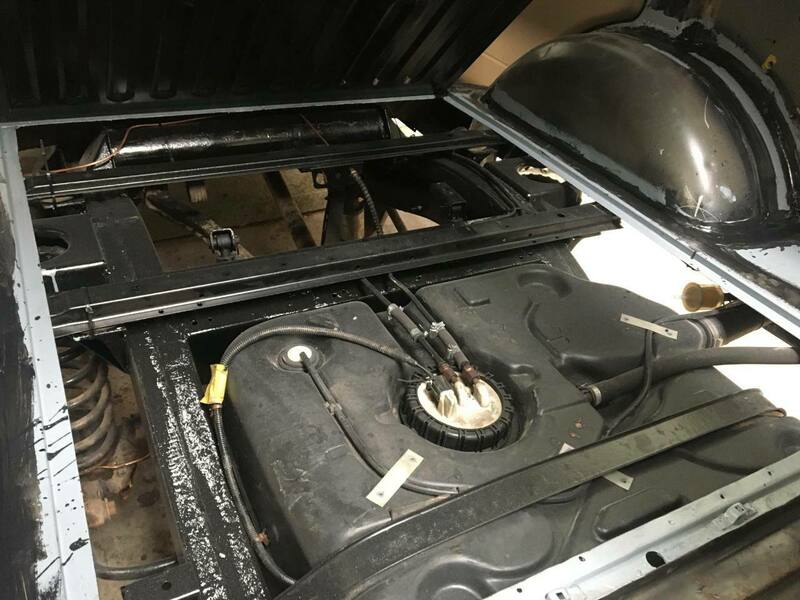

Another hole in the other sill was found so a patch was made and whilst I had the metal tools out I decided to make the patch for the sill end filler/wheel arch hole. Whilst measuring I prodded it and the entire body mount crumbled and fell off. Game Over! A shame as outer body/interior and mechanics are excellent and I have spent a fortune on new parts such as brakes, suspension etc. Herpes was removed from the shed and parked in the "awaiting the bridge" corner,

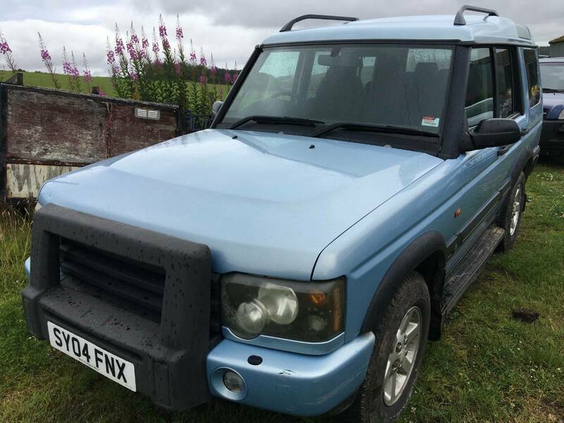

The blue Disco was purchased just before I headed to France so it has just sat awaiting my return. When purchased, the seller said it was needing new brake pads and a full set of front and rear were included with the car as he "had not had time to fit them". On a test drive, the brakes worked fine and no sounds of grinding, so I assumed there was actually a sticky calliper, which did not bother me as Herpes had a new set for its last MOT. On the way home, a rumble was present at higher speed so assumed the front prop was done, a common fault and again Herpes could provide. An idiot in an Audi on the way home meant the brakes got a proper test, and the violent lurch to one side confirmed my calliper theory.

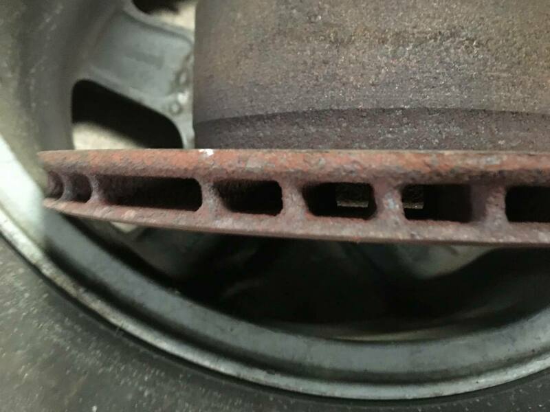

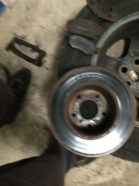

Yesterday, it went onto the ramp for a dose of looking at. Starting at the back, I removed the wheels to be met by nearly new discs on the back. The offside disc was rusty whilst the nearside nice and shiny. Removed the os calliper and one of the pads looked like this

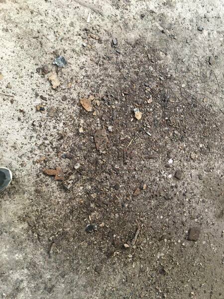

Yep, the lining had become detached and broken up. A look at the calliper itself showe a few* signs of rust and on touching the seal brake fluid started to pour out. Off came the lot on both sides, and the carriers, callipers and pads came off Herpes and were fitted to the blue one. With that done, onto the fronts. With the wheels off, it was obvious that both front discs were well shot, the offside being the worst. Removed the calliper and what has to be the worst bodge I have ever seen on brakes came to light. The front pads looked like this
Both different, neither for a Land Rover. We think one is Ford and the other Audi. Because the disc is so worn, the backing plate off another pad had been jammed behind one of the pads to space it out
But wait! What is that on one of the pads?
Yes, a couple of nuts have been welded onto the pad to make it fit* in a fashion. And the disc?
No longer round and just a little worn
Disc, carrier, calliper and pads taken off the red one and fitted.
The nearside had less bodges but equal wear. Also the wheel bearing on that side is completely shot and would appear to be the rumble as the prop shaft seems fine. I am currently waiting on a friend bringing his XL sockets and XL 3/4 drive dugga gun to remove the hubs so I can complete the job. Hopefully this evening.
Cannot get over that bodge though, and I drove it home 90 miles like that! Last MOTed in March (honest).

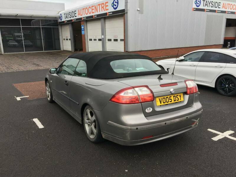

As detailed in my French trip post, the Saab 9-3 'vert went from home to Somerset for Saabfest without an MOT due to me miss remembering when it was due! Whilst there, it received a re-map courtesy of Karl Saabnoob and then continued to my place in France for a couple of weeks R&R. During the two weeks there, the roof stayed down and the lawns suffered a bit more.
This photo was taken at 5pm local time yesterday (Monday)
 Drove the back roads up to Calais for the tunnel, some 300 miles with the top down. Fantastic run. In contrast, this was taken in Dundee waiting for my pre booked MOT.
The Saab passed with a few minor advisories having covered 2645 miles in the previous 2.5 weeks,  The advisories were the headlights need a polish to restore full beam pattern, front offside shock absorber showing early signs of leaking, one drop link slightly worn (probably due to the eleventy million speed bumps at each end of every French village and town) and a rusty rear spring which the tester suggested I change sooner rather than later as it had some severe pits which would weaken it significantly.

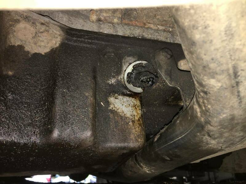

Once home, I put it on the ramp to check which type of droplinks were fitted, and whilst under the car  had a look around. The nearside rear spring (the rusty one) drew my attention as it was now in two bits! The MOT tester was right! Decided that as rear springs, drop links and front shockers are required, and I like the car a lot  I will replace all the suspension, so came inside and ordered it.
Went back out and spotted a small oil patch under the car, but as I was getting the strimmer out that I would investigate later. On returning the strimmer, the oil patch was noticably bigger. A look at the sump and this was found
That is the oil level sensor connector, amusingly not used on my car, which is a common leak point when the O ring on the back fails. Of course, to replace the O ring, the sump has to come off which is a major job. Why do cars reward a bit of TLC and considerable expenditure always reward you by being a complete bar steward?

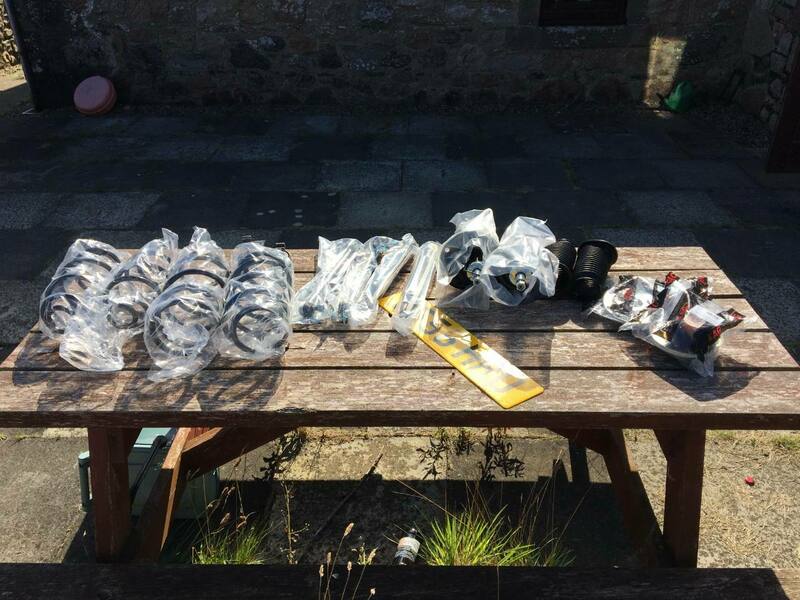

Before I left I had a delivery
All the new suspension bits for the Saab. I had already tried bodging fixing the oil leak by applying tiger seal, but this modern fully synth oil is thin stuff and can escape with ease. It did slow a torrent into a slow seep so counted that as a win. Fired up with enthusiasm with all the nice shiny bits, the Saab went back on the ramp ready to start with the rear suspension, as the design of this meant no spring compressors are needed. I hate doing springs, do not own a decent set of spring compressors so decided do the rear, build up my fortitude for doing the fronts and arrange to borrow a decent set of compressors from a friend. The enthusiasm did not last long as I was met with these on all 4 wheels
