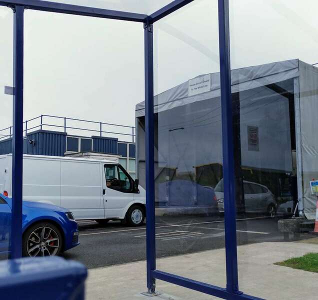

Right then...
Car: COLLECTED.
Brakes: FIXD
Light Of Doom: OFF
Date with Destiny Pt 2: NIGH
I'm a-goin' in.
Again.
Greenhouse of Shame: OPEN FOR BUSINESS
Been here five minutes and both returning cars in that time have been failed: a five year old Skoda Kodiaq thing on tyres, and a ten year old Audi A4 (running the Devil's fuel) on emissions.
Fear levels: HIGH
