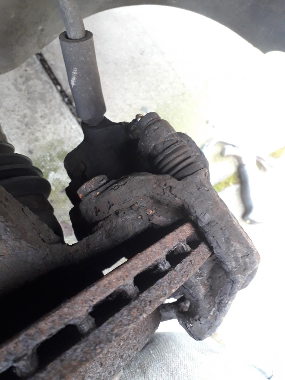

The 8mm ring spanner just slides around the bleed nipple's nut like there's no shoulders there. I try the open end; still nothing. I pull out an 8mm deep socket; nada, there's no grip.
I try a 7mm socket, but it won't fit over the nipple itself. Then, after much rootling in the dark, I find a 7mm spanner of dubious heritage. It... almost goes on. The open end slides on about halfway; it's really weird, as the nut doesn't look chewed or mutilated: just about half a mil smaller than all the others. It's baffling.
In all my looking and puffing, I also note that the disc on this side seems to be barely making contact with the pad at the back. So... are we talking new pads here? And new discs too, maybe?
Right. I have one shot here. I use a delicate ball-peen hammer to tap the 7mm spanner all the way on, so it's very tightly gripping the nut. With a suitable bit of pipe slipped over the end (as a Lilliputian spanner of this size is a mere three inches long), this might work... pressure... bit more pressure...

The inexplicably fractionally smaller, yet utterly stubborn bleed nipple is clearly ruined. There's no shoulders to drive on, just a torn brass mess. At a teensy 8mm, it's too small for my mole grips but frustratingly a smaller socket simply won't fit over the nipple no matter what I do - so as a last gasp I use a chunky set of pliers to see if I can put some turning force on it. But the result is, predictably, just tearing up the nut even more. It's not going to budge. It's never going to budge.
(As an hilarious* aside, I'd had a similar issue with AdamMcC's Mk3 Cortina during its caliper caper a few weeks back, and nothing could shift it - not penetrating fluid, not freeze-shock spray  - nothing. After replacing almost the entire braking system and still seeing no improvement, we eventually worked out that the Tincorner's brakes were absolutely fine, and it was shot void bushes causing it to pull to one side under braking. Ah, Fords...)
The thought of swapping over TAZ's caliper does occur to me, but the bolts holding the caliper on to the stud in KAZ look like something Dr Bob Ballard would retrieve from the ocean floor using a robot-arm submersible, and, sure as night follows day, it would simply open up another world of pain.
Besides - if I'm fitting a new caliper, shouldn't I also be fitting new brake pads? And if I'm fitting new pads, I may as well fit new discs, right? Suddenly, another £80 expenditure is on the cards... and I really don't like the chewed appearance of the Torx bolts securing the existing discs. Nope. Seriously, I just can't.

There appears to be no two ways about it, folks - the brake master cylinder is indeed entirely, 100%, incontrovertibly, indisputably fucked.
Fuck.
Whether my earlier ineptitude with the Easy-Bleed kit caused an internal seal to blow under too-high pressure, or something untoward occurred unseen and unknown in the depths of a freezing winter, I really don't know. But horrific rust and floaty bits in discoloured brake fluid is no-one's idea of a good sign.
This probably explains why the old fluid dribbled out so slowly, drip by drip, rather than the Yaris' healthy flow - the brake lines must be utterly clogged with all manner of rust and gack. So they'll all need replaced, in addition the master cylinder.
