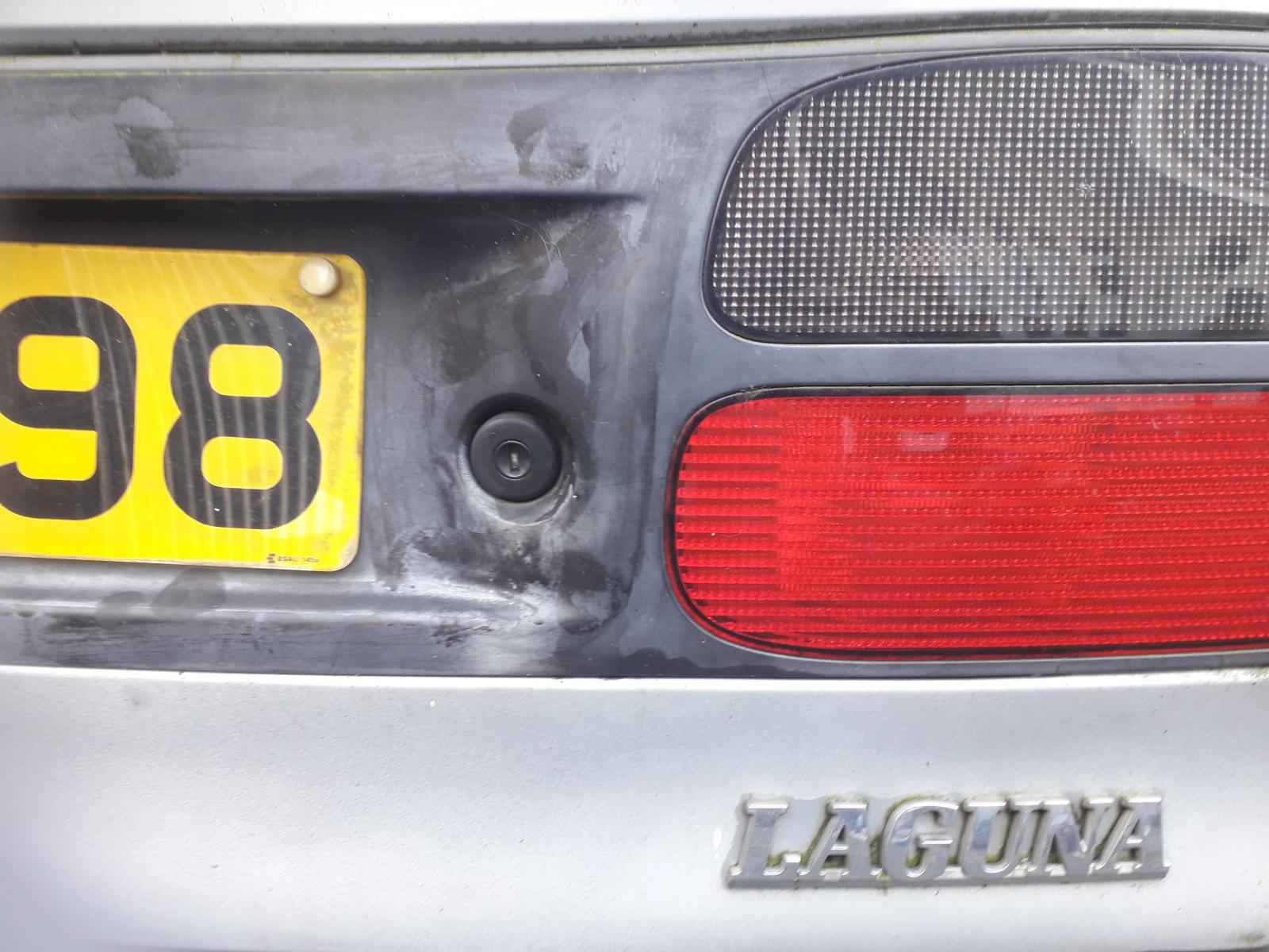

More poking at the tailgate catch revealed a distinct lack of improvement with staying shut, so the next step is to remove the entire assembly and see if I can get it to work. Failure there will then involve a swap with TAZ's latch.

Mrs DC's just come up trumps again - a perfect solution to KAZ's non-closing bootlid, courtesy of another slice of similarly aged frogchod spotted just now:
Rubber retaining clips. Genius.
Actually, thinking about it 306s, Meganes and 405/6s all seemed to have fucked boot locks from nearly new :)

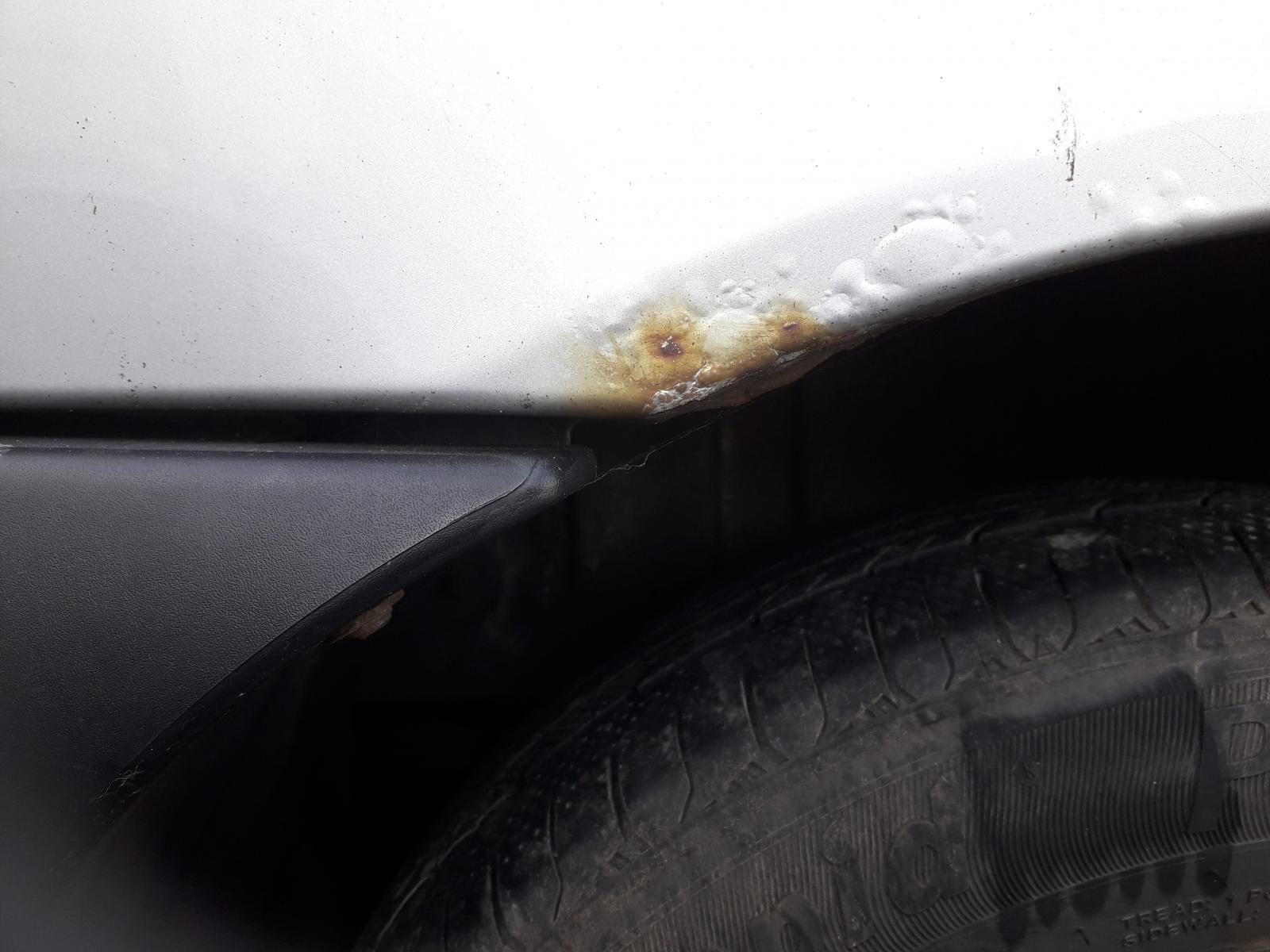

Also - while jacking TAZ up I had cause to notice that there is A LOT of bubbling/splitting around the arch lips and inner wings. Much, much worse than on KAZ. It's been a terrible winter for salty roads, and it appears that TAZ would soon have been needing some tickling with the sparkly stick to remain safe 'n' legal.
 My green E36 has deteriorated more over this winter than the previous three years I've had it - it really has just exploded in some areas. It has perhaps one or two MOT's left and that's it short of major and expensive surgery.
It is 20 though.
Edit: Slagunas - just fucking scrap them.

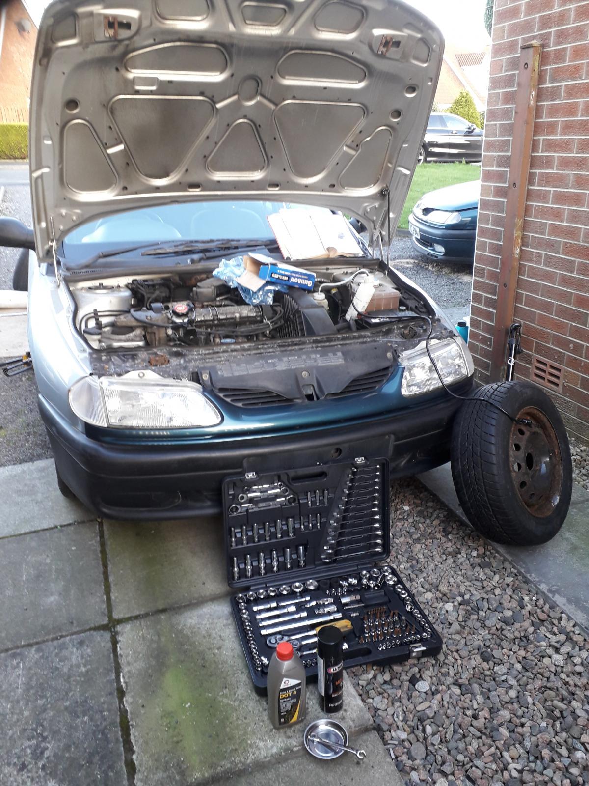

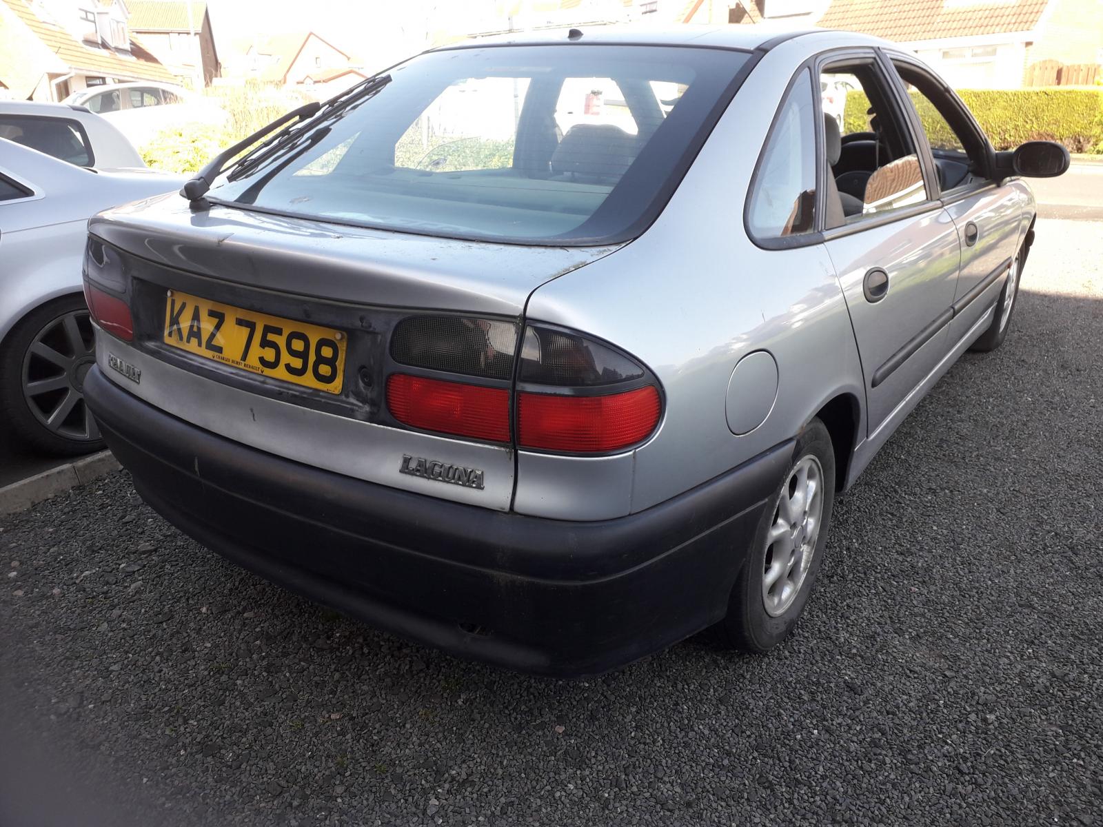

Well, I get KAZ started before lunch and pull her from the valley of the shadow of death (down the side of the house) and out into the sunshine for the first time in nearly a year, and wearing her new shoes too. Starlings have plainly been using her as a bombing target over the past few days.

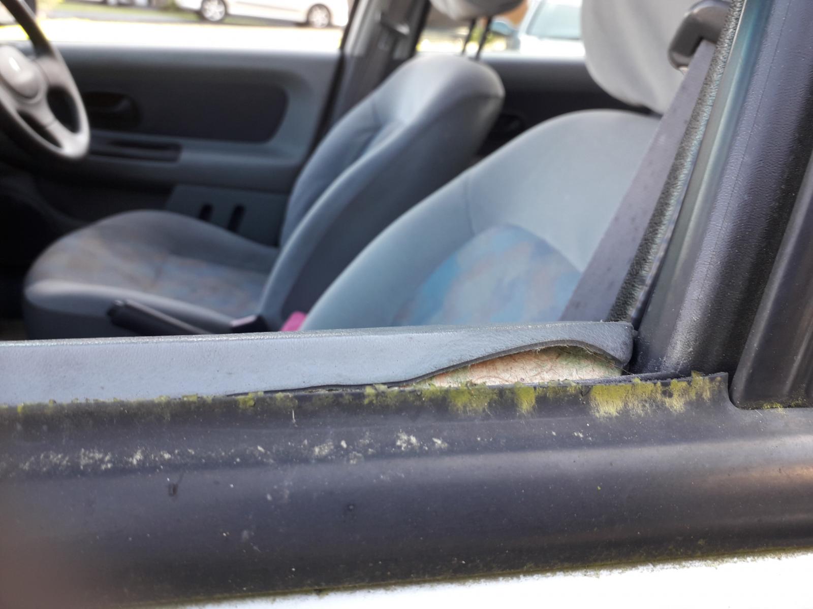

I wind down the windows to harness the sun's assistance in the interior drying-out, which is actually coming along quite well. Carpets feel almost dry, even the rear passenger footwell that was previously very squelchy.
A brief survey of my Gallic chariot reveals gack that doubtless appears fairly atrocious to any two-bucket wrong 'uns in the vicinity (i.e. Next Door, who foam pressure-washes his Evo 9 literally every time he takes it out) - but by no means insurmountable. Bucket of suds and an old toothbrush should sort this, no bother.
And some more Cherry Blossom liquid shoe polish will be needed to go over the black bits. I'd tried this product before, out of curiosity/desperation on a Polo's greyed bumpers with surprising success; and only recently became aware that it's, like, A Thing - with various Facebook groups and whatnot set up for detailing devotees to perve over.
The only scab that I can see that looks like it'll need work is the n/s rear arch, with some bubbling evident. But, overall, for a 22 year old car it's hardly surprising, or a difficult fix.
So. Starting is bob on, and although there's still a bit of top end knock I'm confident that it's no worse than it ever was (and I'm responsible for a full third of this car's lifetime mileage). I'd had a look earlier and nearly bought a can of this additive, but then pulled back from my giddy abandon and decided to wait until the car actually has an MOT and looks like a going prospect before I spunk more money up the wall.
Anyway. After lunch I go for a bit of a gentle shakedown drive along my private test track*, keeping a sharp lookout for nuns, kittens and rozzers. No odd noises, nothing out of the ordinary. Clutch, gears, reverse = all sounding and feeling pretty good. Even the exhaust, which caused endless heartache á la Vulgalour's Princess through failing to seal, seems sound. I am impress.
Until I step on the brakes; they really aren't so good. They felt a little spongy last weekend, and although the pedal feel's maybe not so bad now, there's a LOT of judder even when slowing from 10mph. It feels a bit like the twitchy and temperamental ABS on the Yaris when stopping on a gravel surface - except this car doesn't have ABS (and a good thing too, as the HBOL spells out in gruesome detail how Lagunas fitted with the optional antilock brakes cannot have them serviced or bled by the DIYer - it's main dealer time, every time).
But that's fine, I'm about to service the brakes.

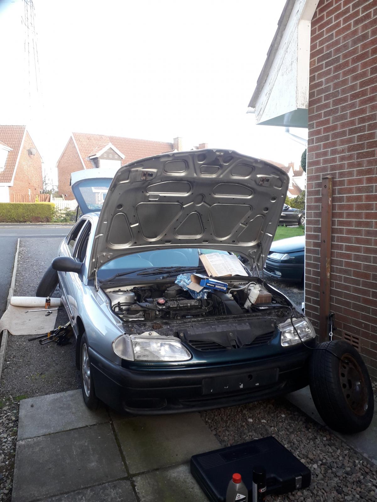

I pull all the tools and new fluids out to begin work, plus the HBOL. To my shame, because KAZ came to me very freshly serviced, I've done very little to her bar oil and filter changes while in my custody. A slow, distant bell begins to toll somewhere in my mind that this may not have been a wise policy.
I start by checking the HBOL advice. Hmmm. My general understanding, while bleeding brakes, is to start at the wheel furthest from the reservoir and then go around the car, finishing with the closest. Not so, sayeth Mr Haynes. Rear offside first (which is the furthest from the reservoir), but then front nearside (the closest), then rear nearside, finishing on front offside. Okaaaay...
The driveway is gravelled, sloped, and not in great shape generally. (This will shortly become relevant). I have the emergency scissor jack out of KAZ and my well-used Halfords 3-ton trolley jack at my disposal to do some liftin'.
Now, I don't miss my old Viva HC for quite a few reasons, but I do really miss the ease in which a rwd car can be raised on a trolley jack. A big front crossmember - centre the lifting arm, and up she goes - axle stands, job's a good 'un, ginger beer all round. Same at the back.
FWD cars... well, there's usually some vague references to jacking points, but not much to help understand exactly what's a load-bearing section and what's not. So, when working on FWD cars, I've tended to use a stout block of wood, notched with a bowsaw to avoid damage to the sill-to-floor seam while lifting it with the trolley jack around the 'official' jacking point, as recommended by Haynes and other motoring tomes.
The Laguna 1 goes a step further, by having an odd little slot cut horizontally into the seam with a plastic liner inside, and a corresponding tab on the jack that locates into this liner. Crank the little handle, and up she goes. Normally this isn't that relevant, but the Laguna is a low beast, and the problem is that I can't get the trolley jack and bit of wood slid under her.

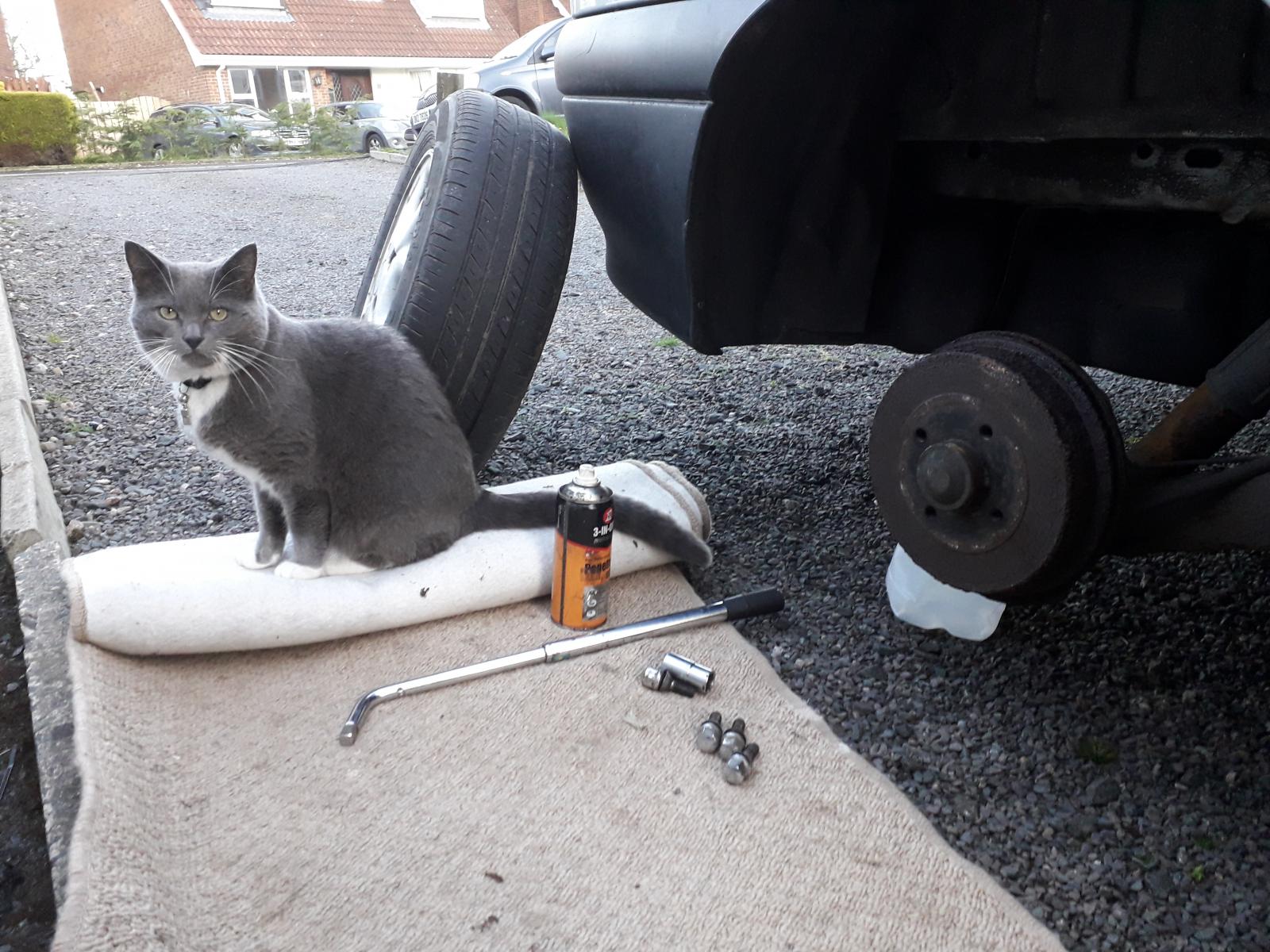

So, while doing the wheel swap the other night, I found it best to use a combination of both jacks - using the scissor jack in its little locating slot to jack the car up an inch or so, then slide in the trolley jack and pump it up until the tyre was clear of the ground. Hey, it worked.
Or - it worked on the hard-standing paving, at least.
Well, up goes KAZ at the back, using this principal. Once the wheel is off, I place an axle stand under a reinforced box section and slacken off the jack, as any fule kno you don't work under a car supported by a jack.
As ever, Cat arrives at this point to offer his services, which are gracefully declined.
So I fill the Gunsons Easy-Bleed bottle with brake fluid. My intent had been to first of all use the leftovers from when I changed the Yaris fluid a month or two ago, but I hadn't twigged that it was different. I'm still not sure how it's different, but I decide to take no chances, and open the new bottle.
And we're finally ready to go. (Pay close attention to the setup in the picture here; it'll become relevant shortly.)
I shall draw a veil over the next half-hour's comedy of errors, involving too much pressure from the spare tyre; too little pressure from the spare tyre; and nothing but a tiny dribble emerging from the bleed nipple no matter what I try or however much I slacken the 8mm bleed nut.
Suffice to say, it takes about a further half-hour of dripping/dribbling until the fluid that emerges from the rear o/s bleed pipe no longer releases air bubbles on making contact with the fluid in the waste bottle, which tells me that there's new fluid all the way through. I run it for a minute or two more, just to be certain. The old fluid also looks like oxtail cup-a-soup, rather worryingly. But I see that about half the Gunson's bottle has now gone into the system, which I judge about right for the longest length of brake line and also the reservoir. I nip up the bleed nipple, replace the rubber dust cap and refit the wheel.
And then it all goes badly wrong alarmingly quickly.
I pump the trolley jack a couple of times to bring it back up to the sill, then start to raise it clear of the axle stand, which I remove. The wood block is about two or three inches downline of the actual jacking point.
I take the trolley's handle from the jacking socket, and begin to turn the release valve to lower it. Gently, like - I'm not a ham-fisted fool. KAZ starts to come down. So far, so tedious (I'm sure by this stage you'll agree).
And then there's a bang, followed by KAZ coming crashing to the deck. And the sound of things falling, and things hissing, and something strikes my (steel-toed) boot hard. And there's an unexpected wetness on my face and my neck.
